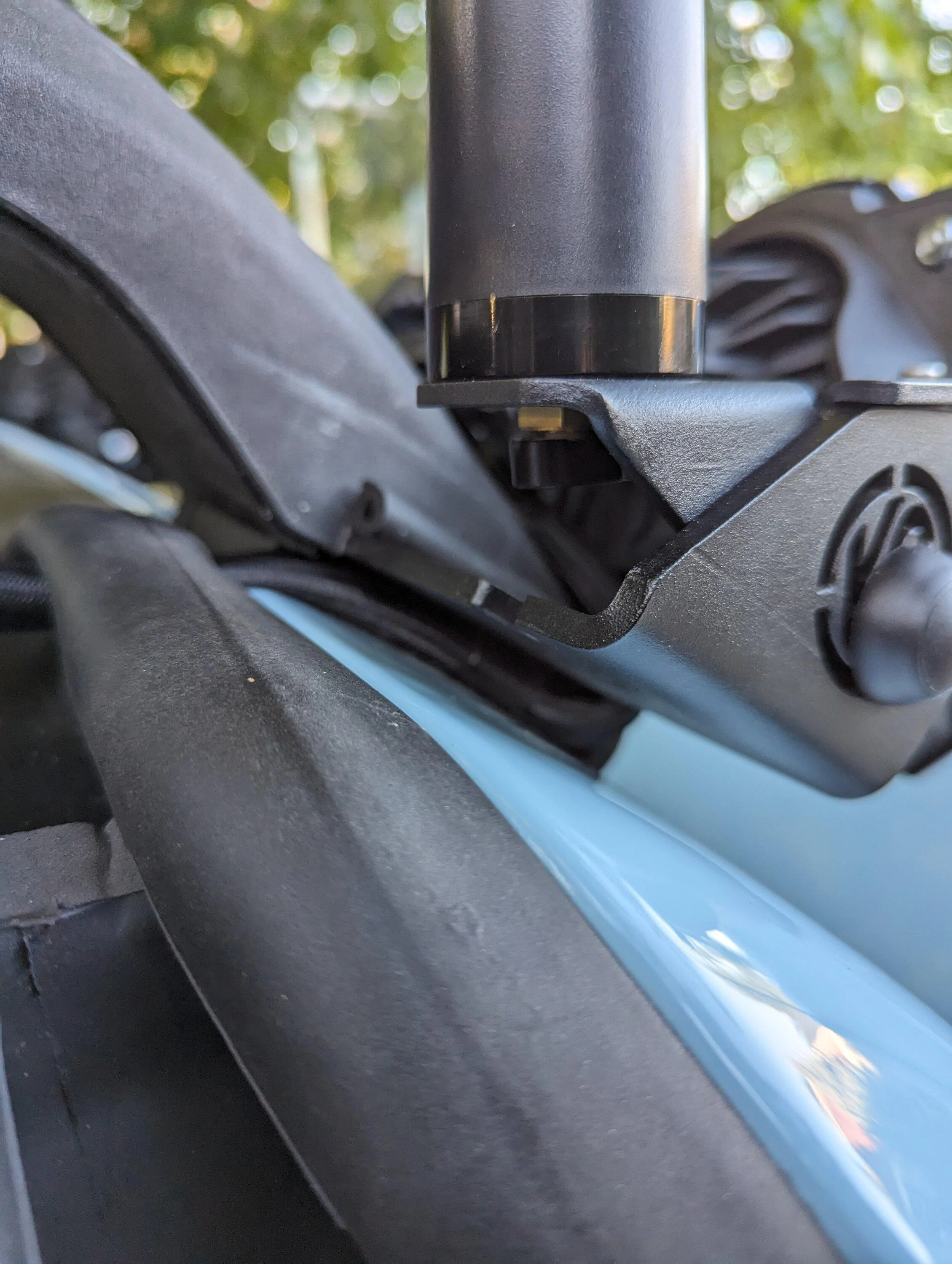

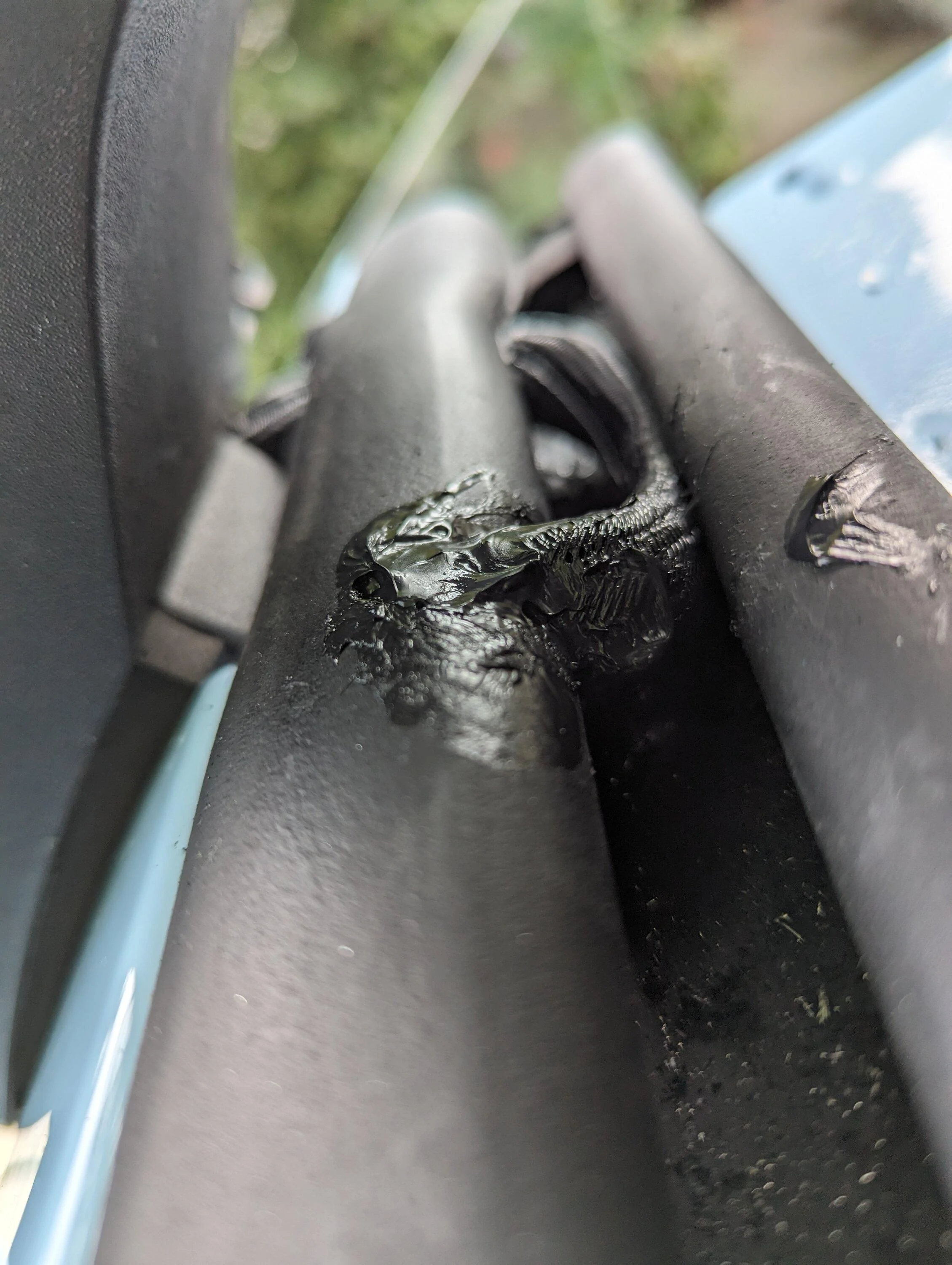

So... I ran 12 gage positive and negative as well at my GMRS radio Coax through the A-pillar. Had to pop up through the roof so.... I chose my own spot and did.
First photo all three lines are wrapped in wire loom. Far side is coming from equipment through the roof seal at the accessory mount location (outboard side) then toward the center of the truck (toward camera) and then turns down through a hole I drilled and into the cavity above the passenger visor then over to the A-pillar. Had to keep the wires above bottom of the "trough" so as not to block water flow and the hole entering the cavity above the bottom as well.
The weather striping is double layered and the wiring is siliconed at BOTH layers on its way through BOTH times. (so 4 Locations).
So far seems to be well sealed. High pressure water (for car wash) does not penetrate.
pics attached....
