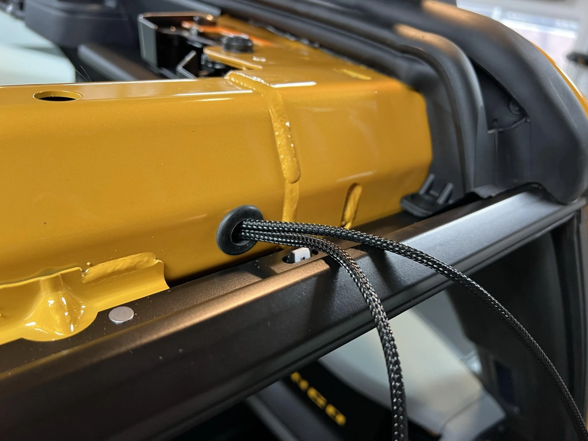

Ford Bronco Removable Roof Light Bar Wiring Solution IMG_5104

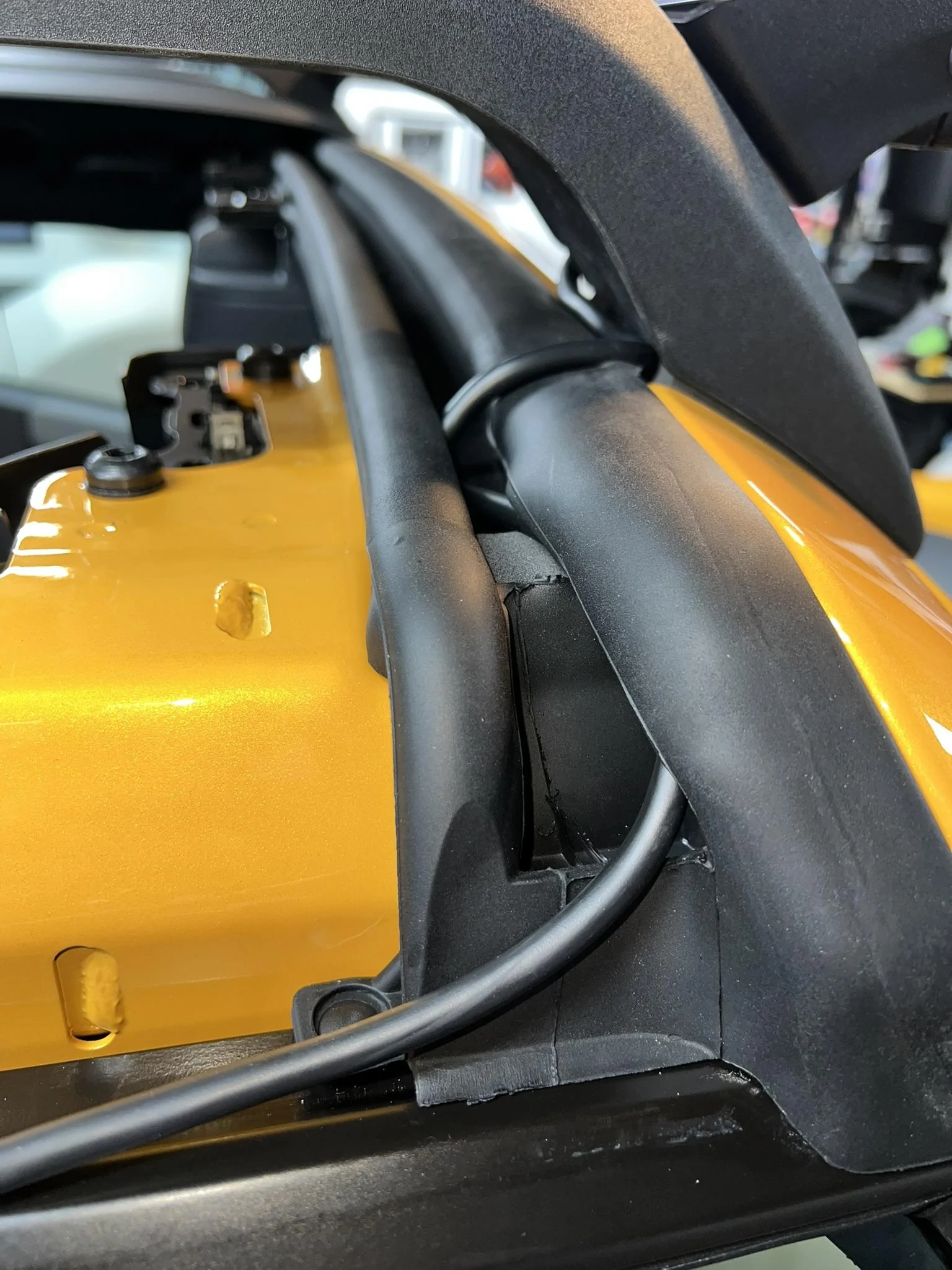

  • I ran the switch wire from above the sunshade into a hole in the roll bar above the passenger seat.
  • The ground wire was connected to a body bolt which attaches the airbag 'guide' to the roll bar.
  • They both then enter the roll bar via the hole you see here and route FORWARD
Ford Bronco Removable Roof Light Bar Wiring Solution IMG_5106

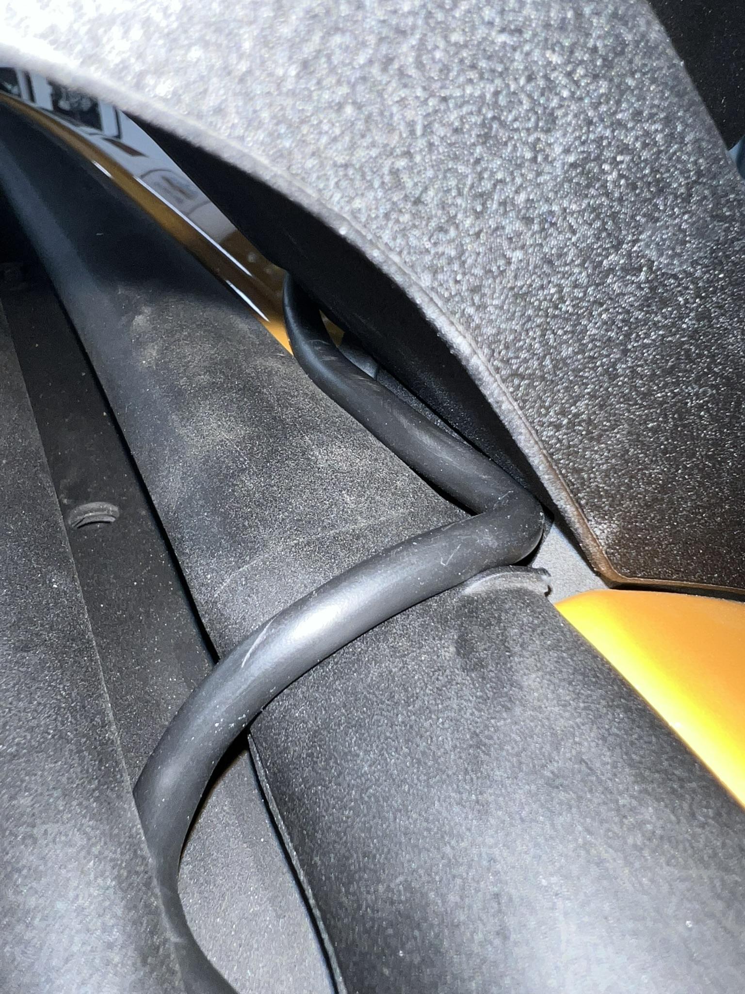

  • As a testament to all of you who never throw out a spare part, I've had that grommet in my spare parts compartment box for over 15 years and was elated to find it was the perfect match.
  • Anyway, exit this hole.

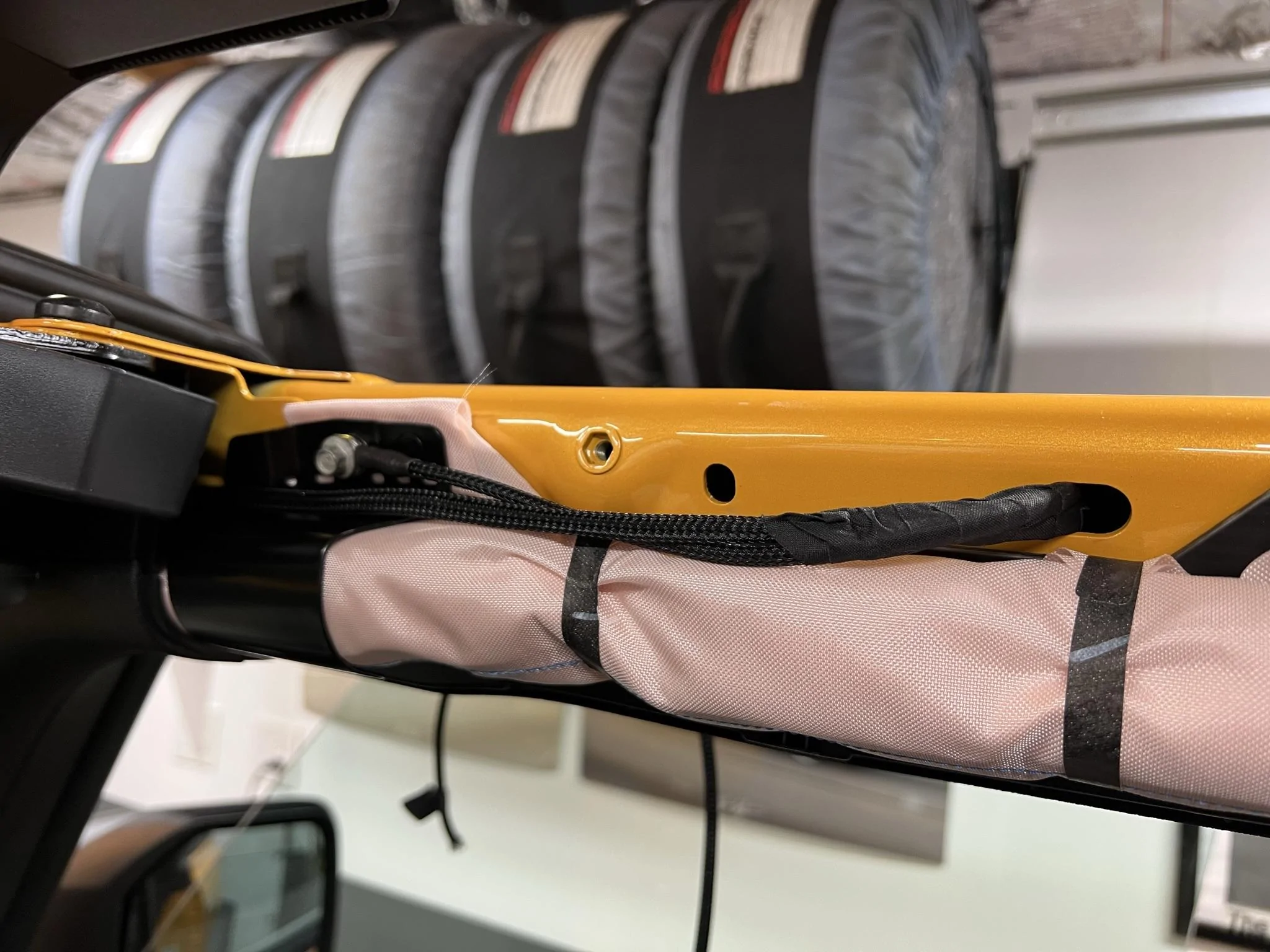

Ford Bronco Removable Roof Light Bar Wiring Solution IMG_5110
  • I went OVER the weather stripping instead of through it.
    • The male end of the Deutsch was just a little too big for my liking to cut into the weather strip.
    • Use your heat gun to warm up your light bar wire and bend it to fit into the weather strip's premolded channel and inside the water runway.
  • Here is where you will use your shrink, harness tape, solder, heat gun, magic powers
  • You don't need the extra length but it's always easier to cut in the future than splice in new wire if you need to go longer.

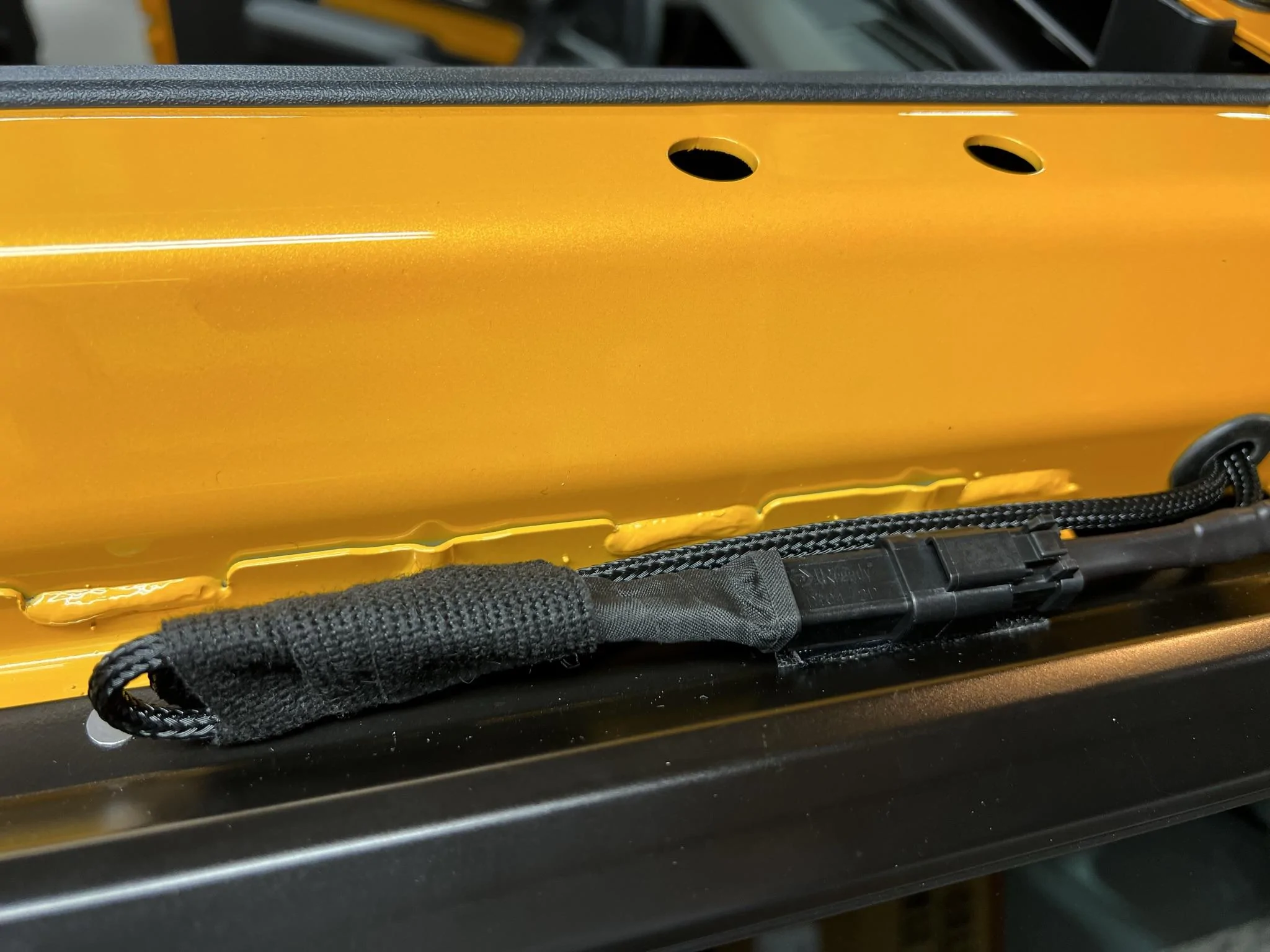

Ford Bronco Removable Roof Light Bar Wiring Solution IMG_5114
  • Note: the light bar wire is specifically and intentionally positioned in this photo to be exactly how it will sit once the roof panel is back on.

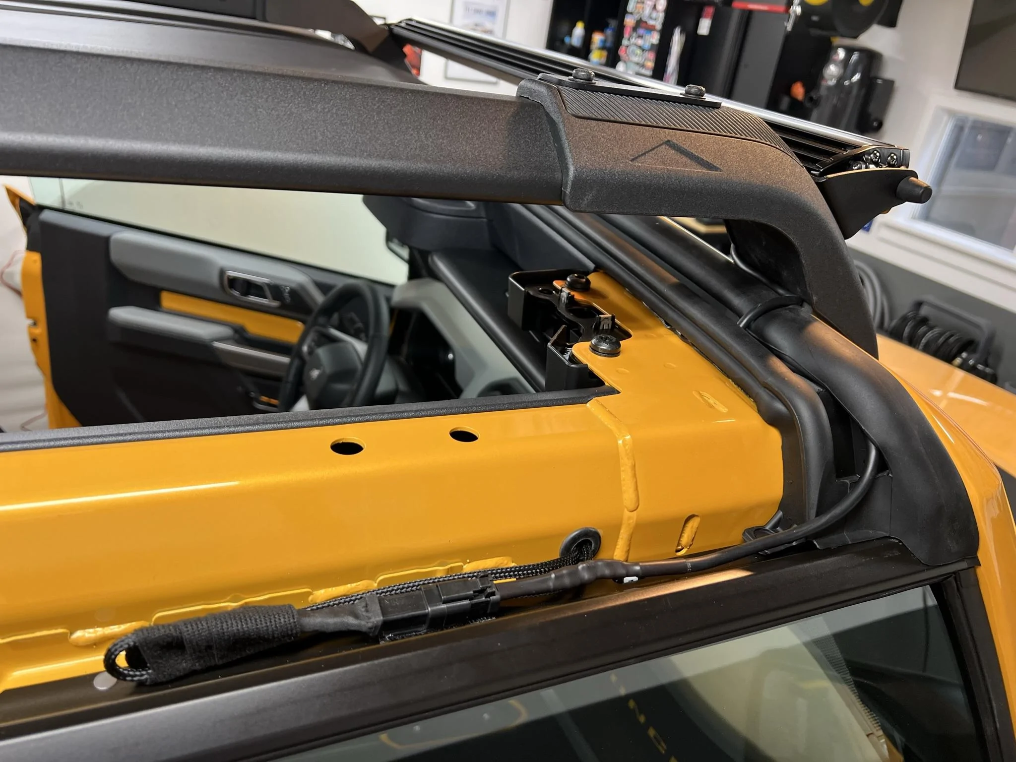

Ford Bronco Removable Roof Light Bar Wiring Solution IMG_5115
  • The connector and wire bundle is wrapped (loosly) at the kink.
  • Velcro is used to secure the connector to the inside rail.
    • When the light bar is removed, the Bronco end of the harness will still secure to the body via Velcro.
    • There are alternatives to this method and a Deutsch mount is one of them currently en route

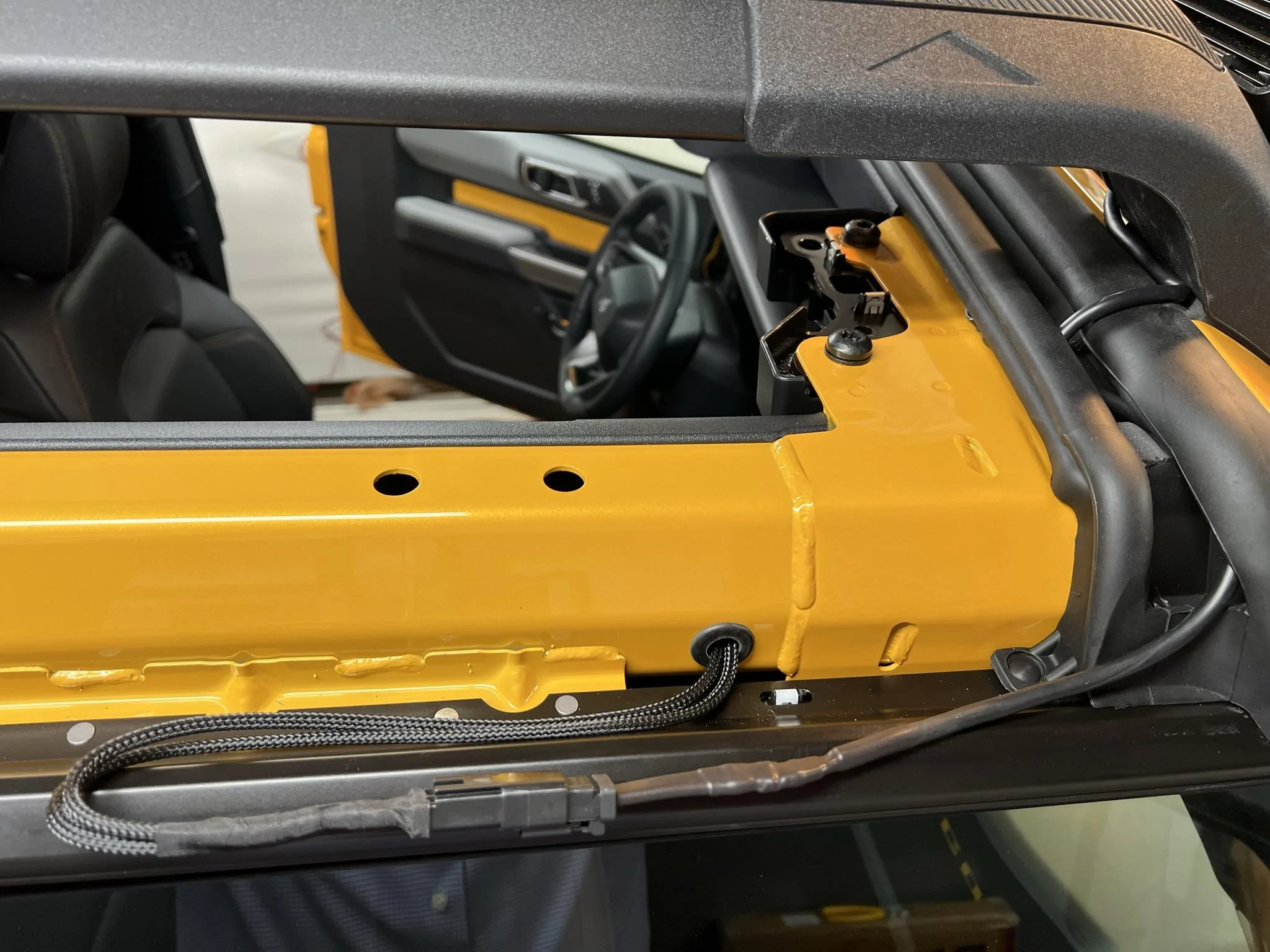

Ford Bronco Removable Roof Light Bar Wiring Solution IMG_5116
  • The bundle is now secure.
  • This is empty space once the roof panel is back on. In fact, you can reach your hand over the rail form inside the car and feel the harness if you ever needed to disconnect it with the panel on (another reason for Velcro and not a more permanent solution)
