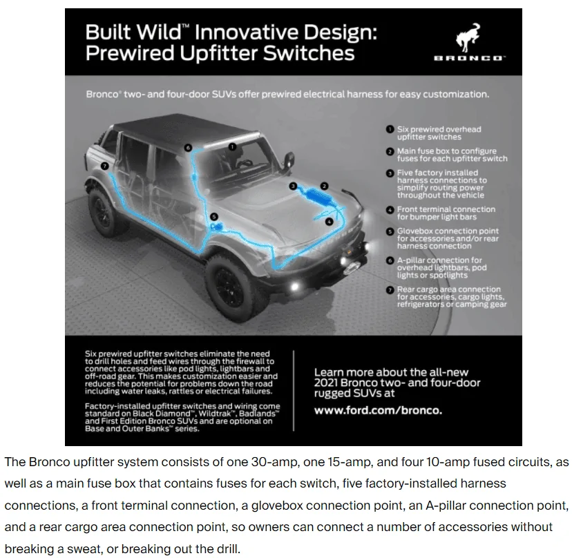

Yes people need to know what they are doing here. The NEC shows how much amperage conductors can handle at ambient temperature and with continuous load. Also have to take into account overcurrent protection. Too much amperage across a wire that is not big enough will act as a choke and melt the wire, damage the components(s) or start a fire. If your not sure check the OEM requirements and stay with what they ask for.
Well, since you have the diagram. You can always use existing wire to pull new wire.

If the table Bronco Nation provided is accurate and its talking in terms of square millimeter cross-sectional area, it falls between 16 and 14 awg and depending on the insulation type (GXL?) is good for 18-20 amps. I think that's adequate for most. If you're dropping $2k+ on a giant array, I doubt the minor amount of labor and expense of pulling new wire is going to be the end of the world.

That table matches the information in my on board owner manual. You would want to use either switch 1 or switch 2, depending on the amp draw of the lights. Those are the ones with the higher gauge wire. All of the extenders going to different parts of the vehicle are the 1.5 mm wire.
Not sure why they just didn't use 14 gauge wire and say so. It would make life easier. Metric wire makes my brain hurt.

does ford really need to contend with the foolish actions of owners making bad choices with modifications? these are nothing more than signal wires to actuate a relay. if someone burns one trying to jump start another car it is on them. part of growing up is making bad decisions and learning from them. back in the day, there were some who put a holley 750 on a stock 305 in a camaro and thought it would be faster... they learned quickly it did not idle...
The switches themselves are also fused. Ford was thinking ahead on this. Lol
Fuses are present to protect the conductors only...
If you wanna hook up a 40A load to a 10A fused conductor, fine... You'll blow the fuse well before melting the conductor and starting a fire.
Hopefully by this point you'll look at the manual and make better decisions

regardless of gauge size the wires can be used to rerun larger gauge. It could be string for all I care.
I wish. I'm installing one right now and Ford has these wires taped/spliced into other harnesses running throughout the vehicle, so you can't pull on it separately without gutting a bunch of other stuff.
