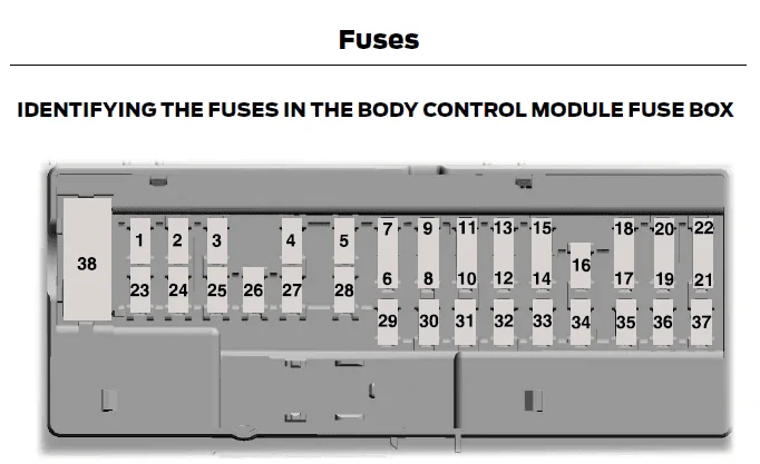

But if you're getting any audio at all, I doubt it's the ACM fuse.
Is that fuse box behind the glove compartment? Haha...i should have hired someone to do this
zombie
Sep 23, 2021
1,532
3,462
New Brunswick, Canada
'21 Bronco '22 Mustang GT PP 06 Viper SRT10
Nope, but the manual lies and says it is. (lol)
Pull down the panel that's located under the steering wheel (the bottom most panel), it hinges from the bottom so pull *gently* from the top out towards you.
