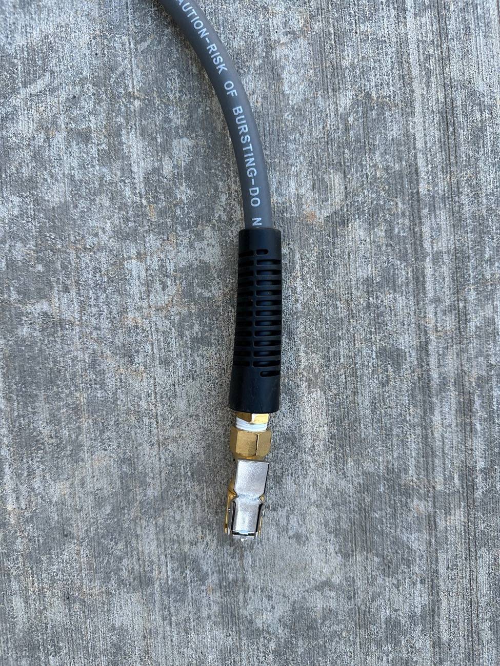

Optional, if you want to preserve the hose that came with your compressor (verify your compressor uses the Nitto J-Type fitting, which it very likely does):
Nitto adapter: https://www.amazon.com/dp/B0CQKCSTFH $15

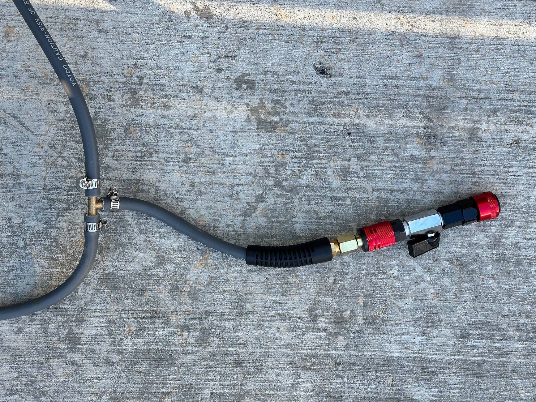

I put the shut-off valve in between the two parts of the Nitto adapter. Then I cut a short length off the hose and attached to the The Nitto adapter. The shut-off valve isn't strictly necessary, but I thought it might be good to have.
Ford Bronco Last minute compressor recommendation IMG_5156 copy

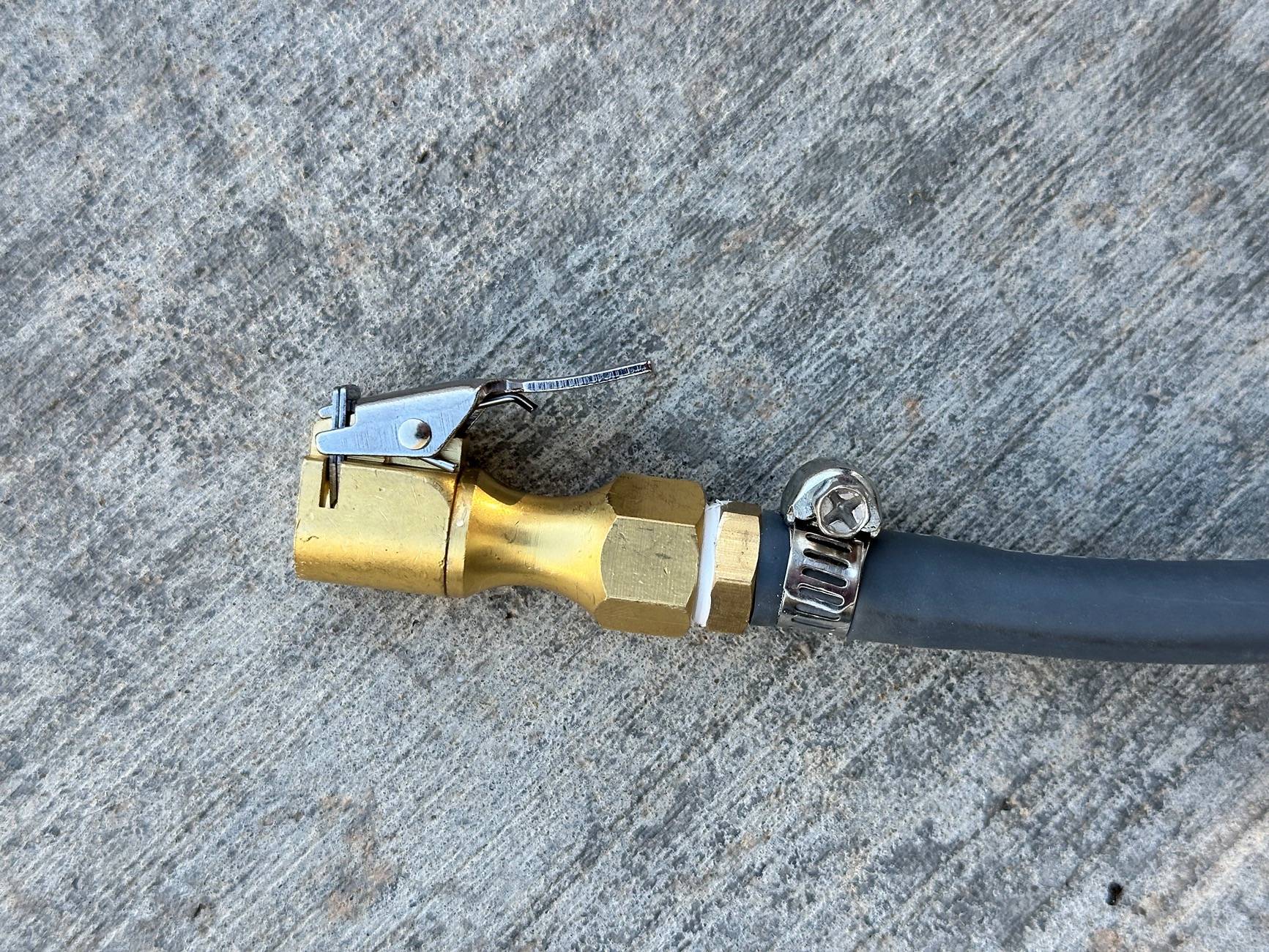

These 10' pieces were attached to the remaining unconnected fitting of the T-adapters, and chucks were added to the ends. Although it can work either way, the oddball fitting that used the built-in connector from the hose tells me which hose goes to the right rear tire.
The chucks are a nice quick-connect and release style, so no air is lost attaching or removing.

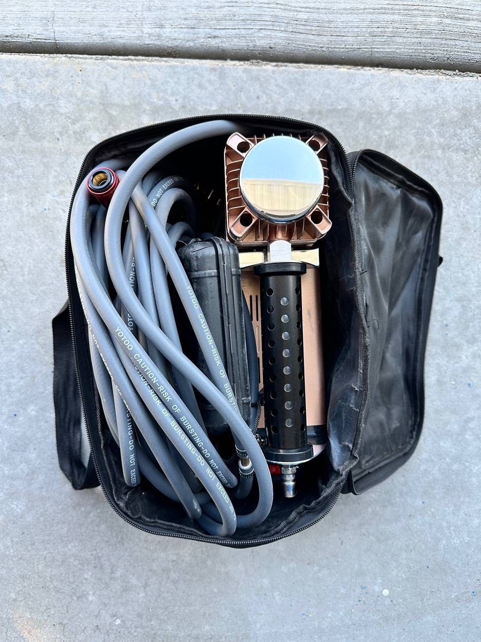

As you can see, it fits in the bag with the compressor and a case with deflators and a pressure gauge:
Ford Bronco Last minute compressor recommendation IMG_5155 copy

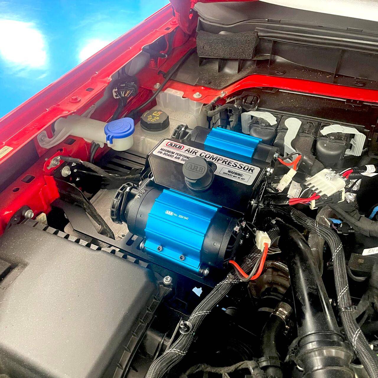

I'm sure you are well on your way but when you get back you should invest in our ARB Onboard kit. We were the first ones to come out with this solution (patent pending design). It's the most elegant solution for an onboard air compressor under the hood. Easy to install and always available. They are popular here on Long Island as we have a big surf fishing community and we drive on the beaches here.
Coupon code BRONCO6G saves ya 10% as well: https://www.4x4truckleds.com/kr-off-road-air-compressor-engine-bay-kit-for-2021-ford-bronco/
