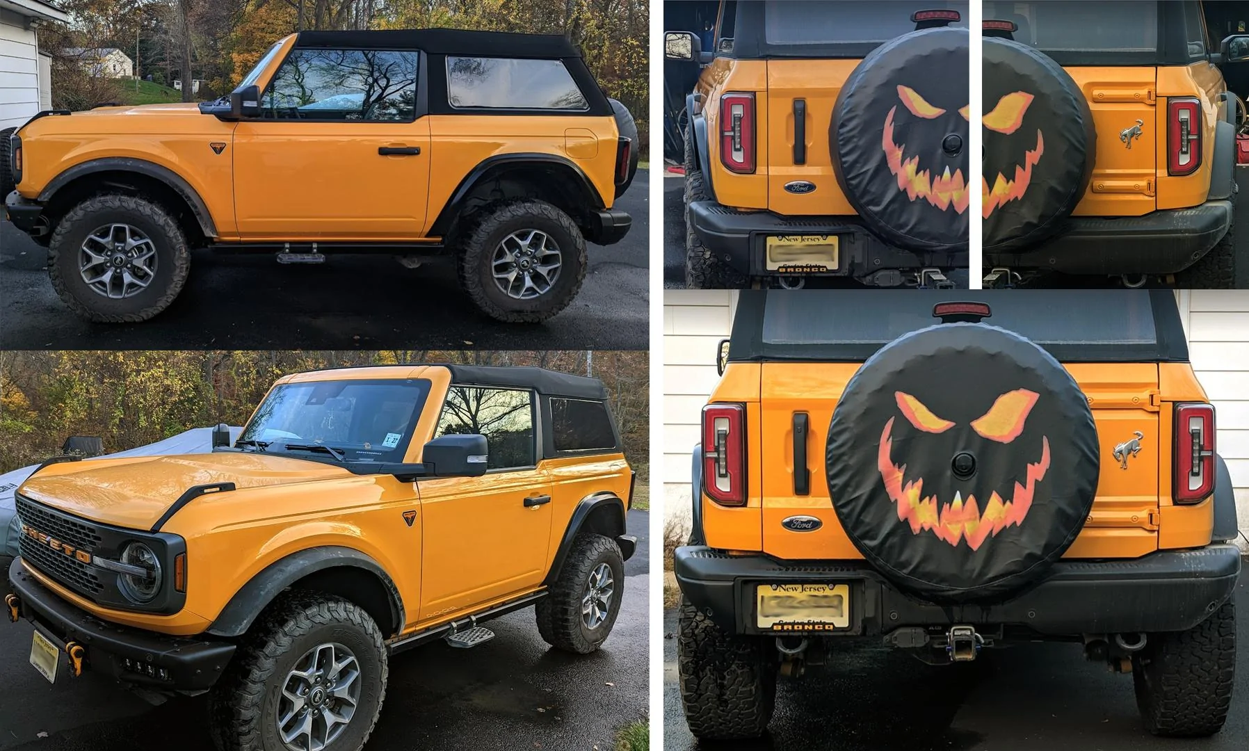

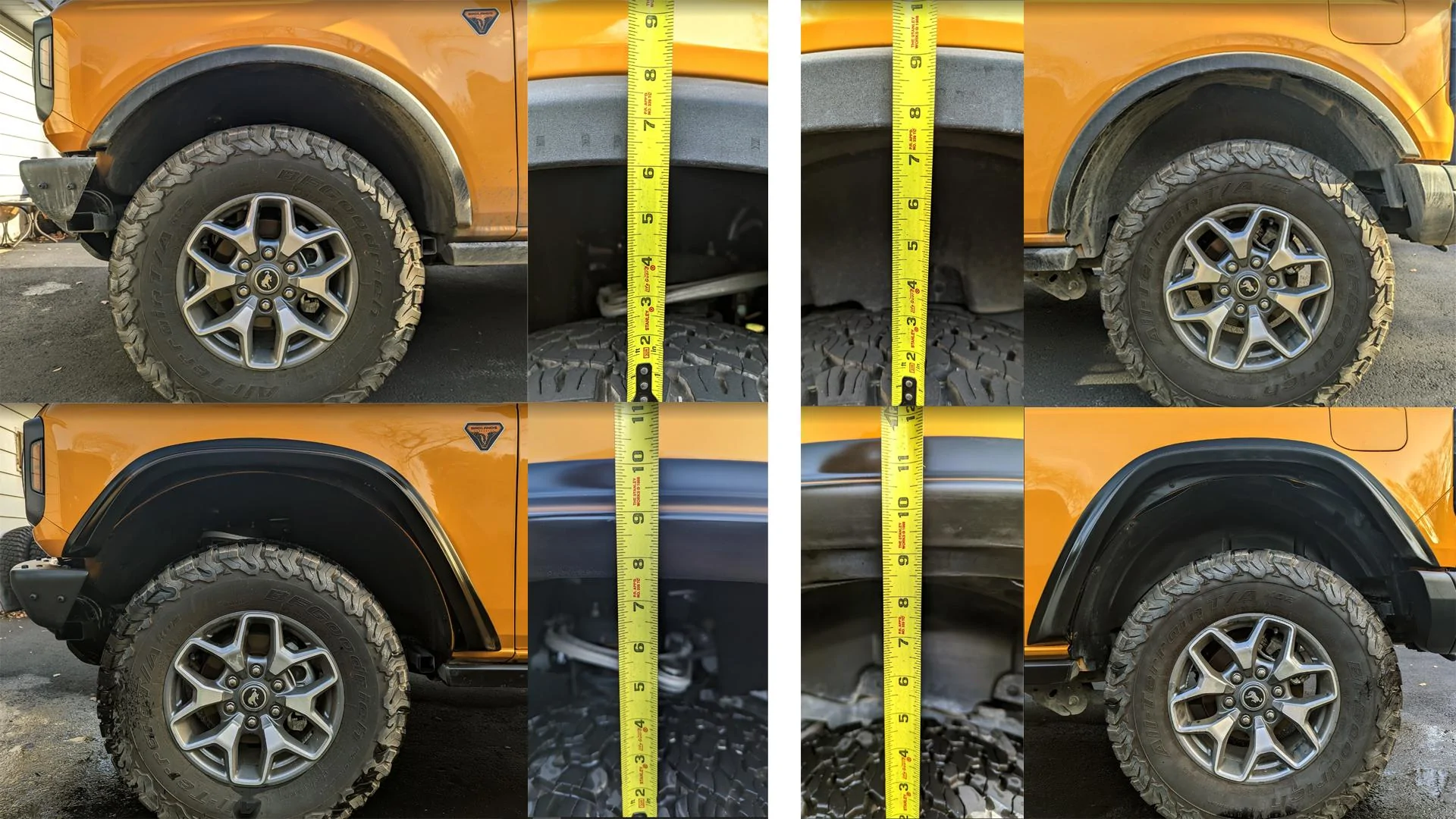

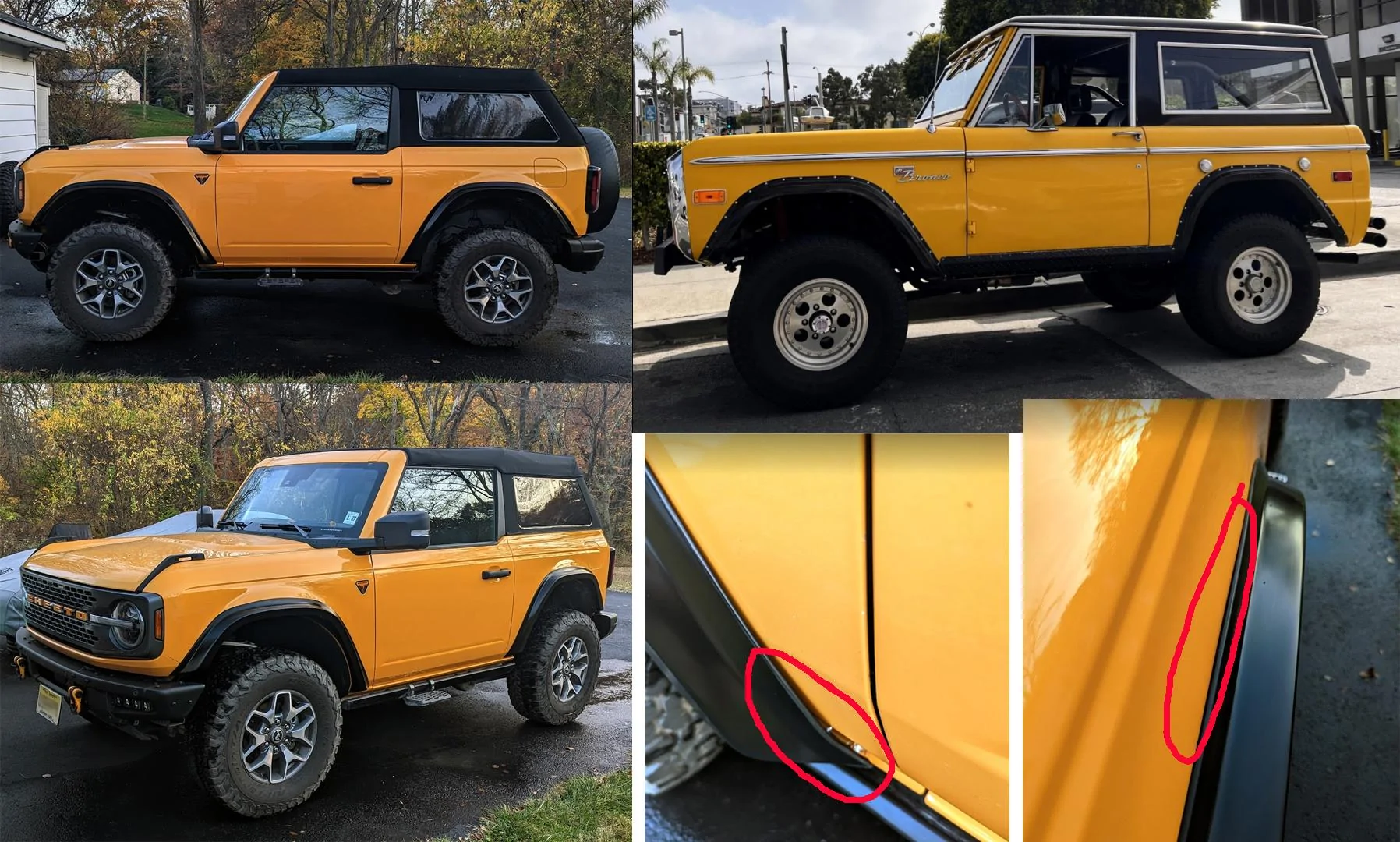

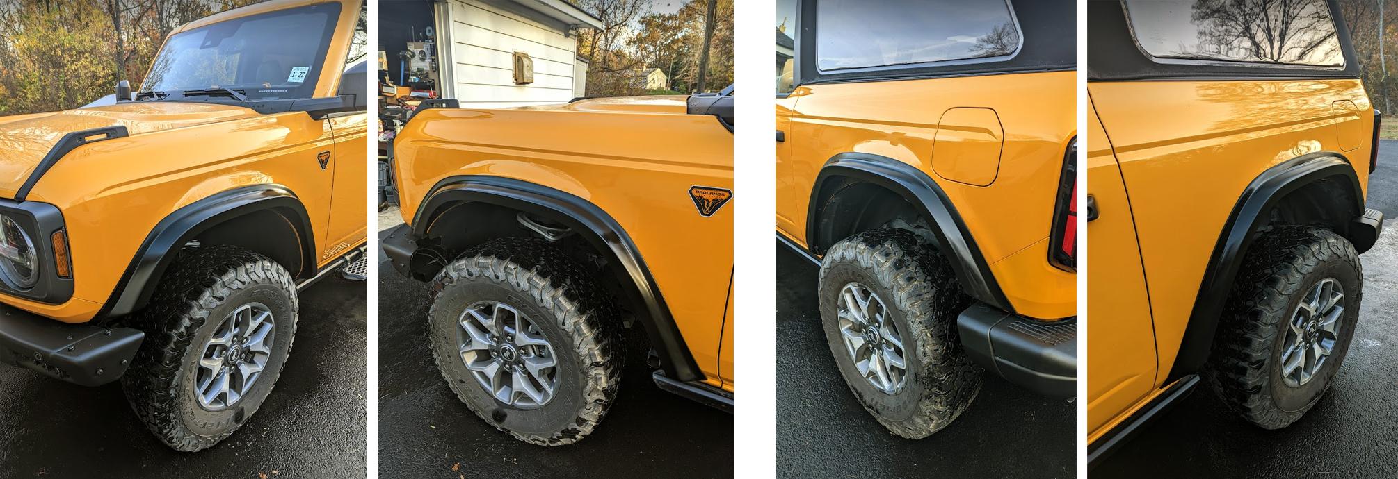

OK, so hopefully everyone can learn from my experience so far. I rushed into this project and really wish I had taken my time and thought more about what I really wanted in the end. I ended up getting one front and rear flare installed, then pulled them off because I really should have held them up temporarily to see where my CO paint shined through, stepped back and thought twice before ripping off the tape backing. In a sad attempt at hiding some of the orange fender edge on the front, I ended up installing the flare too low to where there was a gap at the top and bottom (see the circled red areas). Luckily the tape is the clear type that pulls off without tearing or leaving anything behind - I will have to get more of that for reinstall.
Overall they have the look I want with the compromises I expect, but I am going to wait until Spring to reinstall, taking the time to prep and paint my fender edges black. The front will fit much better sitting at the correct height, and the black paint will hide my CO fender edges. Also worth noting is that these flares have the appearance of a lift with extra clearance (1 1/2"), and I'm sure that anyone running a setup with poke would indeed get more clearance to the edge of these flares under the right flex conditions.
Some comparison pics:
Ford Bronco KBD fender flares KBD Comparison 01
Ford Bronco KBD fender flares KBD Comparison 02
I included the EB as it inspired me wanting this style fender flare and keeping them black:
Ford Bronco KBD fender flares KBD Comparison 03
Ford Bronco KBD fender flares KBD Comparison 04
