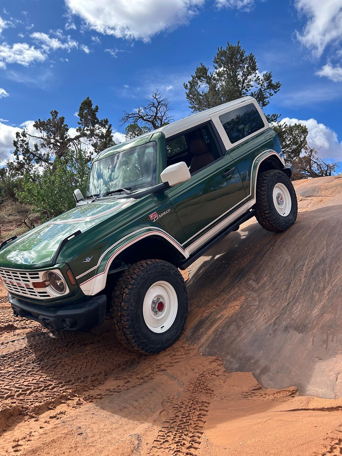

this thing is beautiful. Just wanted to let you know. probably one of my favorite builds I've seen yet!
Thank you very much. I have now had the flares for almost two years, and they are still doing great.

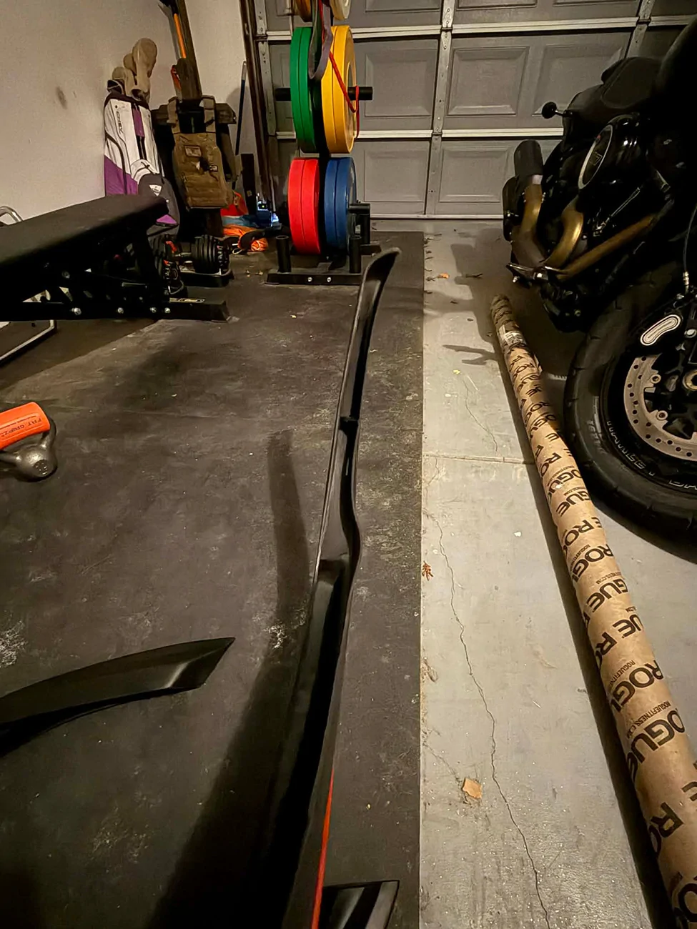

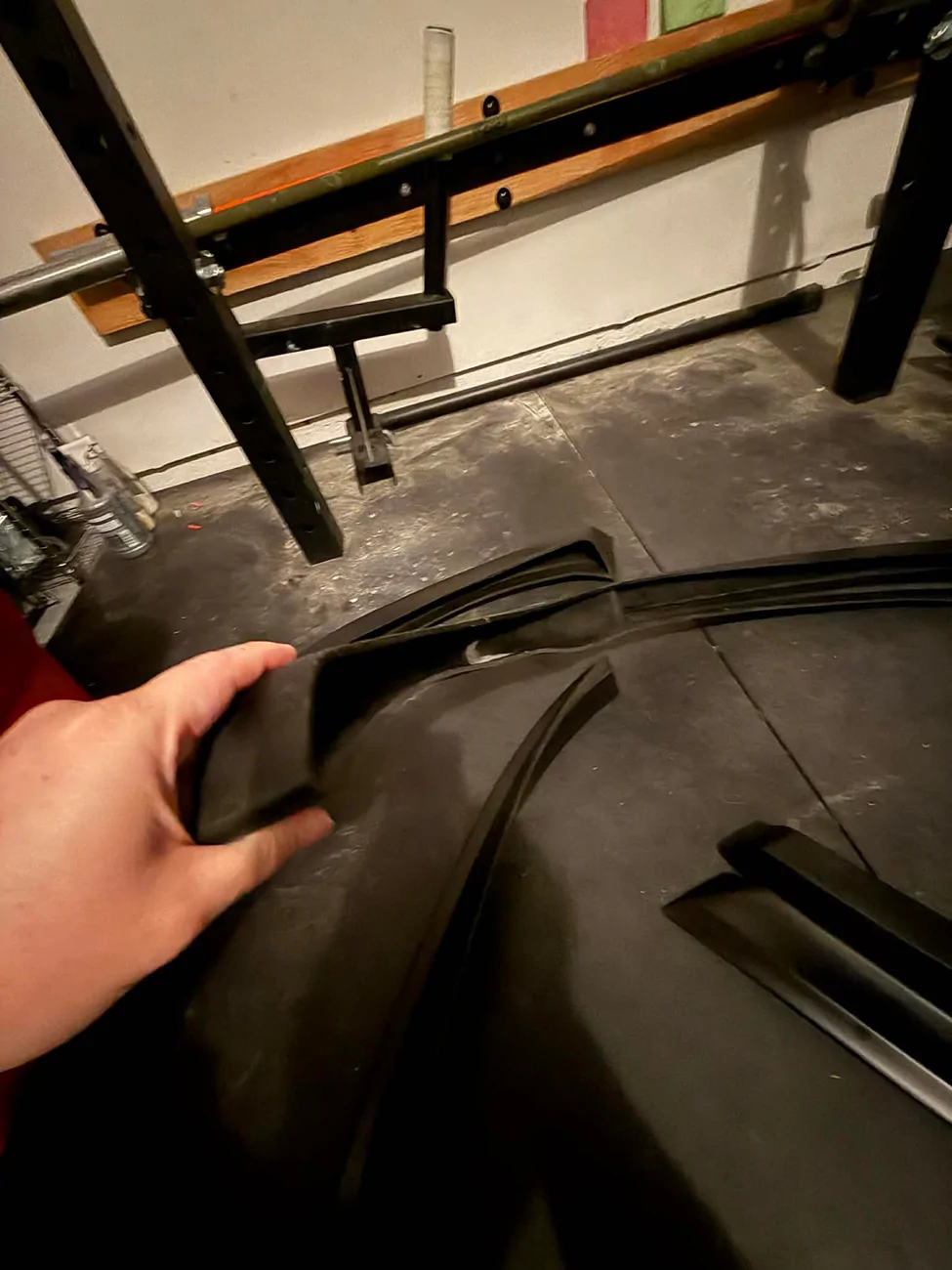

So I bought some flares from a local member. They are brand new. Are the flares supposed to look like the ends are smashed in? Some areas are distorted on the back side too....is the backside supposed to look like it still needs a second stage of smoothing? I know it's the backside but most places still make it at least kinda smooth looking.
Did anyone need to use "heat" to reform the flares like they say in their video on their website for their bumpers?
Mines look like they need to get painted too, can't just throw it on. I am thinking bedliner coating would look like stock?
Here is an example below. The right side is the backside, see how it is distorted. The rubber is softer back there but I hope it flattens out to the body when installed...

It has been over two years since I put mine on. I can’t remember exactly what they were like. But they were definitely not pretty. Mine went on pretty straight forward. They ended up pealing away from the fender about a year later. So I ended up putting a bead of silicone adhesive on the backside and taping them in place with painters tape for a day to let them dry in position. They have been great even since.
