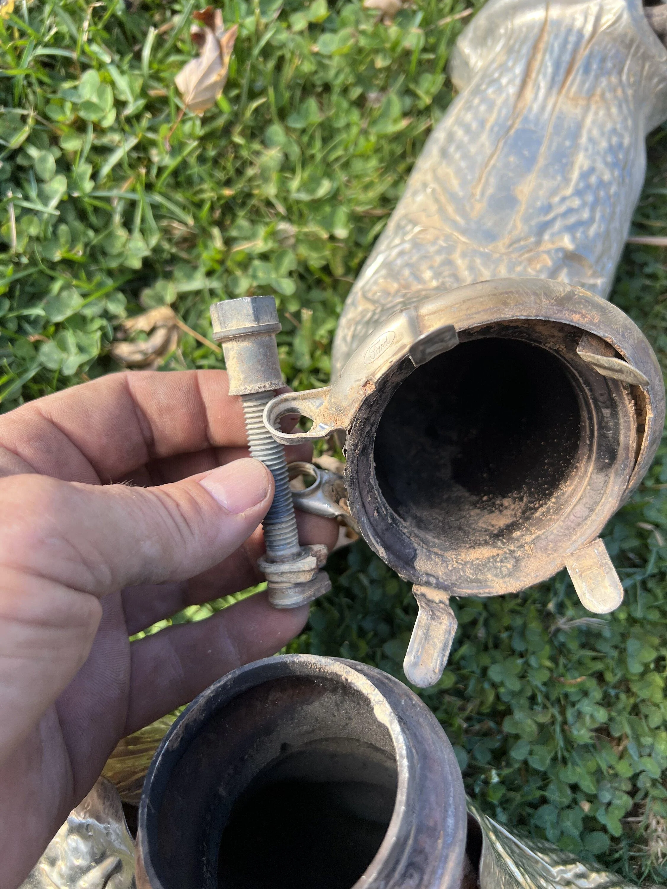

Next break loose the flange bolts on the turbos. 15mm. They are not that tight. I used a small ratchet with a long 15mm then a short 15mm.

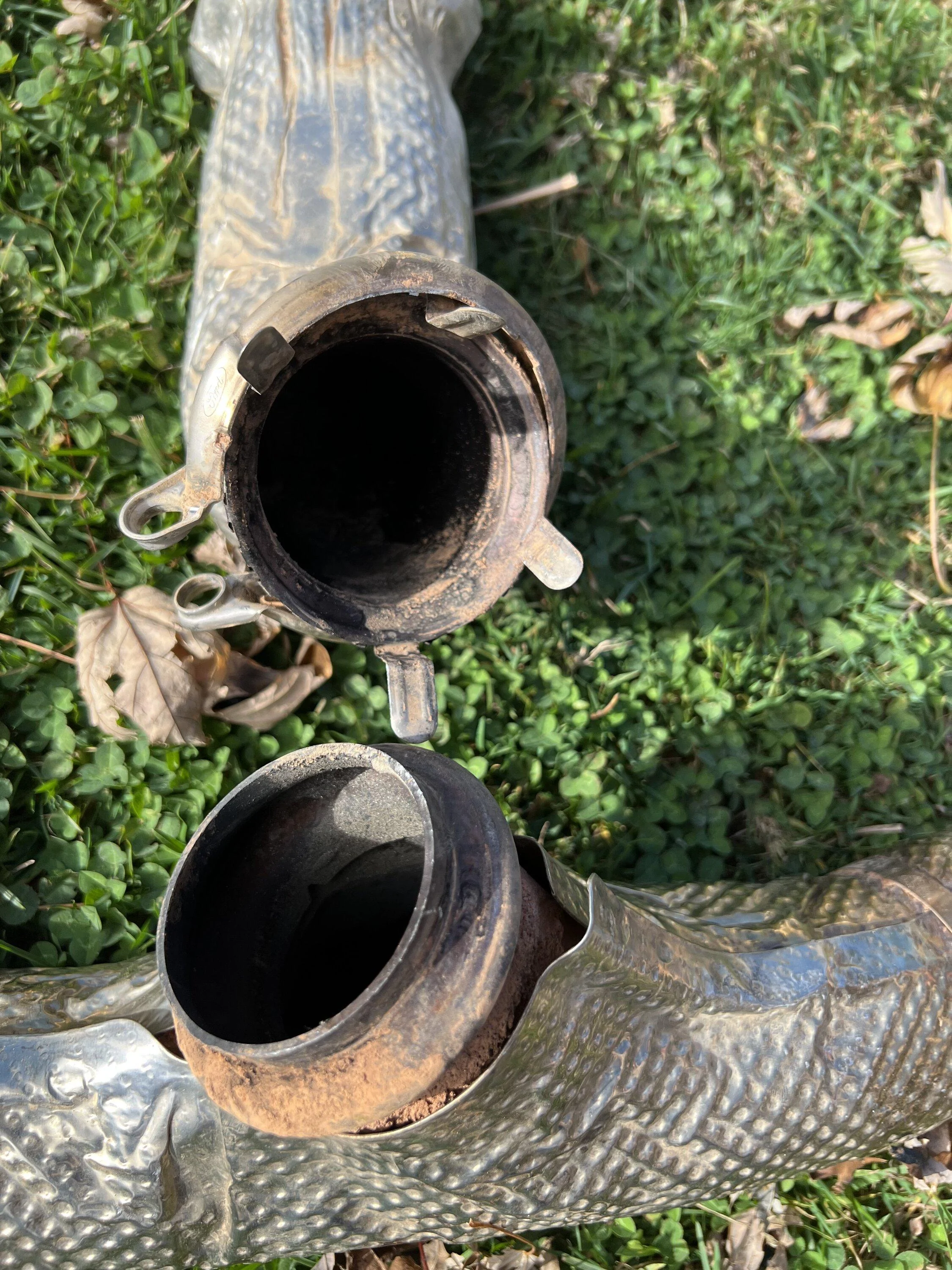

Where the exhaust bolt together in the middle is the next point. Loosen both of those. 15mm. They may be tight and need some spray to help. On the pressed in studs will be some thin metal gaskets. Pry those those off the studs and save them. Easy to remove once that pipe out. Don’t forget. You can barley notice them.
Then we have the mid clamp at the Y. That is a 16mm. Take the goofy nut all the way off, then tap down on the top of it until it starts coming out. You can finish unscrewing it by hand after you get it to move. Clamp has metal tabs around it. Lay those back then pry the clamp off.

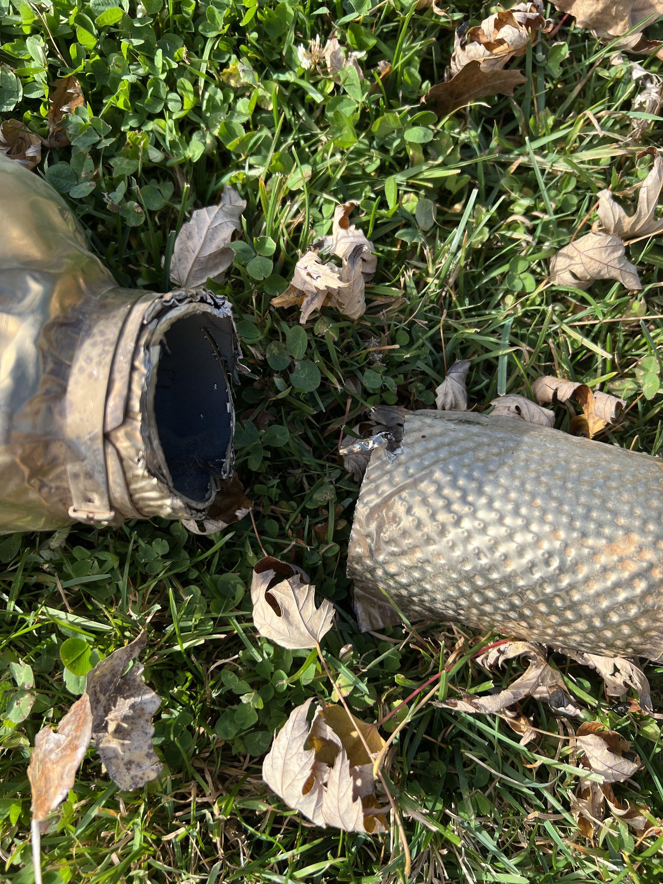

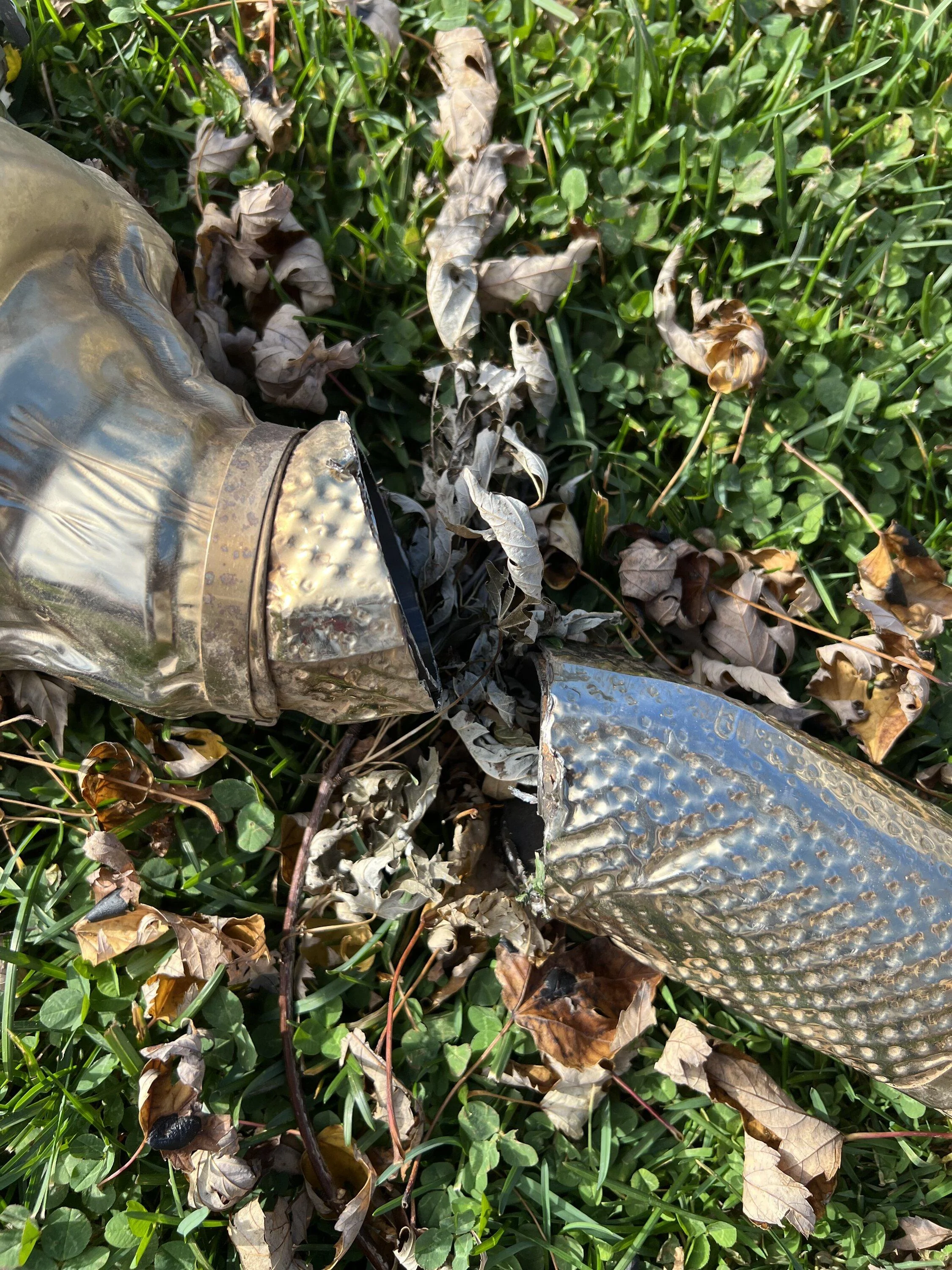

After you’ve successfully have gotten all this loose we’re gonna cut the oem exhaust under the cats. It’s pretty thick. I started with a sawzall but my blades were shot. Ended up using a cordless angle grinder. For the grinder you need to unhook everything so you can manipulate it around as you cut. Grinder went through it like nothing. Make sure to keep your face out of the blades path. I didn’t get any binding, but shit happens. Sawzall you can leave it with the loose bolts to cut. I spent 10 minutes playing Tetris to get it out uncut. Wasn’t happening.
When you separate the pipe from the turbo there is a donut gasket. Be sure it goes back on the turbo. Both sides.
Cut where I did in the picture. Everything will come out after that.

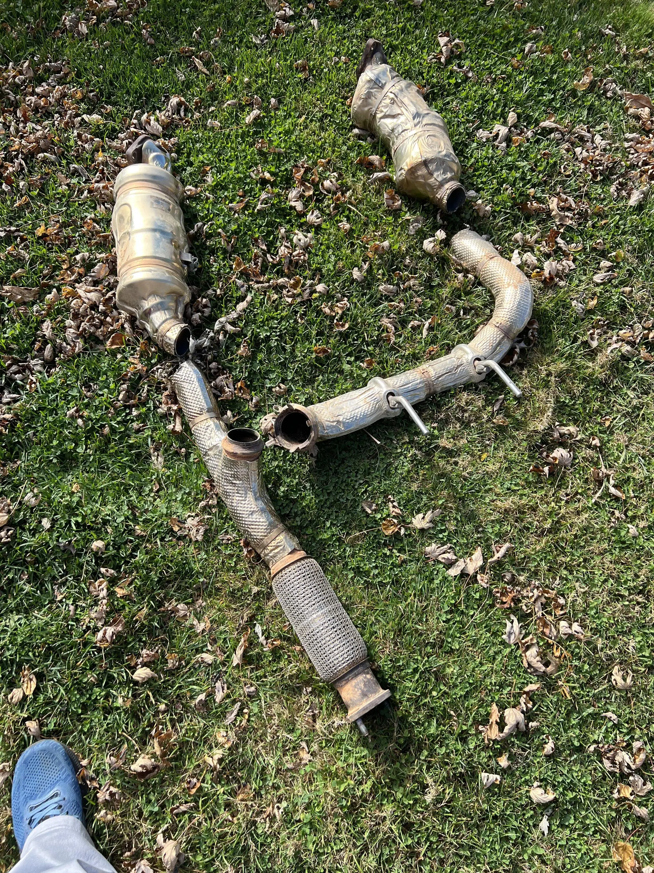

Go ahead and remove all the loose fasteners and pull the oem stuff out. Remember to get the thin gaskets off the studs from the mid pipe. Mine had 3 of them.

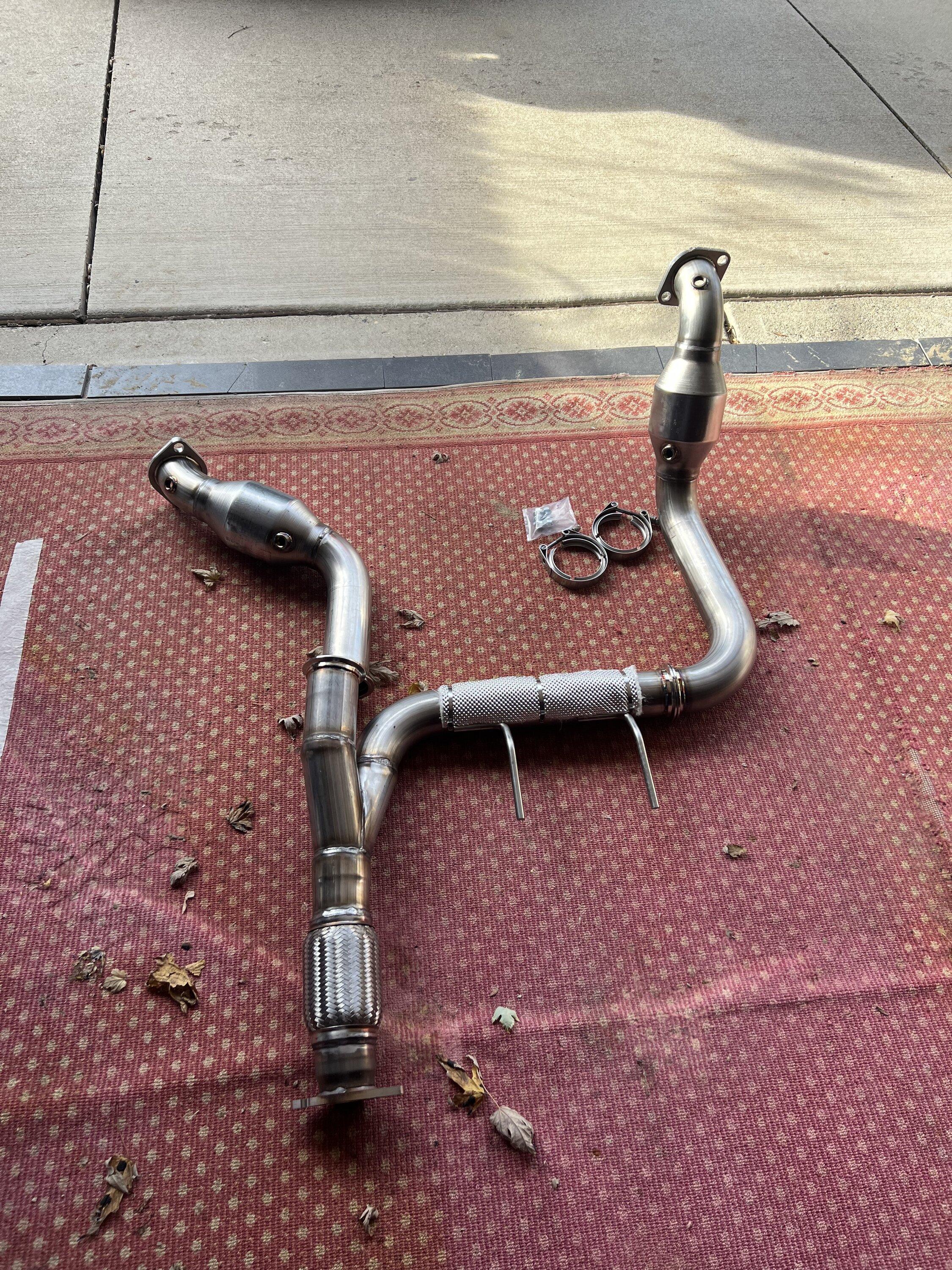

For the install your going to make sure you swapped the blue wire o2 sensors. If you didn’t you’ll remember on the drivers side. Center section goes in first, one with the 2 straight pegs on it. Spray the pegs and the rubber holders with some lube. Shove that all the way back.
Next you can put both cats up in there. Put them on the threads then thread the nuts on by hand leaving some wiggle. Make sure the donuts are back in.
Bolt the center section back the the original exhaust leaving it loose. Make sure to put those gaskets on first. The new bolts it comes with will be 15mm nut with a 17mm bolt
You can pry the pipe you put in with the pegs on it closer to the engine now to make sure the cats fully seat in the flanges.
Then put the 2 new clamps on. Those are 13mm. Make sure they close almost all the way. And make sure they seat. If you can see a gap between the 2 pieces of pipe your not in the hole.
