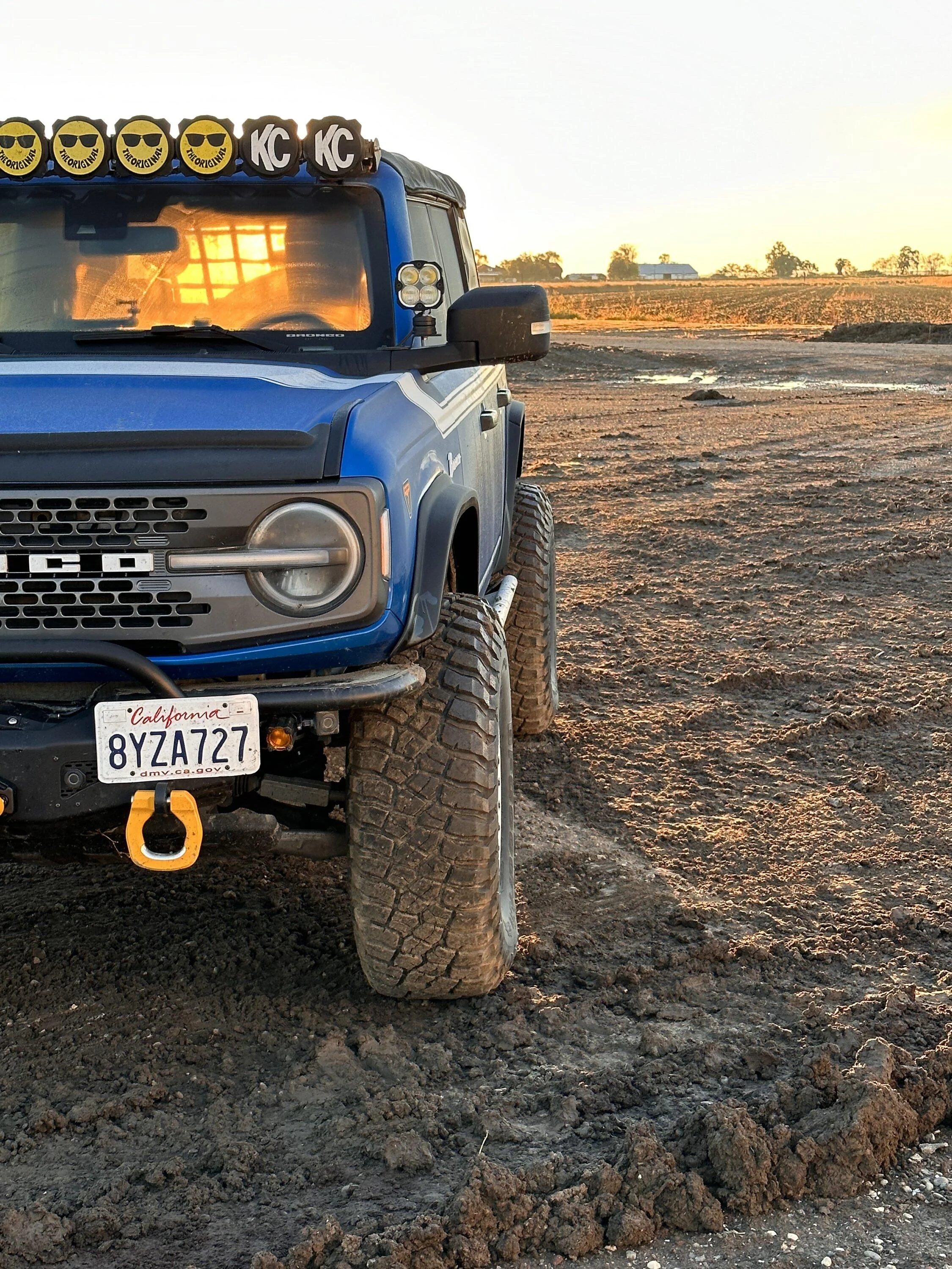

Well here are the day time photos. There’s a couple spots where it lifting where I may add a stronger tape but other than that they look great.
These look good! I still wish they were a touch wider but I’m not sure they’d look right if they were.

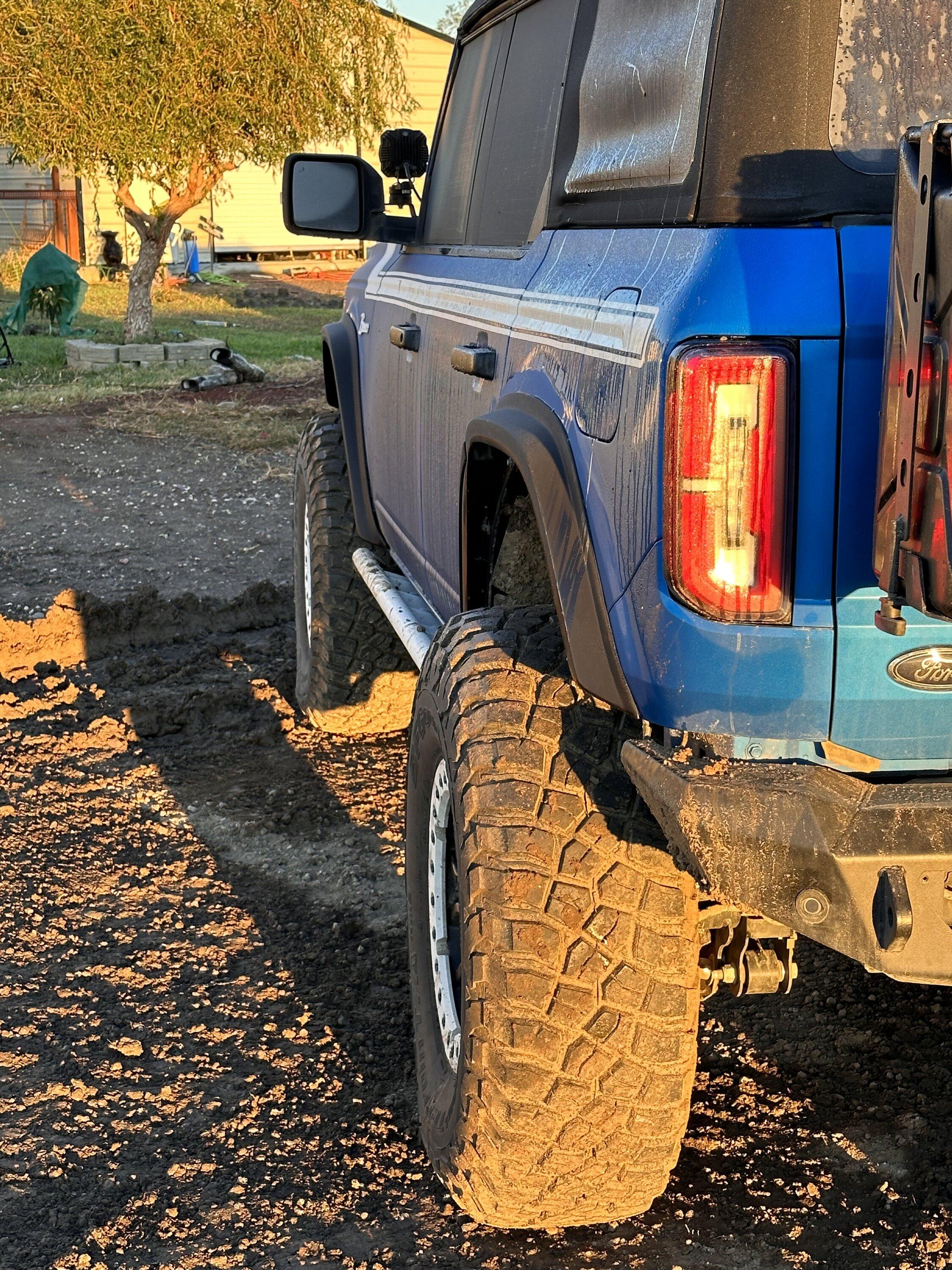

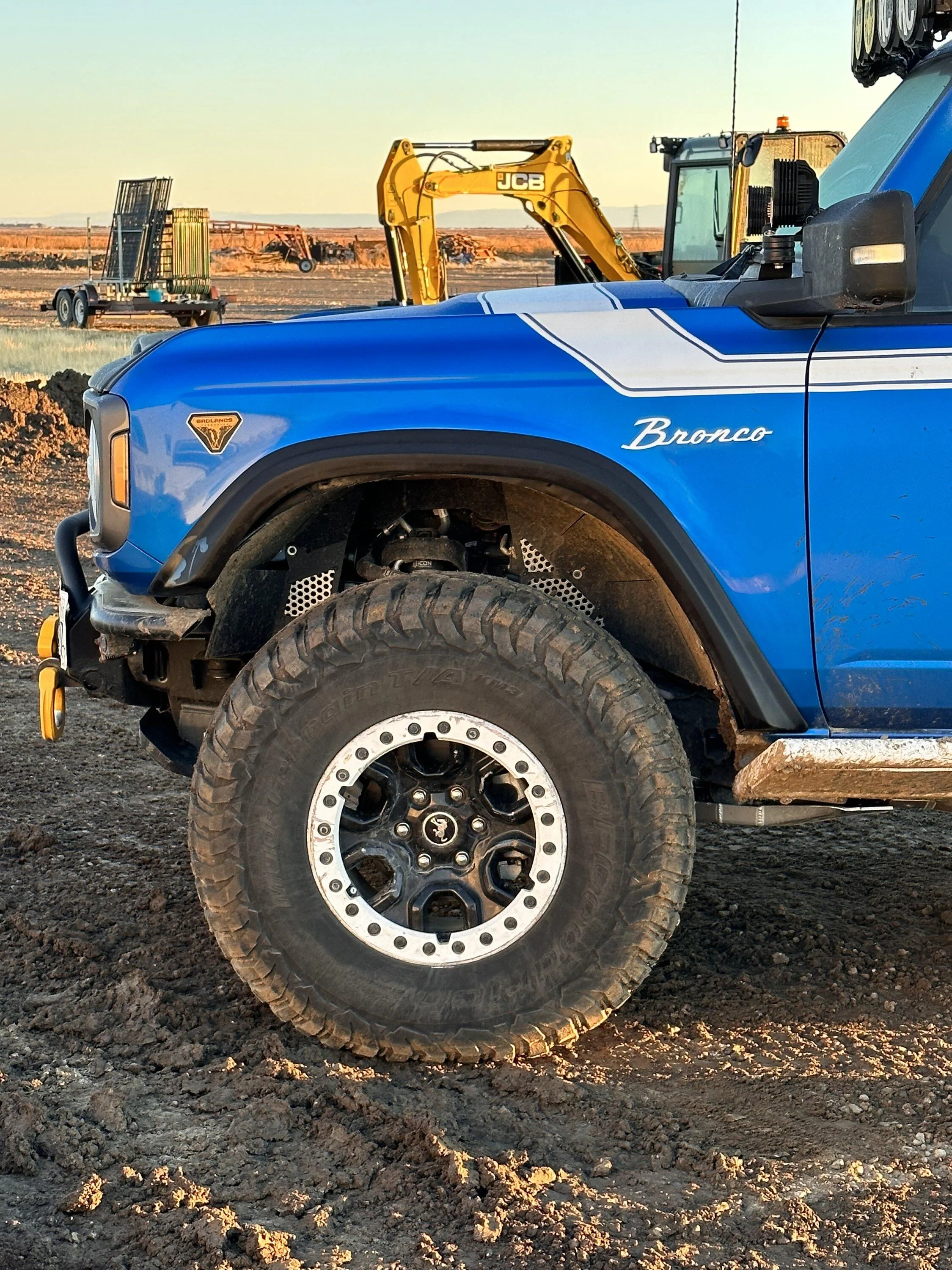

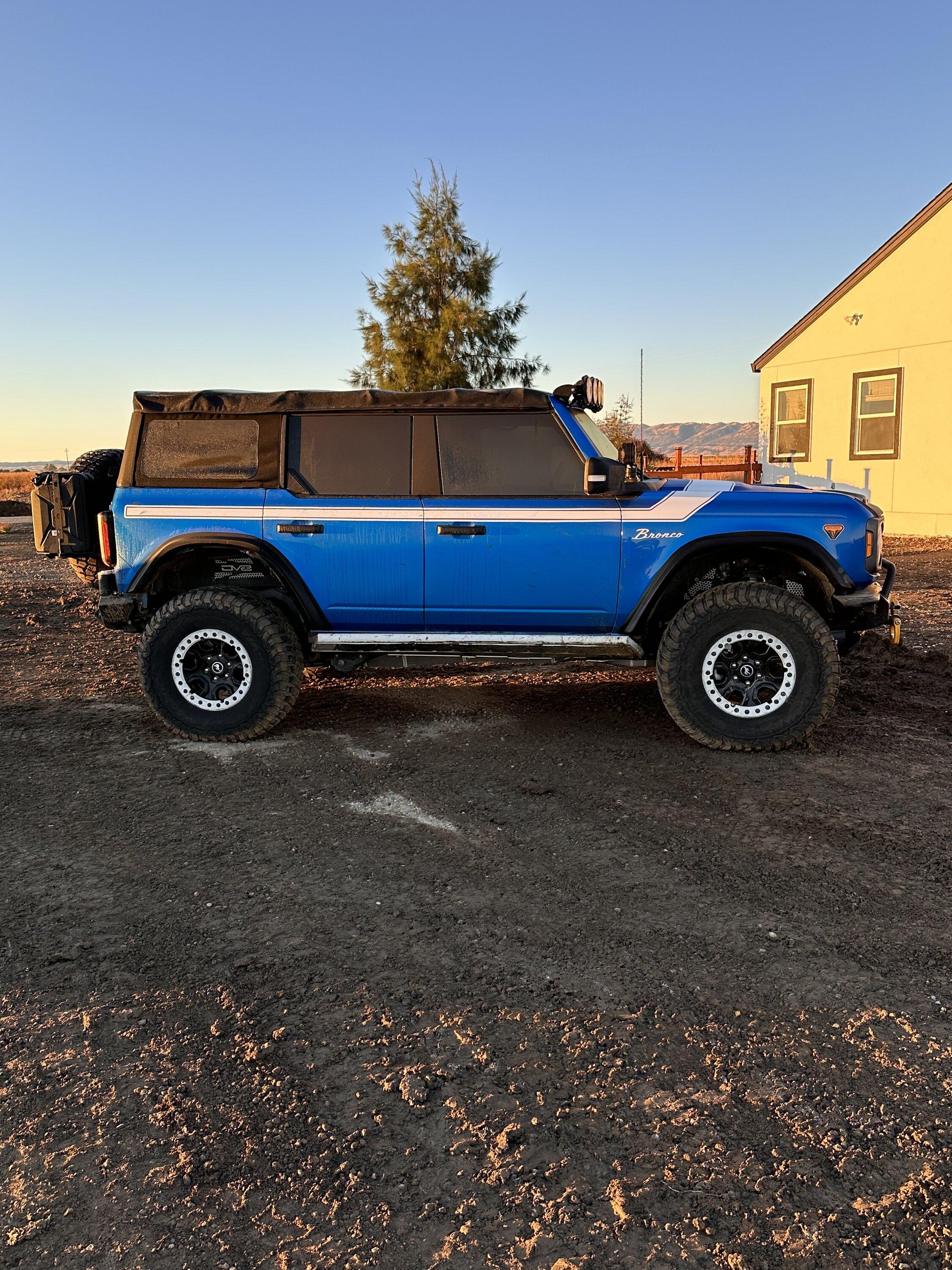

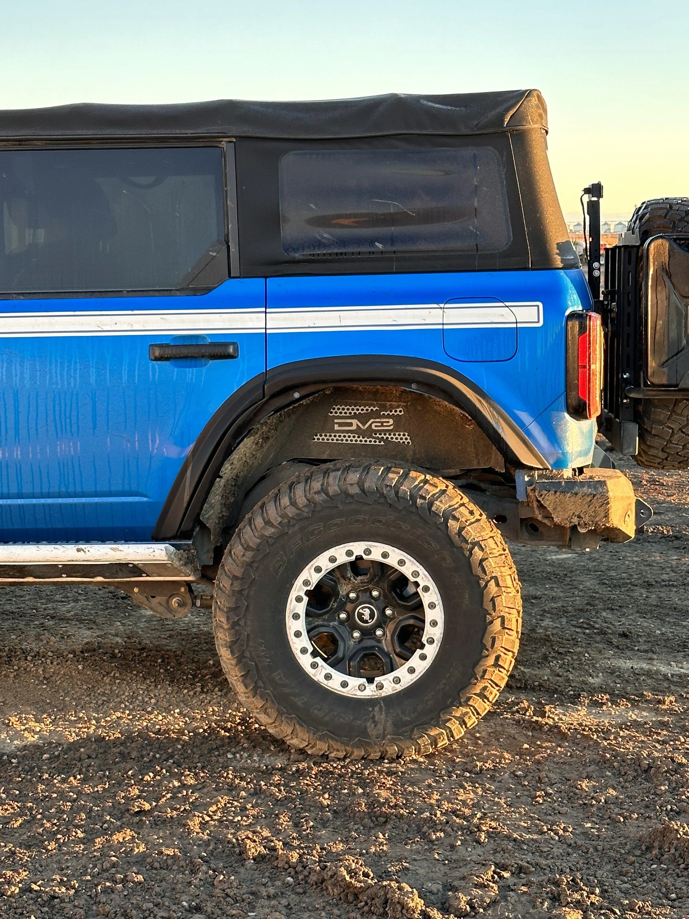

Got my KBD flares installed. I'm happy with the look. I had a bit of a problem installing the tape. Great support from KBD, and I understand they are going to start installing the tape before shipping the fenders so the customer won't have to. Now the important part.

Those look really good. Just wish they would make sasquatch size flares.
