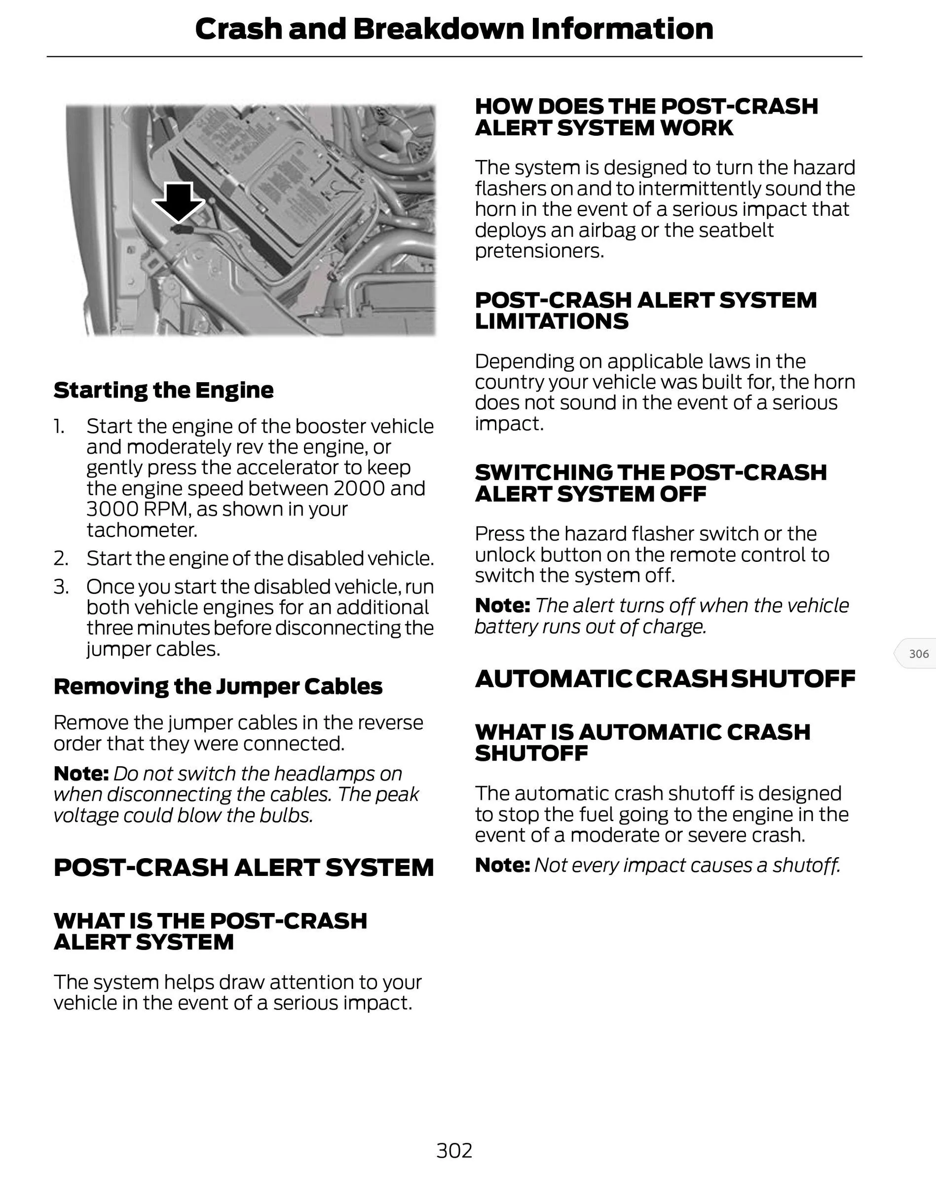

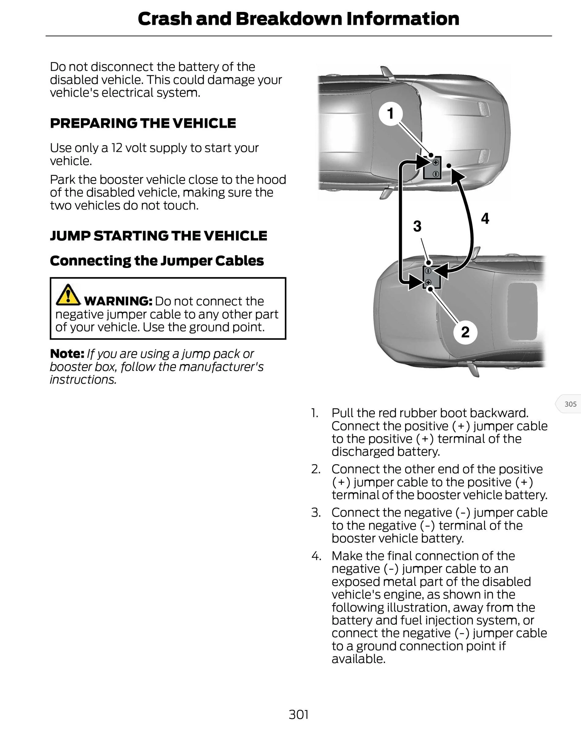

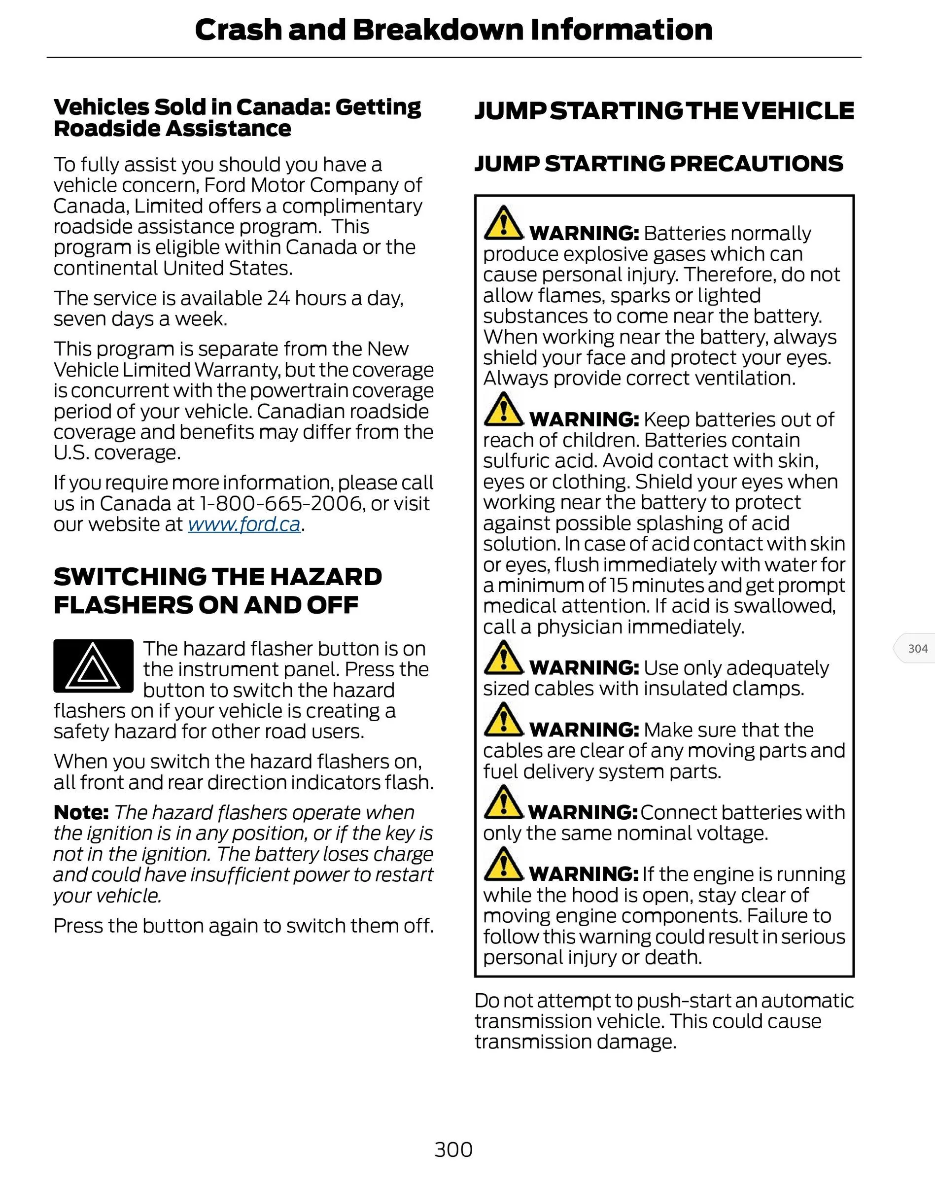

The jump start procedure is covered in pages 300-302 of the Owner’s Manual. Doesn’t seem much different to a keyed vehicle, except you push the button to start. Be careful not to turn on the headlights when disconnecting the jumper cables, though, because the peak voltage could blow the bulbs.
