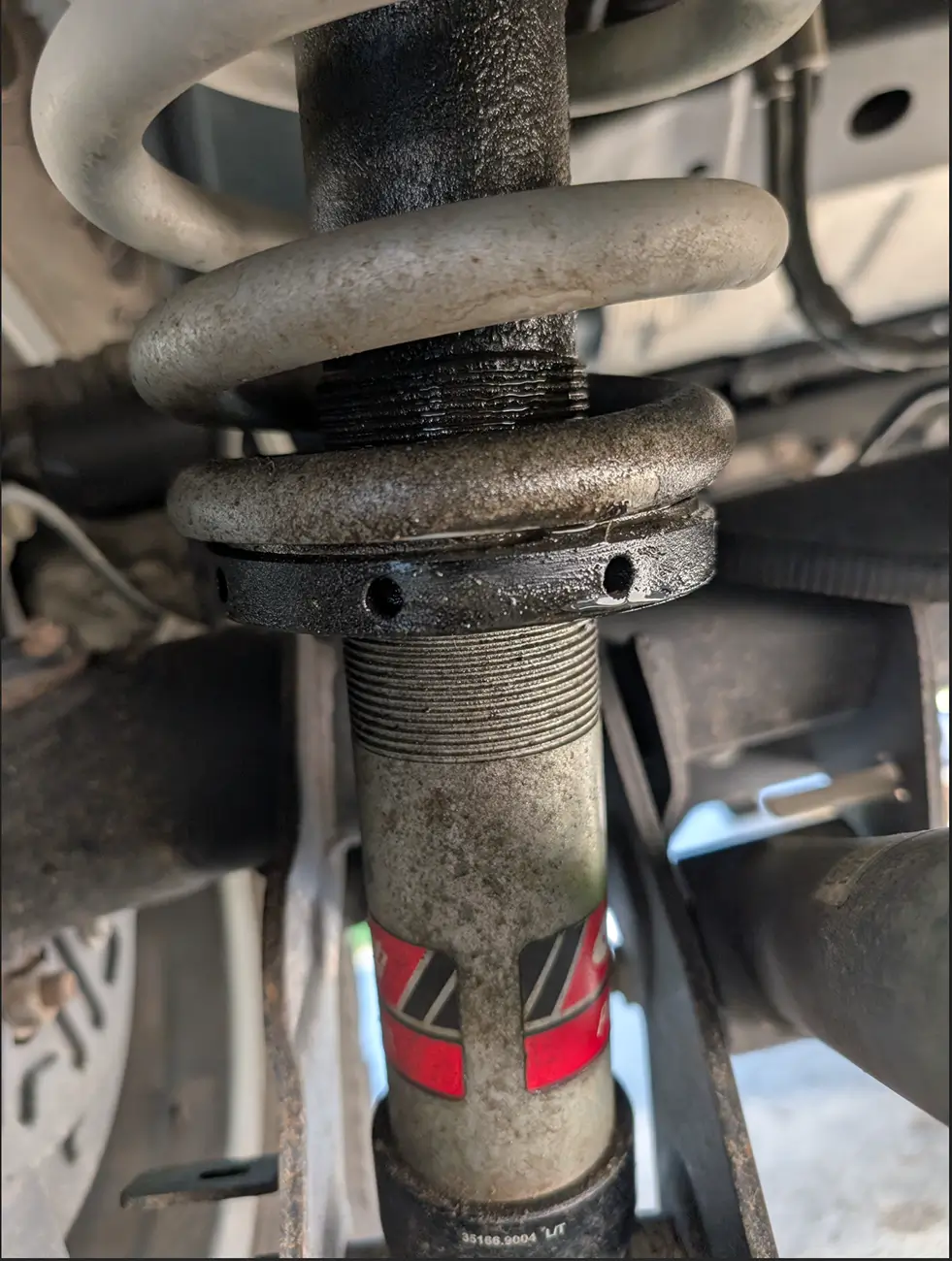

Is this normal? Eibach rear struts oil buildup

Compressing the springs will be much easier if you can get three compressors on there vs. just two. IMO it would be much easier to pull them off the truck to swap springs.
My intention is to compress the springs with it on the truck, and then pull the whole coilover off the truck to actually replace the spring. Then the spring will already be compressed and I don't need to crank down on the spring compressors 1 by 1. I definitely intend on using 3 compressors as just using 2 sketches me out lol.

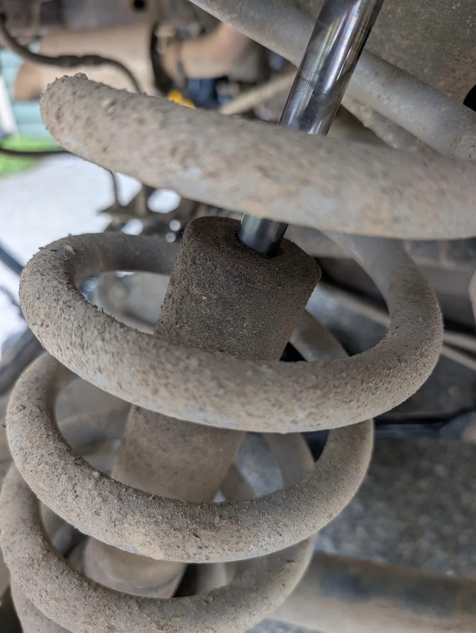

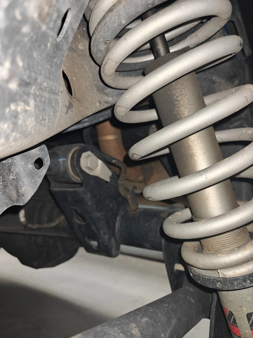

Jazer
Jessica
Jun 20, 2021
2,771
8,244
2.7 OBX
My rears have some but not quite to this extent. I was hoping it was just road grime 😬
Getting a lil concerned.

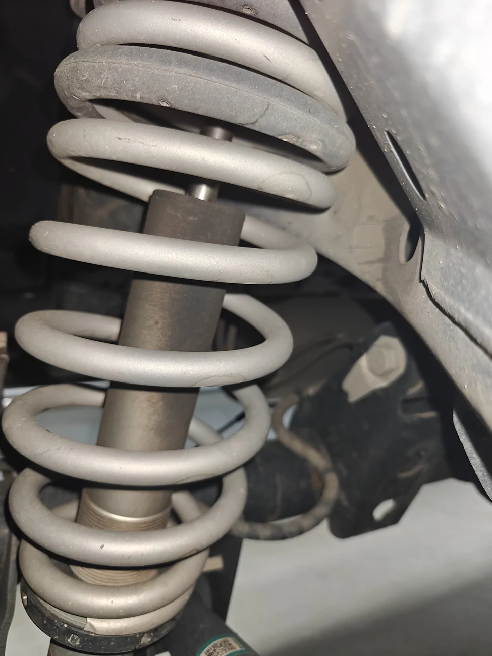

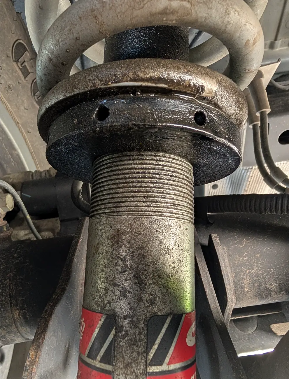

Koss_co
Everglades
Nov 4, 2024
69
74
2024 Bronco, 2022 F-150
Everglades
Well. Add my Bronco to the list of Eibachs with blown rears. Haven't even taken off road yet. Working with Panda and Eibach on warranty. Just installed past October.
