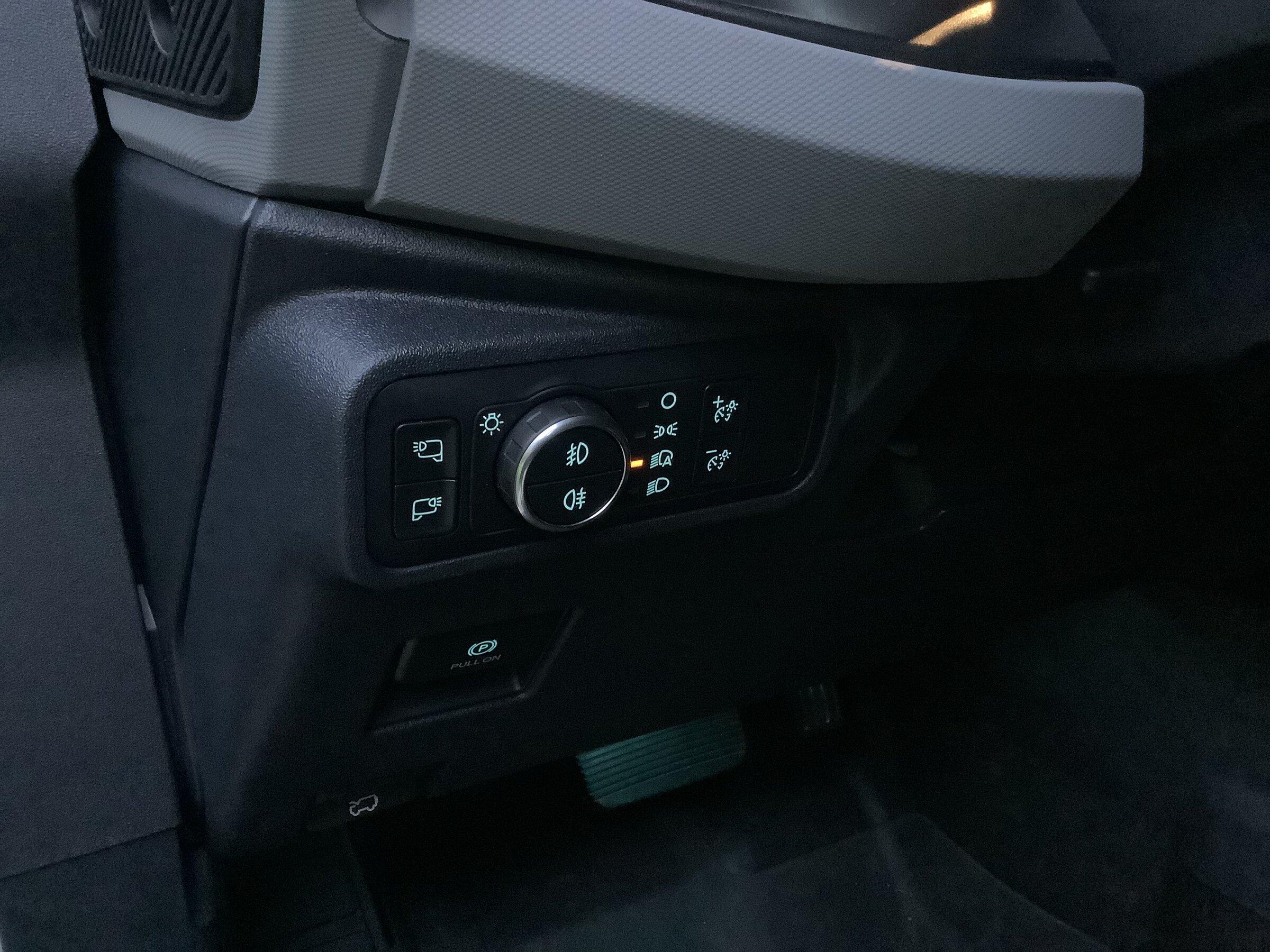

Couldn’t find any rear factory fog light threads, so here goes…anyone wire up rear fog/chase lights using the factory switch and harness?
Hoping for a tutorial or maybe some confirmation this works and where the harness to connect this to is located without having to trace and be the test dummy 😋
Special thanks to @flip and @drew707 for their efforts in confirming parts and their insight thus far!
Harness and switch pictured below.
The front fog light harness I know is already installed from factory, but the rear fog light harness is not installed from factory and you have to order it, correct?

Yes, This is Correct

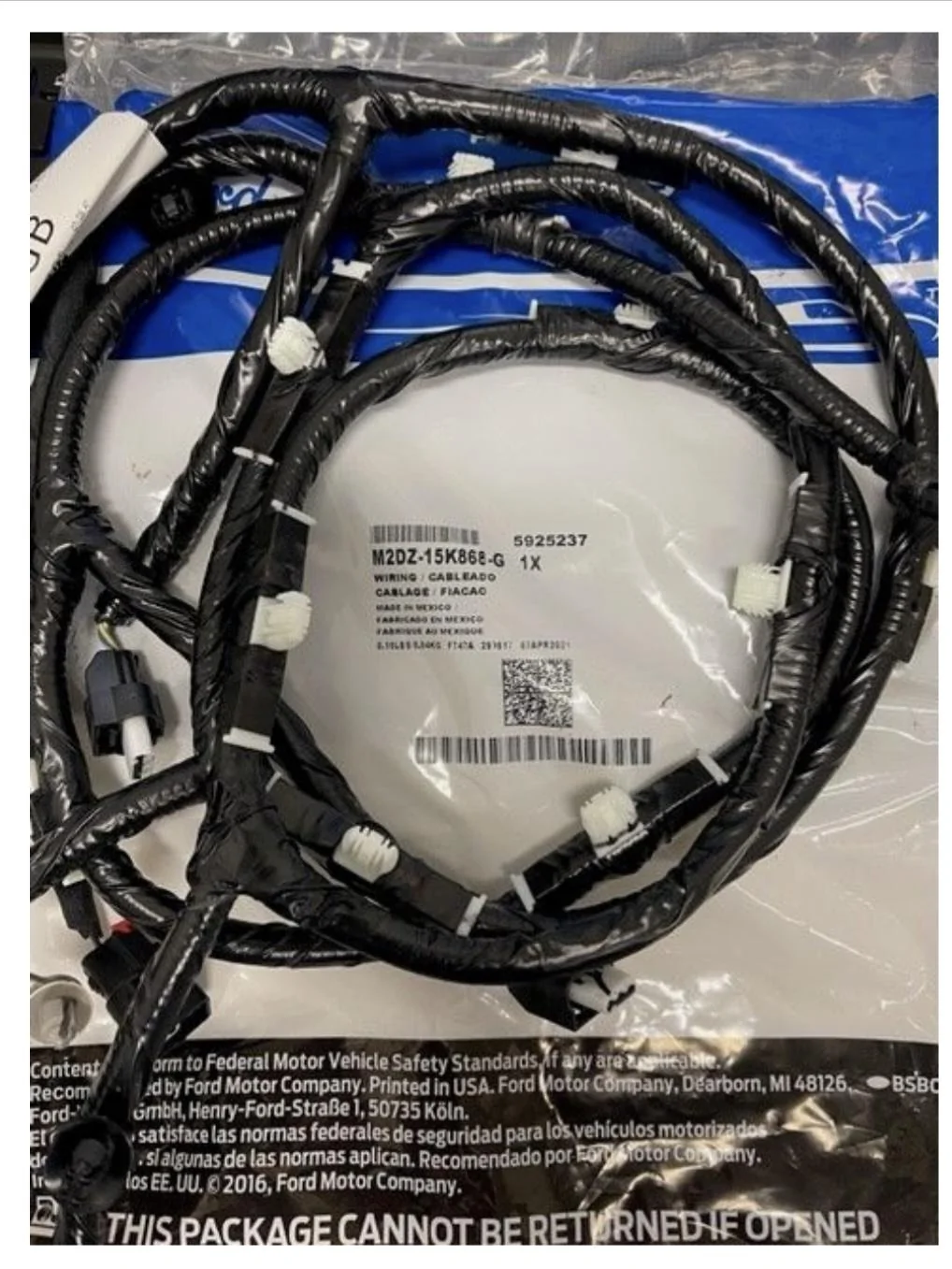

......the body harness to the rear is wired (at least on mine it is) to connector C424.
I suppose one could add a pin to the bumper harness that comes from the factory
with terminal EU2Z-14421-BA. and use the shared ground with the license plate light. Driver side bumper connector.
The blu/wht Wire is in the body harness all the way to the rear DS corner of the vehicle at which point it ends in the connector (C424). you can tap into it there Or you can add the G Harness which extends the BLU/wht wire to the middle of the rear bumper (C436).
So the real thing is where are you picking up the wire. I see three methods:
1: Tap into the body harness at the DS rear Corner (Before C424)
2: Add a terminal to the existing harness/connector (At C424)
3: Add G harness and tap/splice into the bumper Harness (Before C436)

Ford Bronco Installing Rear Fog/Chase Light Using Factory Switch & Harness 4BAC4E41-9DB3-4CB5-A7D3-AA8CD2AED70D
Just got these delivered from Tasca. Switch, fog light insert and rear wiring. Only have to order the bumper. It was back ordered. Ford dealer sells it at Msrp 704.72 excl. tax. Is that a fair price or should I shop around? They are offered cheaper but shipping is high.
