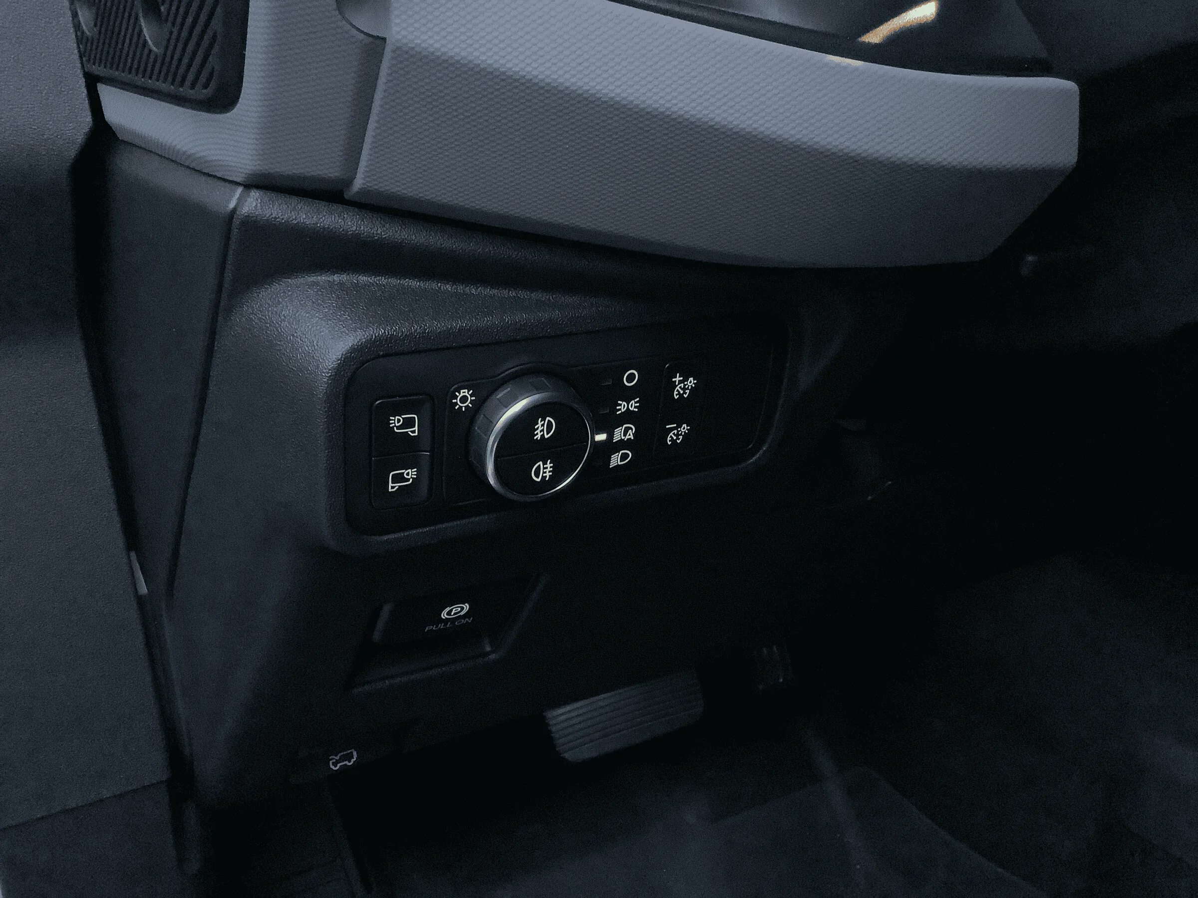

Can I get the part number for this headlight switch?

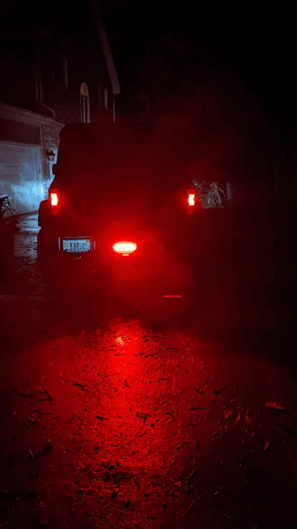

I did my rear fog install today. I installed the factory Rear Fog Harness (M2DZ-15K868-G*) in the bumper. I also installed the Front/Rear fog switch (M2DZ-11654-CB) in the dash.
To connect to the rear circuit I crimped on a 2 pin Deutsch connector and built a harness to distribute to the lights.
I used the low power circuit (R/W wire on rigid Harness) for the Fogs with plans to connect brake lights to the high power (Red wire on Rigid Harness) for now I just stubbed it out, but I would change the Deutsch to a 3 pin if/when I do it.
Ran my custom harness along the factory harness to both sides of the bumper.
Links to all parts:
https://parts.ford.com/shop/en/us/parking-distance-aid-sensor-wire-14758343-1?pdp=y
https://parts.ford.com/shop/en/us/headlamp-switch-14868567-1?pdp=y
https://www.rigidindustries.com/sr-q-series-diffused-rear-facing-high-low-sm-red-set-of-2-90163.html
https://www.4x4truckleds.com/kr-off...ount-light-for-ditch-light-a-pillar-brackets/
https://www.deutschconnectorstore.com/deutsch-dt-series-connector-kits.html
M2DZ-11654-CC
Only works with High and Lux. Ordered today and shipped already.​
