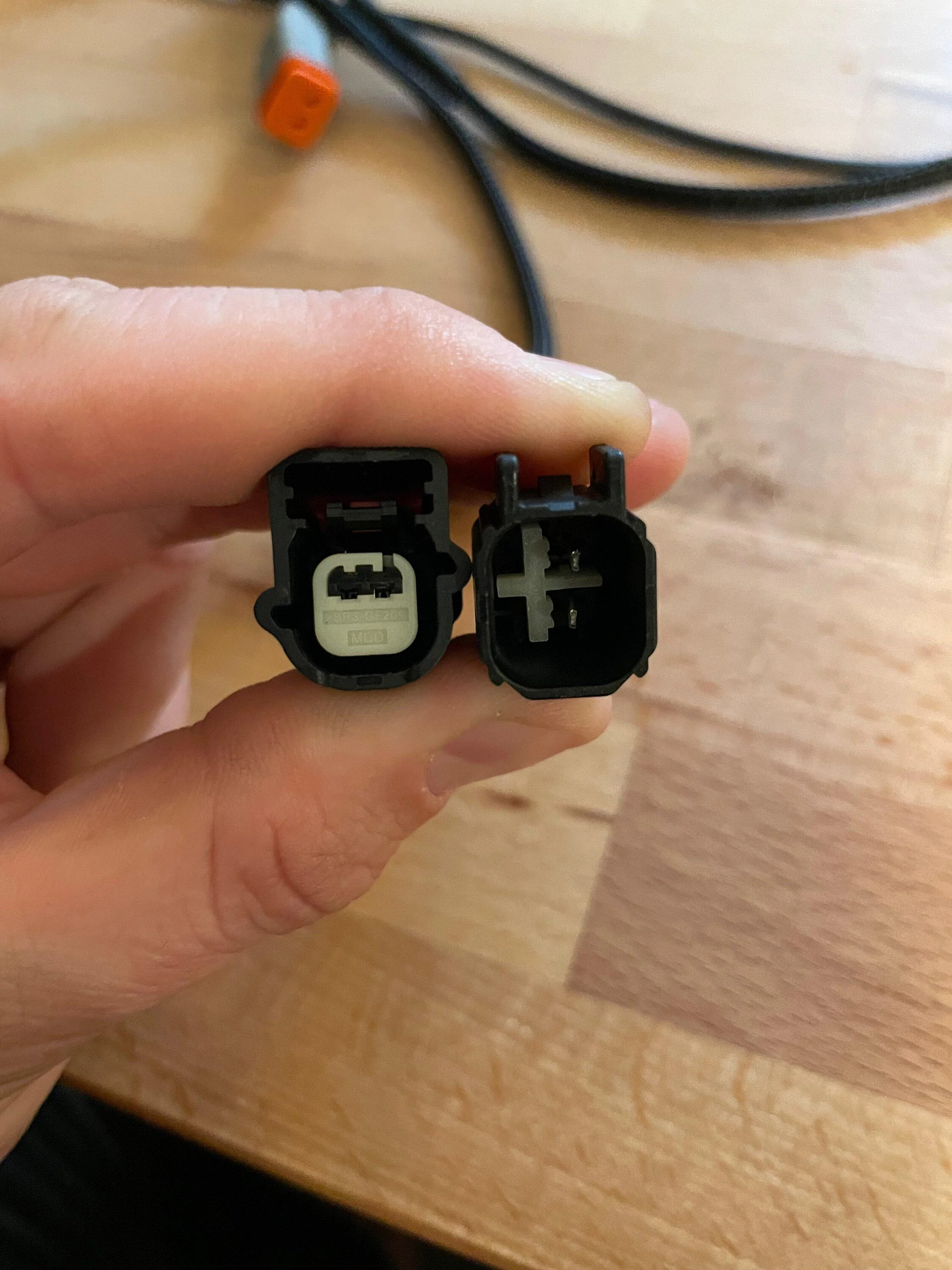

These do not work
I purchased these from my front fogs and tried the connector is not the same.
I would be willing to send the connector I cut off to someone who makes harnesses to help find a correct one though.
Send me the connector.

Just put a note in the package with your user name on here. If we have a harness already made (because we have other harnesses for Fords) we'll send you one free. If I have the connectors in stock (because we also stock misc. connectors) Il'l make you a free pigtail

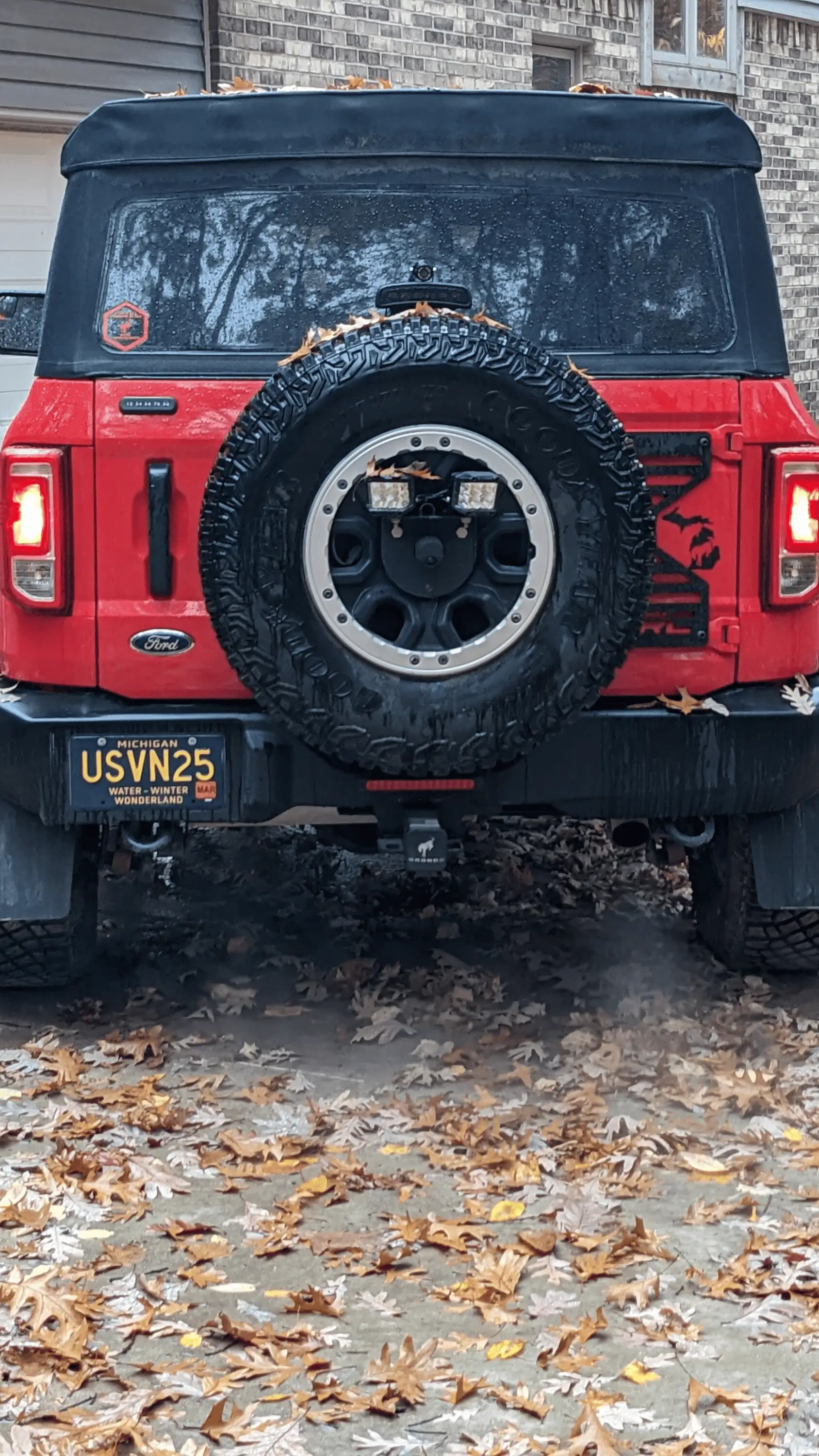

I did my rear fog install today. I installed the factory Rear Fog Harness (M2DZ-15K868-G*) in the bumper. I also installed the Front/Rear fog switch (M2DZ-11654-CB) in the dash.
Ford Bronco Installing Rear Fog/Chase Light Using Factory Switch & Harness IMG_2322
To connect to the rear circuit I crimped on a 2 pin Deutsch connector and built a harness to distribute to the lights.
Ford Bronco Installing Rear Fog/Chase Light Using Factory Switch & Harness IMG_2318
I used the low power circuit (R/W wire on rigid Harness) for the Fogs with plans to connect brake lights to the high power (Red wire on Rigid Harness) for now I just stubbed it out, but I would change the Deutsch to a 3 pin if/when I do it.
Ran my custom harness along the factory harness to both sides of the bumper.
Ford Bronco Installing Rear Fog/Chase Light Using Factory Switch & Harness IMG_2319
Ford Bronco Installing Rear Fog/Chase Light Using Factory Switch & Harness IMG_2320

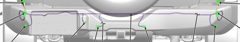

as for the harness it replaces the factory harness for the bumper (not the tail light). the body harness to the rear is wired (at least on mine it is) to connector C424.
Ford Bronco Installing Rear Fog/Chase Light Using Factory Switch & Harness 1665577509538
I suppose one could add a pin to the bumper harness that comes from the factory
with terminal EU2Z-14421-BA. and use the shared ground with the license plate light. Driver side bumper connector.
Ford Bronco Installing Rear Fog/Chase Light Using Factory Switch & Harness 1665577267242
Ford Bronco Installing Rear Fog/Chase Light Using Factory Switch & Harness 1665577277180
Ford Bronco Installing Rear Fog/Chase Light Using Factory Switch & Harness 1665576938335
