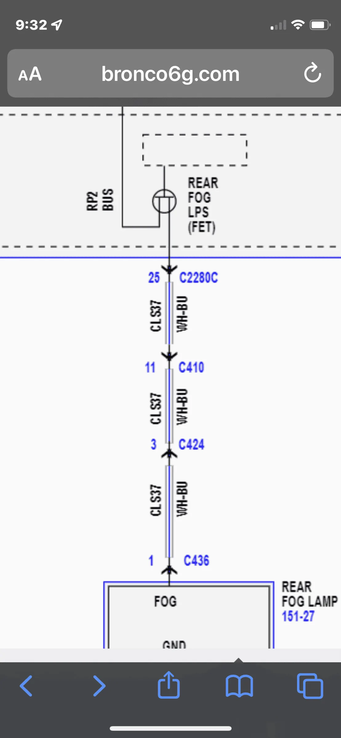

I’ve hook my ditch lights up to the rear fog light switch since I don’t have six switches. You have to change things in forscan to enable them. It’s a white/blue wire that runs down the driver side sill plate. One plus is with the factory switch you get an icon on the dash reminding you it’s on.
I enabled the front fogs, so figured the rear would have to also be enabled.
So if I tap into the blue/white, no harness needed…decisions, decisions. Thanks for your insight!

I haven’t added lights in the back yet, but this is what I plan on doing. I don’t see a reason to buy or use a whole new harness.

So, the G version of the harness (there are many different letter versions that I found) has the parking sensor connectors for Lux pack, plus the rear fog connector? Assuming that I already have the front/rear fog-enabled switch installed, is all the other wiring between the dash and rear end already present (21 4dr FE)? Already done the Forscan to enable all the fogs, and I have the front fogs wired to a set of Baja modules in the Mod bumper. All good except the rear fogs and I am planning to use a set of Rigid SR-Qs mounted to the bottom of the bumper.
Yes, that is my understanding. If going the harness route, you'd just need to swap out to the G harness. The caveat is there is likely one factory connector (for the one factory fog light w/red cover) that would need to be tapped and that likely is capped off like the fronts. You could splice the two lights together and then pin the supplied connector (most likely).

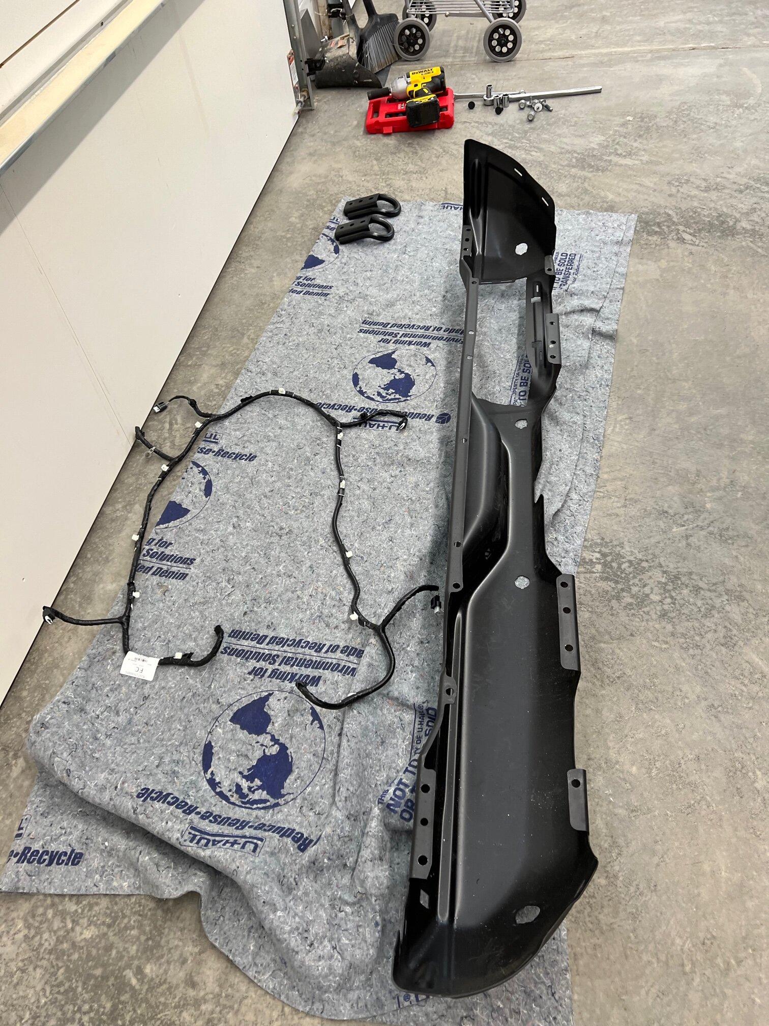

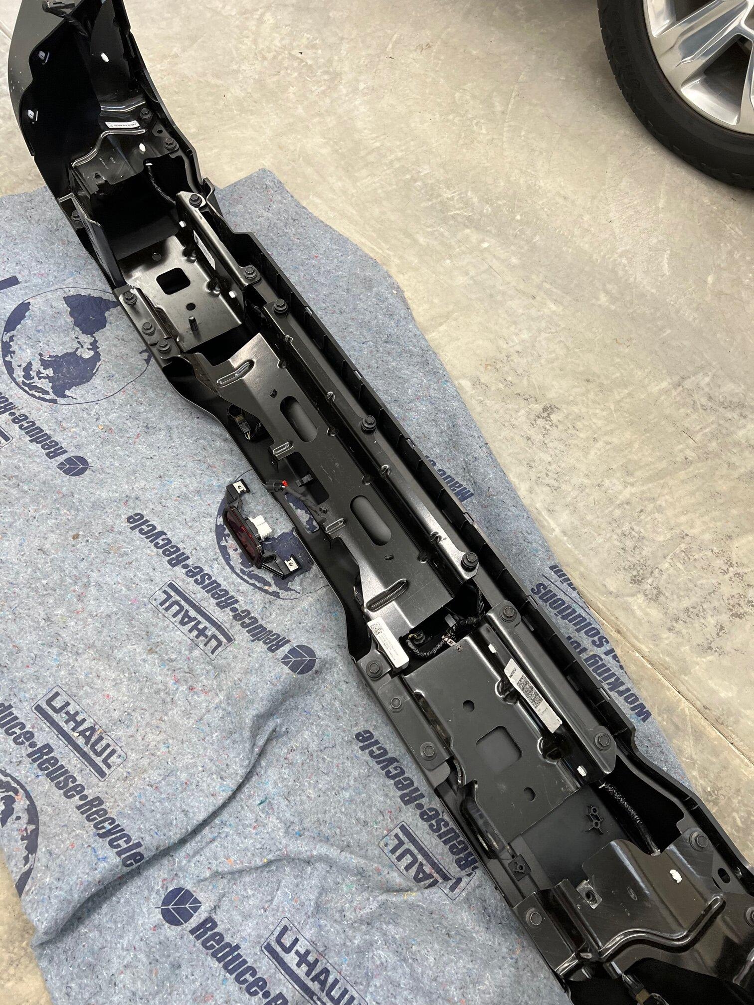

I spent significant time today disassembling a used metal rear bumper with sensors "without a rear fog light" to move everything over to a newly purchased "for rear fog light " bumper shell that utilizes the OEM rear fog light. The toughest part was removing the bumper cover that has a
" bazillion" clips/ tabs to squeeze in to remove said cover. The big surprise was finding a 40mm Torx bolt on each end hidden under the cover , that retains the end caps. The cover has to come off before you can access the bolts. IE; no slipping off these end caps and adding them back. I managed to successfully remove the cover , although I was at one point tempted to take a multi tool and just cut all those tabs off. It became more of a challenge to see if I could actually do it ??? vs waiting on a part. It is almost back together using a new harness and just need to run out to the Dealer in the morning for 2 mounting screws. I always enjoy these one day projects that aren't needed to get me up and running for work. I remember hating having to have something done in order to be back on the road. A water pump or brakes both come to mind ....or even worse a clutch and pressure plate . I am so, so glad those days are behind me. The pictures below are the 4 hours of slowly moving , nothing damaged, no pressure....JUST plain ole fun! I have a perfect rear bumper metal shell and deluxe harness if anyone is in need.

Just
" bazillion" clips/ tabs to squeeze in to remove said cover. The big surprise was finding a 40mm Torx bolt on each end hidden under the cover , that retains the end caps. The cover has to come off before you can access the bolts. IE; no slipping of these end caps and adding them back. I managed to successfully remove the cover , although I was at one point tempted to take a multi tool and just cut all those tabs off. It became more of a challenge to see if I could actually do it ???vs waiting on a part. it is almost back together using a new harness and just need to run out to the Dealer in the morning for 2 mounting screws. I always enjoy these one day projects that aren't needed to get me up and running for work. I remember hating having to have something done in order to be back on the road. A water pump or brakes both come to mind ....or even worse a clutch and pressure plate . I am so, so glad those days are behind me. The pictures below are the 4 hours of slowly moving , nothing damaged, no pressure....JUST plain ole fun! I have a perfect rear bumper metal shell and deluxe harness if anyone is in need.

the bumper no plastics? I’d have to price out how much all that would run. Be nice to get rid of the plastic we have.
It’s too much money to build the whole assembly from pieces as there are 5 inner large metal plates as well. The shell would be great for someone that’s damaged theirs and needs a replacement. I started down the path of adding up all the piece parts cost and it was more than made sense.
