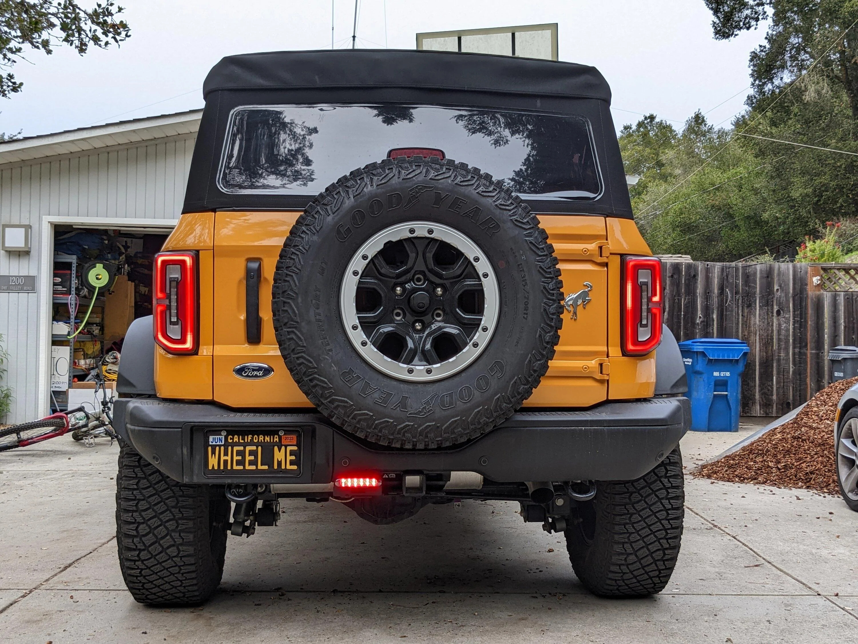

Finally got it done - one rear fog light installed. I tapped the blue/white wire inside the rear bumper, and grounded it to a nearby bumper bolt. The fog light is an older model made by PIAA - I used it new on my 2005 Subie then, and it still works great today.
FORSCAN configs were:
BdyCM - Rear Fog Light - Enabled
IPC - Rear Fog Light - Enabled
I had already enabled the fog light switch earlier on when I installed the front fogs.
