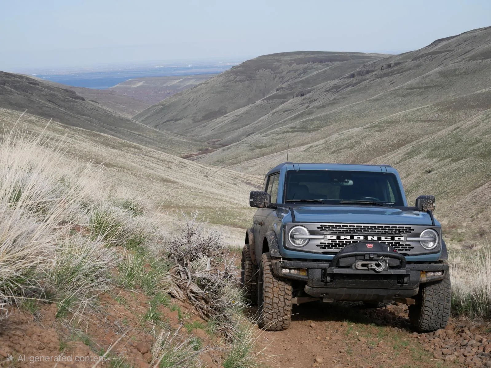

Bronc6g22
Jake
Jul 27, 2022
427
686
Washington
Mazda 6, Tacoma TRDOR
Plenty of options for relocating camera and sensors. It's very DIY if you are at all inclined. I used Mountains2Metal camera bracket and MetalCloak sensor bezels.
Ford Bronco Installing a Winch Mounting Kit when it comes to the Frame Flanges, strength wise. image000000 (3)(1)
