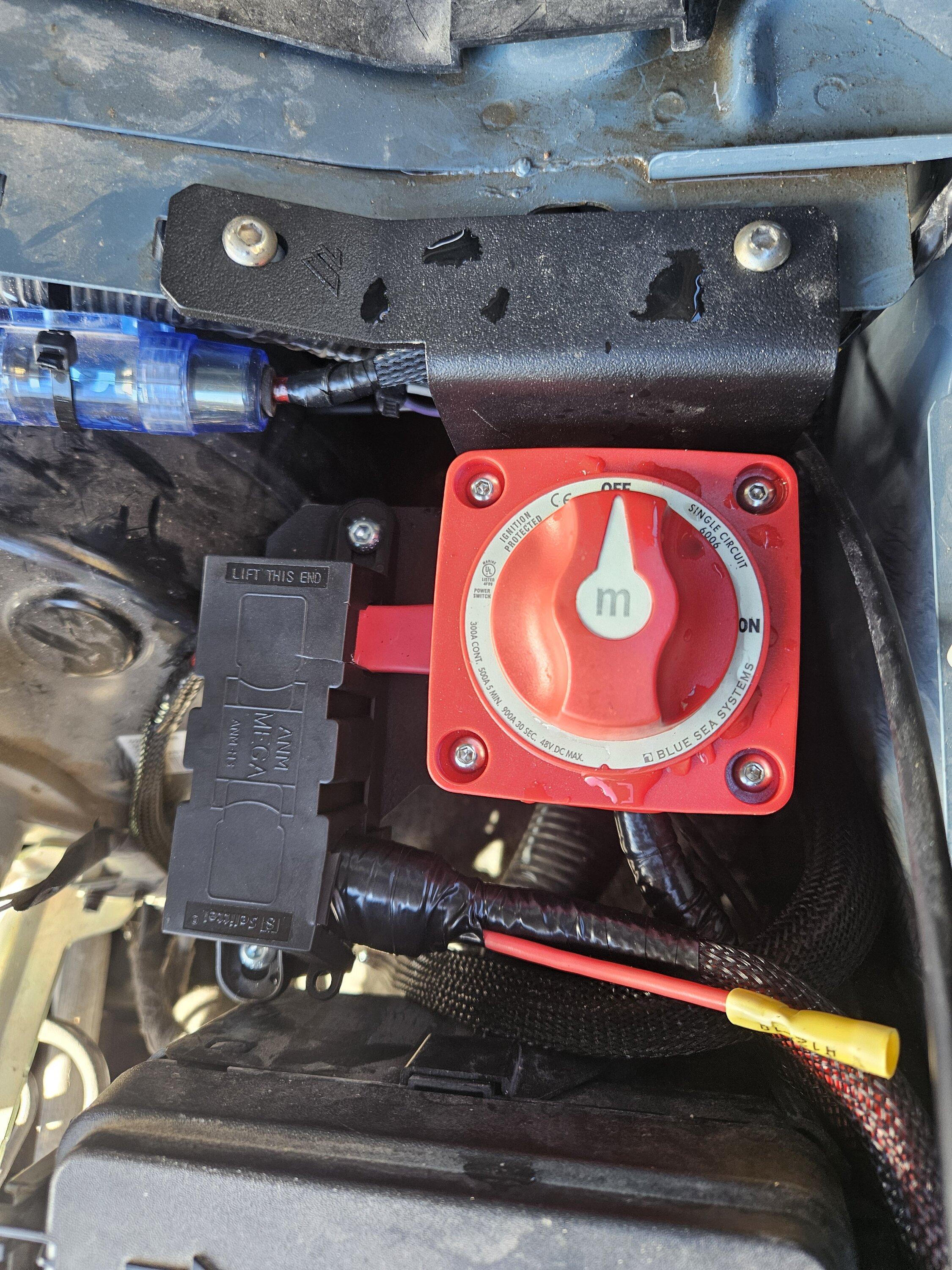

I did the belt and suspenders method on mine, switch and disconnect. The bonus is my jumper cables hook into the quick disconnect. Flaming River makes good switches.

Sorry I must have scrolled right by that. My bad. Question? Why both a disconnect and switch? Meaning to a dip sh!t like me is there benefits to having both. Also I am thinking disconnect in the winch side of the switch so I can easily remove the winch if necessary.
I did a switch and disconnect because my jumper cables are set up with the connector already so they just plug in. I leave the connector hooked up for daily driving but flip the switch off. Just a preference I guess.
