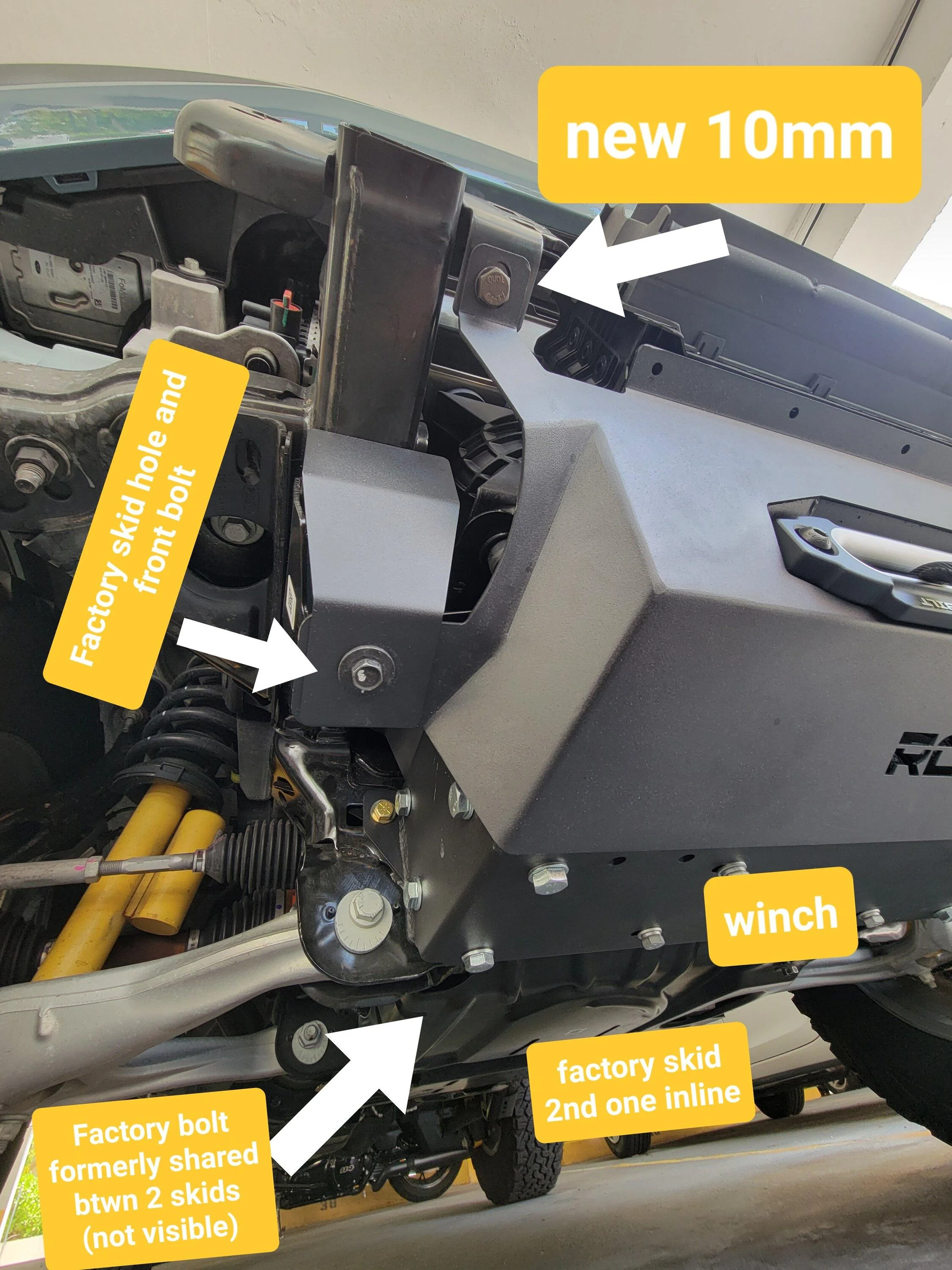

But you don't have a metal bash plate that can even mount a winch or the fairlead. The RC is two pieces underneath; the winch cradle mount and then the fairlead skid forward of that.
I used a cordless reciprocating saw with the Torch 9" blade by Milwaukee--good blade made easy work. Just cut the lower 3 sides of each and wiggle up and down to break the top side.
Once off, it is pretty clear they serve no functional purpose.
I’ve actually seen folks use their shelf and cut a hole for the fairlead. But I doubt id do that.
Squatch
5,224
21,178
Not sure how that'd work. The winch cradle is aft of the RC skid plate and it takes both to make up the coverage of the stock Badlands plate. The fairlead would be angled down or they'd have to beat it up to avoid that... seems like a ridiculous hassle.
Stock (2-Section):
__.___>
oil . bash
RC (3-Section):
__.__._/
oil .winch cradle.fairlead bash
Maybe I'm missing something but I'll see if I have a pic from underneath.

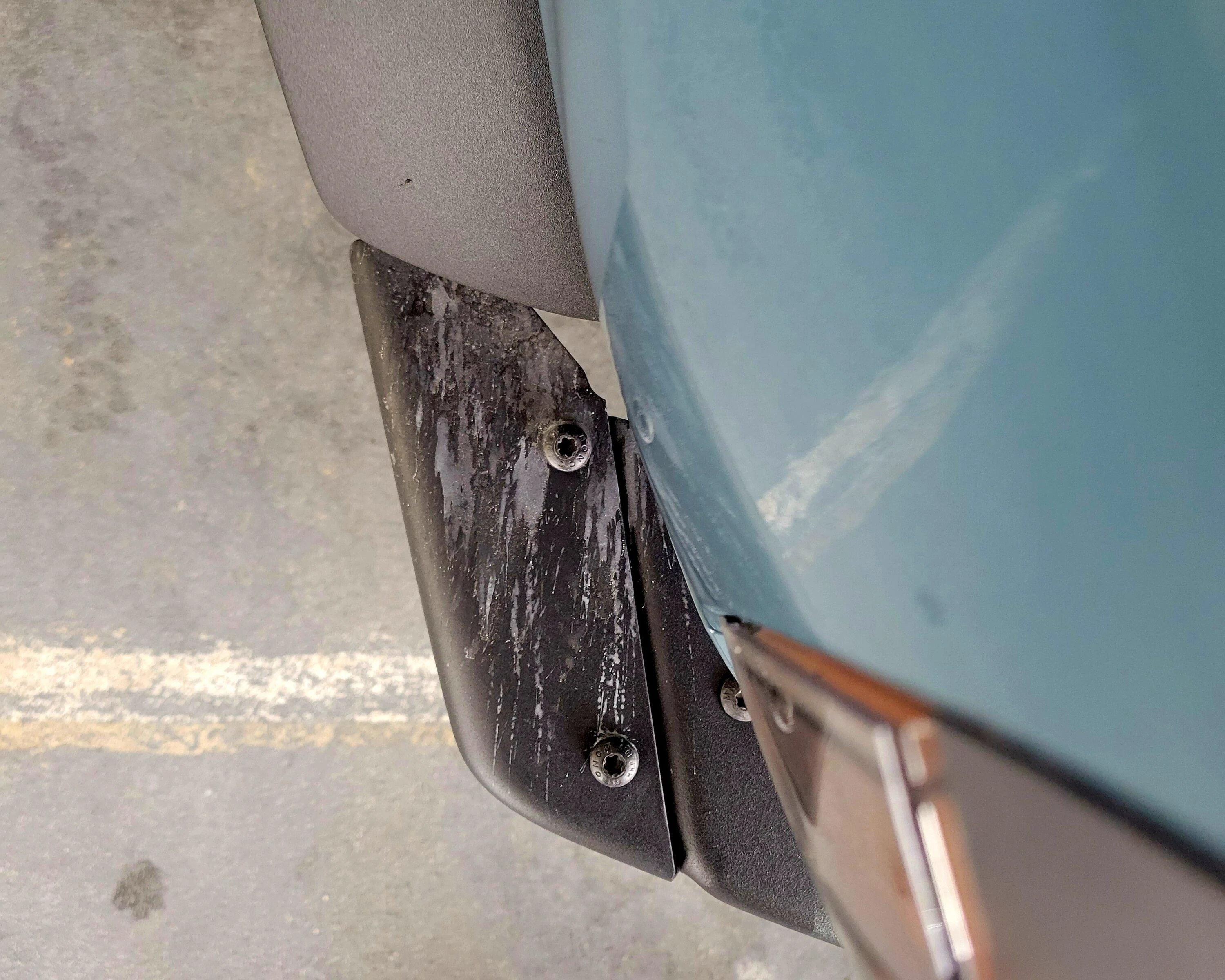

Another thing that may be related to the spacers that go behind the front modular bumper:
Ford Bronco Clearance after installing winch? 20230527_103123
I don't know if it's directly related to the larger gap there or not, but it is on both sides and I don't remember it getting dirty like this before.
