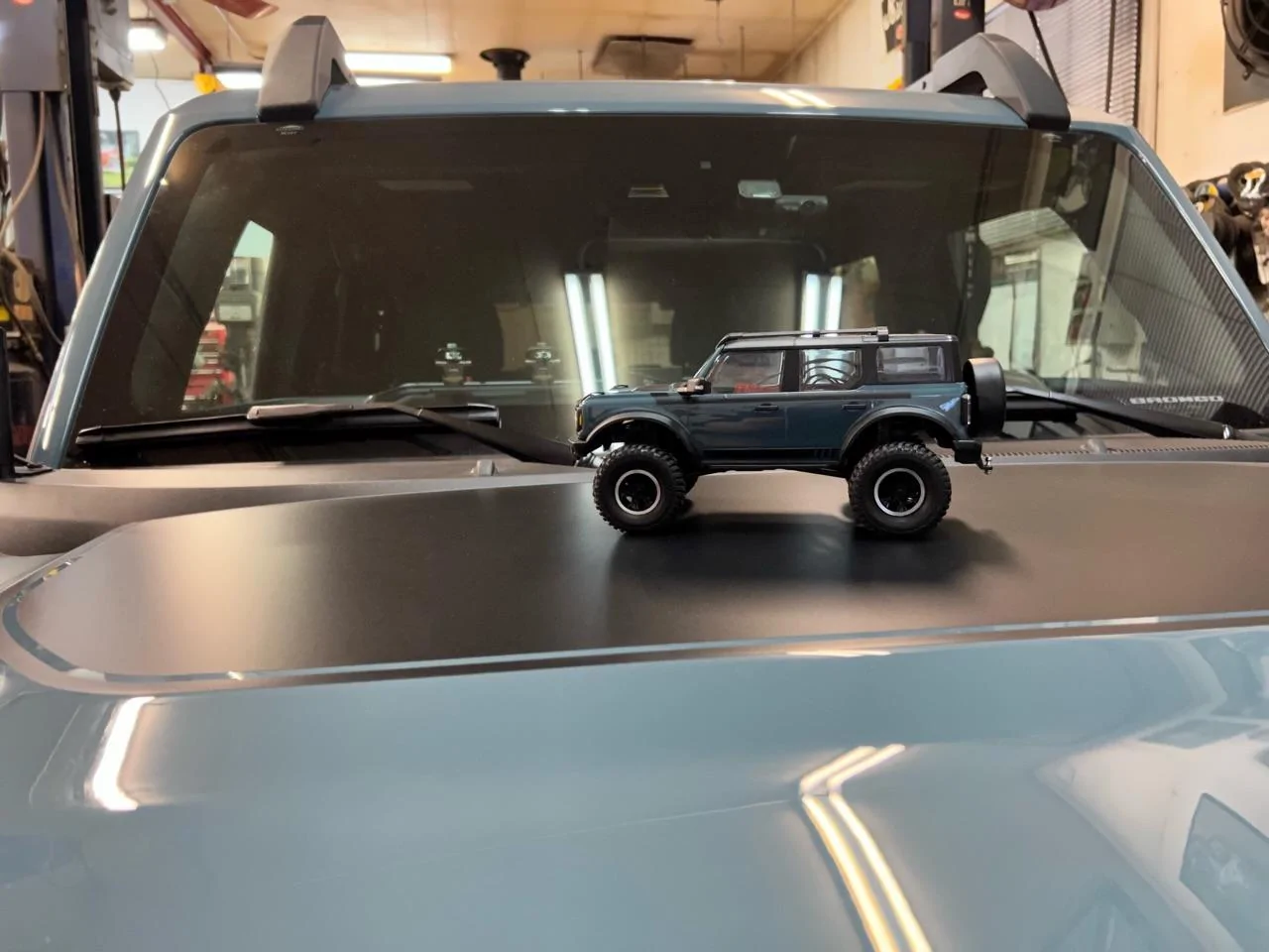

Dang, didn't know you had to take the tires off to put this light kit on. Serious install right therešŸ˜‰
LMAO I’ve got to get those to storage.

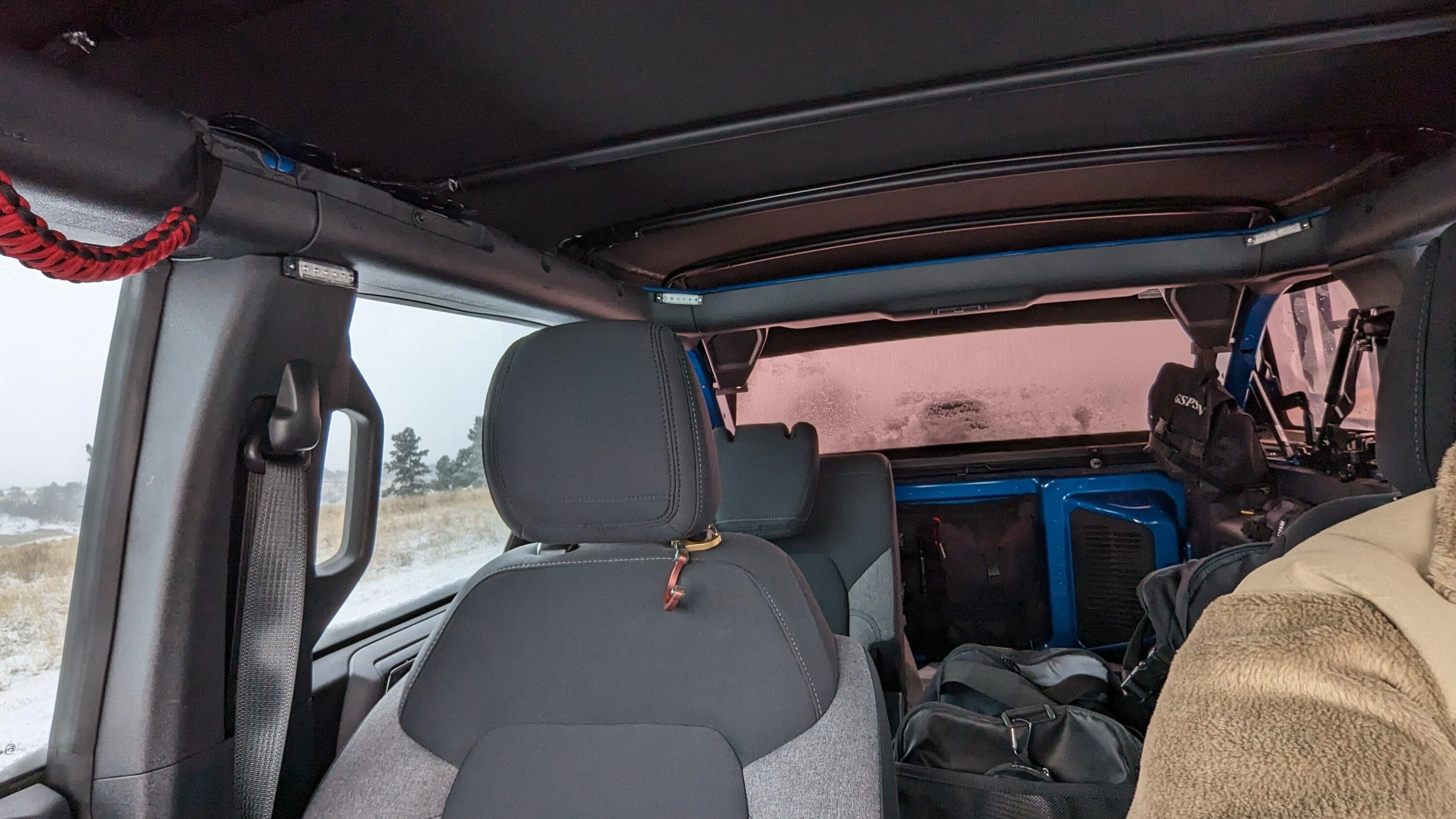

Can anybody that has installed this on a 2Dr show pics of what it looks like installed??

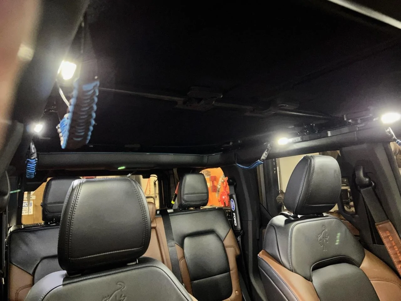

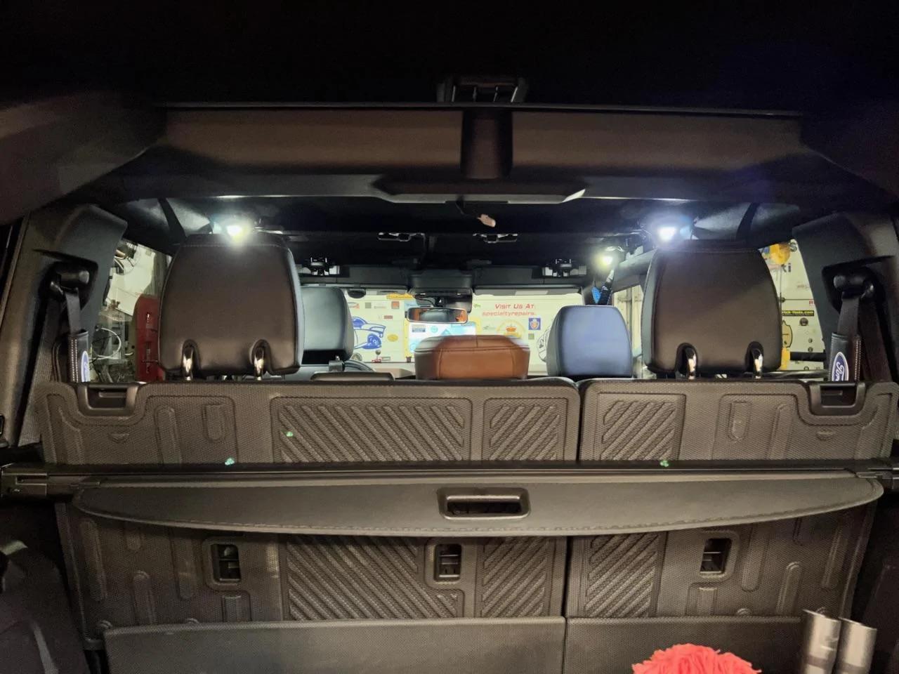

Had to remove parts of the roof rack, forward and mid section of the top but it went well. Took almost 3 hours but it’s a great quality kit and made a Hugh differance to the lighting of the interior. Still waiting on the Mabett rear dome light to get here and then that should do it for lighting. Thanks @IAG Performance for offering this great kit.

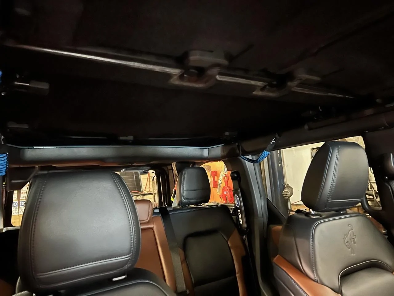

Have any pics with the lights turned off? Trying to find pics of the lights installed on 4dr hard top; specifically what do they look like with the brackets.

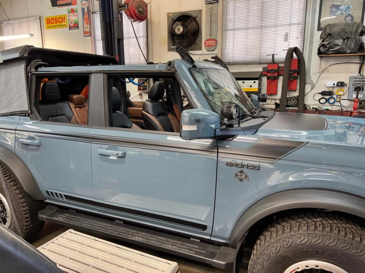

I’ll get it for you as soon as our storm is over. The Bronco 9s in our shop but getting to the shop 9s the problem lol
