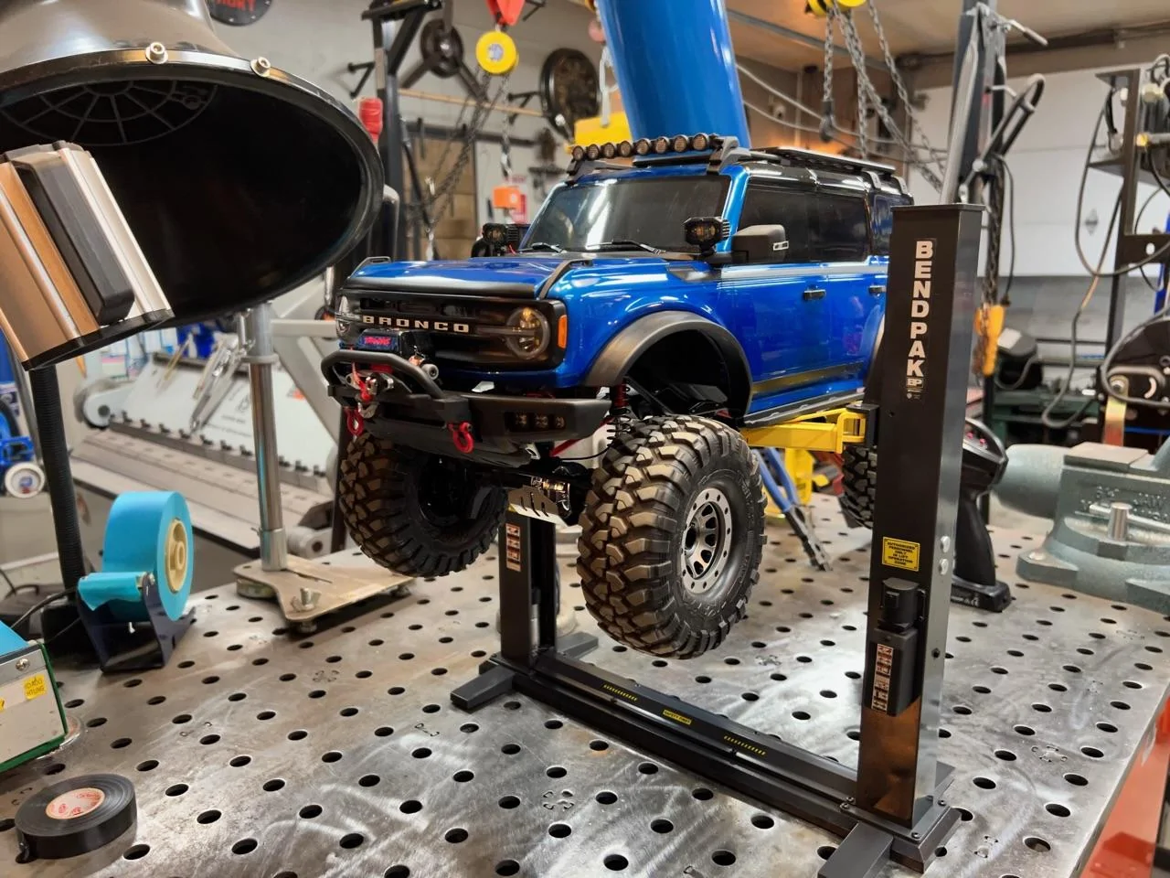

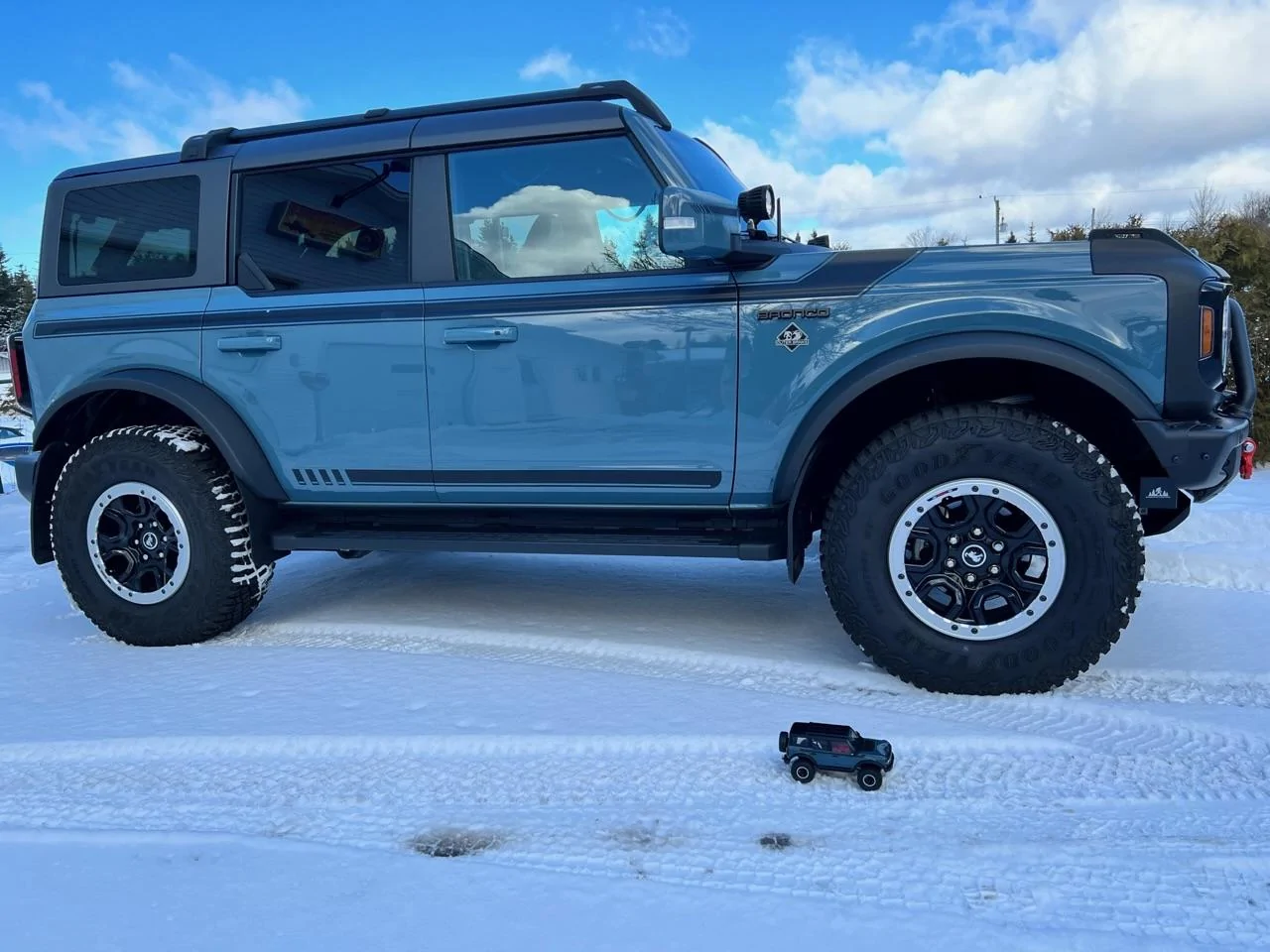

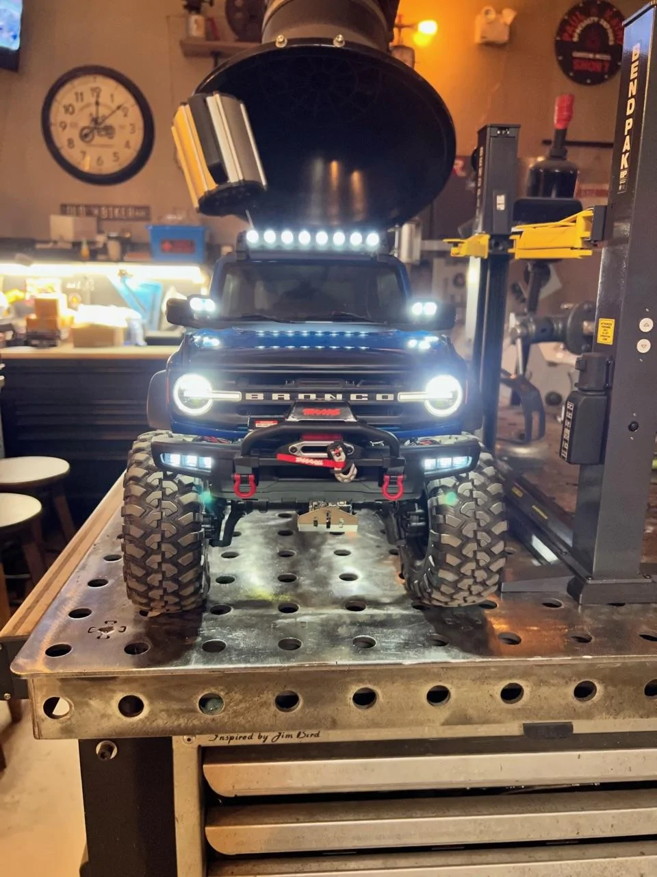

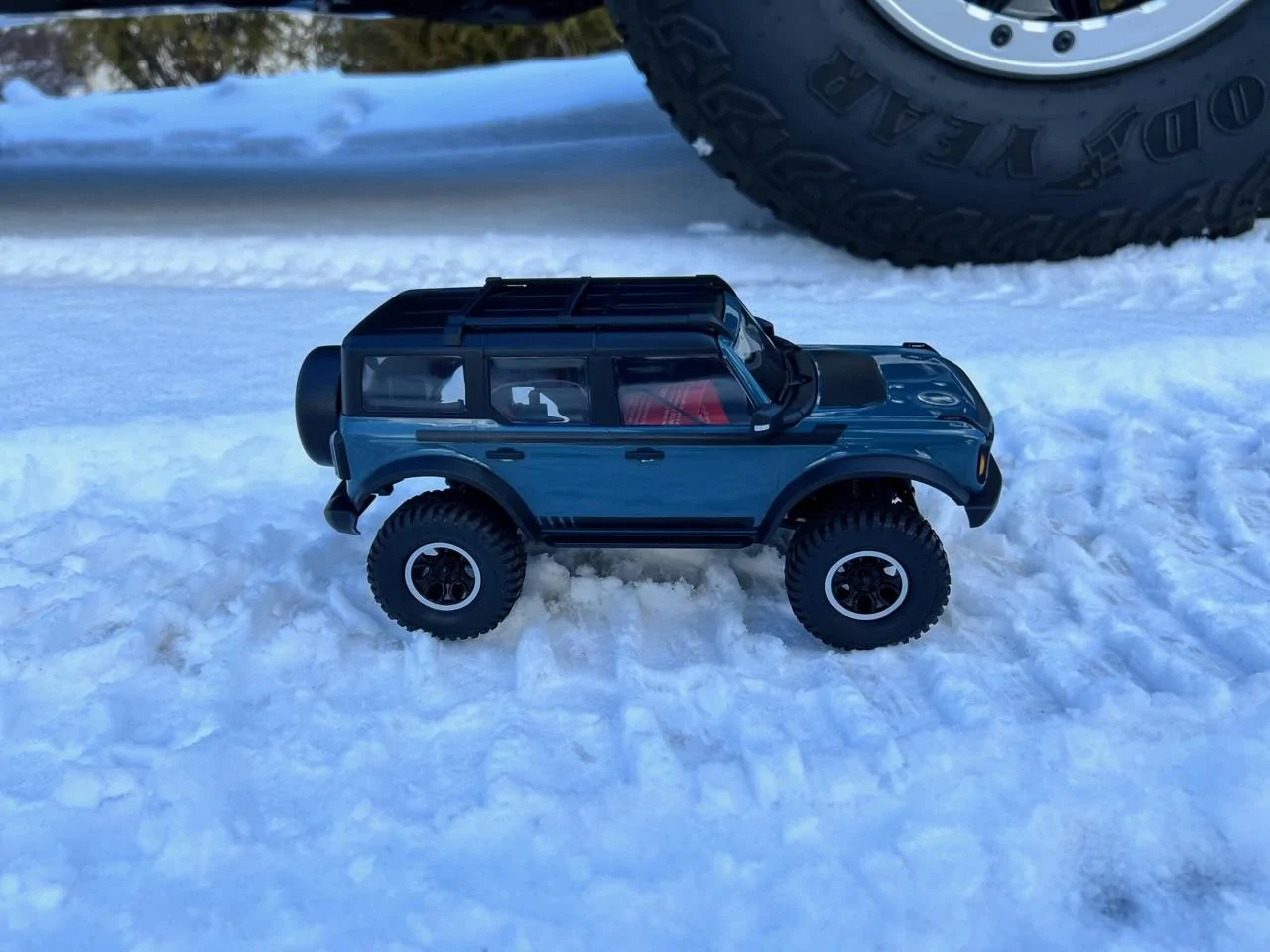

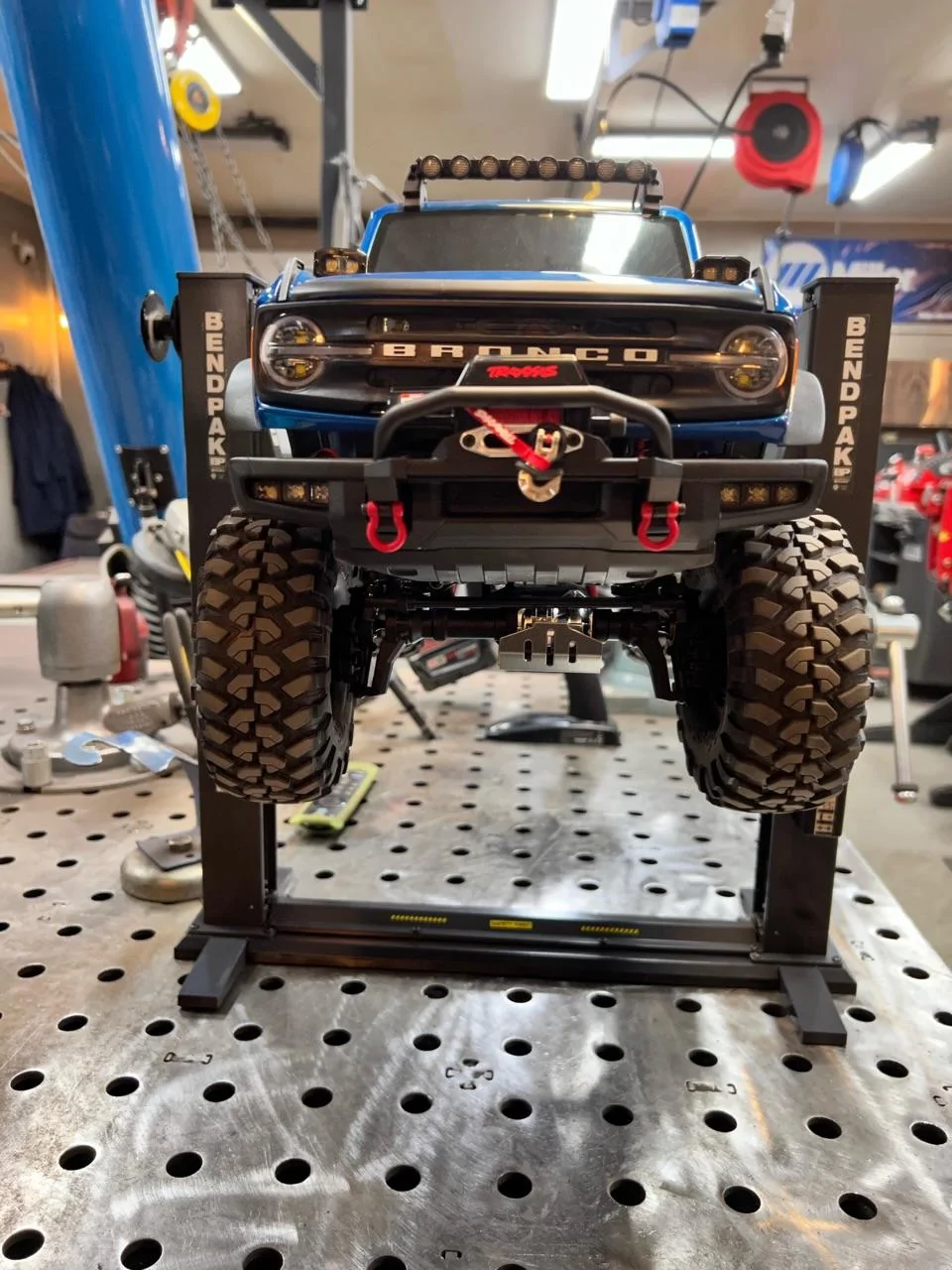

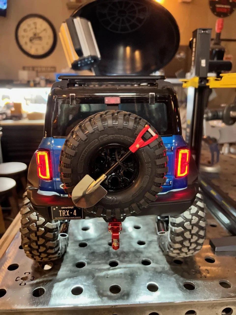

That’s a Traxxas 1/18 scale rc Bronco. It has the optional Area 51 body. We did the graphics last evening to match our actual 2022 bronco.
iā€˜m also doing a 1/10 scale bronco with lift kit, wheels and tires………. It’s a fun hobby. You can get them at most hobby shops

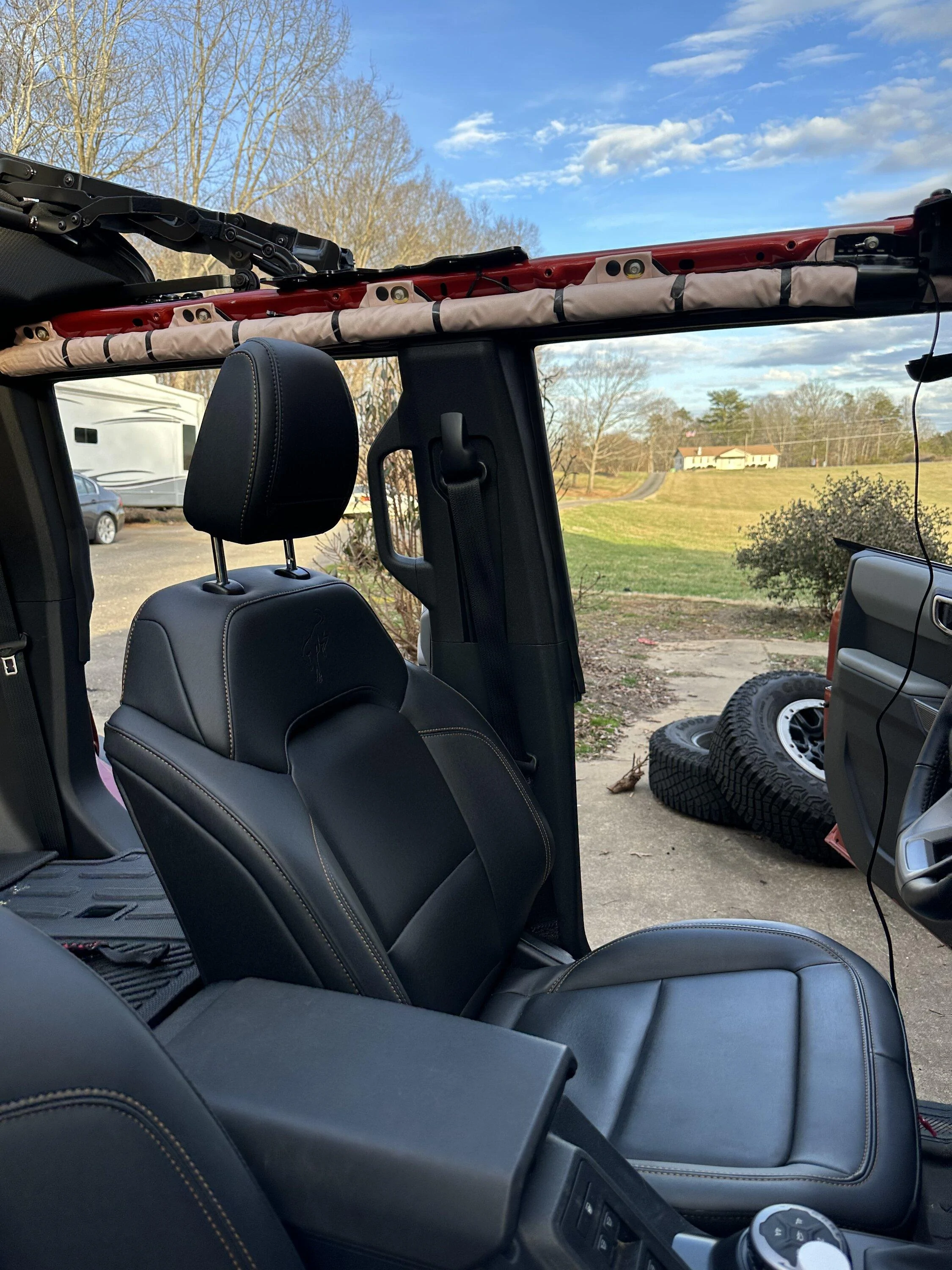

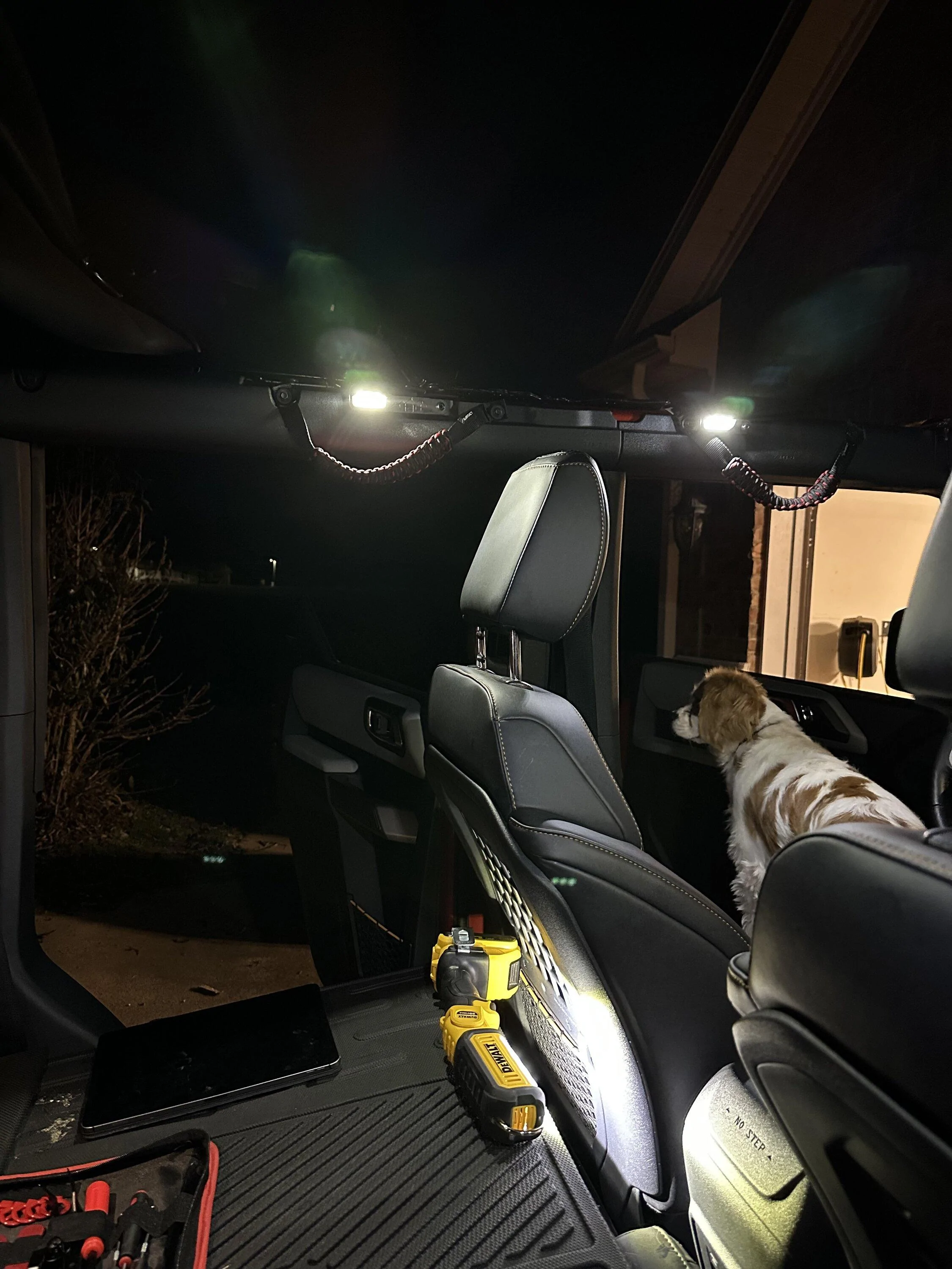

I got mine installed this evening. The pupper supervised. It was definitely a little tedious under the dash. But, just take your time.
