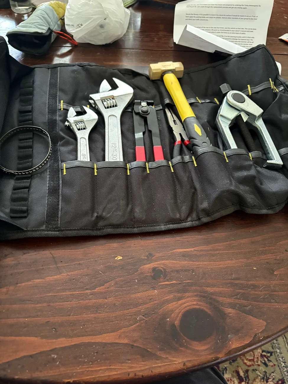

I will have to take a picture of my tricky dicky tie rod repair kit. Honestly never used it and been through some tough trails in Moab, Colorado, and Wyoming.
That would be great!! I see he is no longer actively selling the kit.

Here's the Tricky repair kit.
Ford Bronco Inner Tie Rod Trail Repair Kit: Looking for Feedback Tie Rod Repair Kit

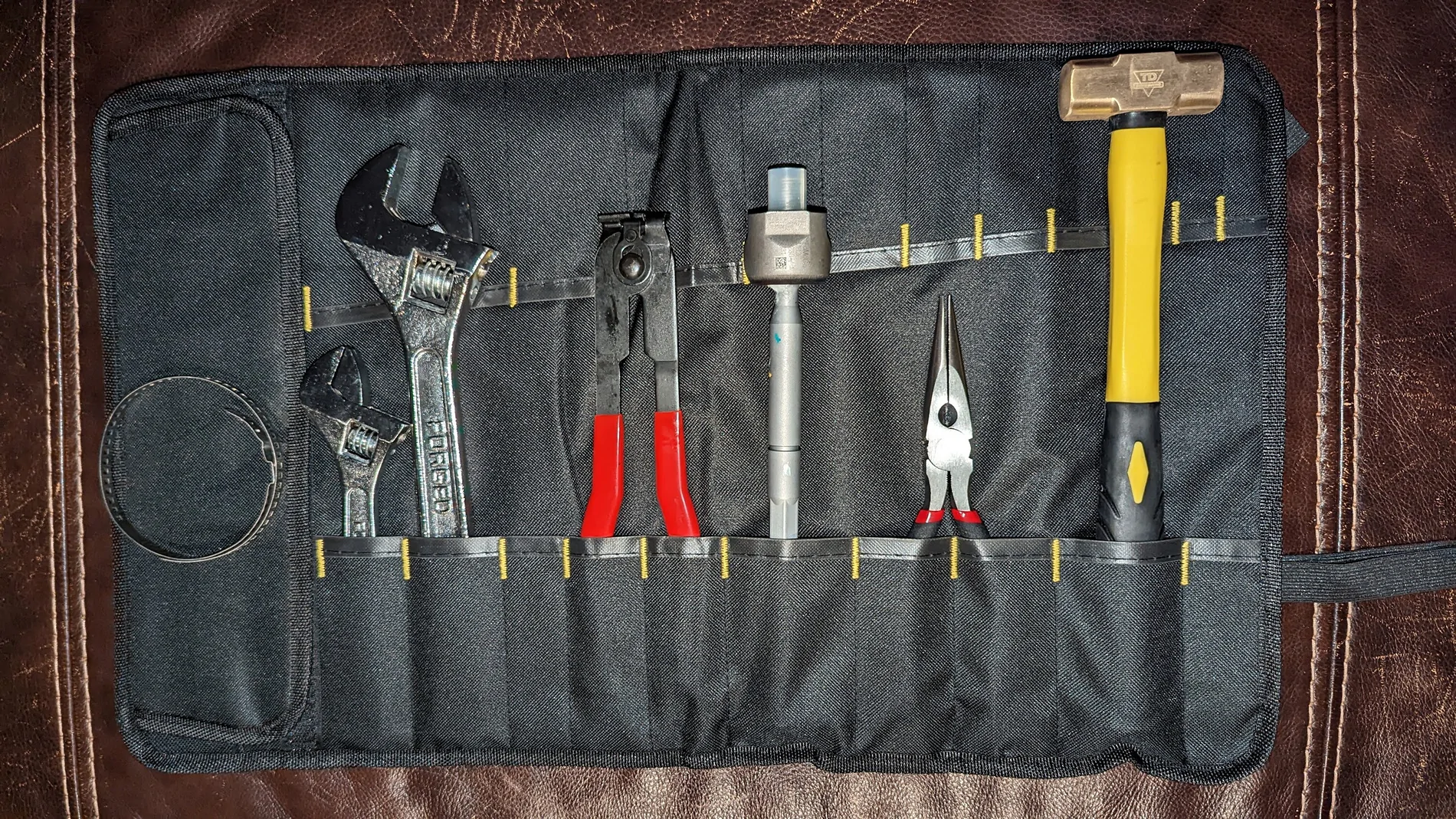

I’ve got it too! Never used it.

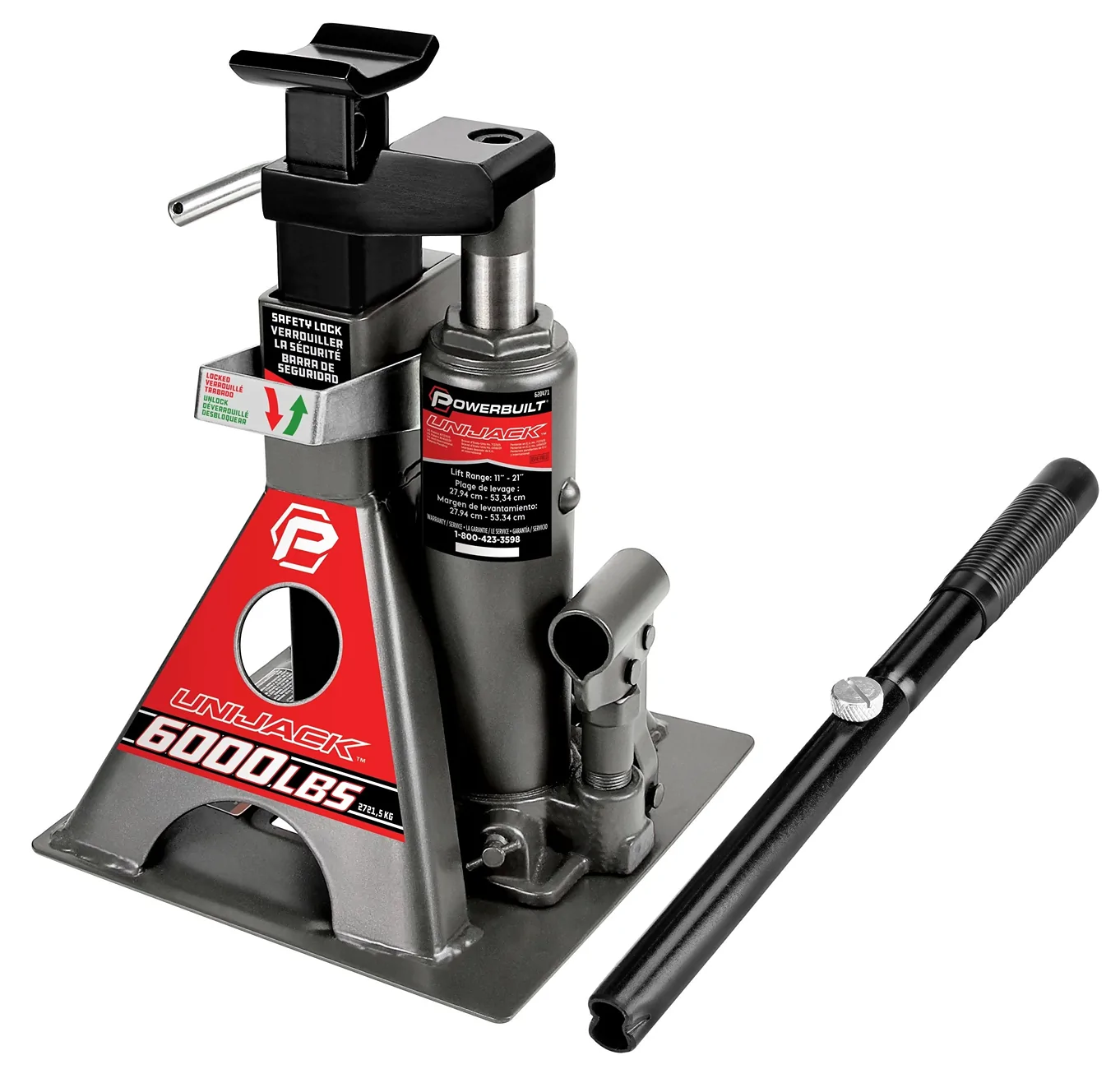

I like the moving blanket idea in a prior comment. And I need a better jack. Bottle jack or inflatable? Or both?
I got one of these.
Ford Bronco Inner Tie Rod Trail Repair Kit: Looking for Feedback 1779791440892-

Actually used my TD tie rod kit this weekend for the first time after carrying it for 5 years.. Made the job a quick and easy fix, Definitely worth having such a kit.
