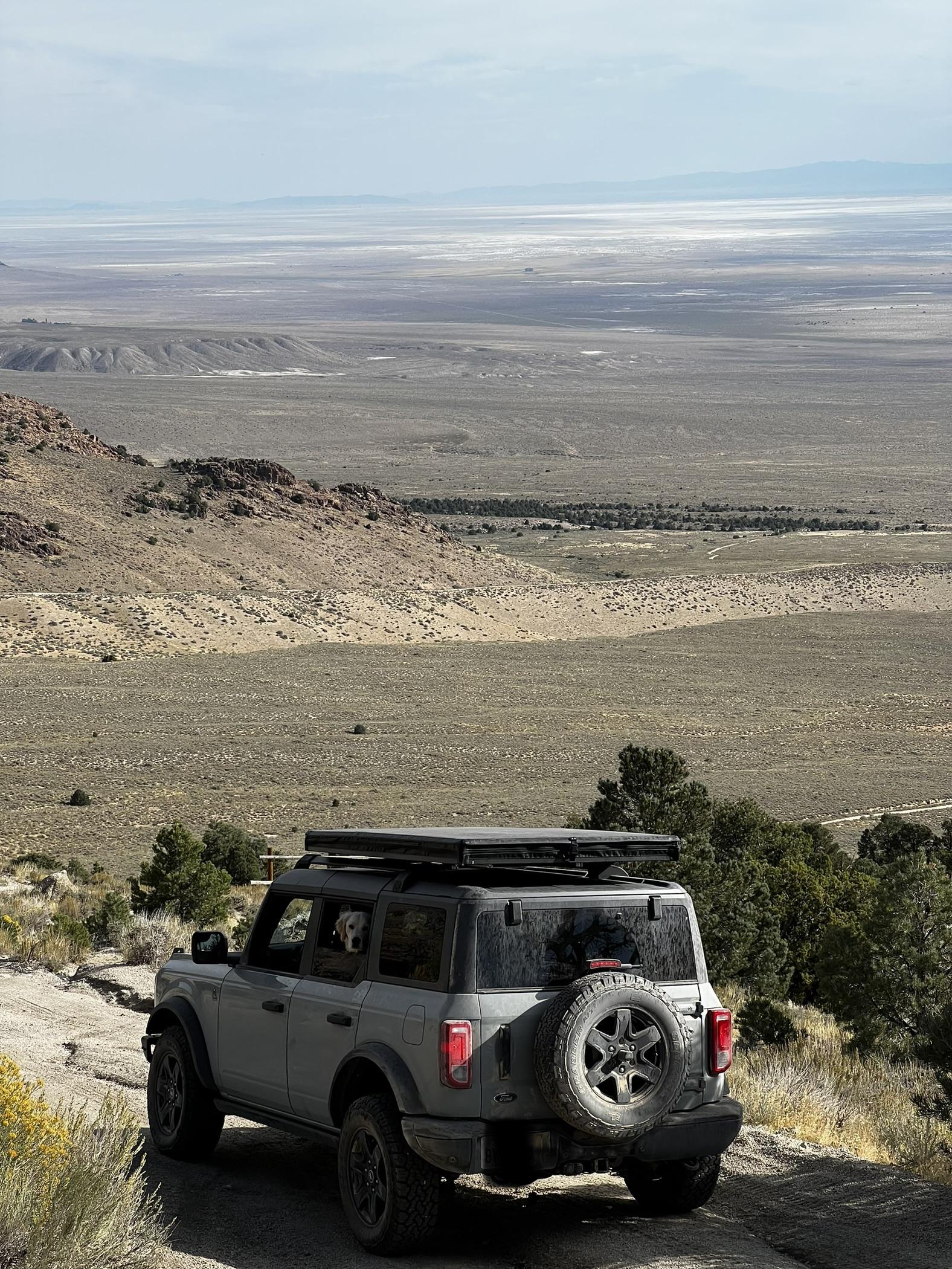

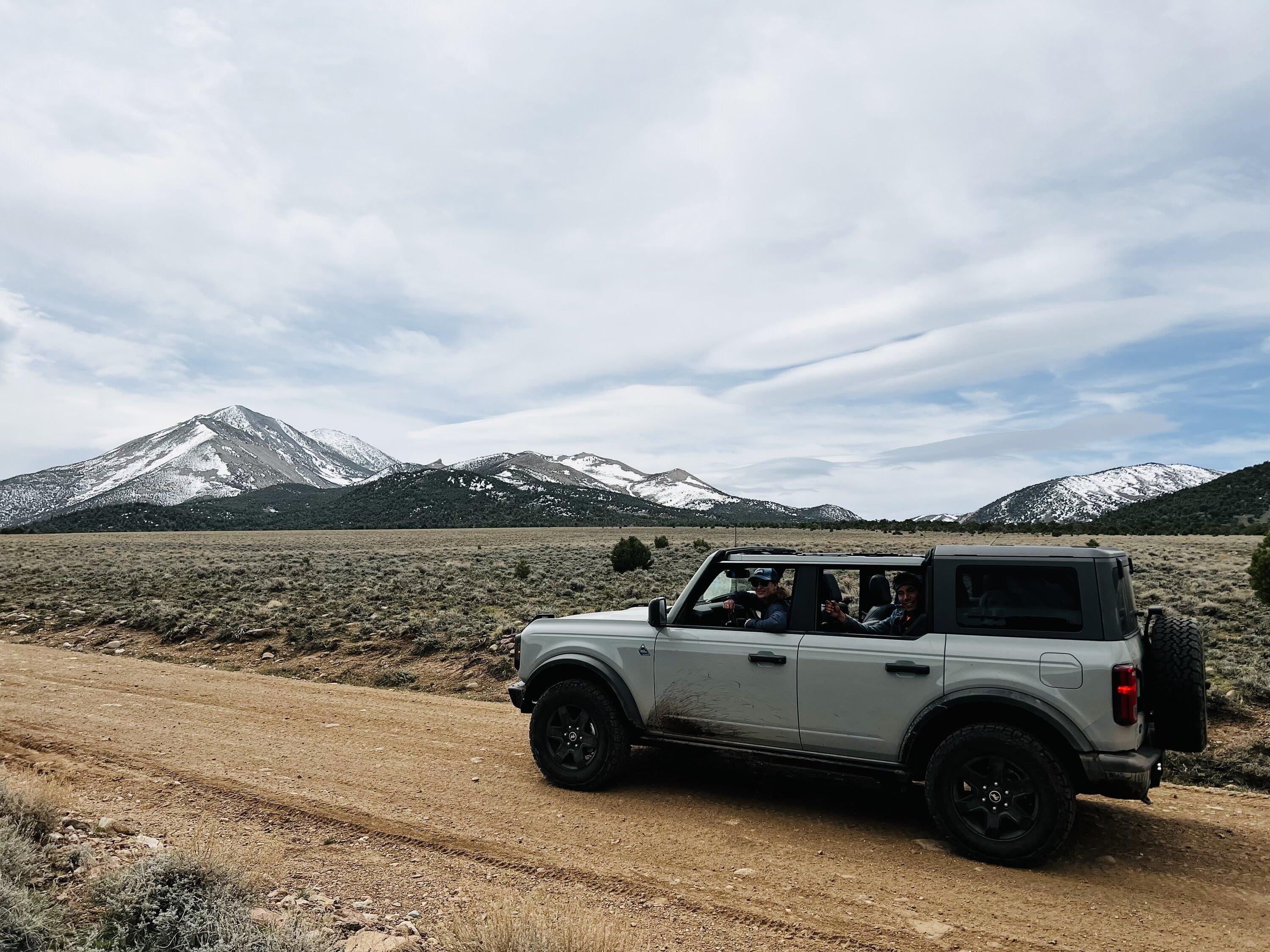

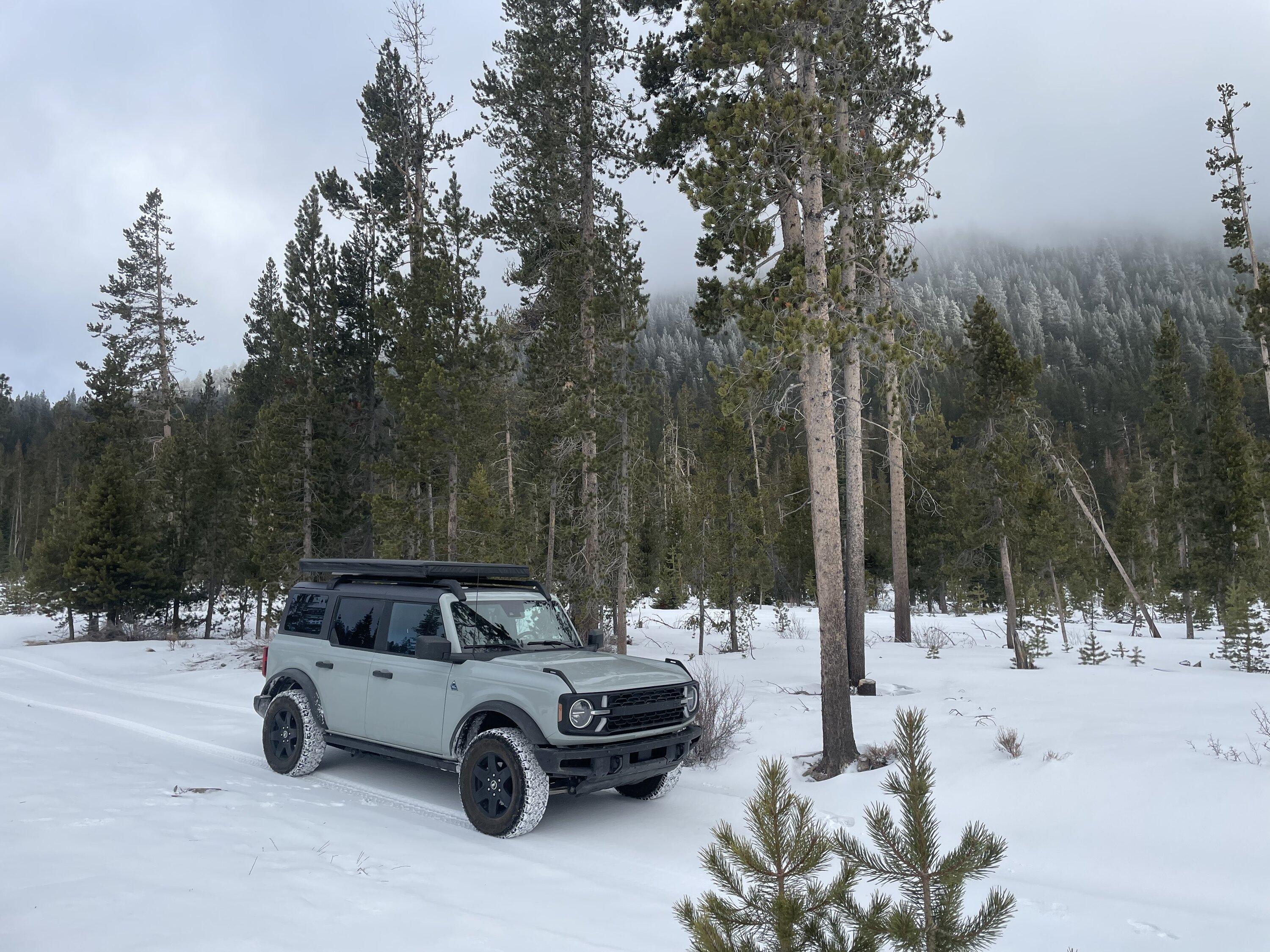

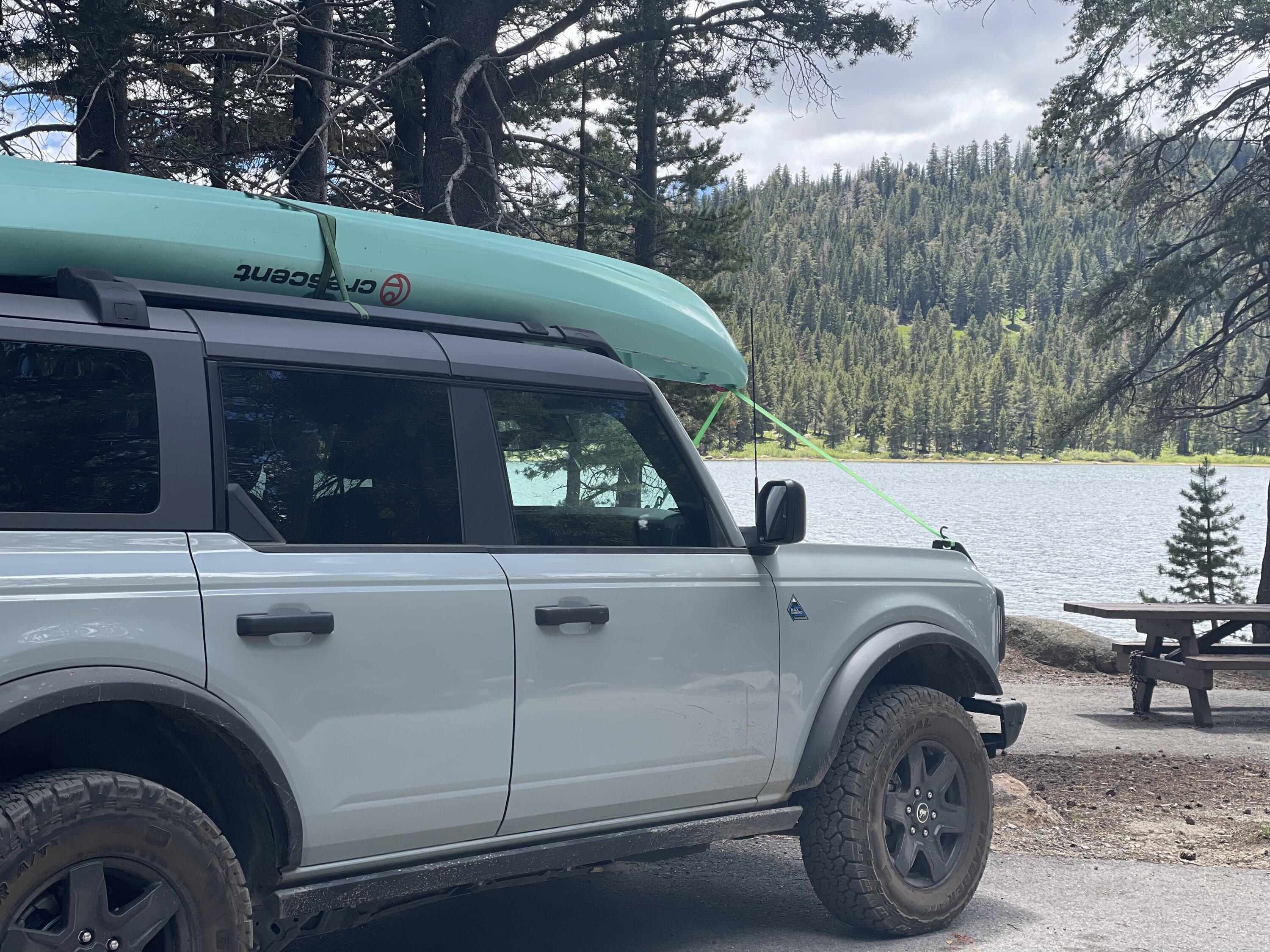

Here’s a few pics of me enjoying the rig over the last year prior to what’s happened. I’ve really loved the shit out of it up until now……
