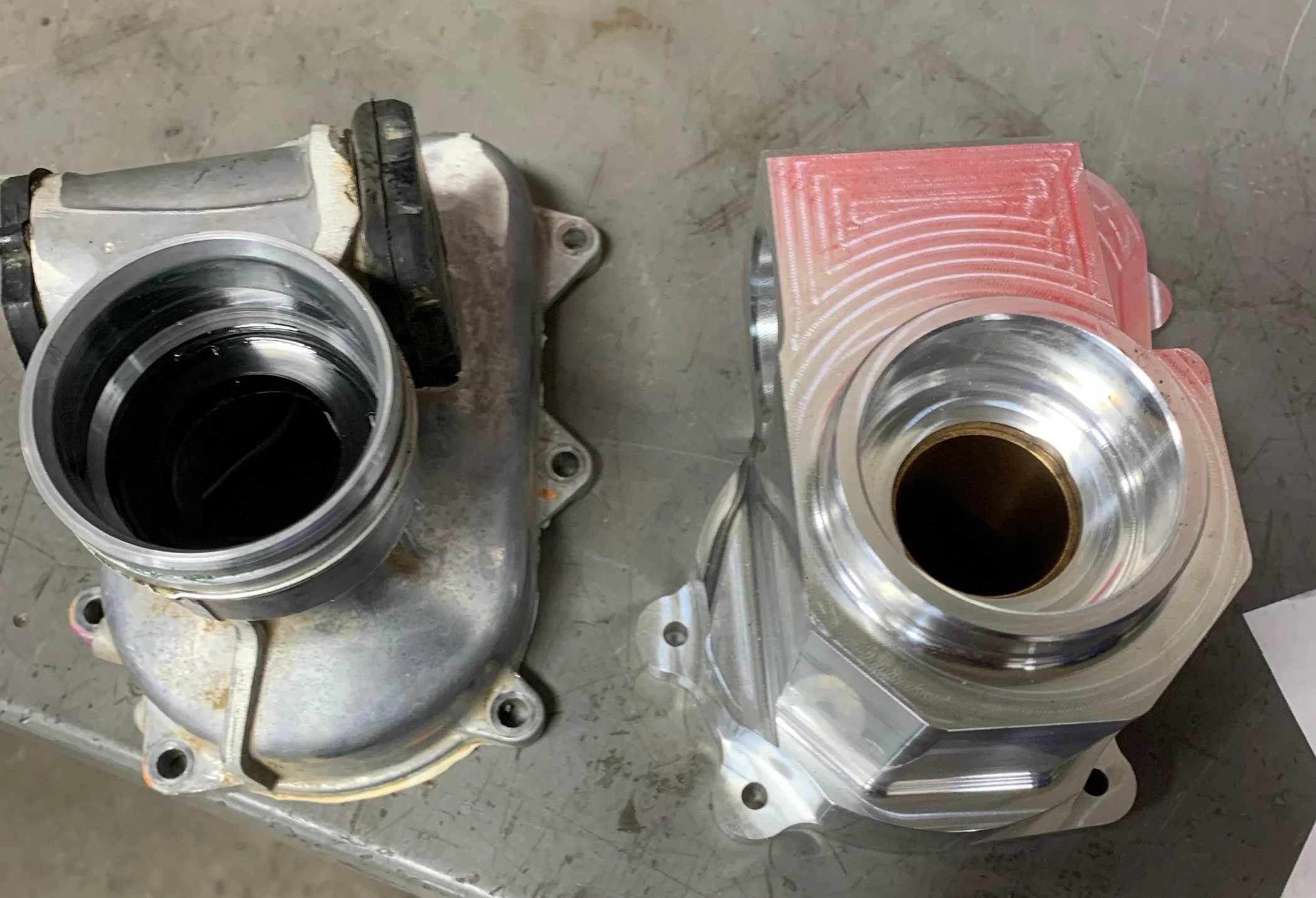

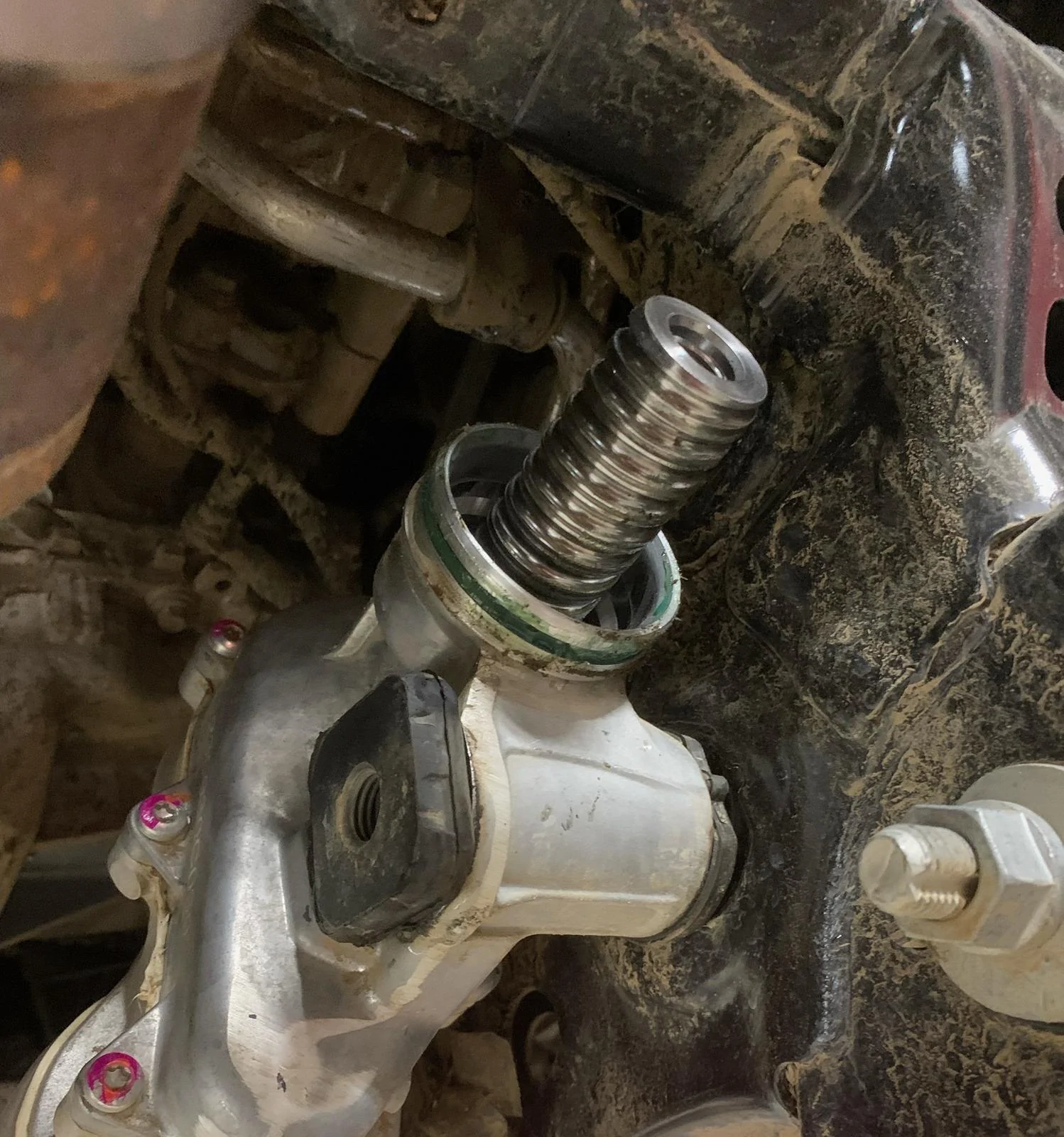

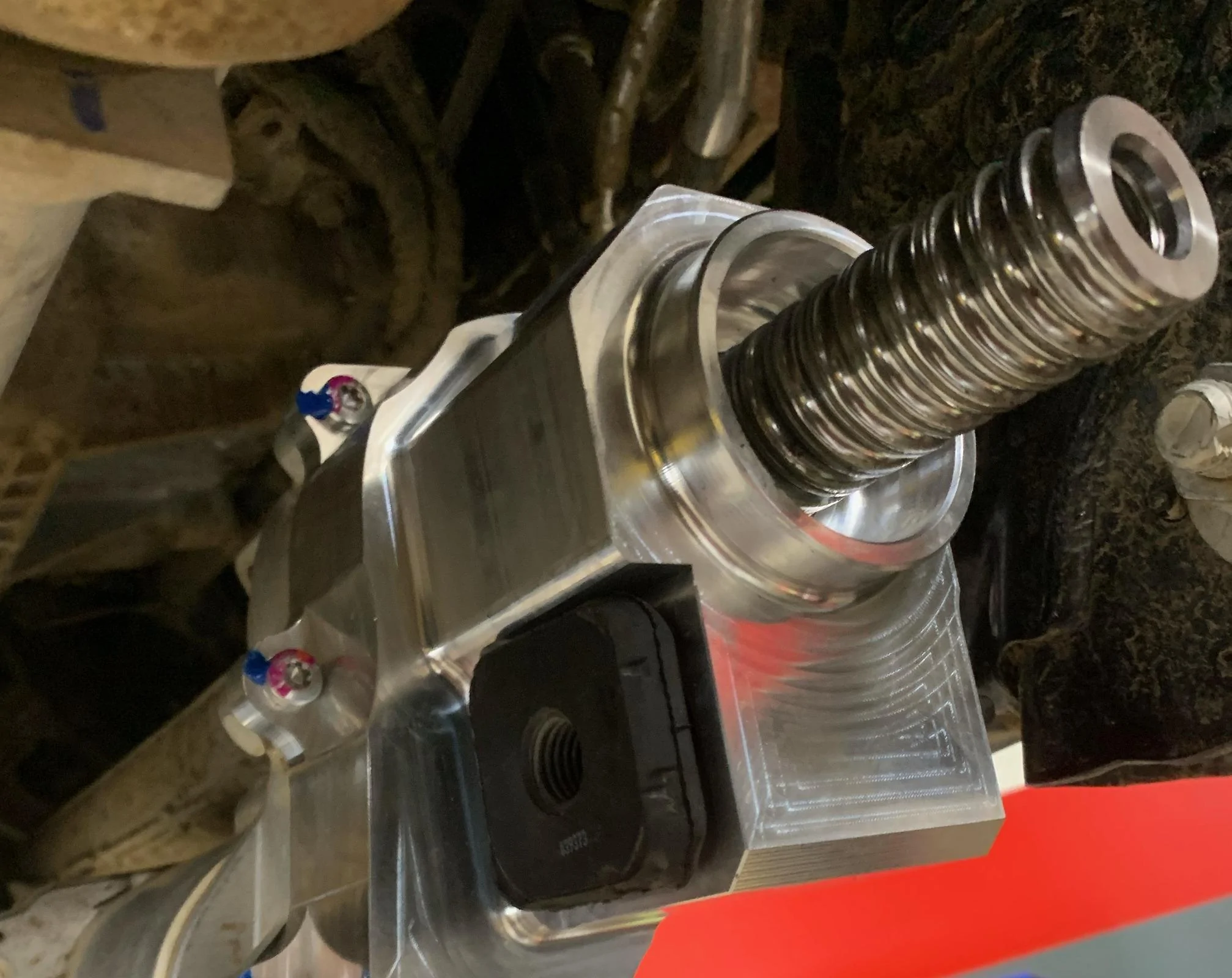

People might recommend getting heavy duty tie rods or tie rod braces, but I would avoid those like they have the plague, unless you are just going to carry them as a repair tool. Why? The tie rods are designed to fail to protect the super thin Bronco steering rack end cap. If you only upgrade the tie rods or you put braces on the stock tie rods, then all you are doing is transferring all the pressure to the next in line weak point which is the rack. I'd much rather have a busted tie rod as opposed to a busted rack.
If you really want to address the Bronco tie rod and rack weak spots, then you'll need to, at a minimum, replace the rack end cap with something like a 74Weld Stage 1 and some HD tie rods.
I recently did the 74Weld Stage 1 and Icon HD tie rods. If you don't want to spend the cash to do the 74 weld and HD tie rods, then leave them stock and carry spares. This will ensure the tie rods fail before ripping your rack up.
Want to see how thin the Bronco rack is? Here are a few photos from my recent installation.
Stock end cap - I think they actually tried to make this as thin as humanly possible:
Ford Bronco I'm just here for a good time... 9
74Weld end cap - Much beefier
Ford Bronco I'm just here for a good time... 7
Stock on left and 74Weld on right
Ford Bronco I'm just here for a good time... 3

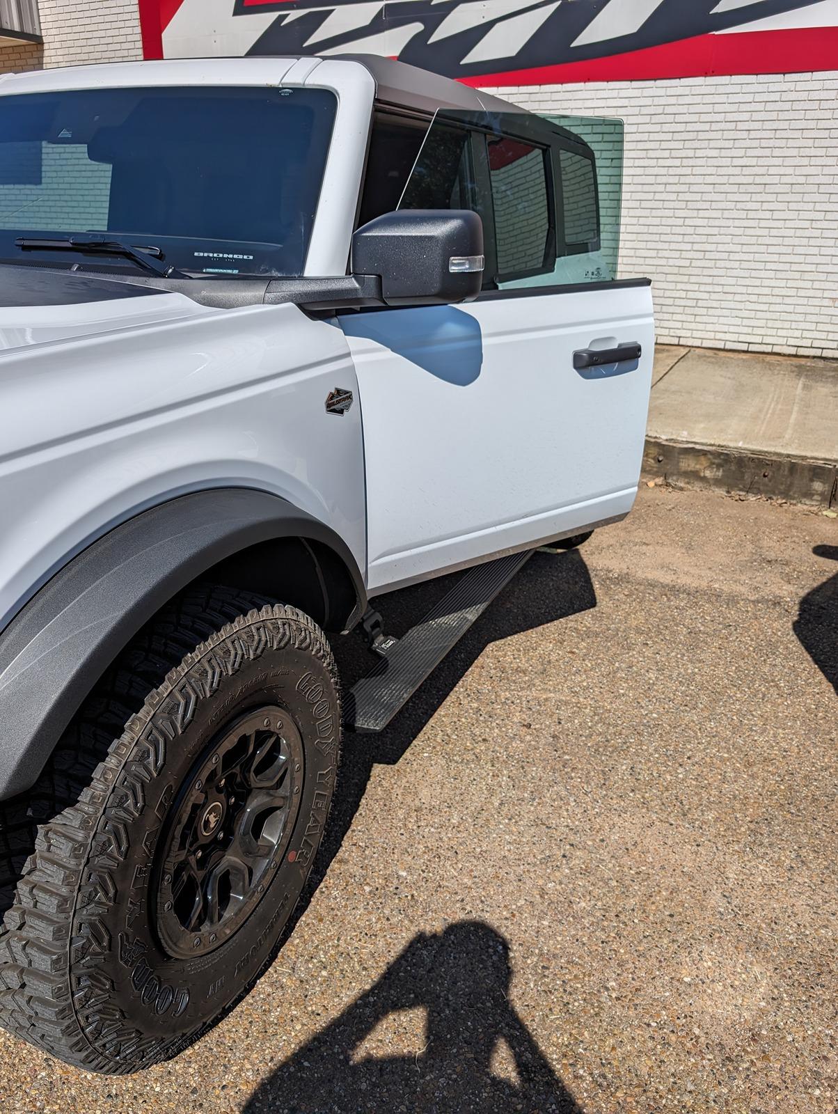

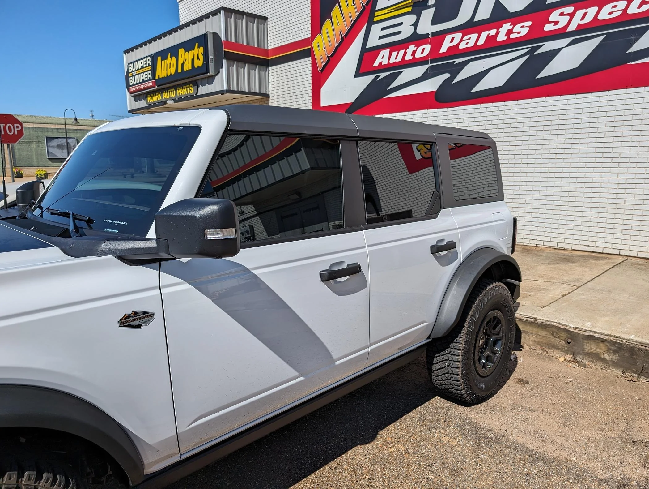

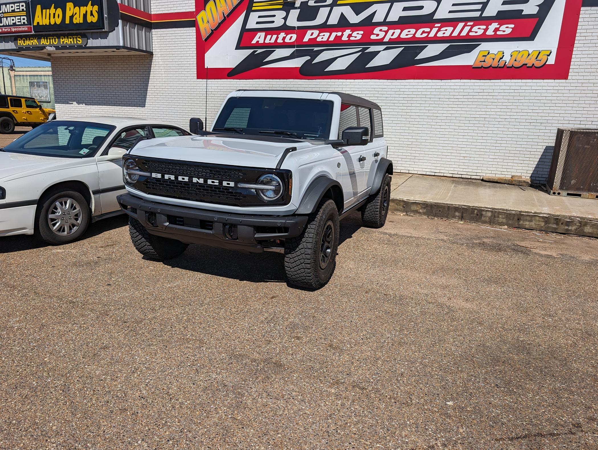

So, like I said, I added the RC E-boards last weekend, as well as the hood lift supports. I again recommend any other brand but Rough Country on the hood shocks. Just overcomplicated.

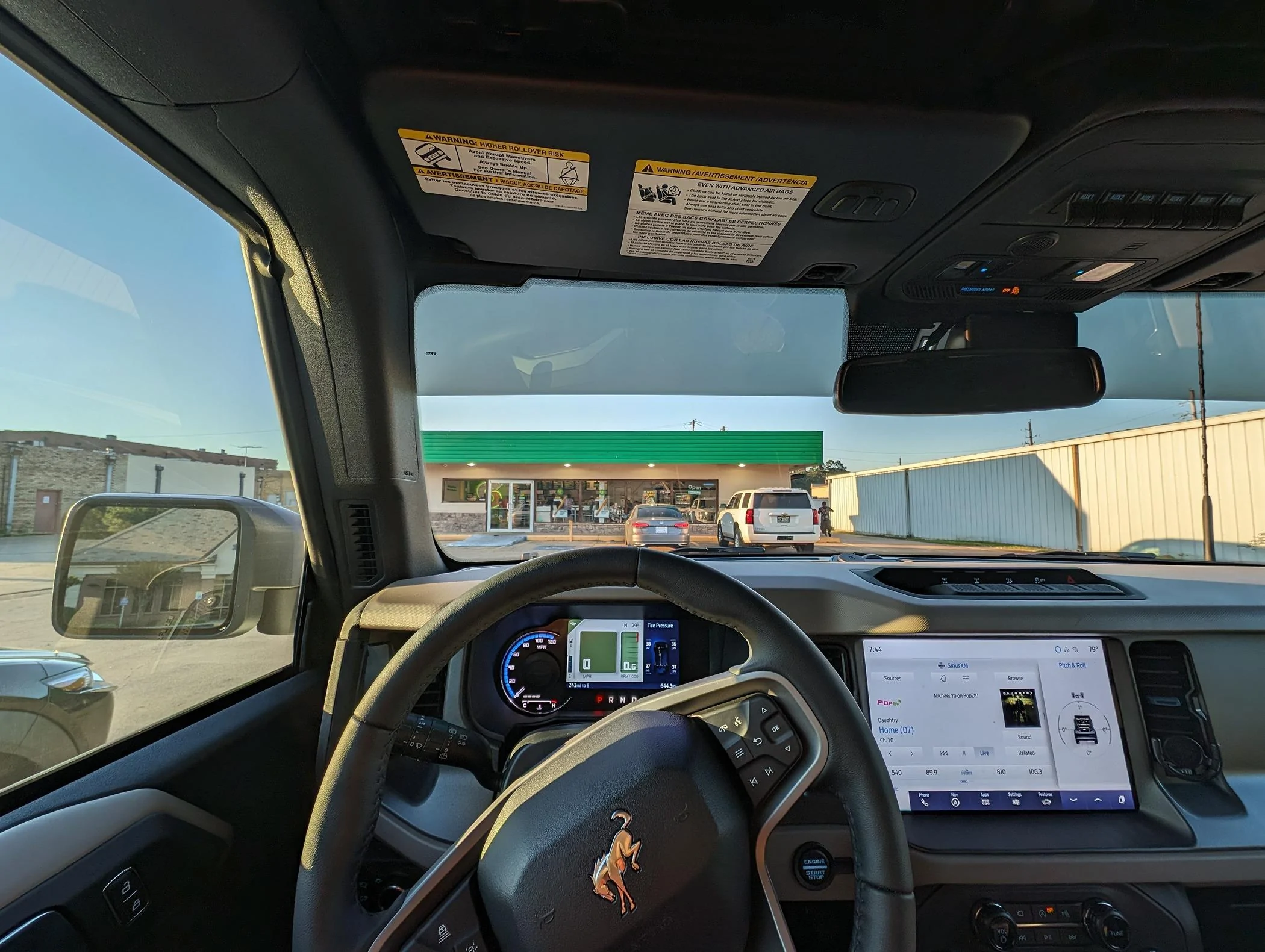

Got the windows tinted today. 5% on all the rear windows, 20% on the front windows, a brow and 50% on the windshield. I must say, the windshield tint is NICE.
Planning on slowly adding a few things here and there. Not sure if it's worth of a build thread. Really wanting to tap into this audio system. Though the 10 speaker is way better than the 7 speaker, it's still lackluster to say the least.
Also, as said before - I'm a GM guy at heart, so I had to cover up the only visible Ford emblem on the entire vehicle 😂.

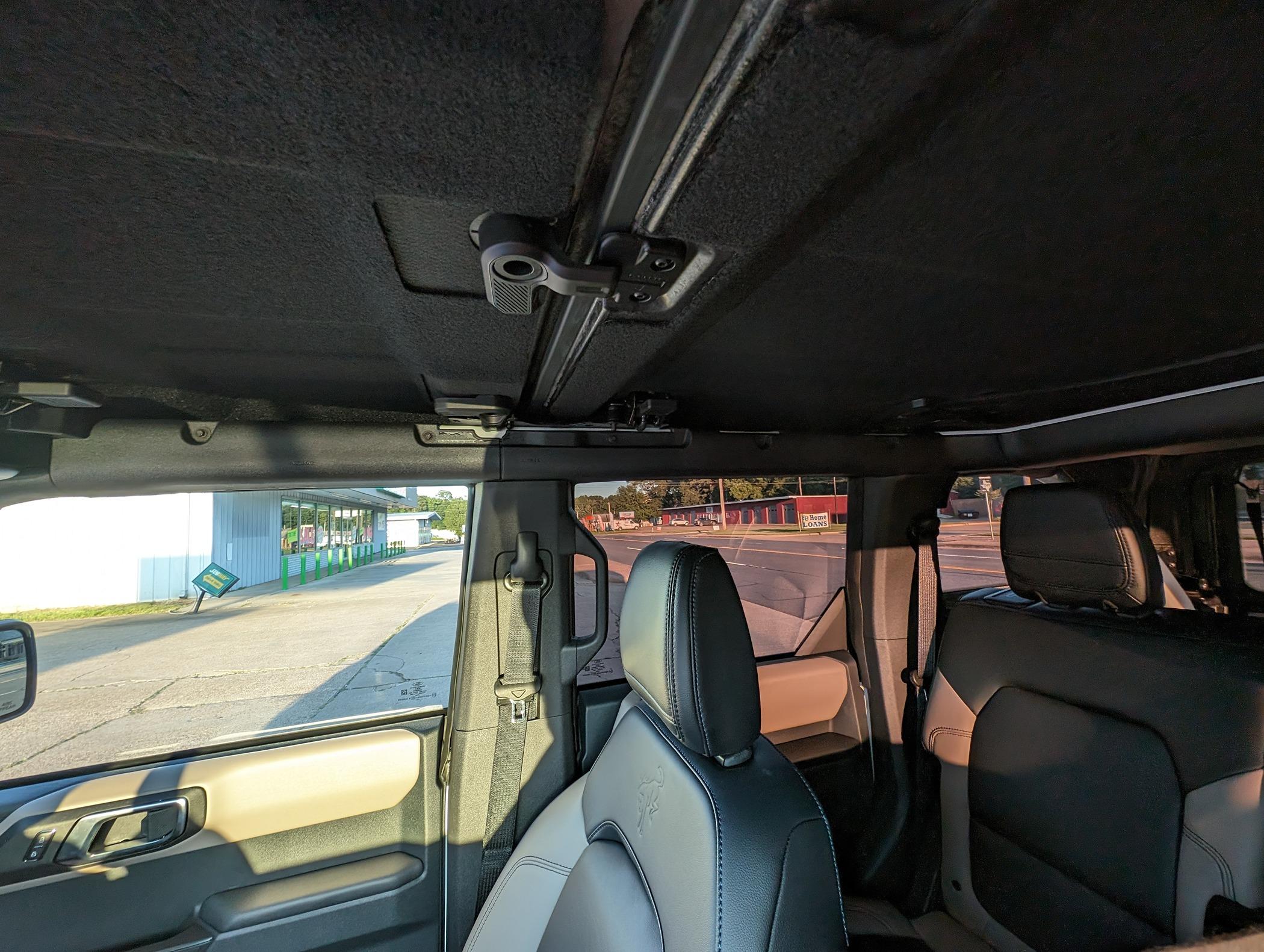

View from inside.
