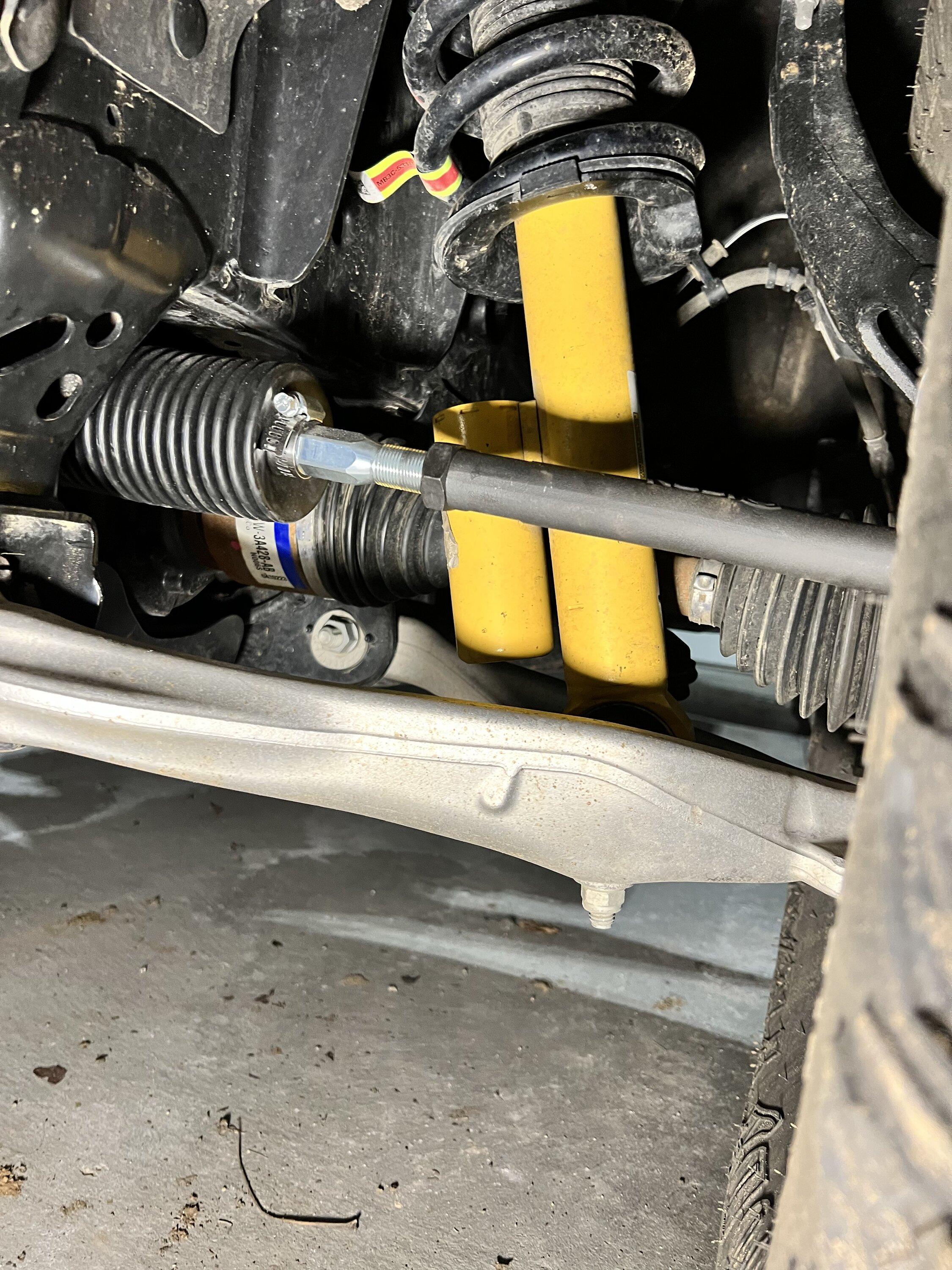

Install done. Was pretty straight forward. Seems like a quality product and I have way more faith in it than a Jks/broncobuster sleeve. for the price point it’s hard to beat honestly. I’ll be upgrading the rack at some point when there is a good option. Threw on lower control skid at the same time.

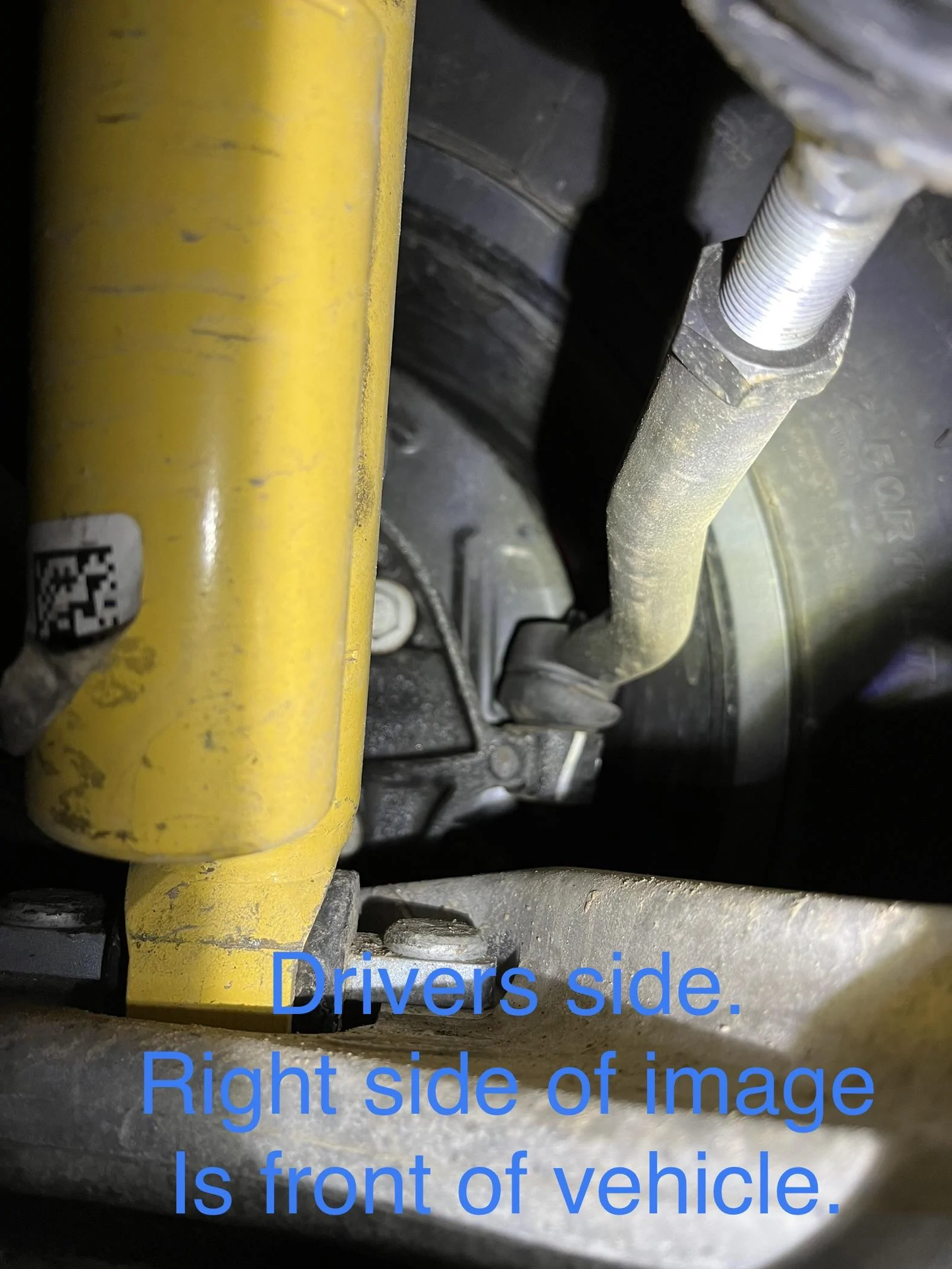

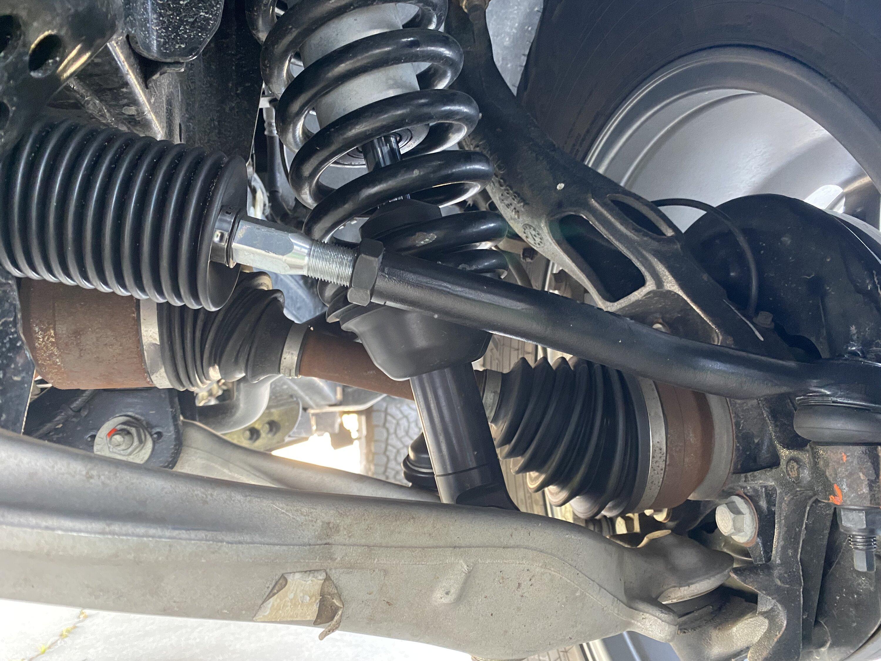

So you think this is incorrect? This is the drivers side, right side of the image is the front of the truck. Icon tie has “L”.
This looks right to me, but I’m no expert. Your theory would mean that Icon’s L & R is incorrect….that can’t be…
Ford Bronco ICON XD Forged Tie Rods 5BF48E8D-5B18-41B9-BD01-C7268D02ABCB

PHOTO above by ramble makes sense. Mine installed the same. It provides most clearance for Icon’s coilover when the steering tie rod is hard-over (retracted). May be irrelevant if not using Icon coilovers (which have a low spring bucket mount)

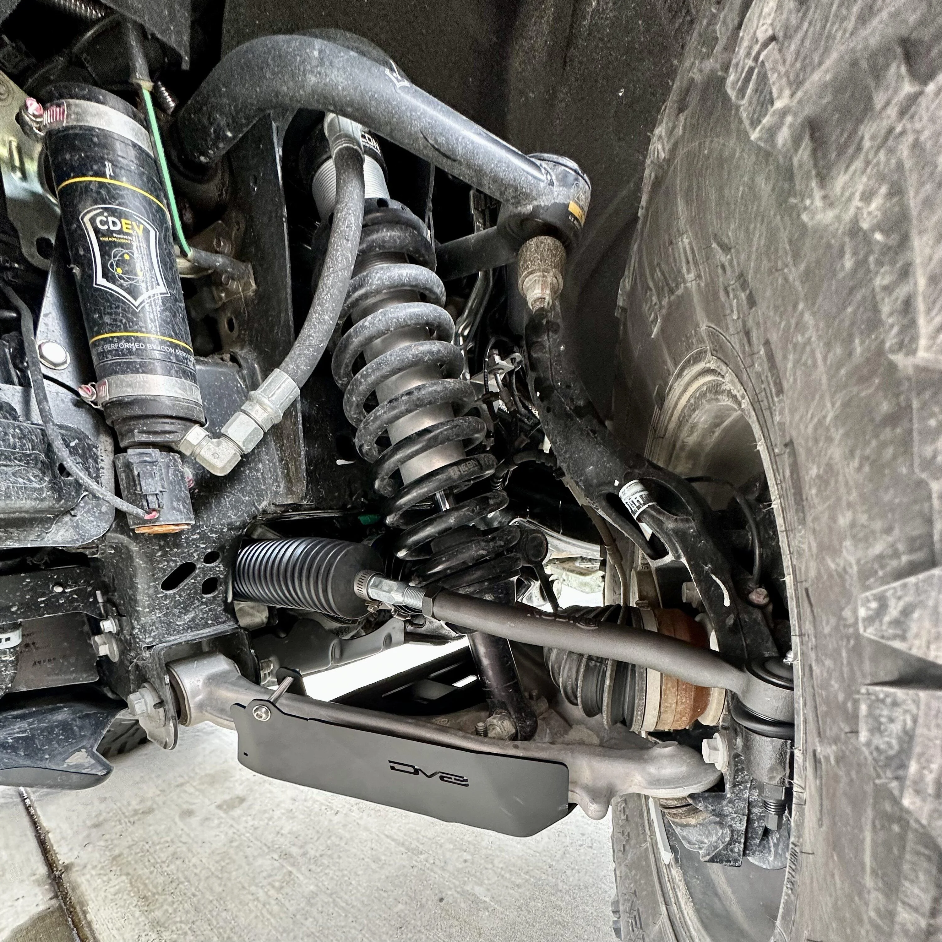

Does this pic help? Try at full lock and see if tie rod hits before you expect

I’ve spent more time on Ford’s parts catalog this morning, and I think @Ramble_Offroad’s install is not correct. The bend should be facing towards the rear of the car, not the front. Pictures of the schematics on Ford parts seems to confirm this.

After looking into this yes it does appear those markings are incorrect. We didn't include L/R markings on our CAD drawings or models, and the first articles didn't have them either. But apparently the foundry decided to add them to the production units, and of course got them wrong. The marks aren't mentioned in the instructions because we didn't intend for them to even be there.
We're updating our instructions now and will have the markings corrected on future production runs. But for now, yes please just ignore those marks. The tie rods are correctly installed with the bend pointing rearward. The bend is there for clearance at full turn with high offset wheels (which is probably a moot point for most of us). I went out in the parking lot to check the ones on my own Bronco, which were installed here at ICON, and they are installed correctly. Our apologies for the confusion.
