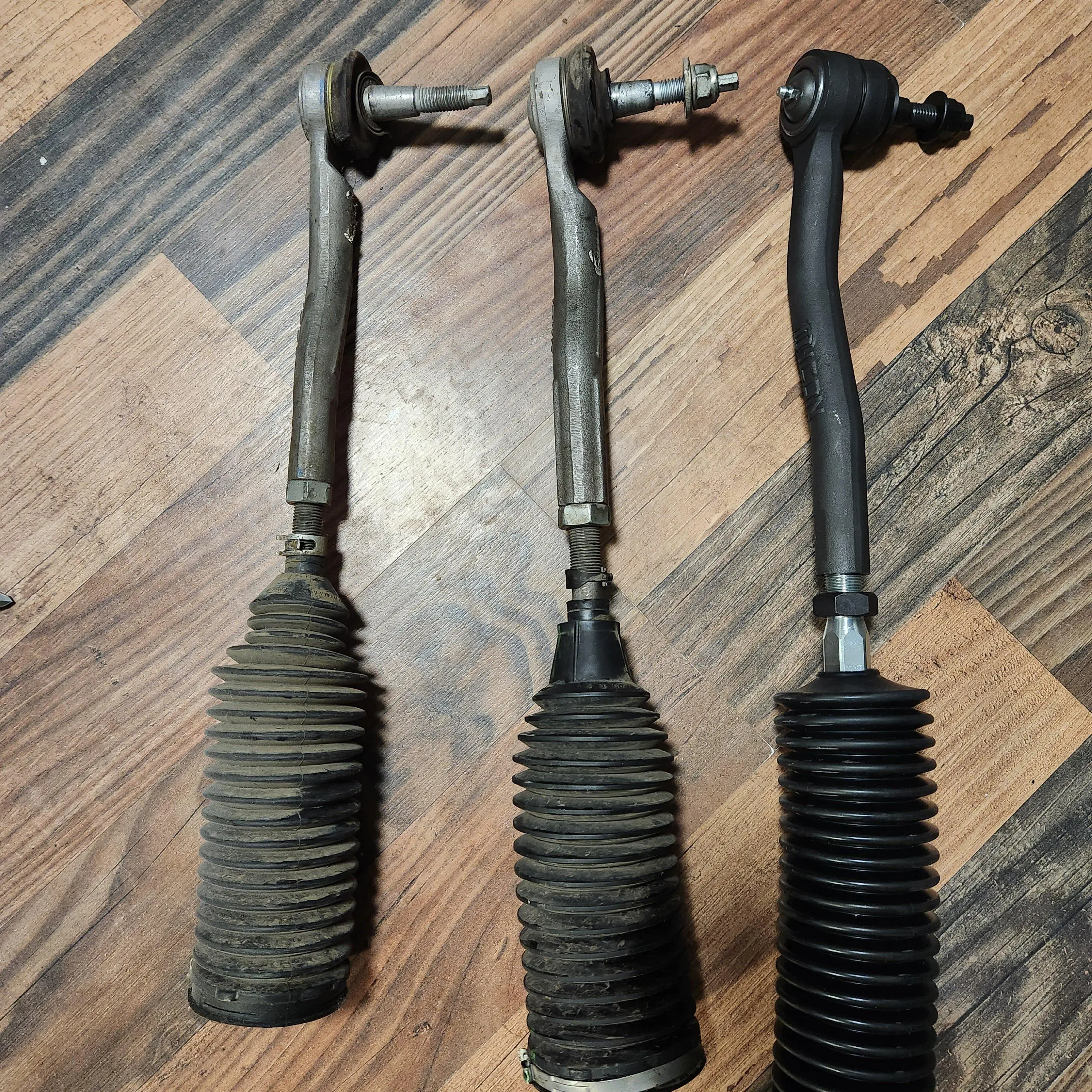

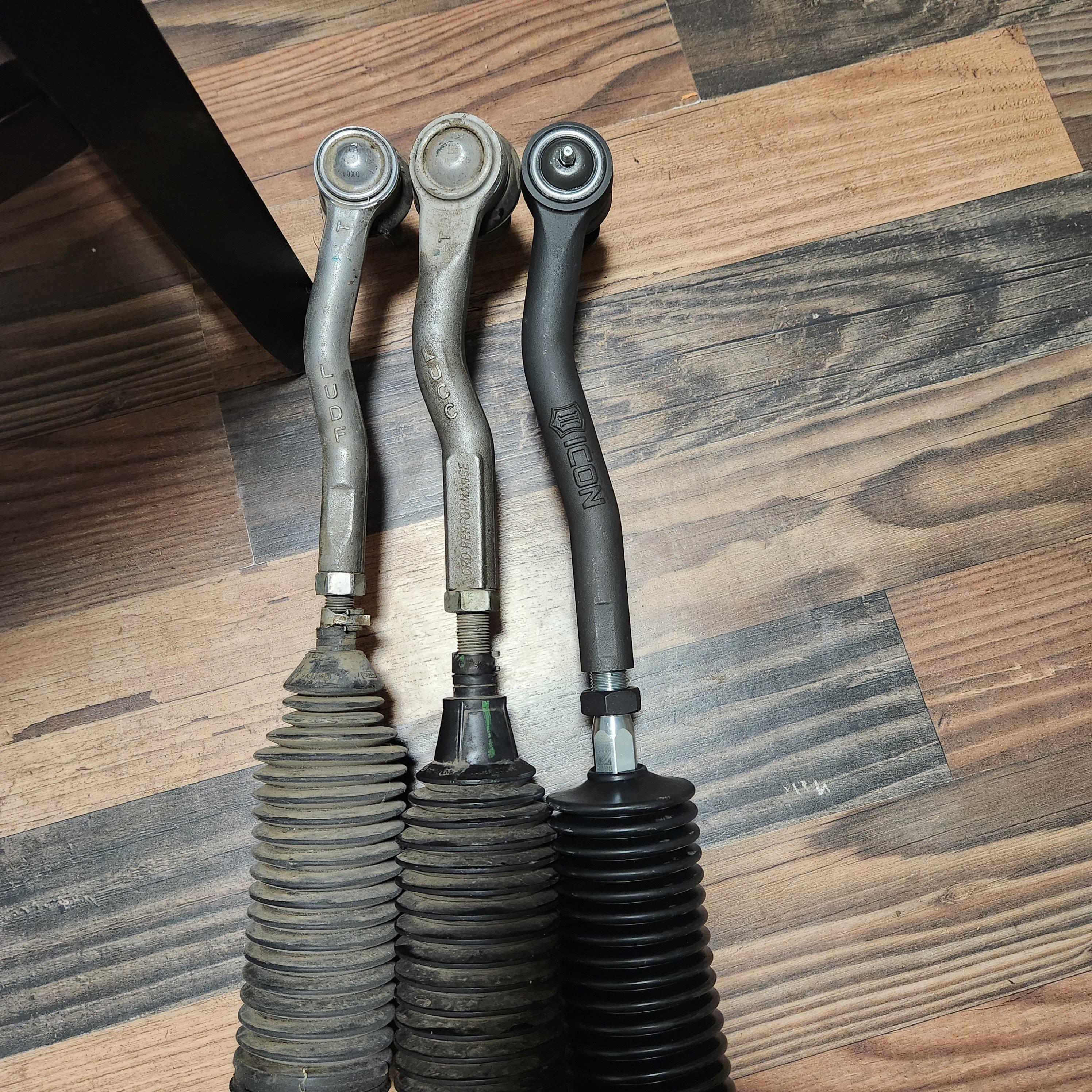

I installed my new ICON tie rods today...
these are WELL BUILT and definitely bigger and stronger than even the Hoss 3.0 tie rods, or Braptor tie rods.
IMHO these are the BEST tie rod option available at this time.
Everything fit perfectly EXCEPT for the smaller hoss 1/2 boot will NOT fit correctly on Hoss 3.0 housing. the housing is substantially bigger and stronger. ICON, you need to offer a bigger boot for the folks that have the H3 racks....or a Wildtrak.
of course the L and R marks are BACKWARDS as mentioned, no biggie unless your drunk or dumb during install. just install them in the same orientation are the ones you removed.
left to right pics....hoss 1/2 , hoss 3 middle, ICON on far right.
overall satisfactory, but boots need improvement @Dusty at ICON
while your making the bigger boot to fit the WT3 (and most likely the Braptor too), might as well build a inner joint with a 3" longer threaded shaft for the Braptor and the long travel folks....
also the clamps are junk, thin and weak. not using them as any water or mud entry is disaster for my fancy WT3 rack.
why not offer a upgraded HD boot as well? too much at risk here for a poor boot design. we need a better boot than OEM, not worse!!!
Ford Bronco ICON XD Forged Tie Rods 20230405_210657
Ford Bronco ICON XD Forged Tie Rods 20230405_210631
