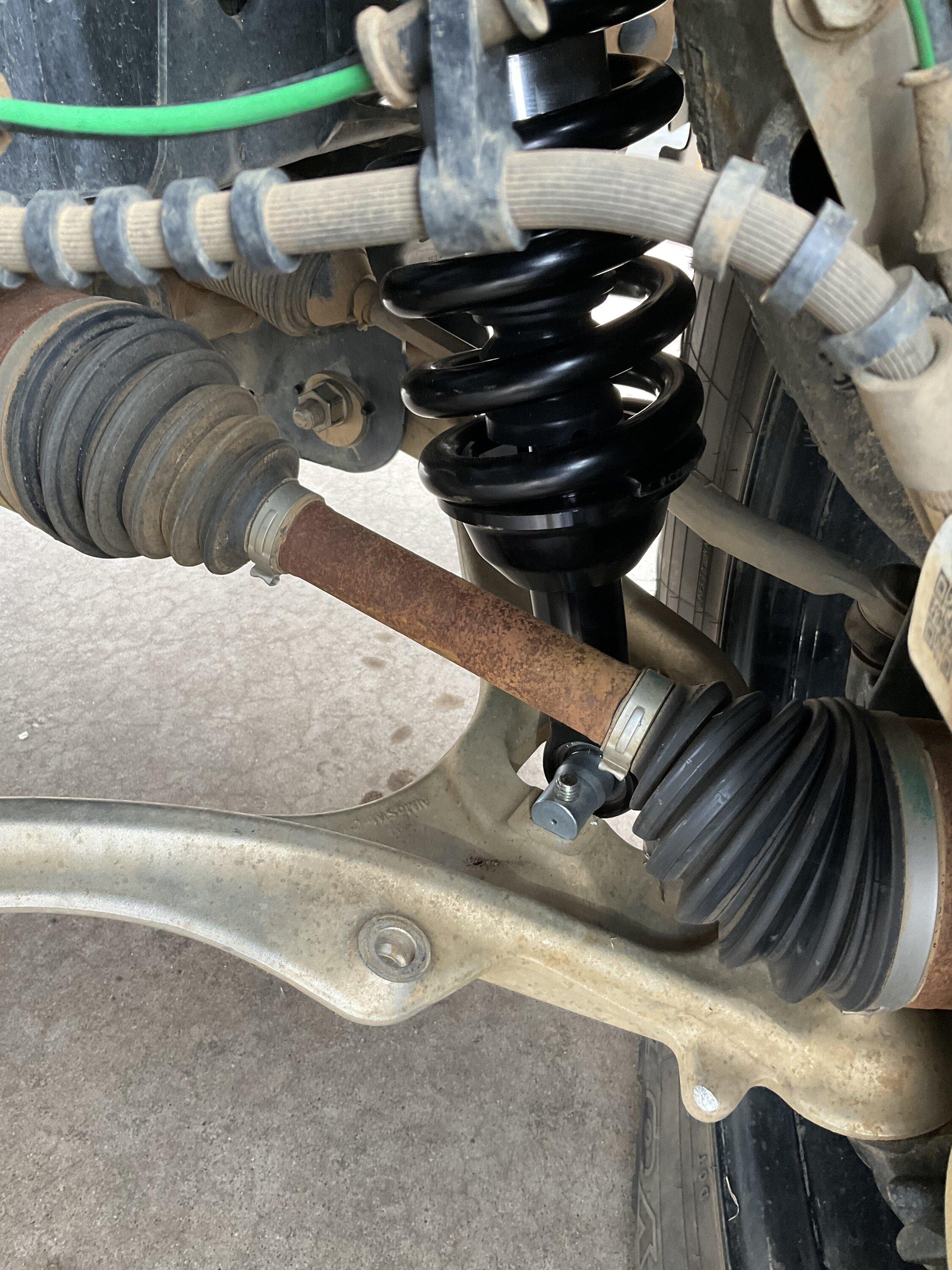

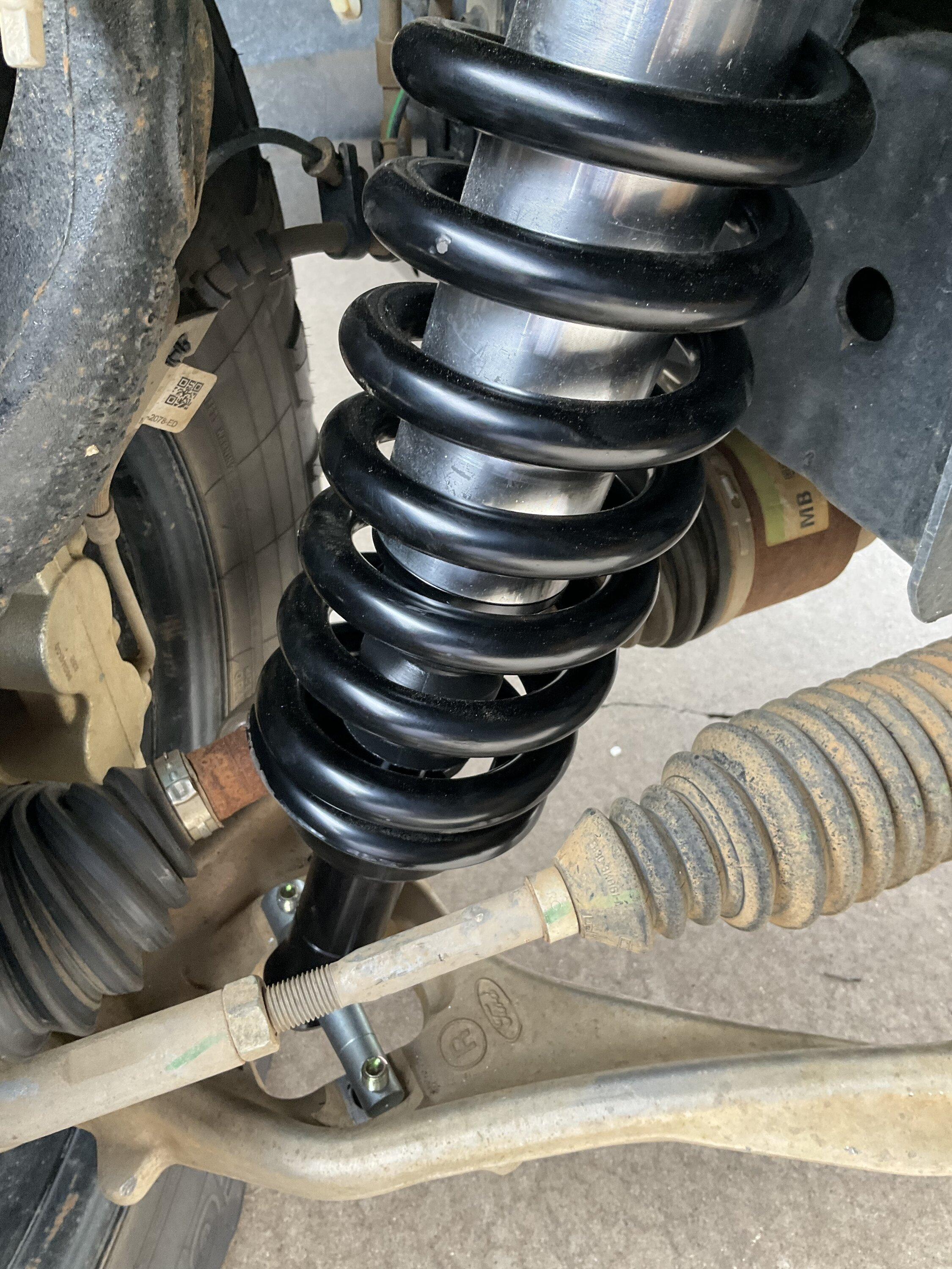

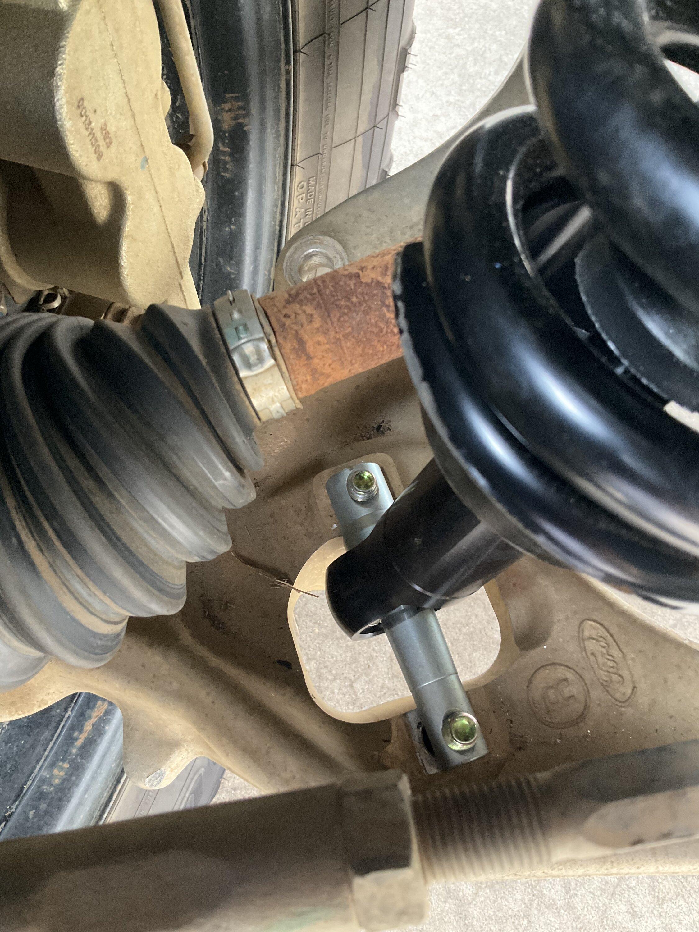

Installing my replacement coilovers and want to make sure this is the current way to do it. I installed them backwards from the original instructions to push back from the tie rod. I’m now concerned about the axle at full turn, full stuff.
Does this look right?

Looks right. The offset should put the shock body farther from the steering link and allow room for beefier links or bracing. That is exactly how I have mine.
