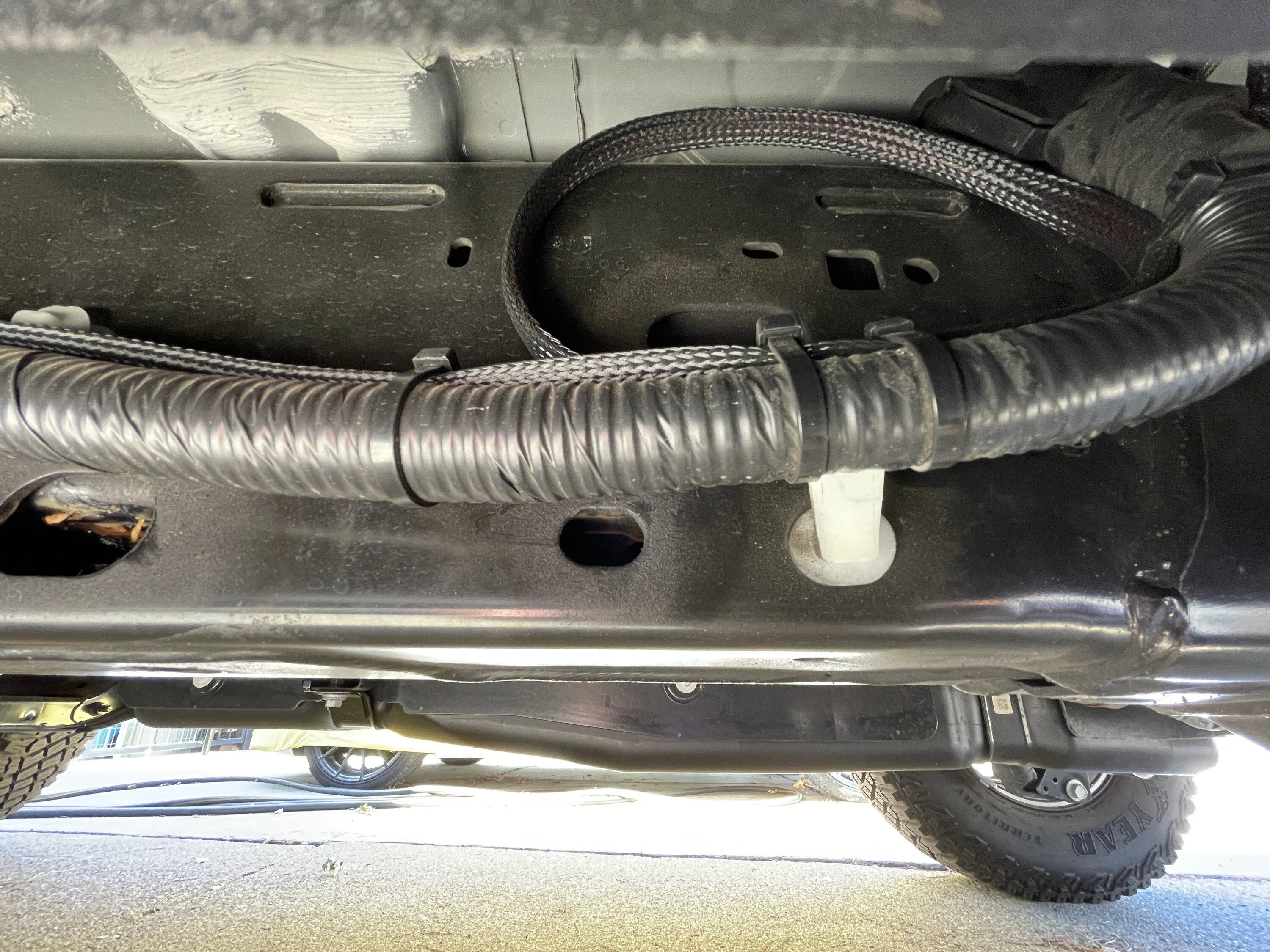

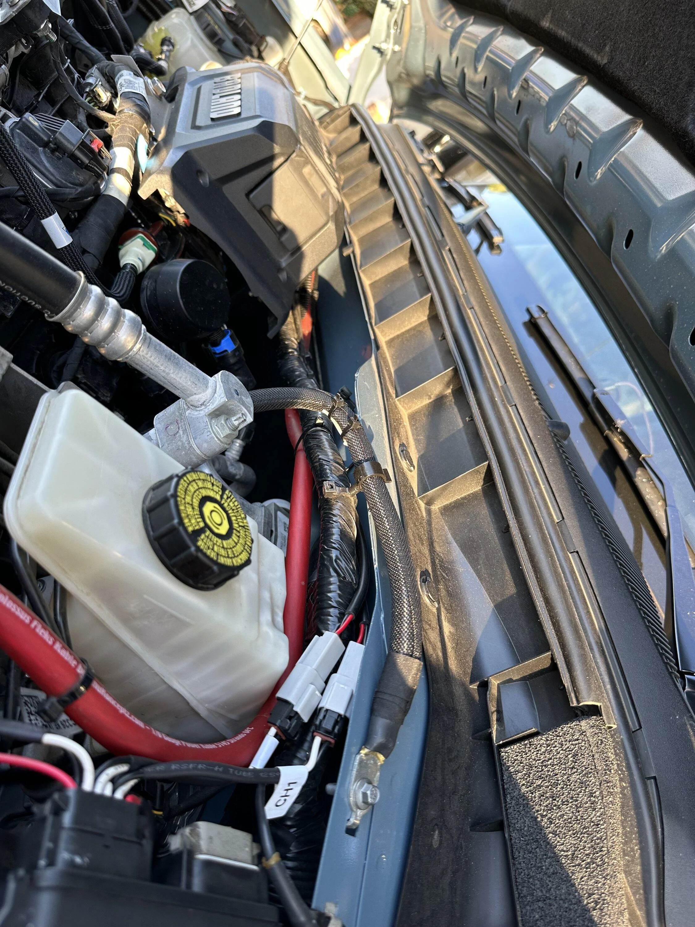

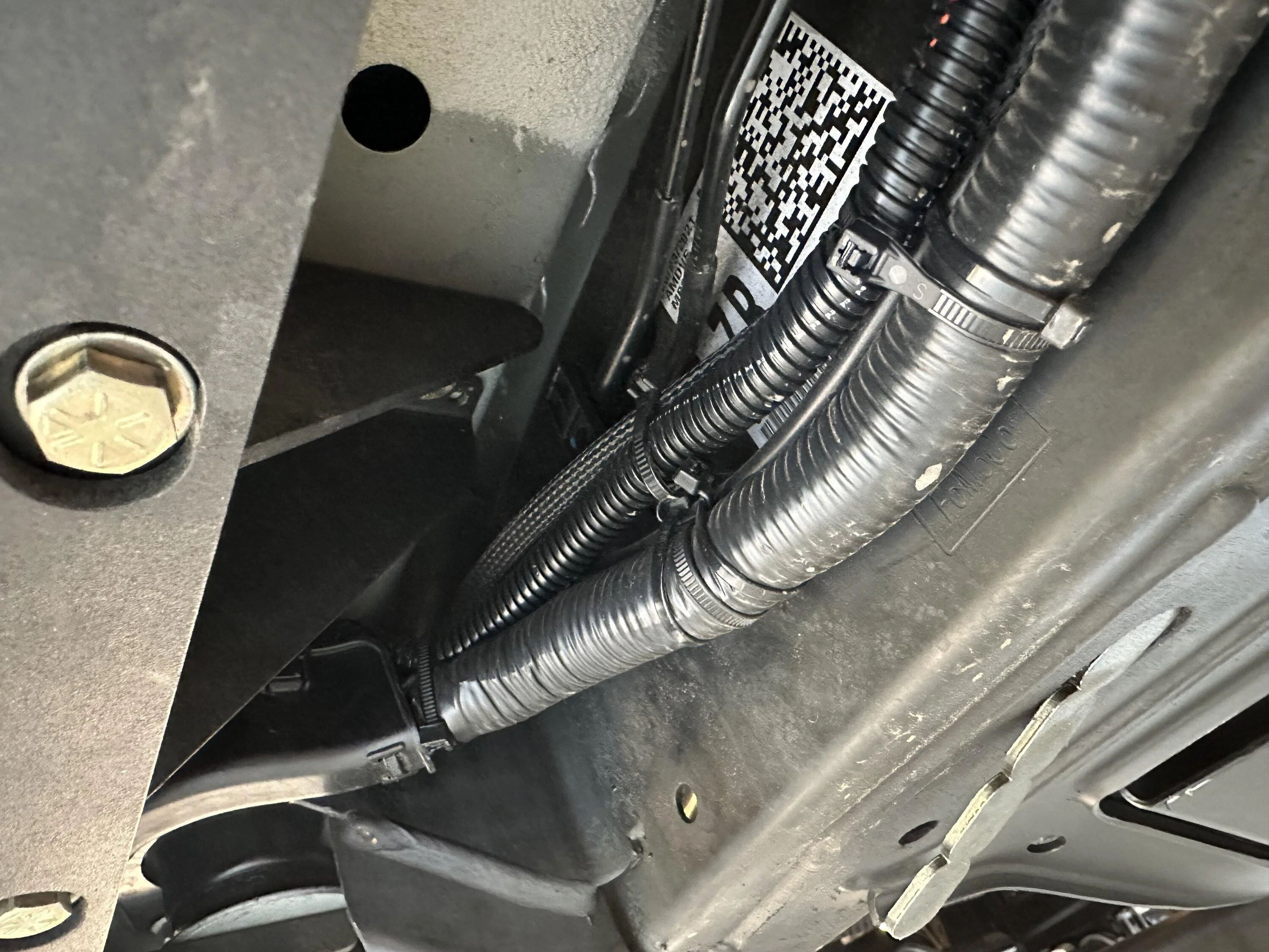

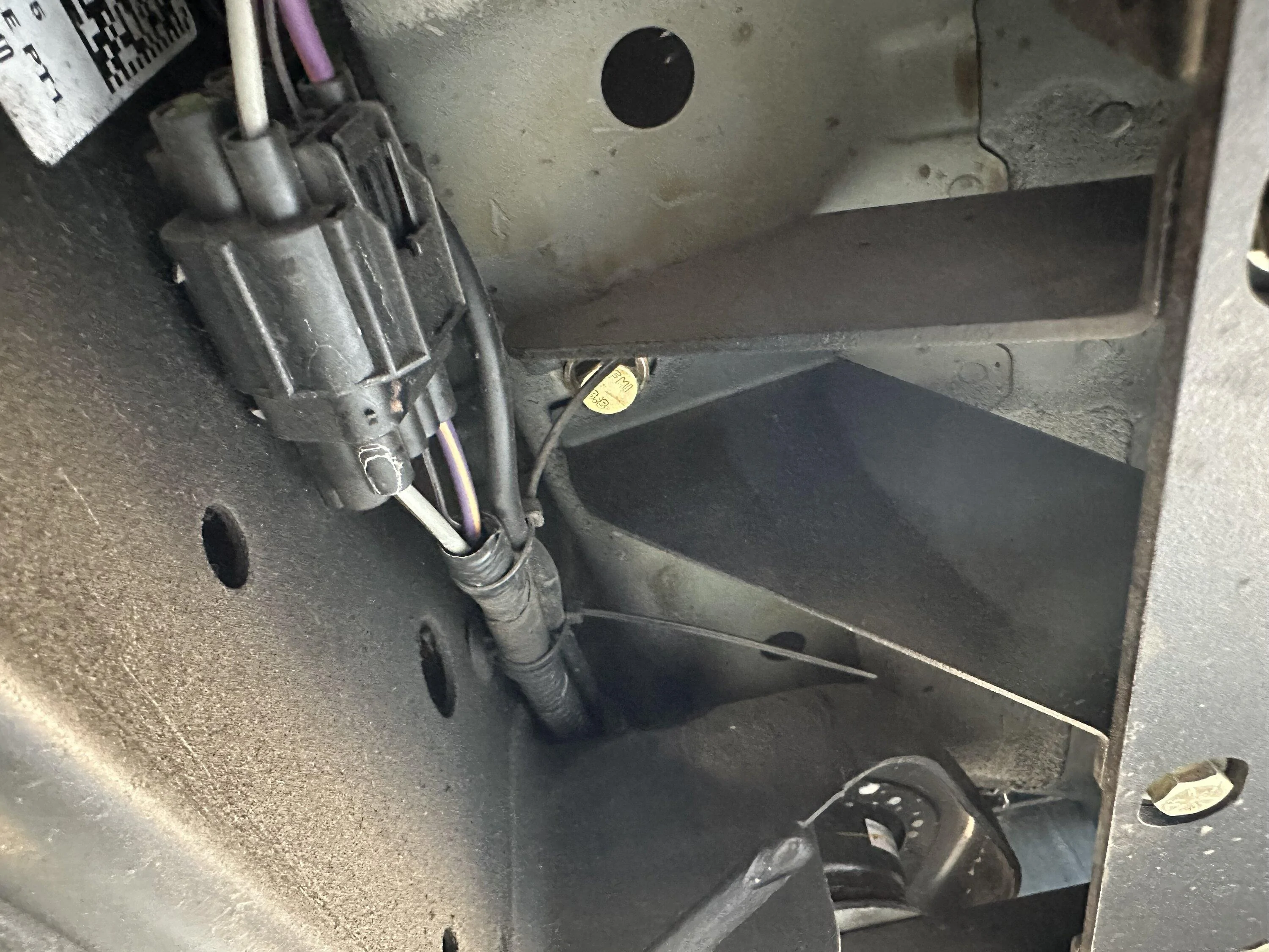

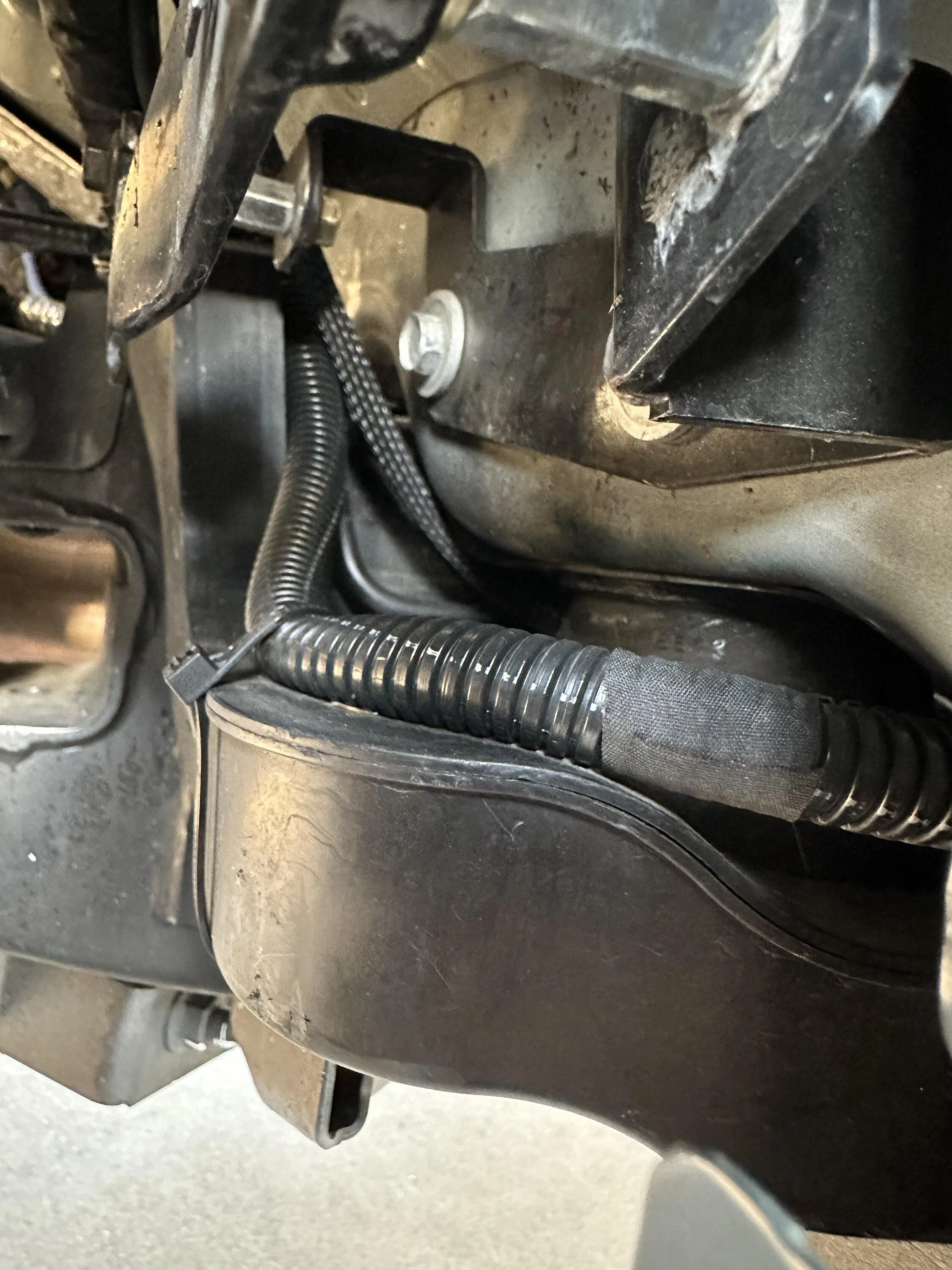

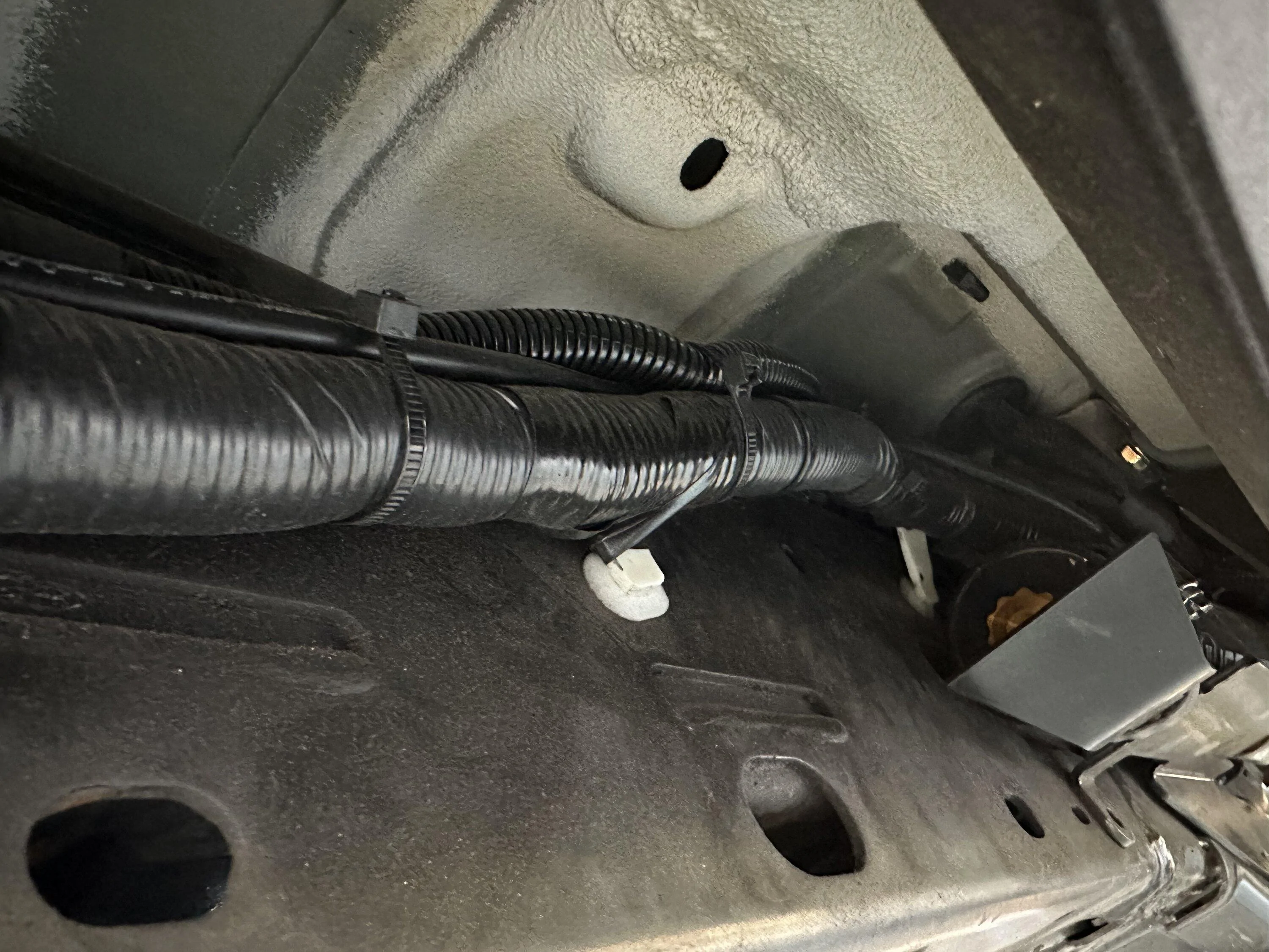

I also have the RSE steps installed and am about to install my Icon CDEV coilovers. One question am I supposed to pull the factory wire harness support out of the frame and muscle it up over the top of the bracket and reservoir? Not much in the way of instructions and the photos aren’t much help explaining what to do
You will not need to do anything with the factory wire harness. You will simply run the (4) individual shock wires in the direction of the shock and zip tie them out of harms way. (2) of them will run along the exterior firewall to the passenger side and the other (2) will run along the driver side frame where the factory harness and your RSE harness runs. I zipped tie to the Frame in the middle of the way to the rear where there were no other existing wires available to offer support.
Thanks for the excellent photos

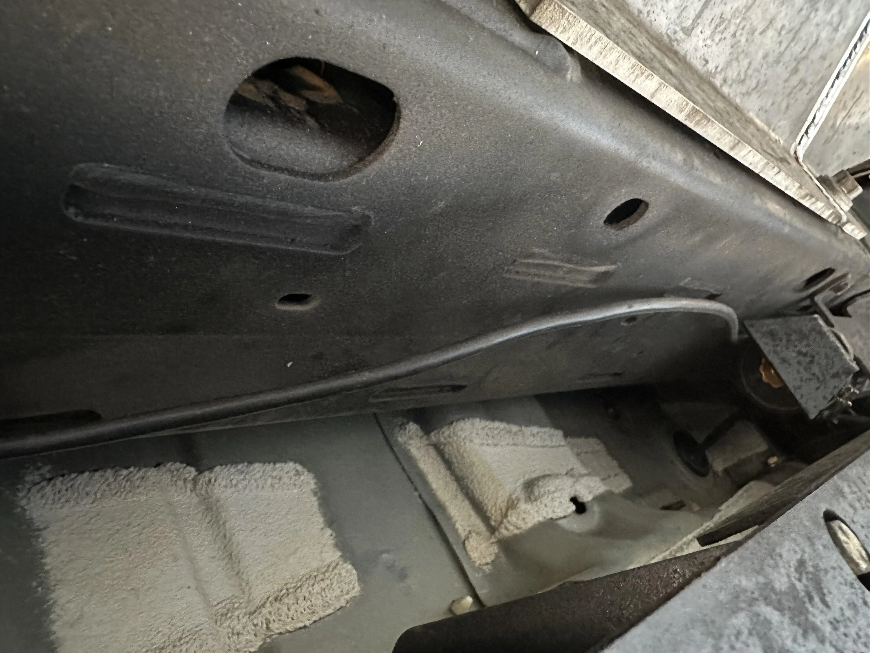

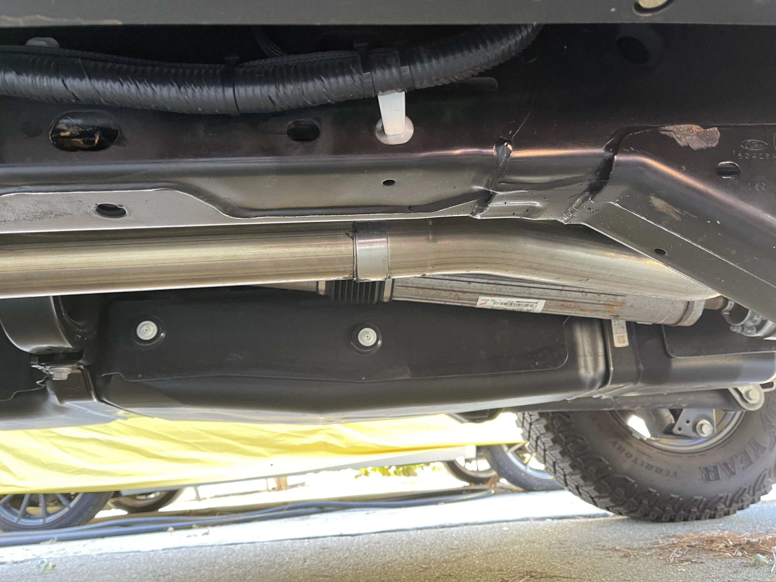

@Defyfate11 Looking at your photos especially the third one I see a major difference between your factory harness and mine. I’ve reposted your 3rd photo and photos of the same area on my frame and you can see that the long white harness attachment to the frame is way higher on your Bronco and the short white attach point on yours is on the underside of the harness. Did your Bronco come this way or did you change the white attach points and plug the one furthest back into a hole higher up on the frame to get the necessary clearance for the ICON reservoir?
Ford Bronco ICON Complete Coilover Suspension Systems (Stages 3 through 8) IMG_1438
Ford Bronco ICON Complete Coilover Suspension Systems (Stages 3 through 8) IMG_1991
Ford Bronco ICON Complete Coilover Suspension Systems (Stages 3 through 8) IMG_1989
