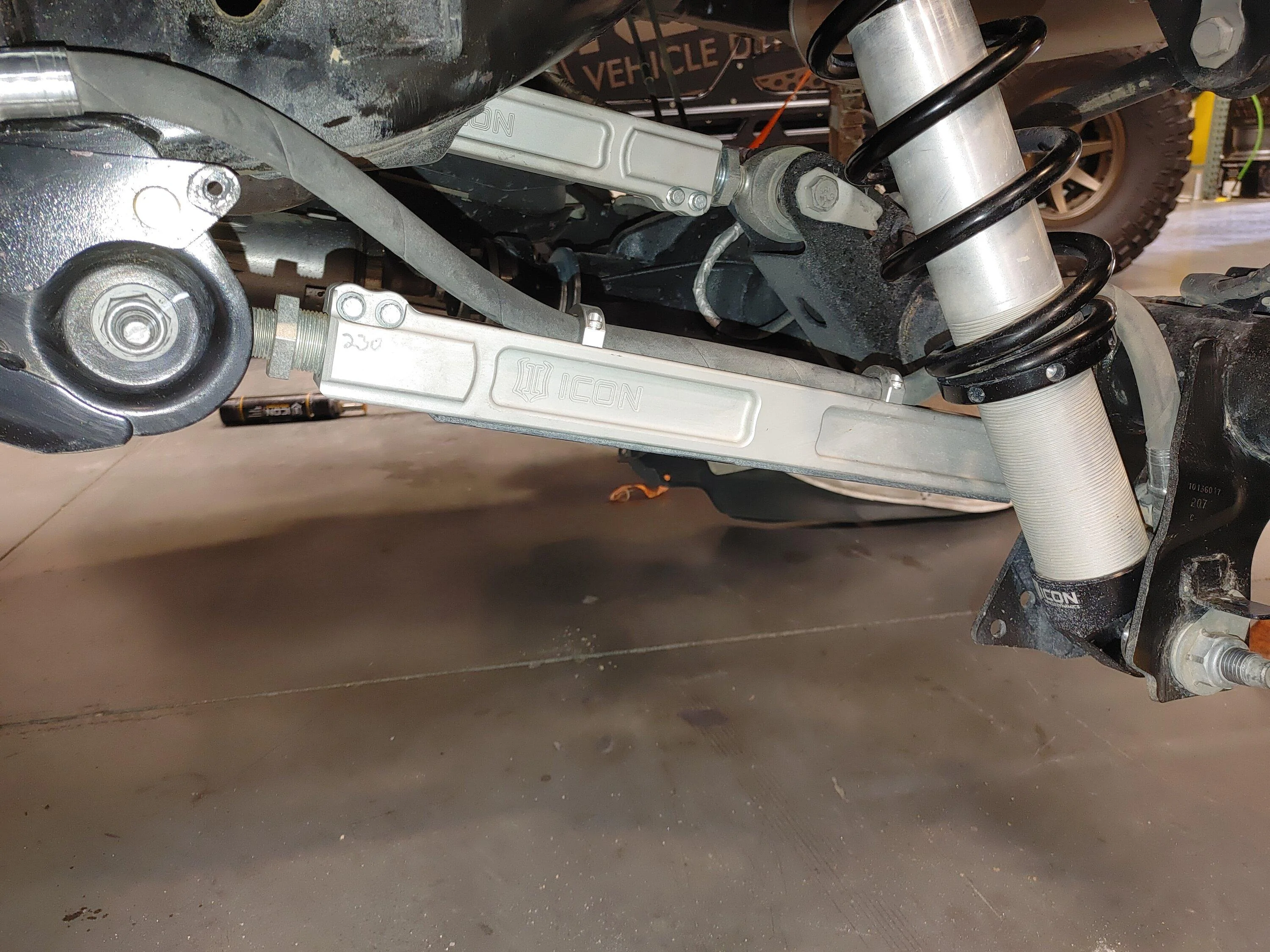

To run our remote res rear coilovers with our tubular lower links you have to use the specific billet tube clamp kit we sell for that specific applicaiton. It's sold separately because some will need a different kit that we offer for use with stock lower links (which are a different diameter). Here's a pic of the kit.
Ford Bronco ICON Complete Coilover Suspension Systems (Stages 3 through 8) 611073_Bronco_HoseRoute_KIT_web_larg
I don't have any photos handy of it installed but perhaps some of our customers can chime in with a pic or two.

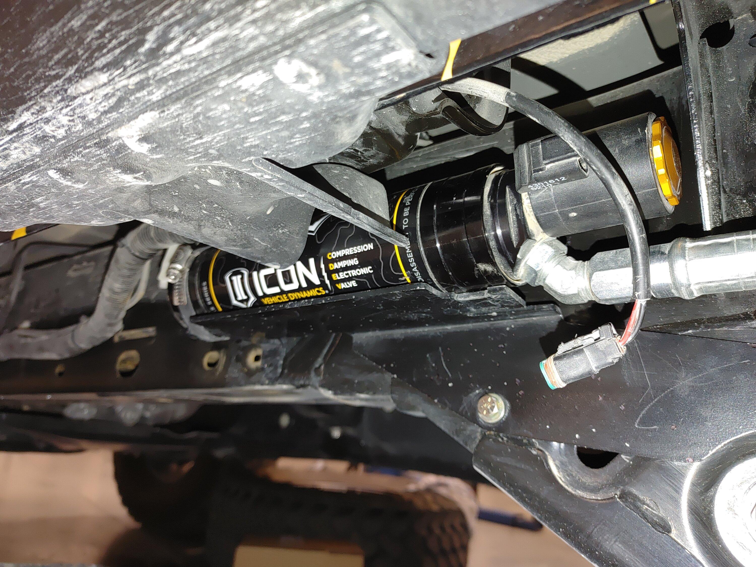

Not ICON but not sure I understand the tub clamps?? Attach res to lower link?
@Dusty at ICON
Our rear coilovers mount shaft up/body down, so the reservoir hose comes out the bottom, not the top. The hose is routed up the lower suspension link (with the tube clamps) and the reservoir is mounted along the frame rail.

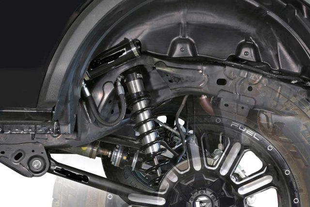

Here are a couple of pics with the billet links. The hose is routed the same on the tubular links but using the clamp kit I posted above.

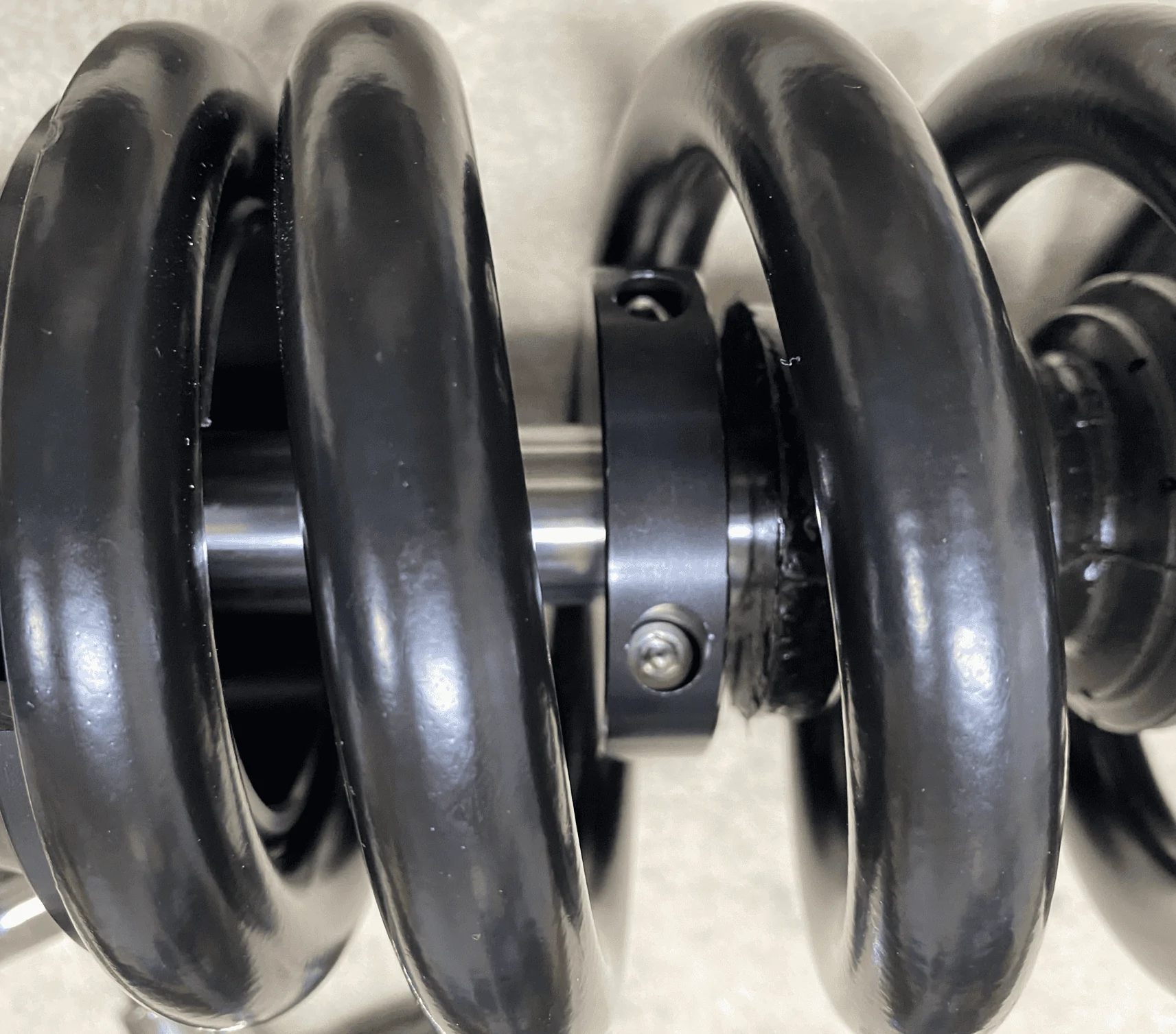

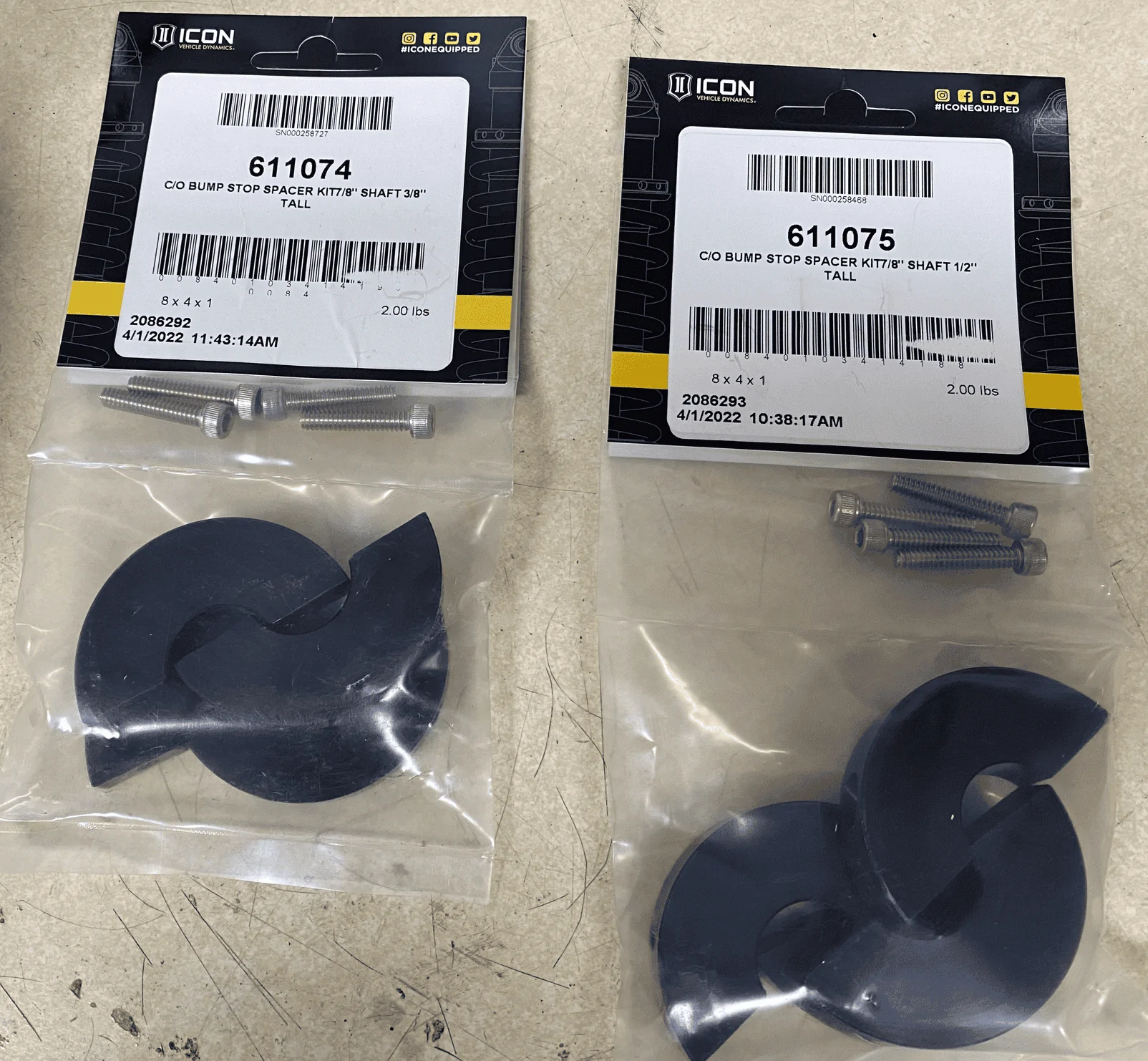

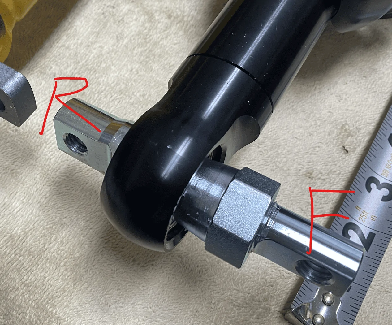

1) They have bump stops for up to 35" tires.
2) the additional bump stop spacers for 37" install on the shaft. They are semi-circular pieces with allen bolts so they can be installed without disassembling. They can even be installed after coilovers are mounted on the bronco.

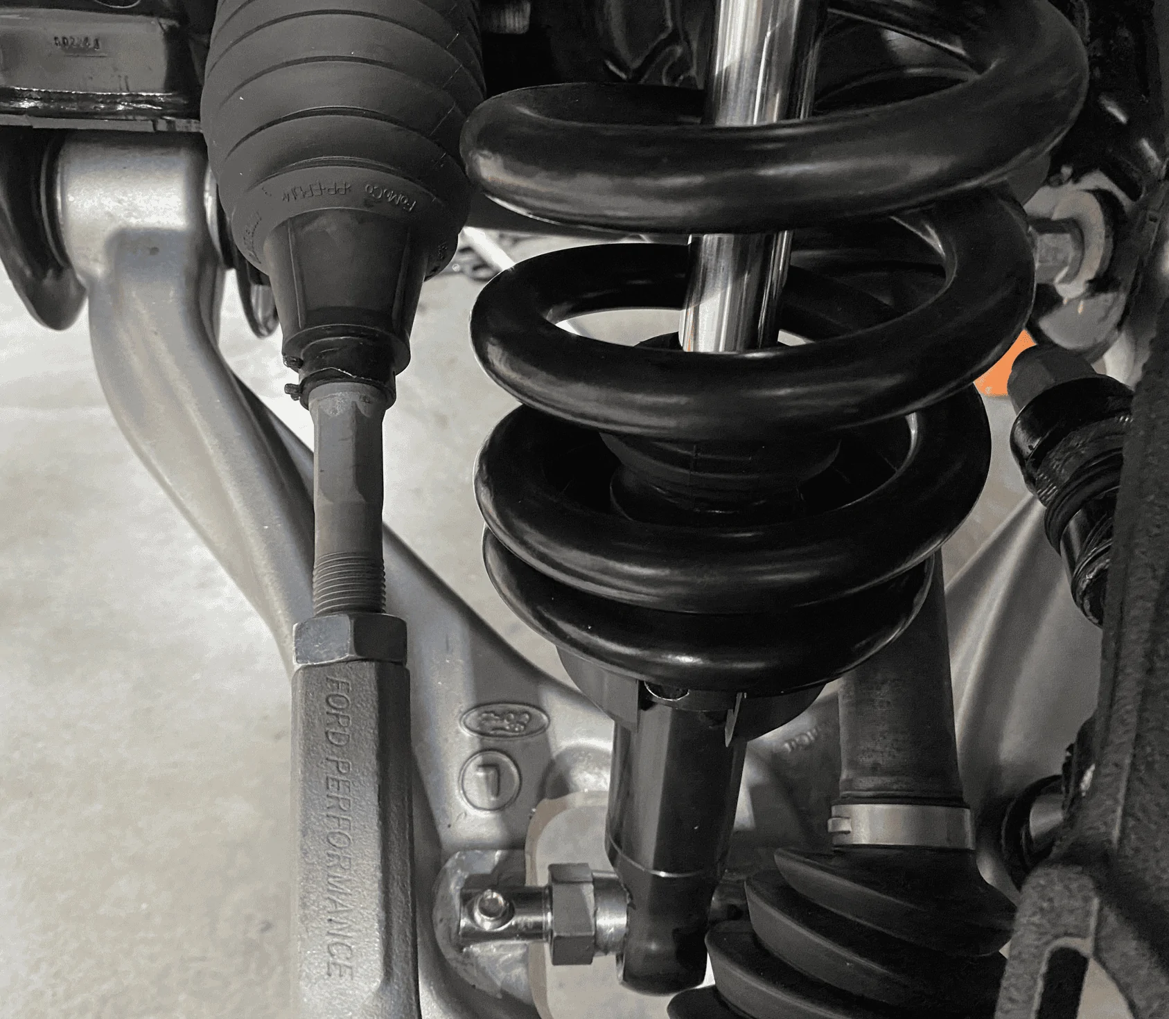

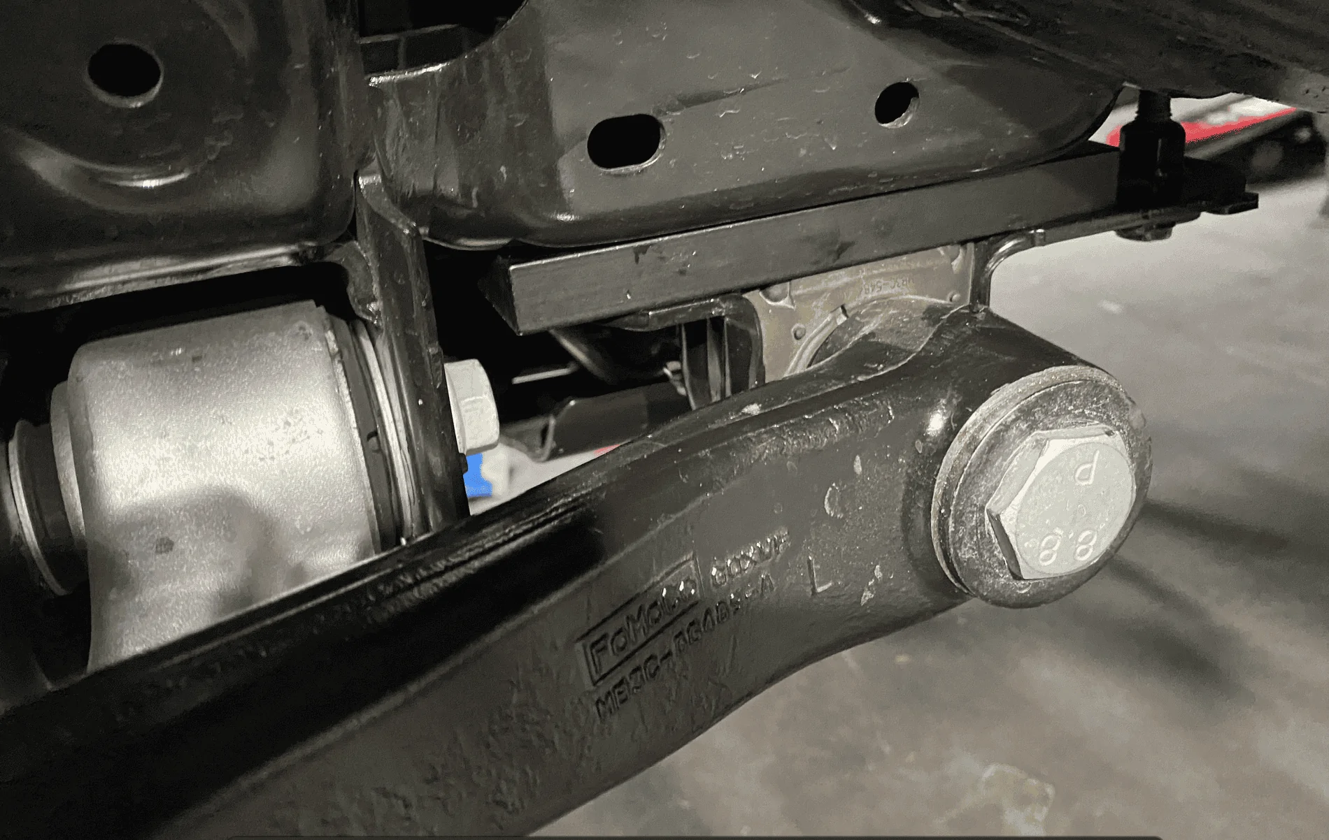

3) Simply rotate the lower coilover mount 180-degrees so that the coilover is located rearward. The Icon or Hoss3 tie rod helps clearance in the sense that you don't need to use a tie rod sleeve. You may also need a swaybar spacer if the swaybar link hits the lower coil.

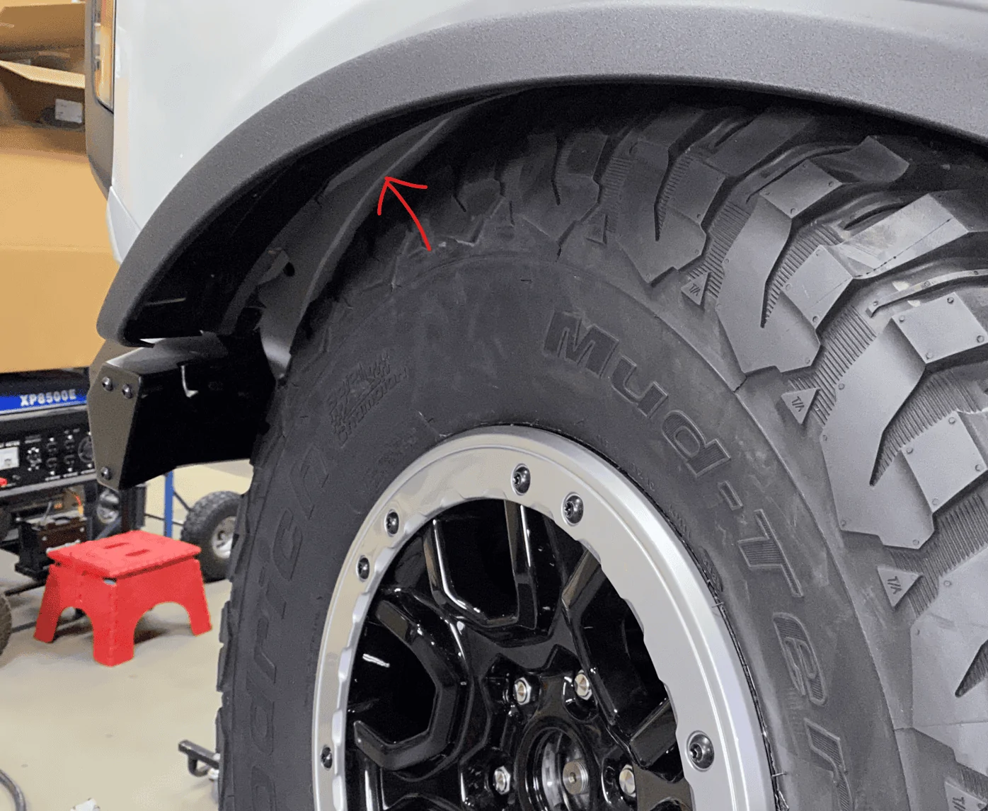

This isn't icon-specific, but worst contact for low speed is the probably the main body with wheels at full lock (photo with liner removed). For wheels straight there is more clearance, but it might contact the fender seam on a hard landing. But it is hard to compress the spring and pancake the rubber bump stop that far.
