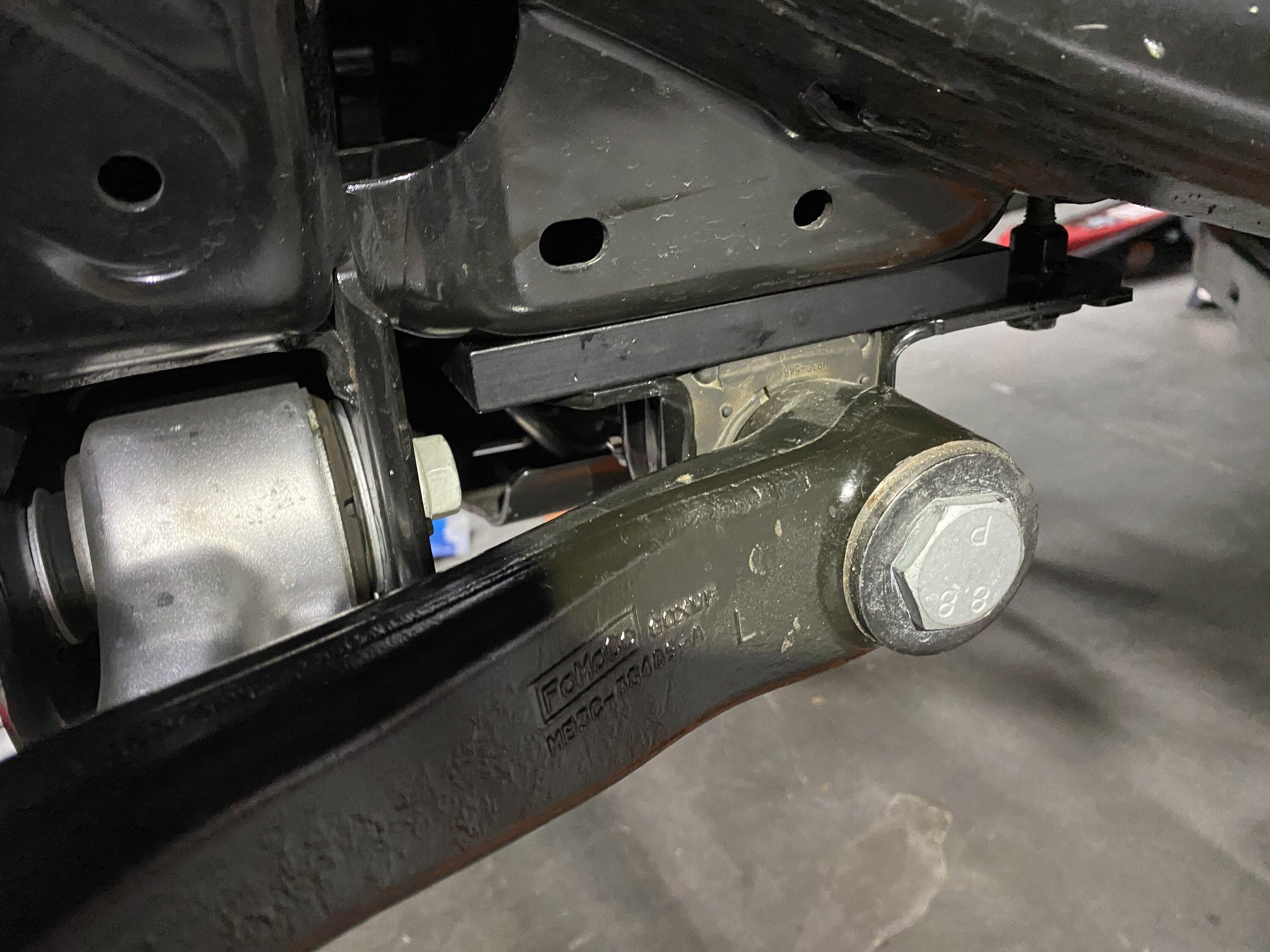

Question, in your opinion is the sway bar relocation plate necessary. I've seen mixed comments in the thread related to the Badlands needing it with electronic sway bar disconnect. Have the front and rear CDEV coilovers, and tubular UCA on order. Didn't order a stage kit as plan to go with the RockJock rear links and panhard. Was wondering if I needed to reach out to Dusty or Scott with Icon to find out if the swaybar spacer is included with the CDEV front shocks or has to be ordered separately..
@Dusty at ICON
I did not need the plate but added it for a bit more room just to be safe. I had swapped the bottom of the coils front to back (the bottom bolt rotates) and it opened up plenty of space for both my aftermarket tie rod reinforcement and the sway bar. Did not rub on either side at full flex.
You have to remove the sway bar from chassis as part of the install anyways so I recommend throwing it in while you’re at it if you can. The spacer was in the box with my replacement front coil over kit, so I’m hoping that means it’s included in all kits now.

if you drop the sway bar skid, you’ll have one bolt and one nut per side holding on the sway bar itself. The nuts thread on to threaded inserts that you’ll need to remove. You can back them out with a socket or impact quite easily. Be gentle with the impact. Use the 4 new supplied pan head bolts to attach the billets to the chassis, one on each side. You’ll see the proper holes in the billets with cut outs to fit the pan head bolts. This moves your sway bar 1/2” lower and maybe 1-1.5” towards the rear of the vehicle. Reattach your sway bar when ready.
I’m going from memory, so hopefully somewhere in this is the info you need. There were no directions that I found with my kit but my mechanic and I got it figured out.

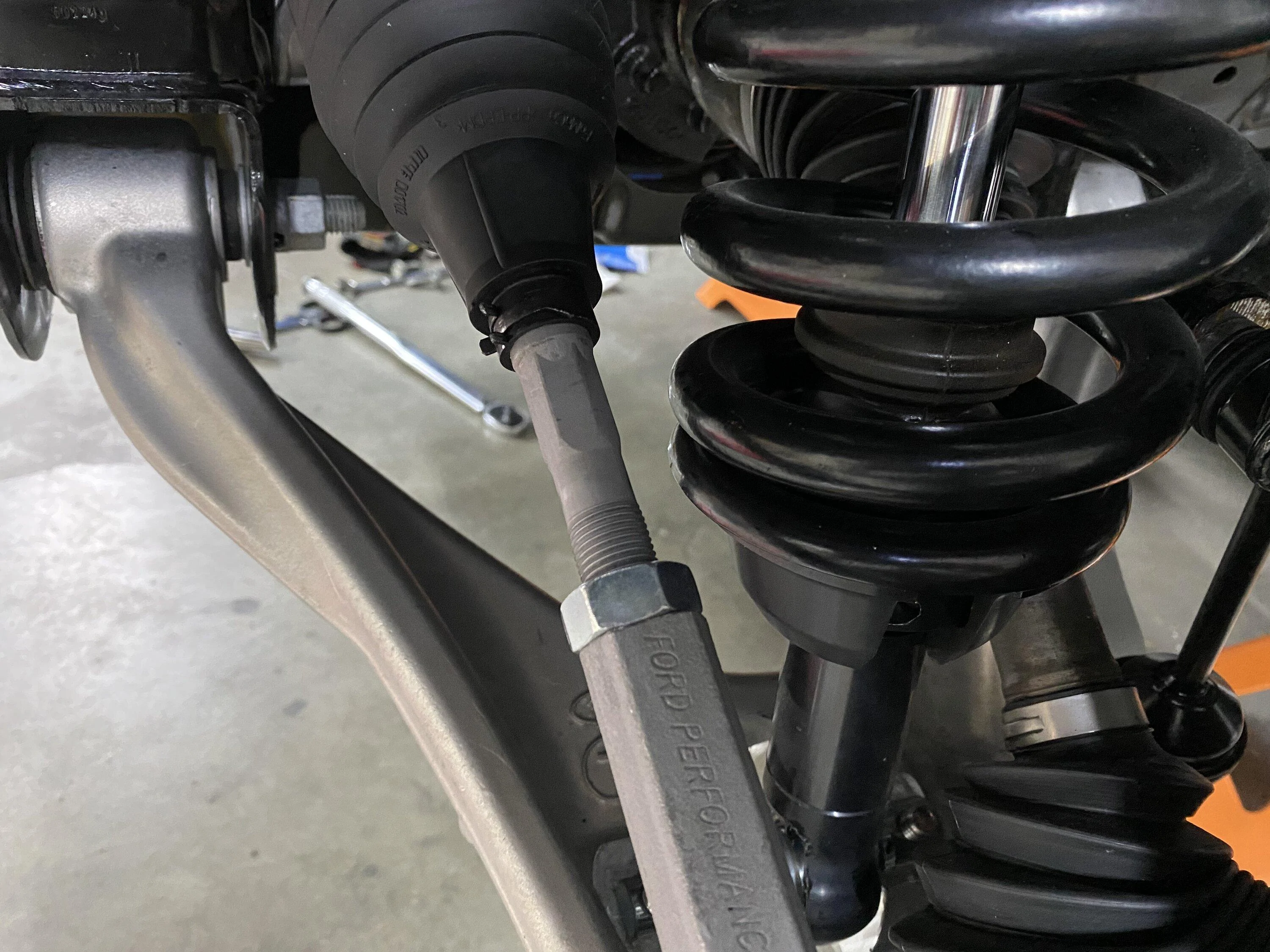

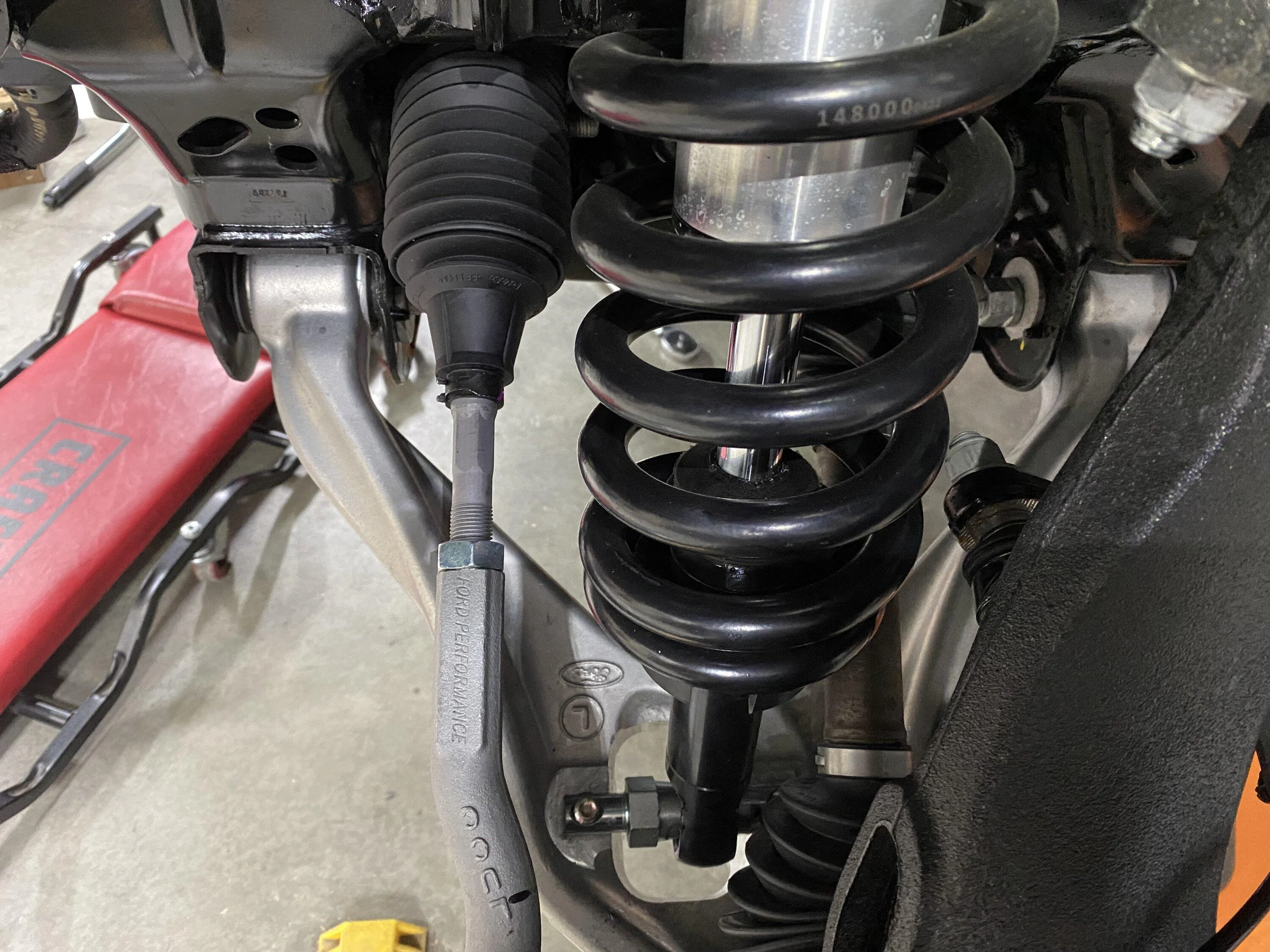

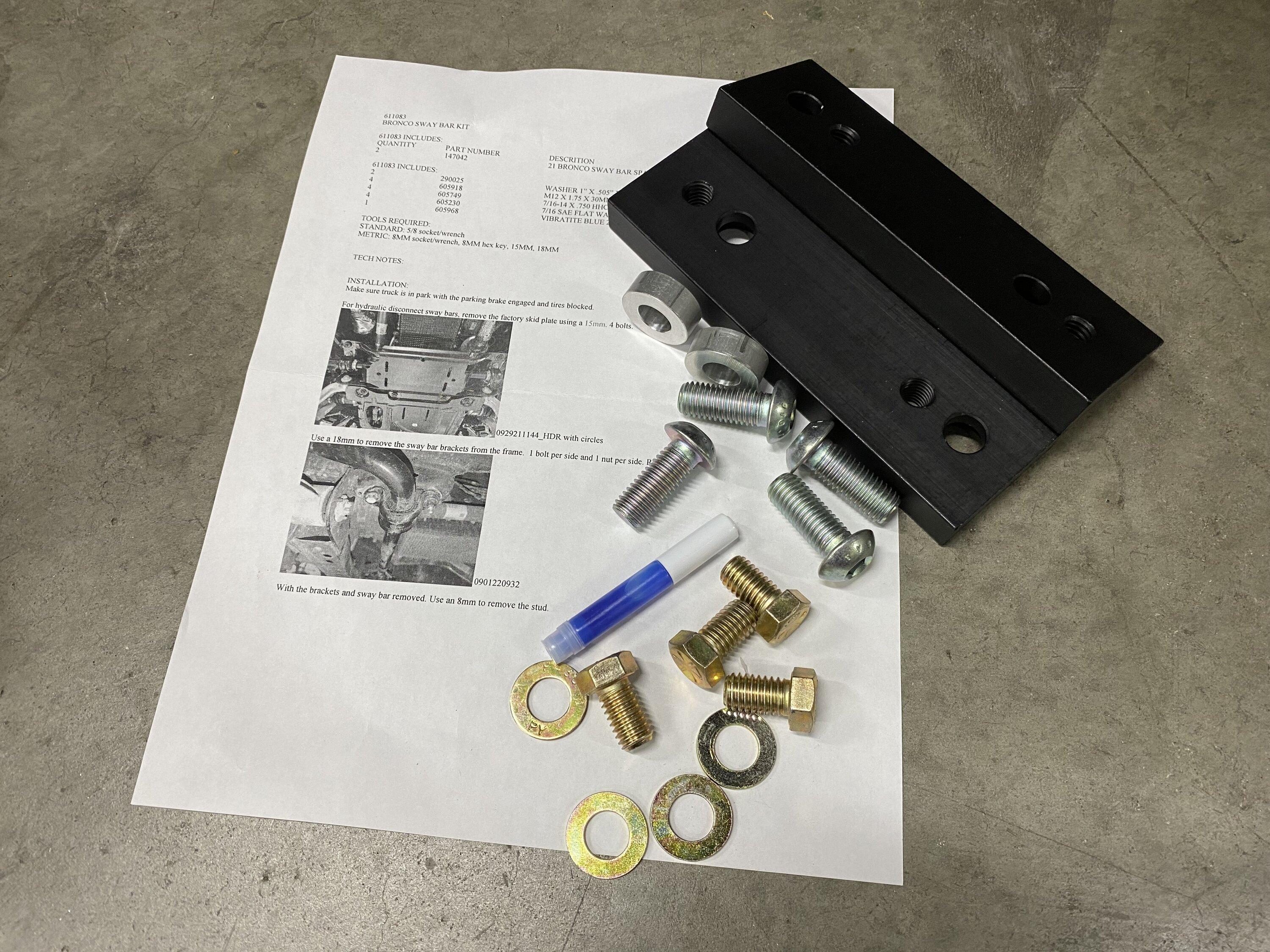

I received and installed the Icon swaybar spacer kit. I also installed the upgraded steering rack and tie rods (wildtrak hoss 3.0 parts) on my badlands. Plenty of clearance now!

How did you get the rack to program and work?

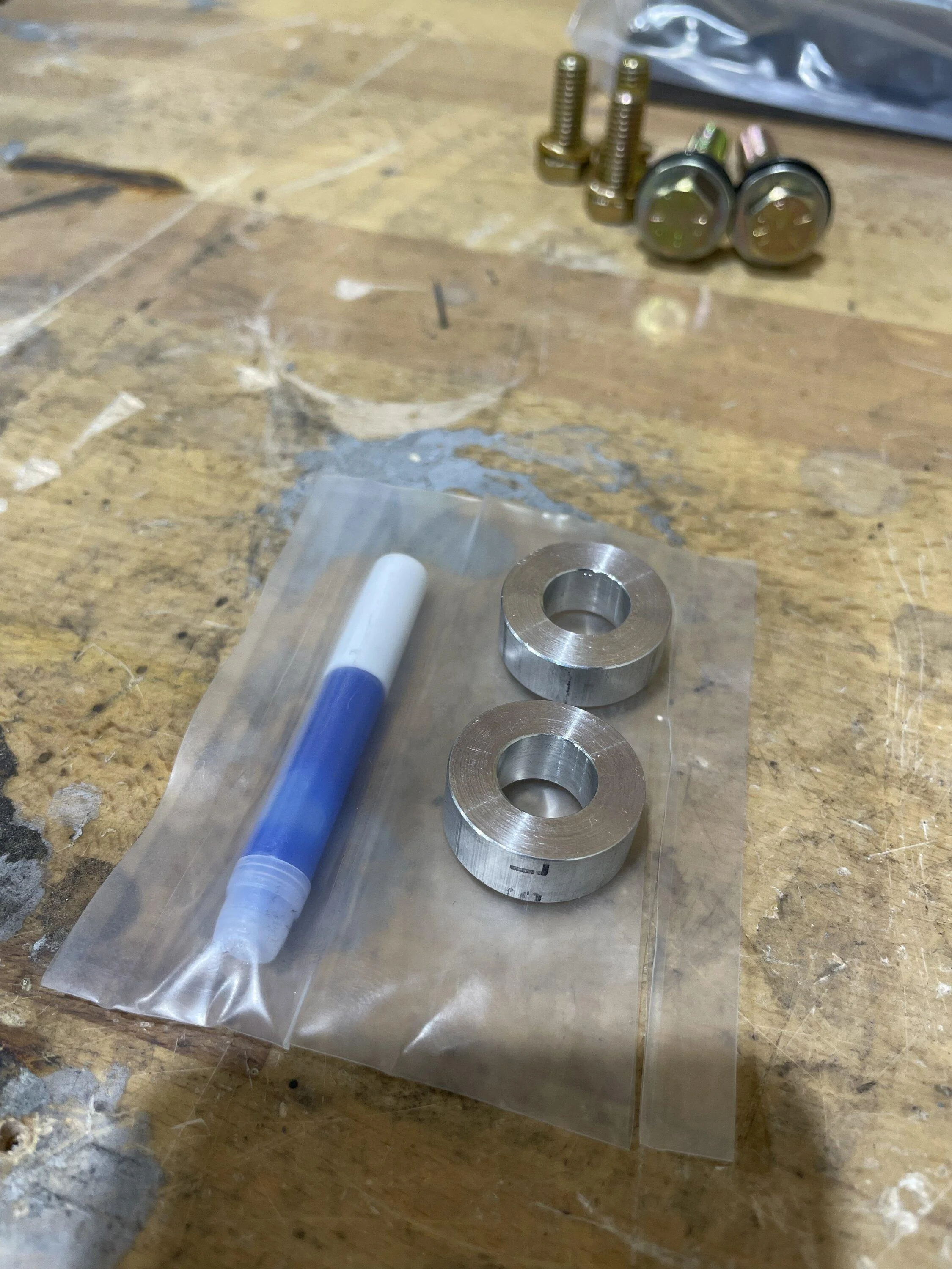

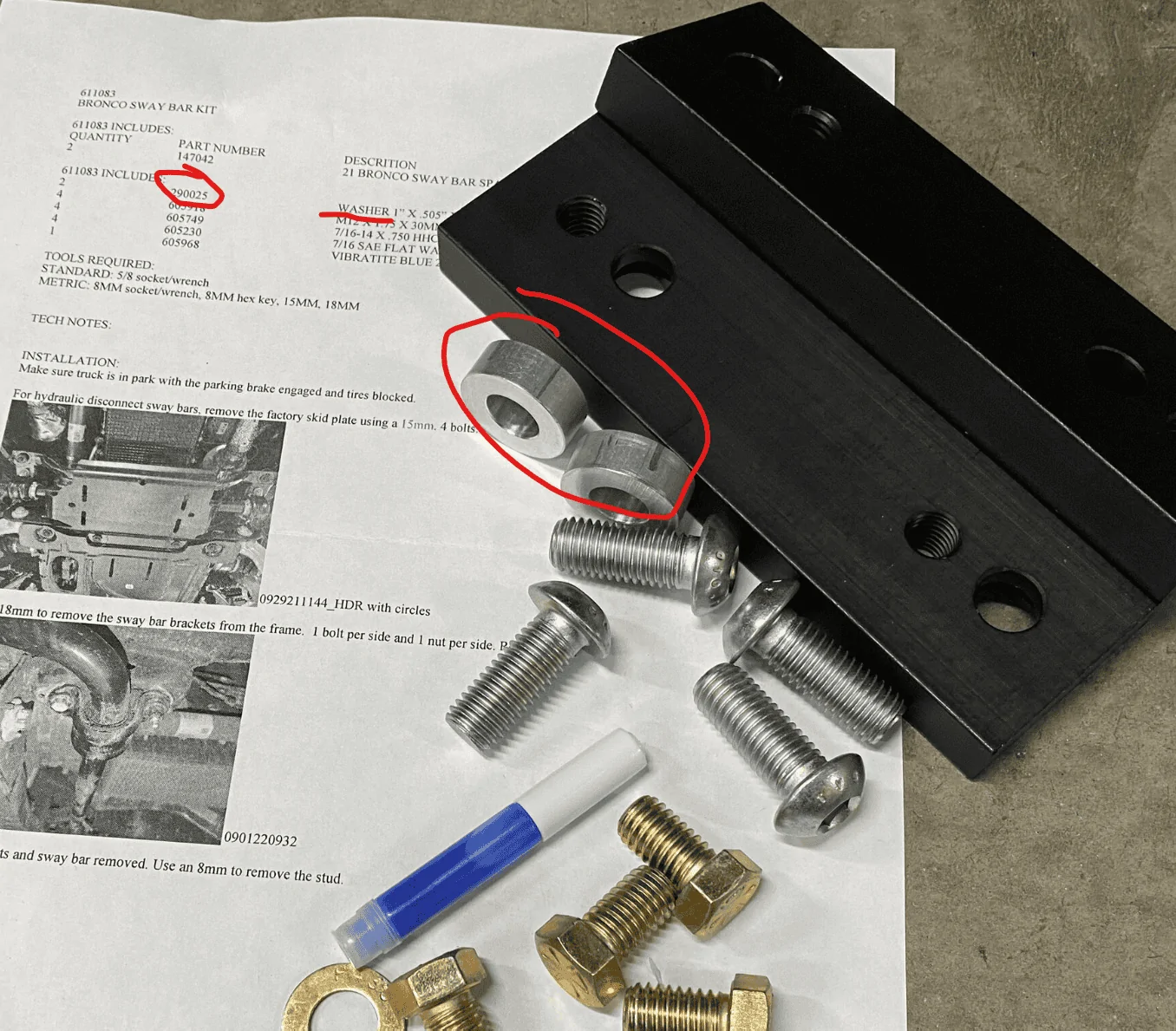

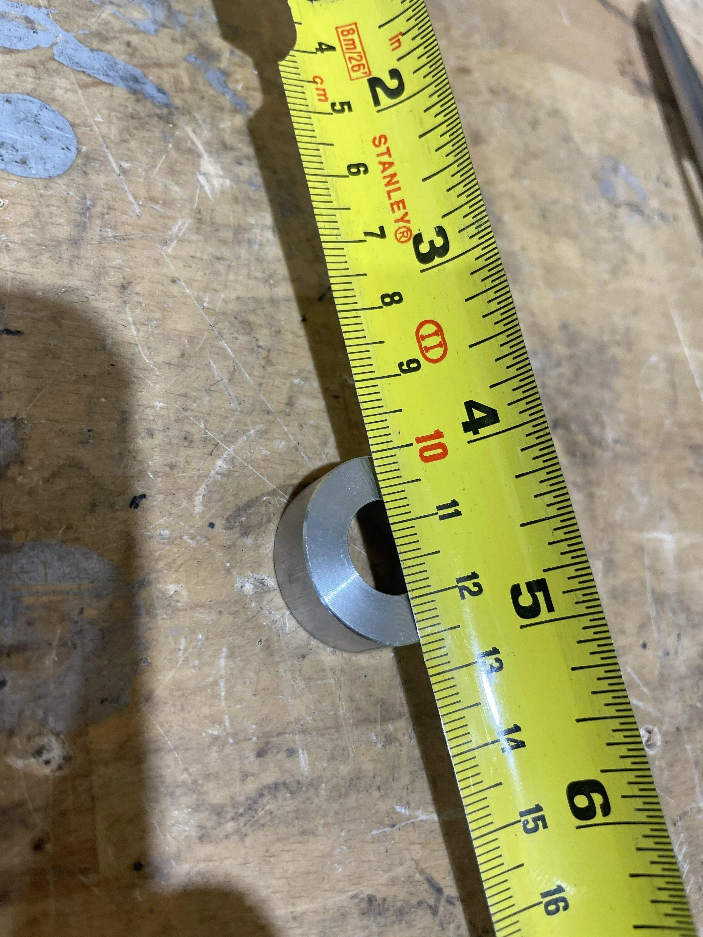

He was unable to answer my question about the extra parts and asked that I email pics to Icon which I did. It has been several days with no reply.

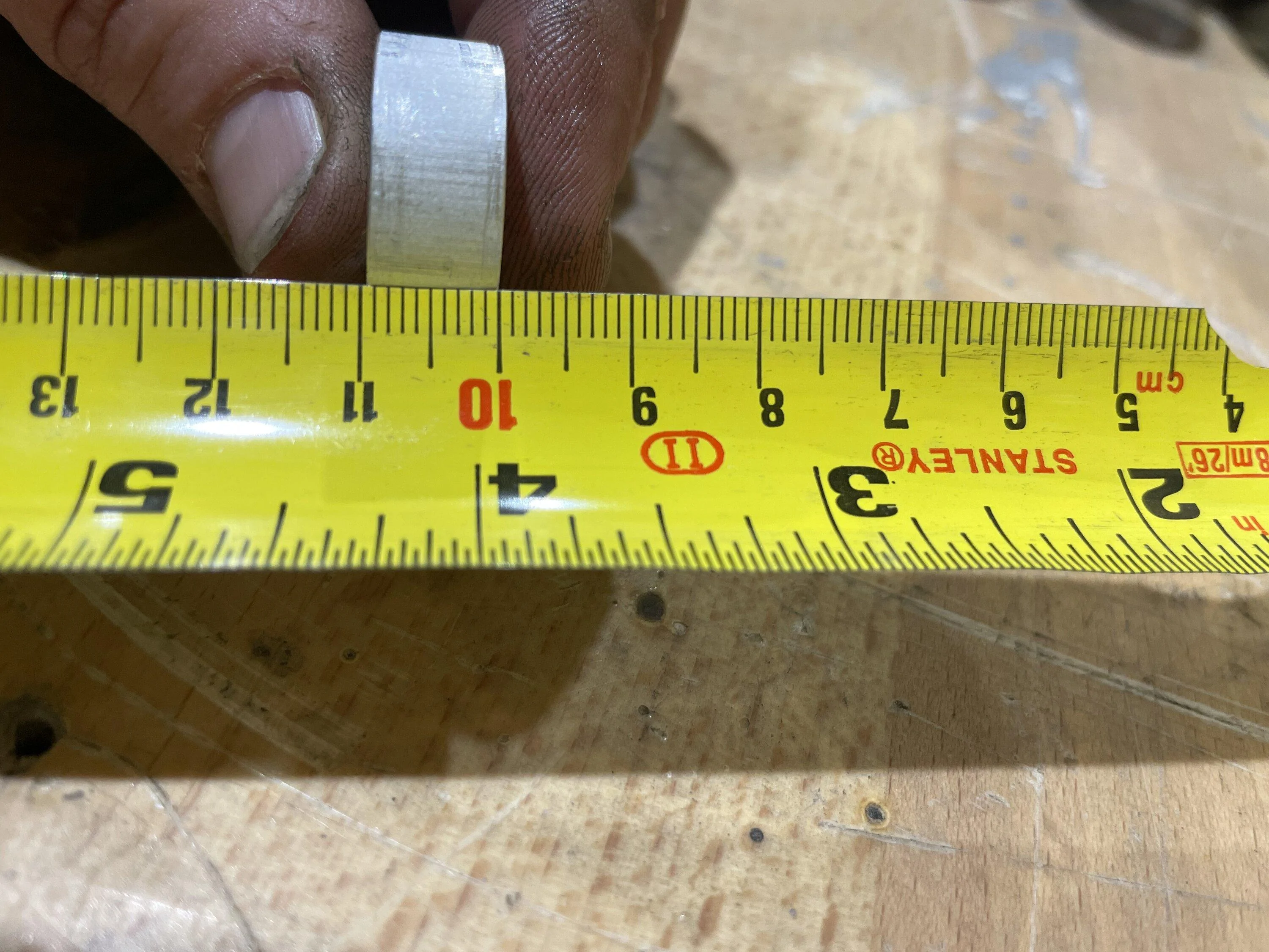

Post photos.
If semi-circular, they are probably the bump stop spacers for 37" tires. There are instructions for them online or look at earlier posts.
If rectangular, they are probably optional spacers for the swaybar to improve clearance (see 4 posts back).

pics of them below

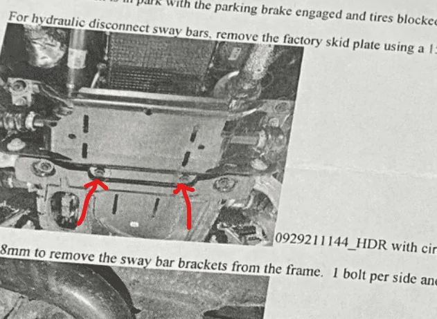

If you installed the optional swaybar spacer on badlands/sasquatch, those are used on the two forward bolts between the factory skid plate and cross member. They are referred to as washers (1" x 0.505" x 0.375") in the swaybar kit instructions (no photo). The rear bolts go directly into the spacer.
The threadlocker is to be used on all of the non-factory bolts on the swaybar spacer kit.

Thanks for the info! There were no directions in any of the boxes so I went to the product page at Icon.com. The direction links there don’t even list the sway bar spacer for the stage 3 system as being included. The tech at Icon had no clue and no response from Icon via email.. after reading thru this thread its obvious they rushed the product to market just in order to one of the first available and overlooked the finishing details.
Oddly enough the Wildtrak didn’t come with the skidplate so the spacers are not needed in my case.
