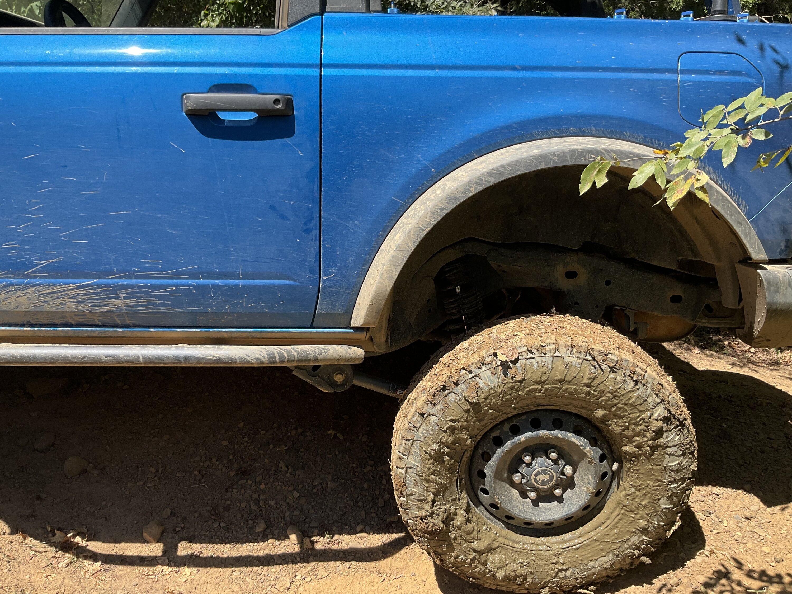

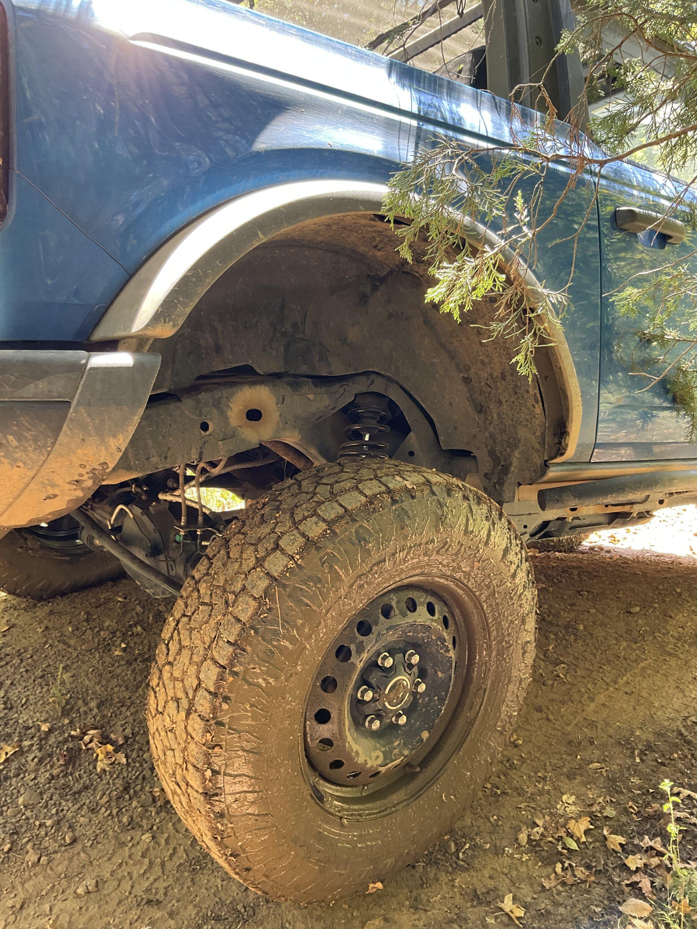

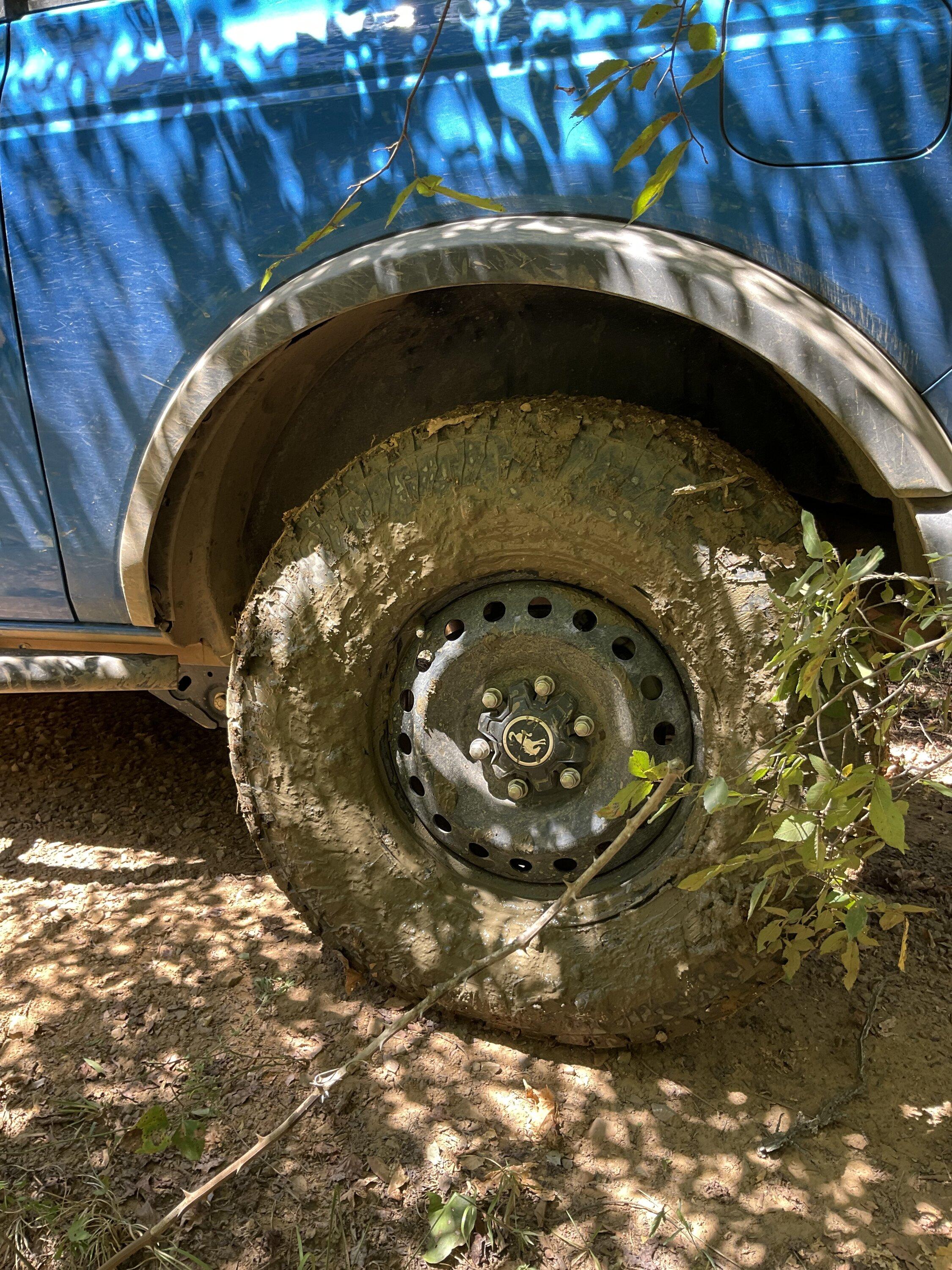

Really happy with rear articulation but the front is bound by the factory sway bar.
These pics are all rear droop and stuff. Wasn’t much of a reason to take a picture of the front.

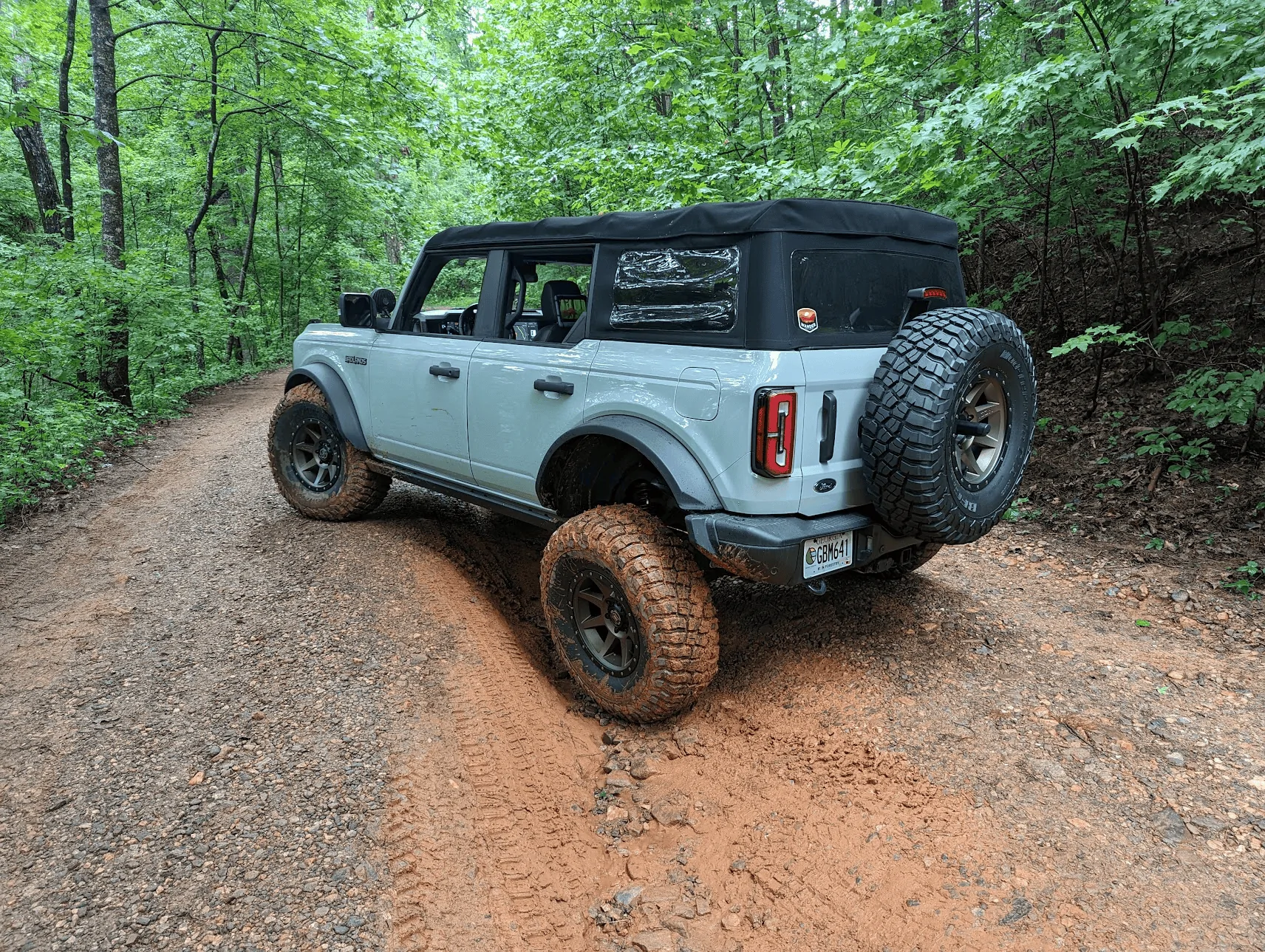

Agreed rear droop is very nice and I LOVE how smooth everything is off-road now.

Everything is a compromise. Usually off road performance as at the expense of on road performance. Any change is going to be different. Maybe better, worse, or just different than factory. Many people go through a couple of changes before they find what they are looking for.
I would say if factory ride is the most important, I wouldn't change it until you need to. I started changing things because I was always lifting a rear tire. I've done several things to increase articulation, but it's at the expense of on road performance. Now, my highway ride at 75mph is still good, it's just different. I still need my vehicle to make long cross country trips and then perform off road once I get where I'm going. It's all a compromise.
The Icons, or any other coilovers, probably won't feel like the factory setup, but that's not necessarily a bad thing.
If factory ride but increased rear movement is your focus, I'd start with the upper and lower rear trailing arms and rear track bar. The factory hard rubber bushings don't allow much movement. Replacing with uniballs, johnny joints, etc. will allow the axle to move quit a bit more but still maintain the factory coilovers.
