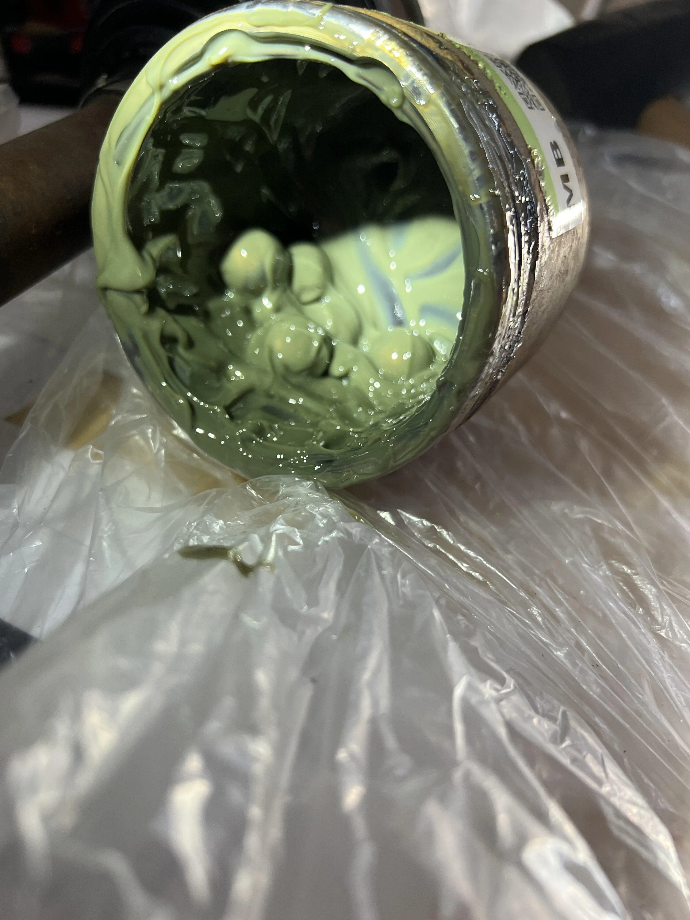

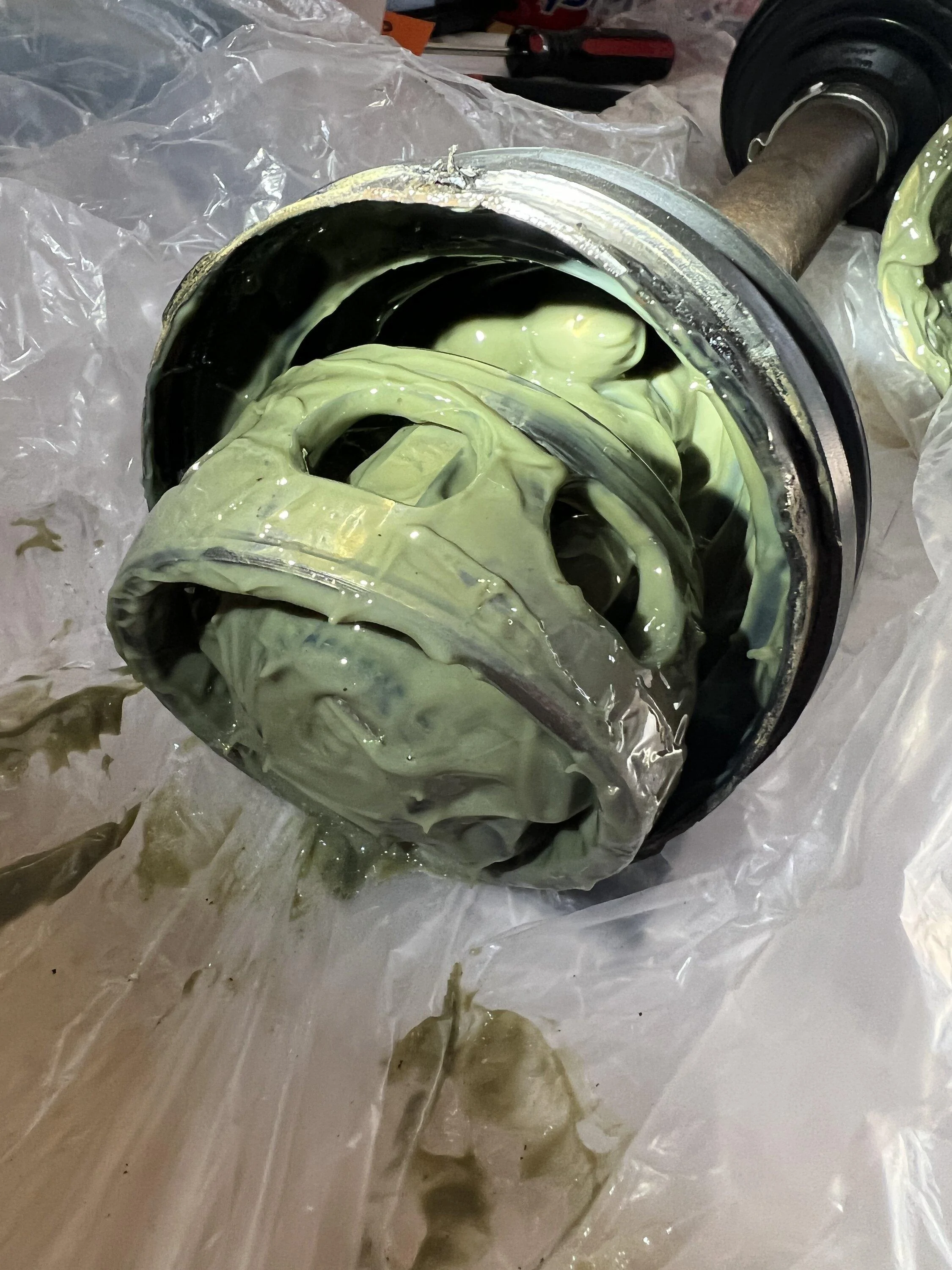

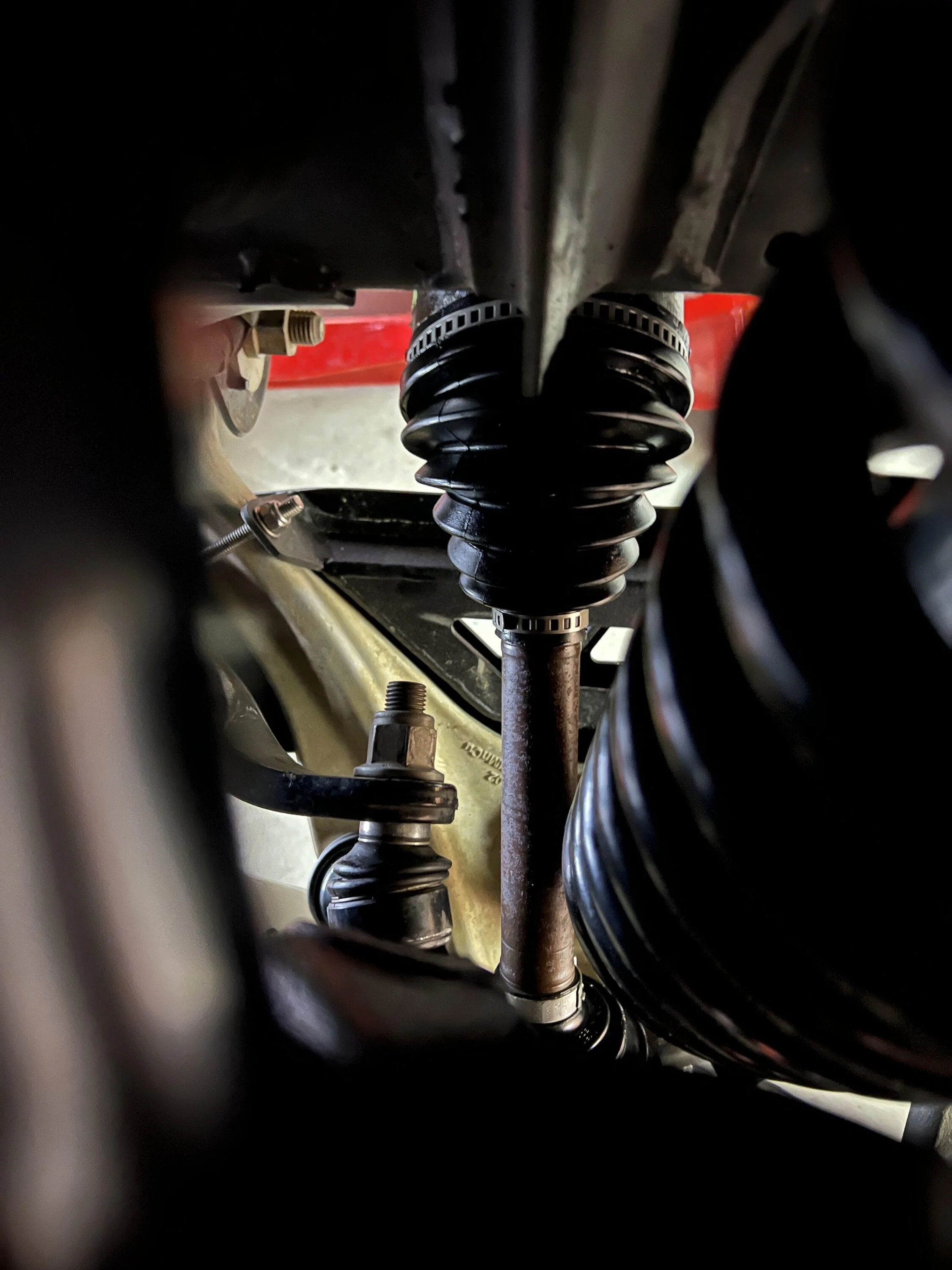

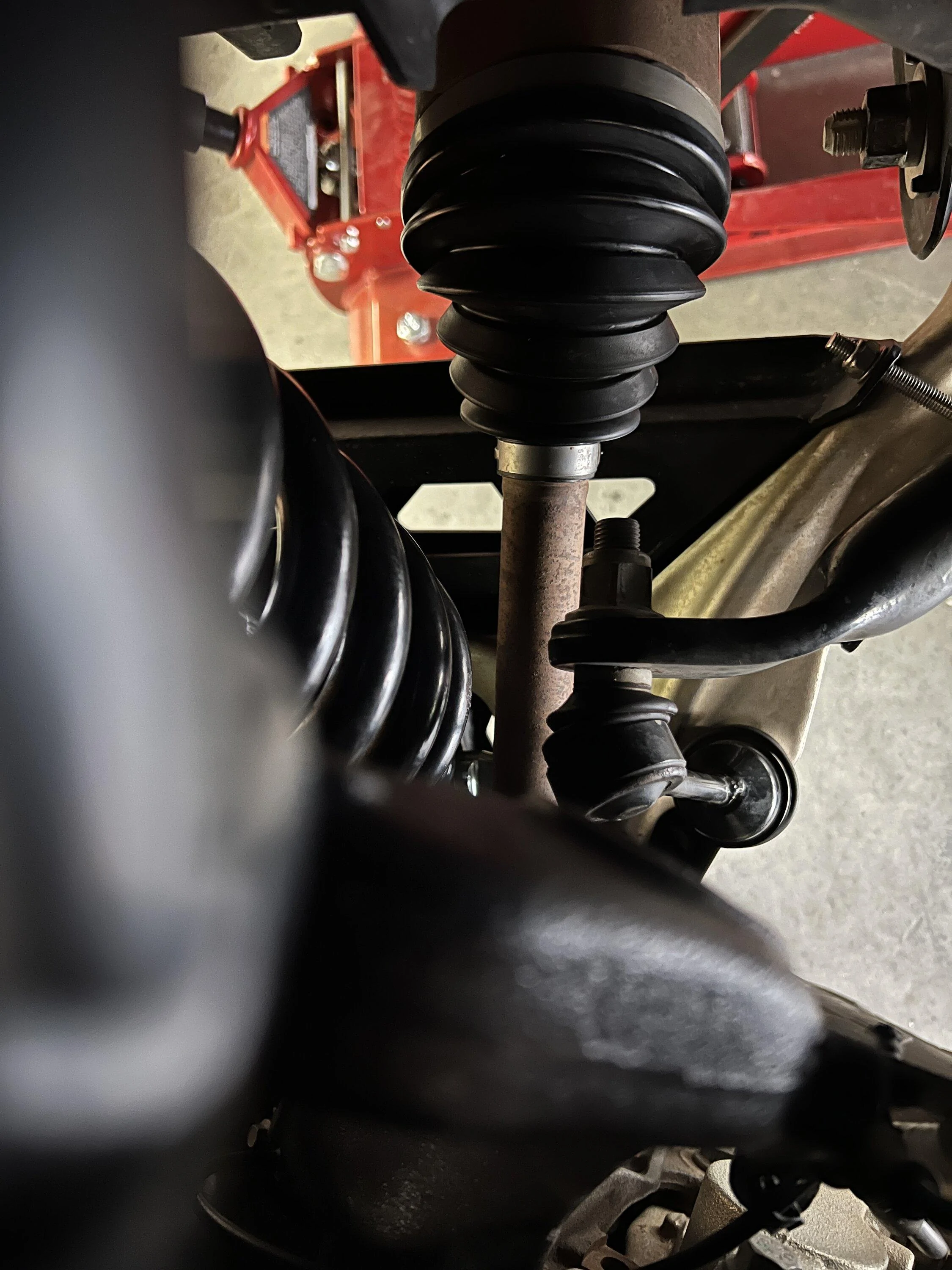

Well, I finally decided to take the cv axle all the way out because it was sounding pretty bad inside the boot closest to the inner cv. Low and behold I have 8 - 10 marble size balls loosely laying around inside. They look like they fit back into the assembly with a bunch of holes around the sides? Am I able to reassemble this thing or is a new cv axle in my future?

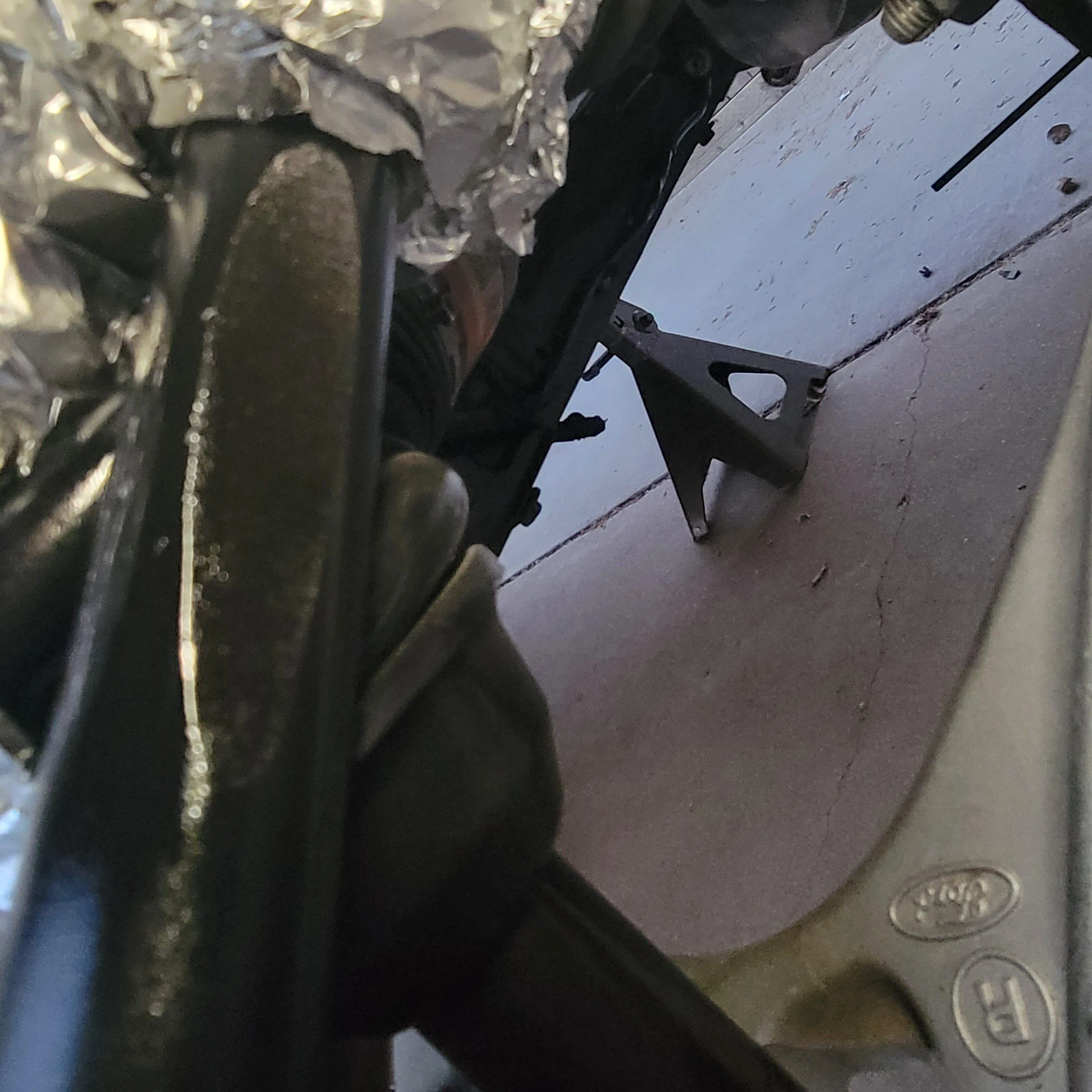

I can see how that would happen on some high speed stuff. ALL my off roading is 4low and crawling. Ill keep an eye out and see if I make contact anywhere.
This isn't icon-specific, but worst contact for low speed is the probably the main body with wheels at full lock (photo with liner removed). For wheels straight there is more clearance, but it might contact the fender seam on a hard landing. But it is hard to compress the spring and pancake the rubber bump stop that far.

So what about your loose balls?
Secured my loose balls and greased them up really good. Put everything back together earlier tonight and the Bronco drove fine for the few minutes I was on the road. I cycled through 2H, 4L and 4H with no issues. There was an inner c-clip that was a huge PITA to get back into the canister that held the balls in place once everything was lined up. I hope I never have to do any of that again, but it was a great learning experience. Hopefully, my balls stay nice and secure moving forward.

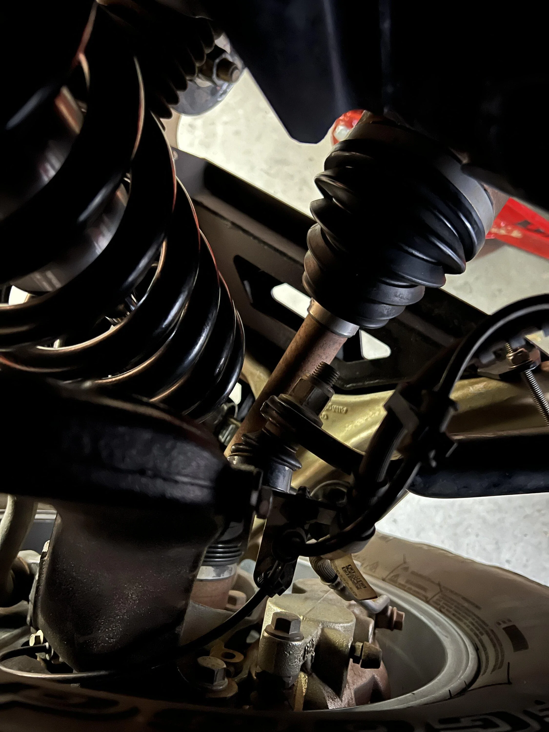

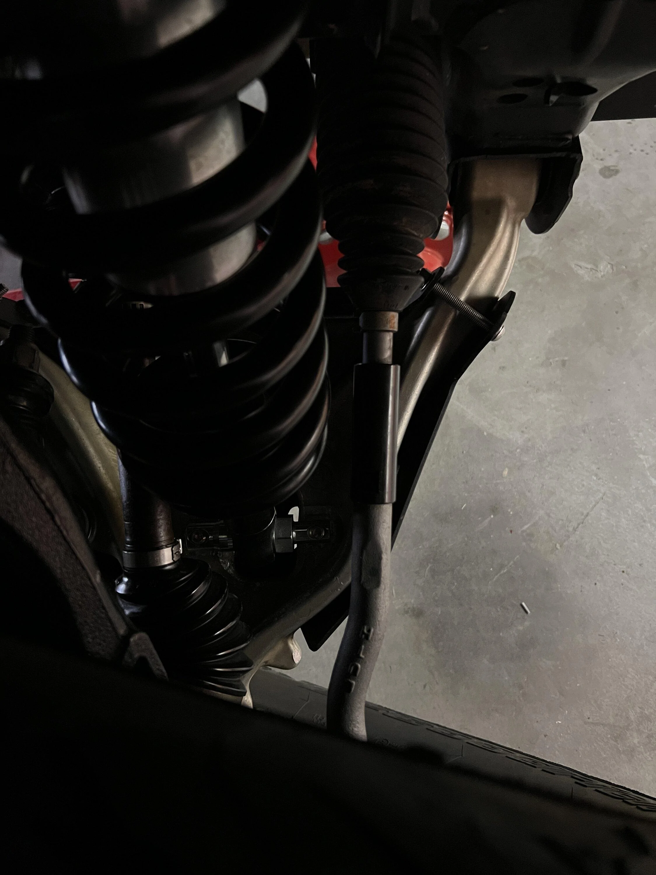

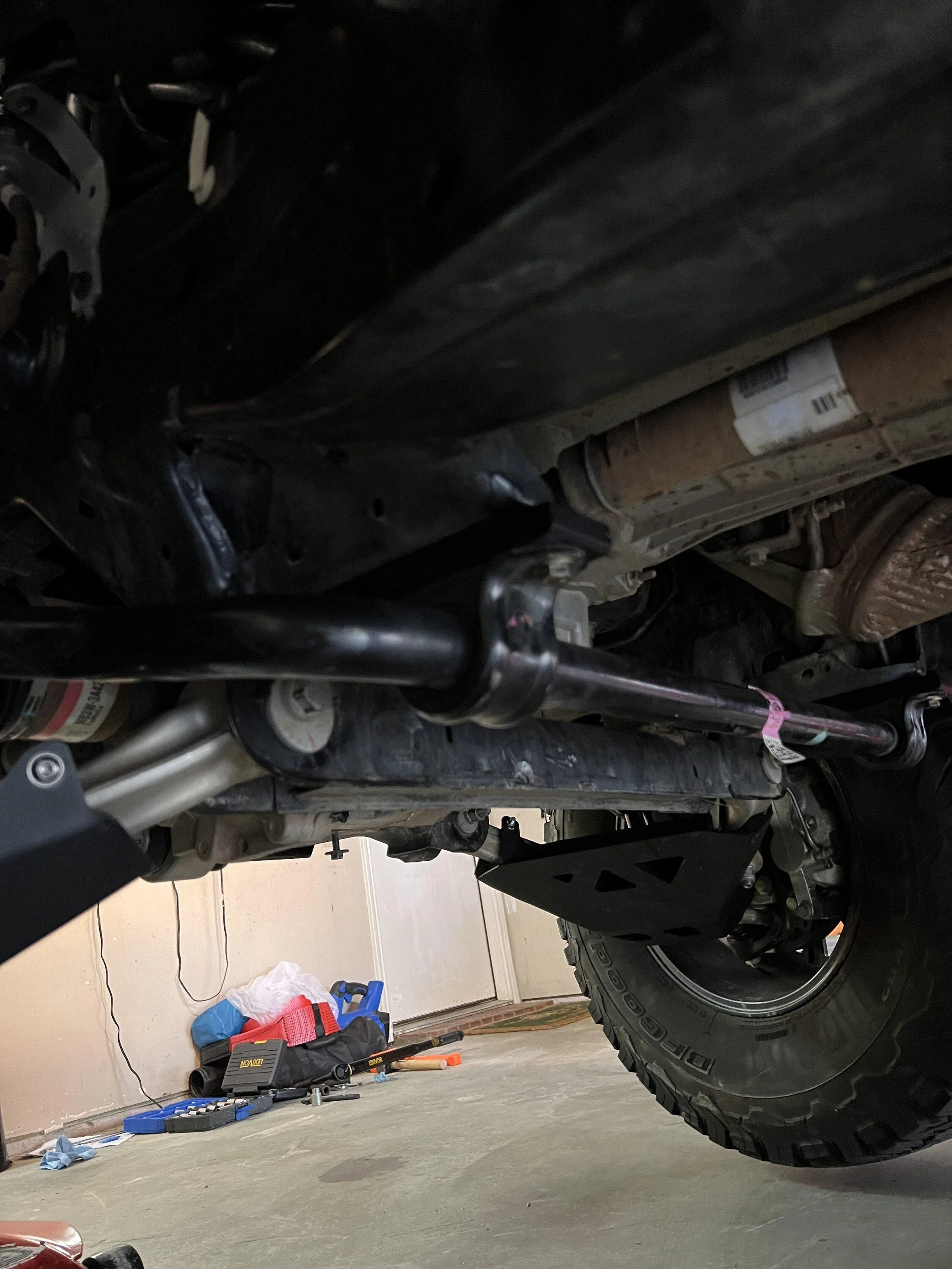

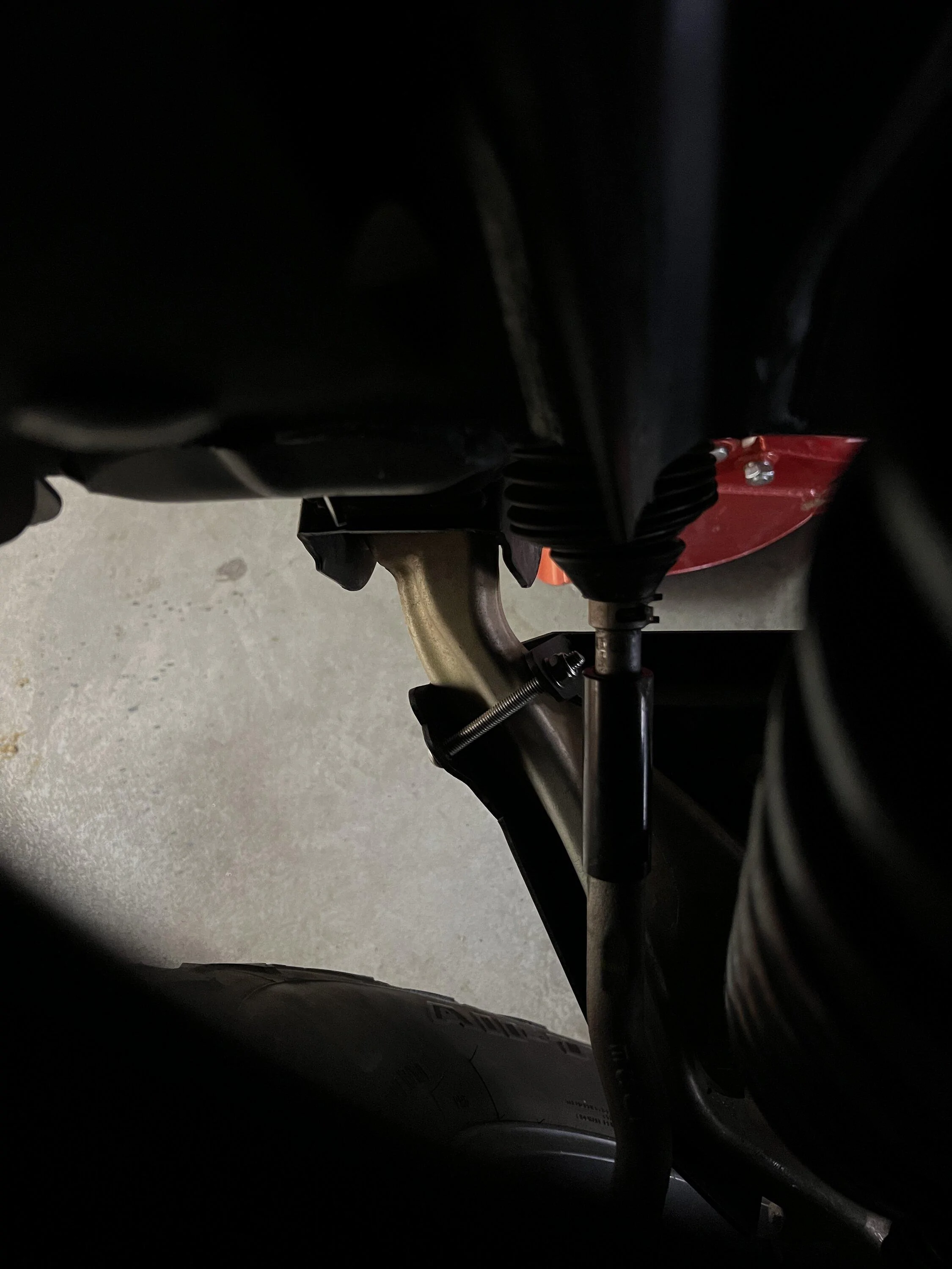

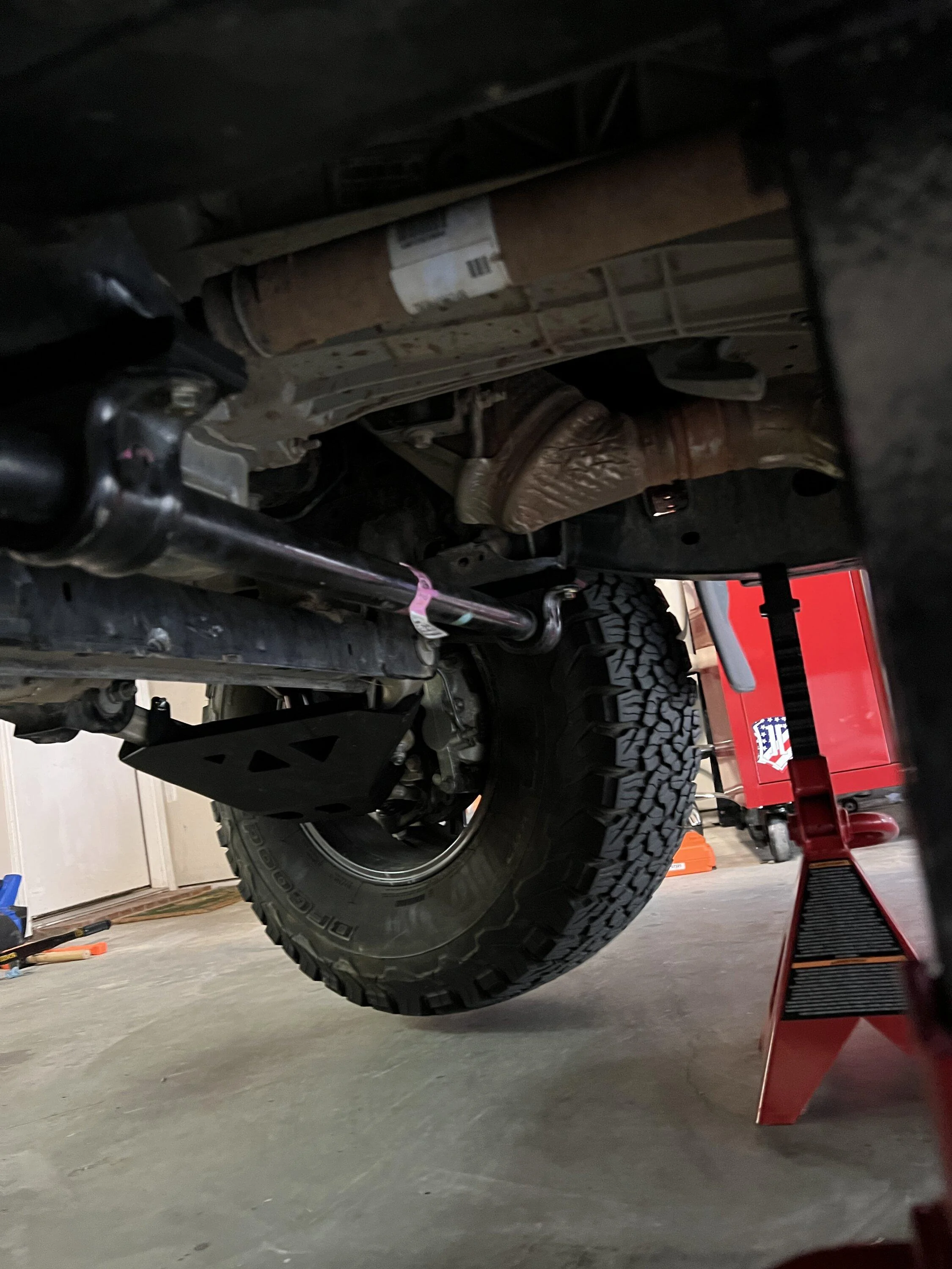

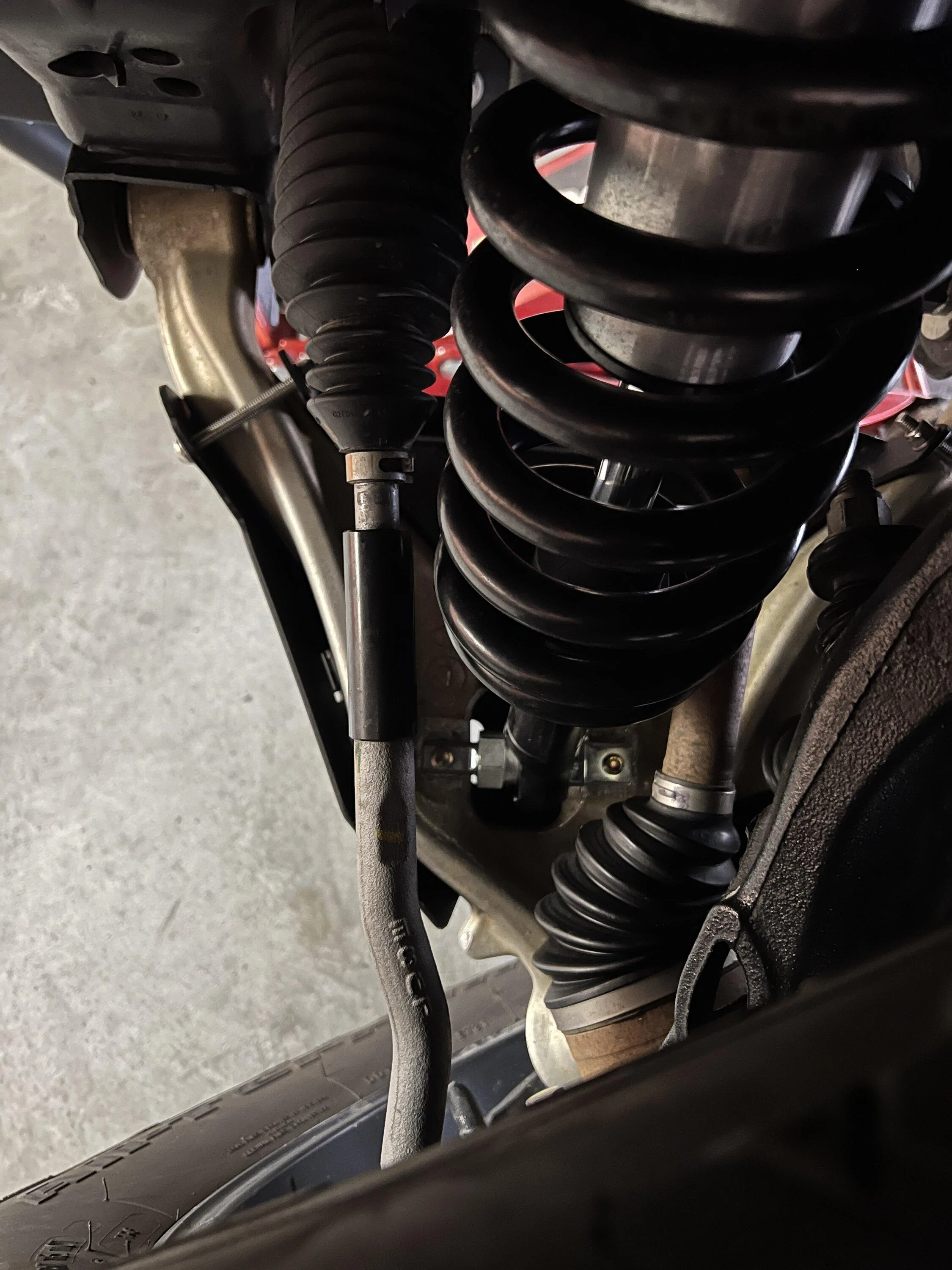

Here are some photos of the new lower assembly and sway bar bracket installed that ICON sent me over the last few days. As mentioned before, clearance exists between tie rod and sway bar now at full droop and full lock both ways.
Thanks for the pictures its very much appreciated. So ICON did move the Stabilizer bar back a bit to get that extra clearance? It's a bit hard to tell but I do believe I see that they did.
Correct. I’d say the sway bar moved back about an inch and dropped about 3/4 of an inch. ICON provided the plate and all the new hardware. Mounted up perfectly.

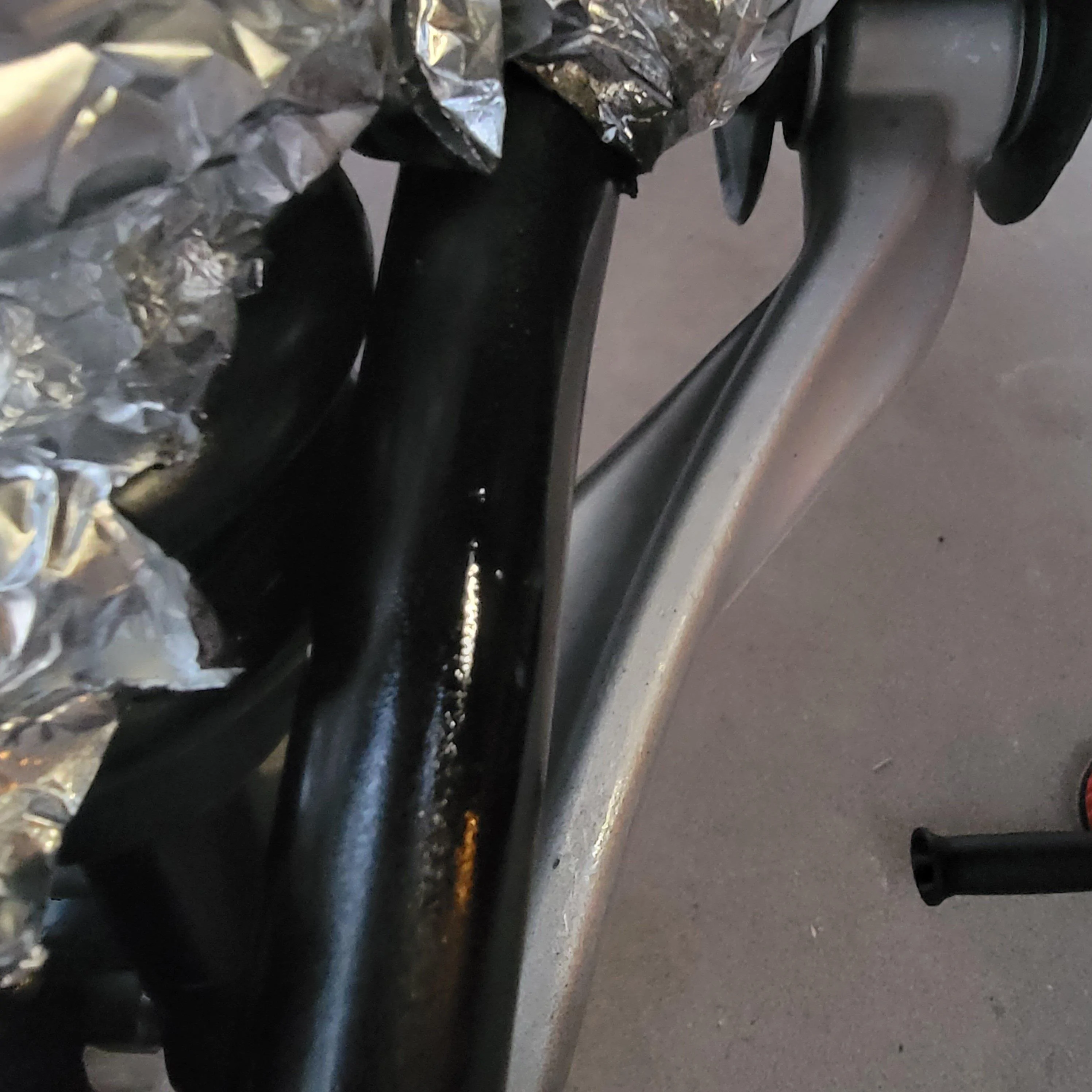

2020 Camry TRD

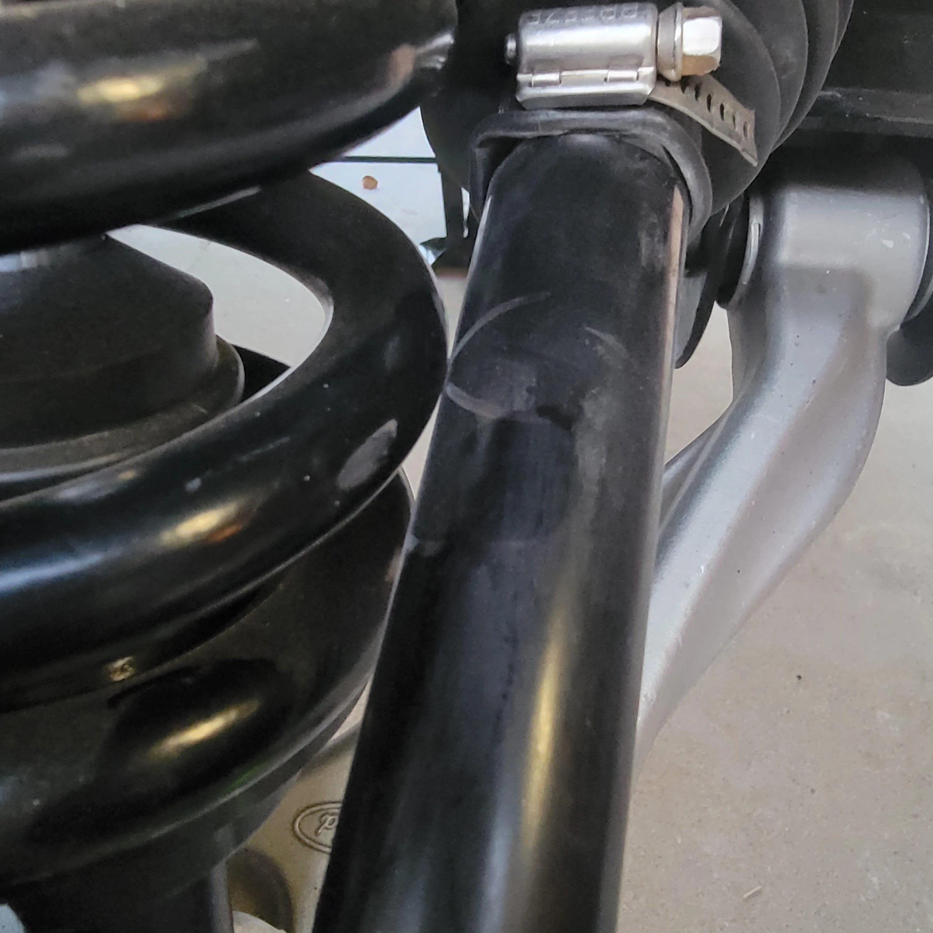

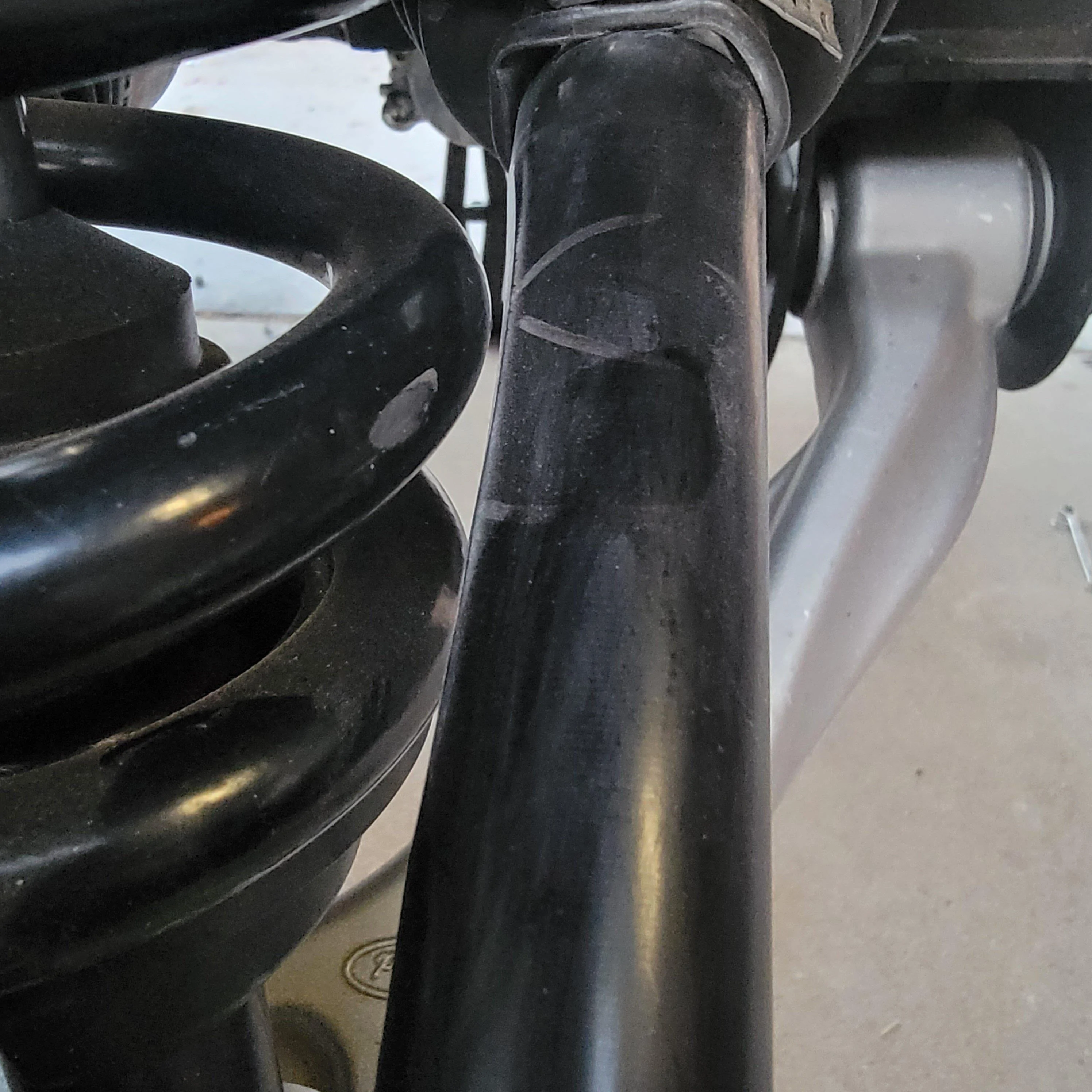

Well I contacted RPG and let them the predictament I found myself in with front coilover contact with their full tie rod kit. They said I could easily shave off some of the tierod body due to it's overkill design. So with about 5mins of grinding my RPG tierods no longer make contact at full droop. You'll see the second picture is with no shave and then the rest of the pictures is with the shave.
