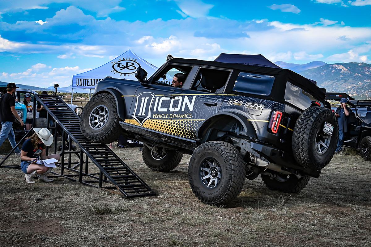

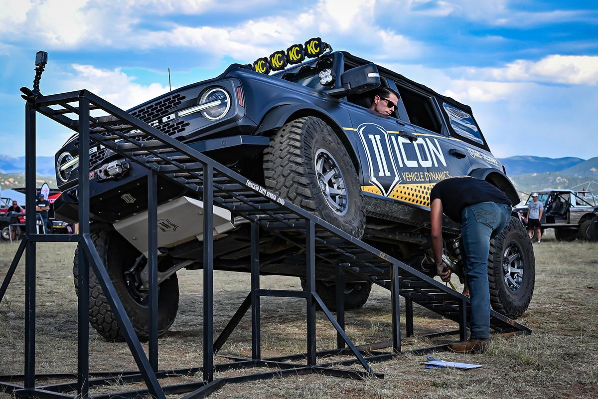

Here are a couple shots from the RTI ramp at Bronco Super Cel this year. The ICON 4-door is running our Stage 8 kit with 37's and the up-travel limiters.

What was the RTI score? Curious to see how it competes to stock numbers.
I don't remember the actual numbers but I know we beat the stock Sasquatch-equipped rigs and a King-equipped 4-door handily. This was at Bronco Super Cel in Colorado last year. Of course all the Early Broncos wiped the floor with all of the 6G's on the ramp LOL. If I can find a pic of how the stock ones were doing on the same ramp I'll throw it in here.

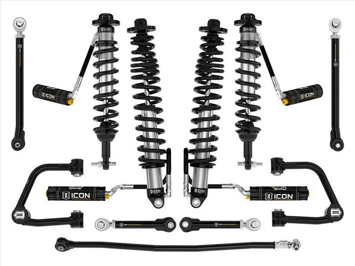

I’m very excited/anxious to see what system you will create/release for heavy weighted Overlanders. This kit is what I’m thinking but of course with heavier rear springs.

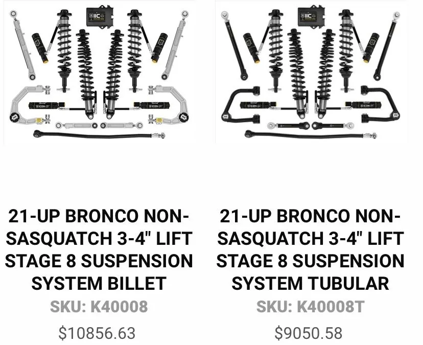

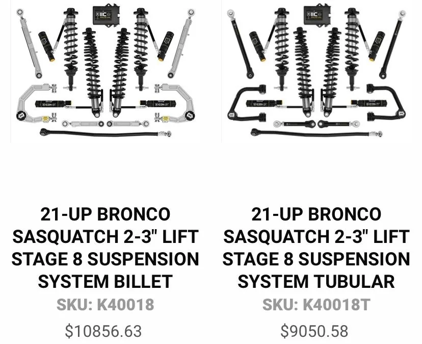

Dusty,
Can you confirm the non-SAS and SAS kits are the same kit and the different inch quotes is just related to the fact both vehicles will end up at same height but starting from different heights?
The coilovers are same length. It’s just the non-SAS Bronco that starts off lower.
