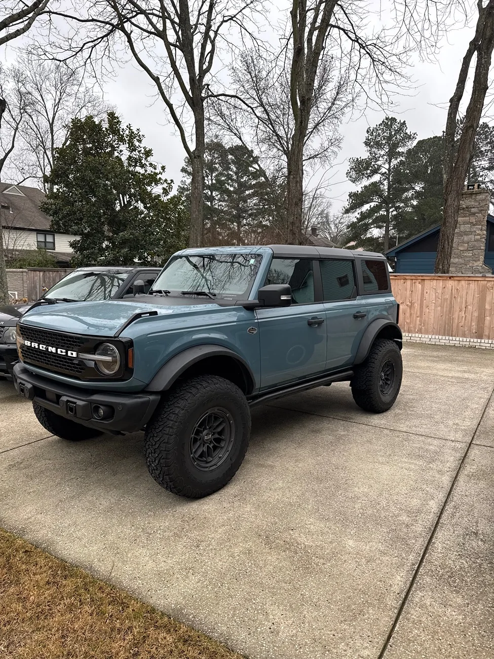

bronc_moose
Feb 7, 2026
Bronco Wildtrak
I hake the same Zone kit and had to add the max clearance kit and 1.25” spacers for stock wheels to clear Mickey Thompson 37s without rubbing.
I’ll get in on the Azure Wildtraks too.
