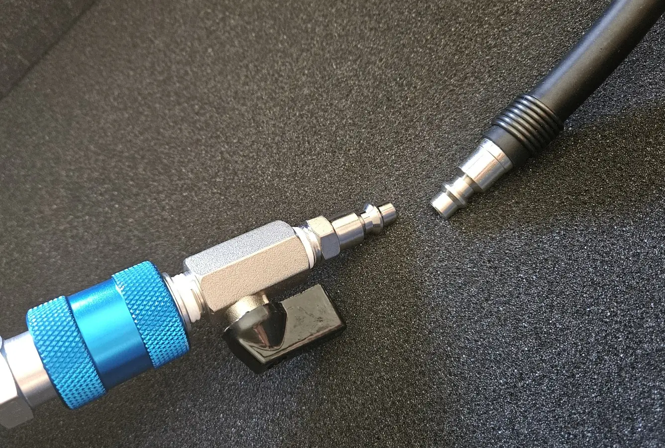

Just got in my air compressor and 4 tire inflation/deflation system, but theres an issue: they both have male ends
Ford Bronco How to Connect Compressor to Manifold 1783724698829-9d
How do I hook it up? What do I need?
Any help is appreciated.

If wanting to keep the shut off, remove male plug, install threaded female plug from harbor freight.
If you don't care about the shut off, remove male plug to it, insert other male plug into female coupler.

I bought this and installed female ends on both sides.
Minimprover 3/8" x 12 Inch Heavy Duty Short Air Compressor EPDM Rubber Hose 300 PSI: 1/4" Male NPT to 1/4" Male NPT Connections With Quick Coupler Brass Fitting https://a.co/d/01Cg0ACH
