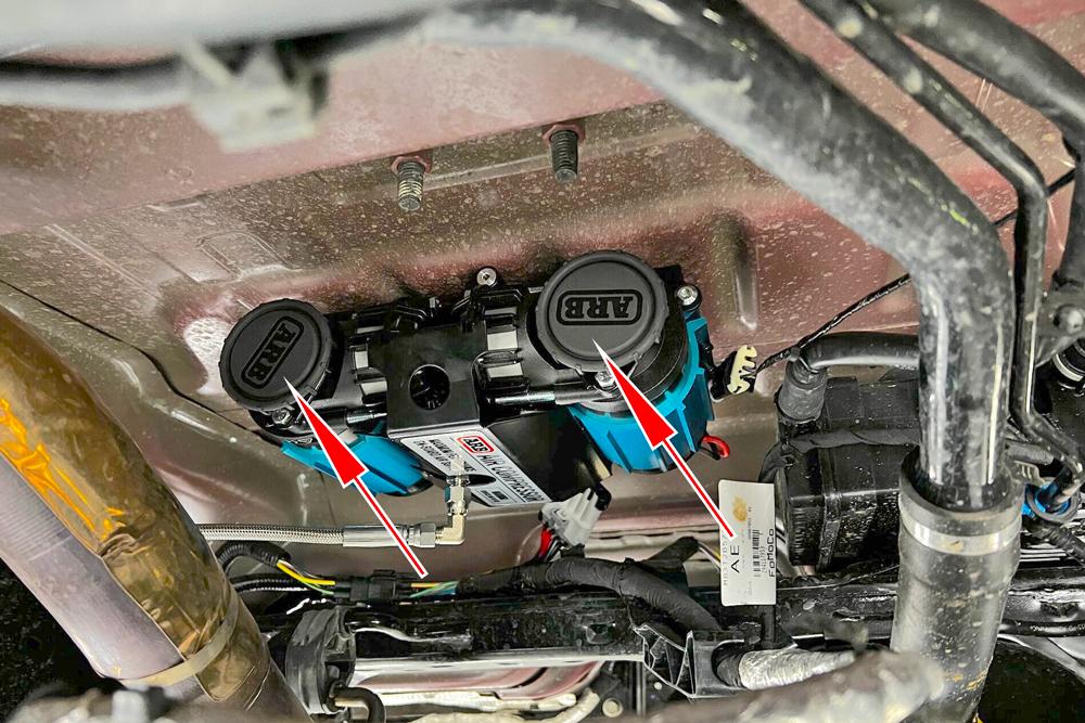

Ford Bronco Hardmounted ARB dual compressor with quick connect port installed 2BB3C398-B969-4190-A2CD-3CBA3B17CE57

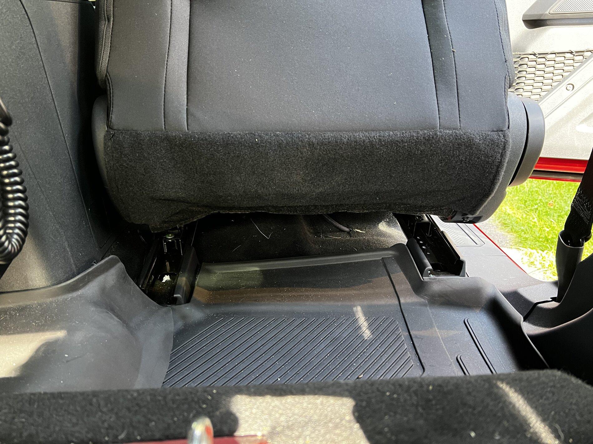

Any room to mount under front seats?
It's possible. Might be a tight fit. That would save you from having to run an air intake line for sure:

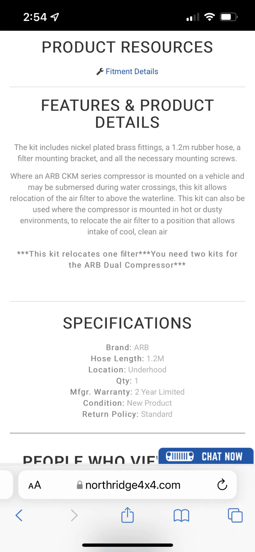

Already done. The intake air line was run up to the cargo compartment on the interior right side, in a cavity behind the trim.
Ford Bronco Hardmounted ARB dual compressor with quick connect port installed filters
You've relocated these?
Curious what you've seen from your own crew and also customers in terms of compressor life on these ARB units when they are mounted in locations which will see being fully submerged, lots of water, mud and impacts?
I've got the ARB twin on my short list but intend an engine-bay mount with aerospace grade quick disconnects on the terminals so that for daily driving I don't subject the compressor to constant heat cycles.
Or are these units so bulletproof that you're getting 5-10 years hard life out of them without issue?
The ARB Dual compressor have been very reliable over the years.
The biggest issues with mounting them where they can get submerged are the air intake filters (see above pic) and the cylinder head/cooling fan.
The filters are easy to fix, just relocate them to a safe dry spot. ARB makes it easy with their relocation kit: https://www.northridge4x4.com/part/...essories/171319-arb-air-filter-relocation-kit
The cylinder head/cooling fan would be the bigger problem. If you pack the area between the compressors with muck and mud, the fan won't be able to cool the cylinder head properly, causing overheating.
So just be sure to keep that area cleaned out.
