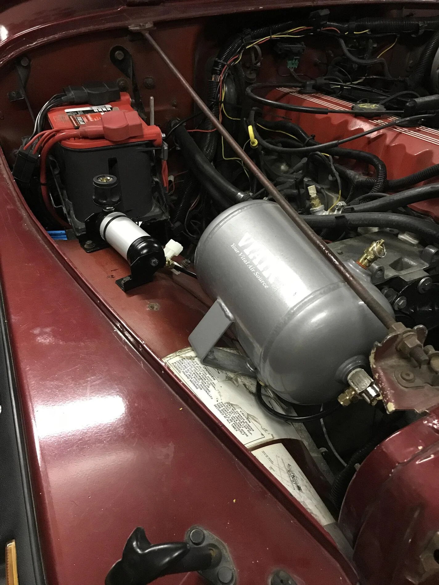

Isn't heat an issue mounting it under the hood? I thought they had some kind of thermal cutoff, seems like a few hours of wheeling would cause them to get too hot for use.
I have one of these in my jeep. the question I guess you need to ask is when are you going to be using the compressor. most of the time when you need to run it for any length of time it is because you air inflating tires, or using air tools, both of which are done with the vehicle not in motion, so you can pop the hood and let it ventilate. I have it mounted under my battery in my yj and it has worked well. I have air lockers in it too, so you do need to run it occasionally when the vehicle is in motion, but most of the time it is when I am stopped. the 1 gallon tank makes the compressor a lot more useable for small tools, and an air blower. but I use it primarily for reinflating tires and running the lockers. and i have had no issues with it. just from my experience.
