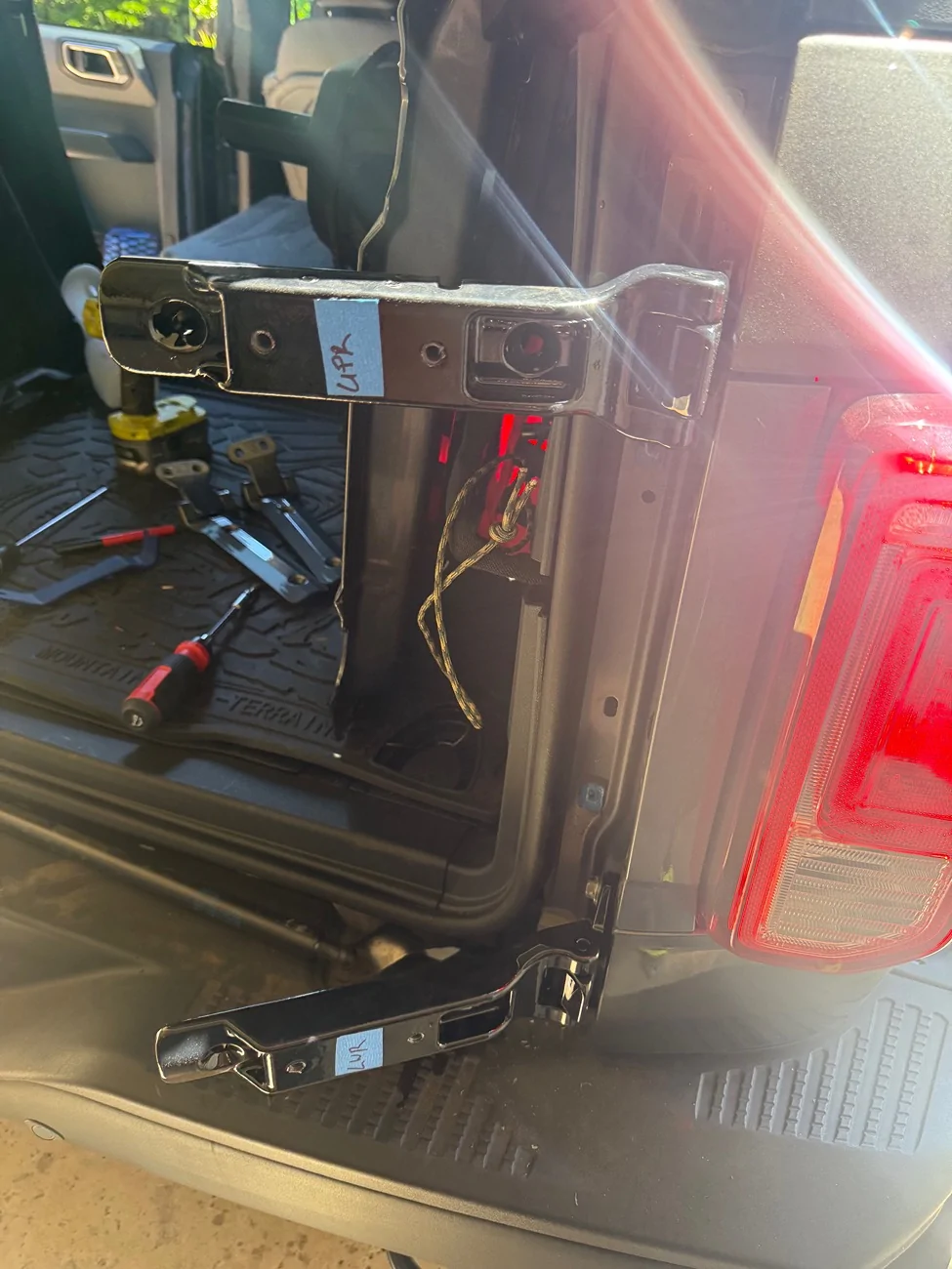

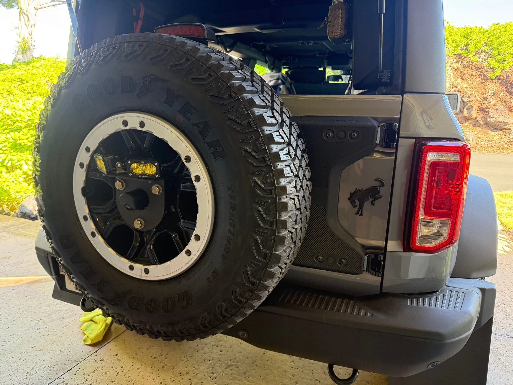

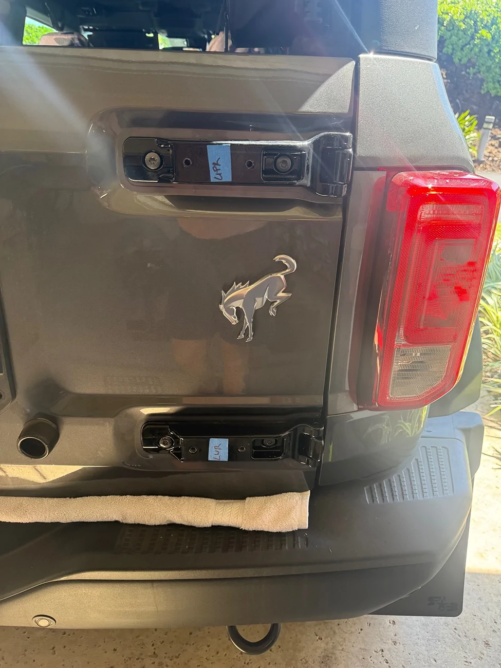

I just did the Ford Performance Braptor hinge upgrade. I can tell a difference just in the way the door closes. Stock SAS tire with Bison Gear tailgate table (the best). I was getting constant clunk down dirt roads and now they are all gone!!
How difficult was the installation? The biggest ting that scares me about all these reinforcement solutions is the possibility of the tailgate coming out of alignment and not being able to line it back up again.
