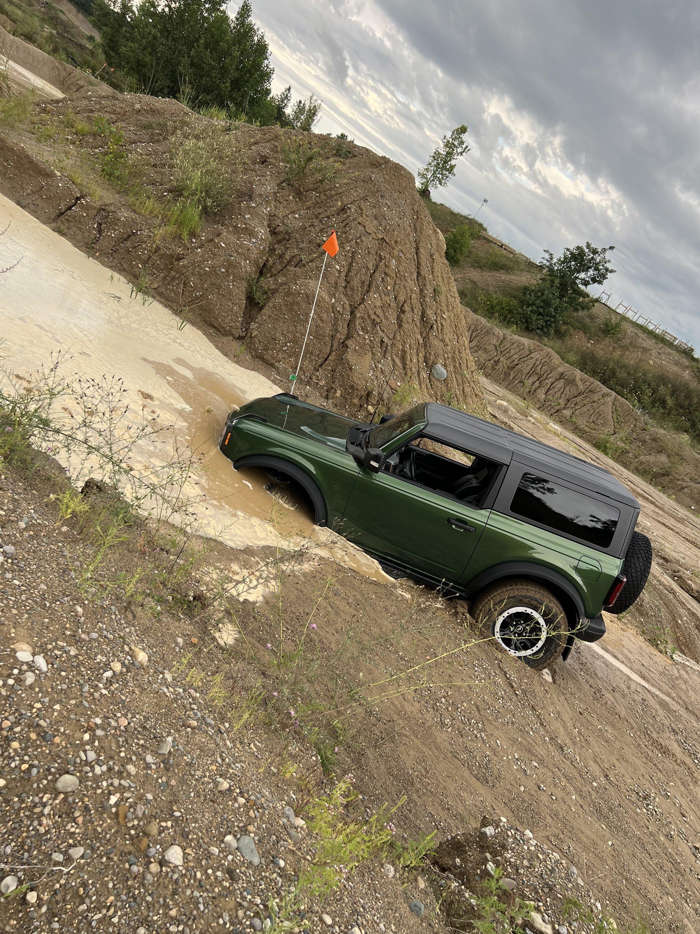

No particular reason, just a lot of judgy people. I guess it’s not all that important to me.
Ford Bronco How can water enter the engine? IMG_5338
Ford Bronco How can water enter the engine? IMG_3763

Isn't the max fording depth 30"? It sure looks like the majority of your 35" tire is under water. Open the hood and use a tape measure to measure from the ground to 30" and make note of what part of the engine would be under water. The measure again at 35". Whatever is within that space is likely where the water entered the engine.

Yeah there's two things about that. I think the depth for the SAS is 33.5" and the tires which are less than 35" are almost submerged, let's say the tires are 34" under. The suspension was hanging, as I was caught up on my rock sliders, so the engine isn't as deep as the tires are. Also being at that angle, the bumper and radiator were several inches lower than the rest of the engine. I haven't done it yet, but I've wanted to get a tape measure and make a line from the slider step to the water line on the grill and see just how much of the tire it passes through. It's probably a moot point but I'd guess at the tire anyway the engine was in less than 30" of water. Or I could measure from the ground to the radiator fan I suppose, the bottom of the fan was in about 4" of water I would say.
I'm in complete agreement that it was as deep as the alternator, and I expected to pay for that. Thank goodness for the TSB on it as it was replaced under warranty. I've got to assume the wading depth max is mainly intended to keep air out of the intake. And that's my main beef, is that water didn't enter there, it got in through the block somehow. But they are sticking with the theory that water got into the intake and with the engine running it got past the pistons and into the crankcase.

Max fording on a Sas is 33.5. The Goodyears are 34" on a good day. If this is as high as the water honestly got... This isn't what messed it up. Maybe an alternator failure... but this doesn't put water in the crankcase.

I'm not disagreeing with the risk part, just the part that water should never have entered the crankcase. I've had 11 trucks (Jeeps, Broncos, Land Rovers) prior to this and been in water similar to this with most of them and have never seen water in my oil.
And yes, I've filed a claim with insurance, it just grinds me that Ford is flat out lying about the air intake to keep from covering it. To be fair, maybe not flat out lying but flat out guessing wrong. Nobody has allowed me to describe the situation about the water/oil, so air intake is the most obvious guess. I had asked if I could talk to the mechanic and explain the part about the water and was brushed off. They did flat out lie about the mud/water in the air filter part. And anybody at the warranty department that saw that description would easily say it wasn't covered.
