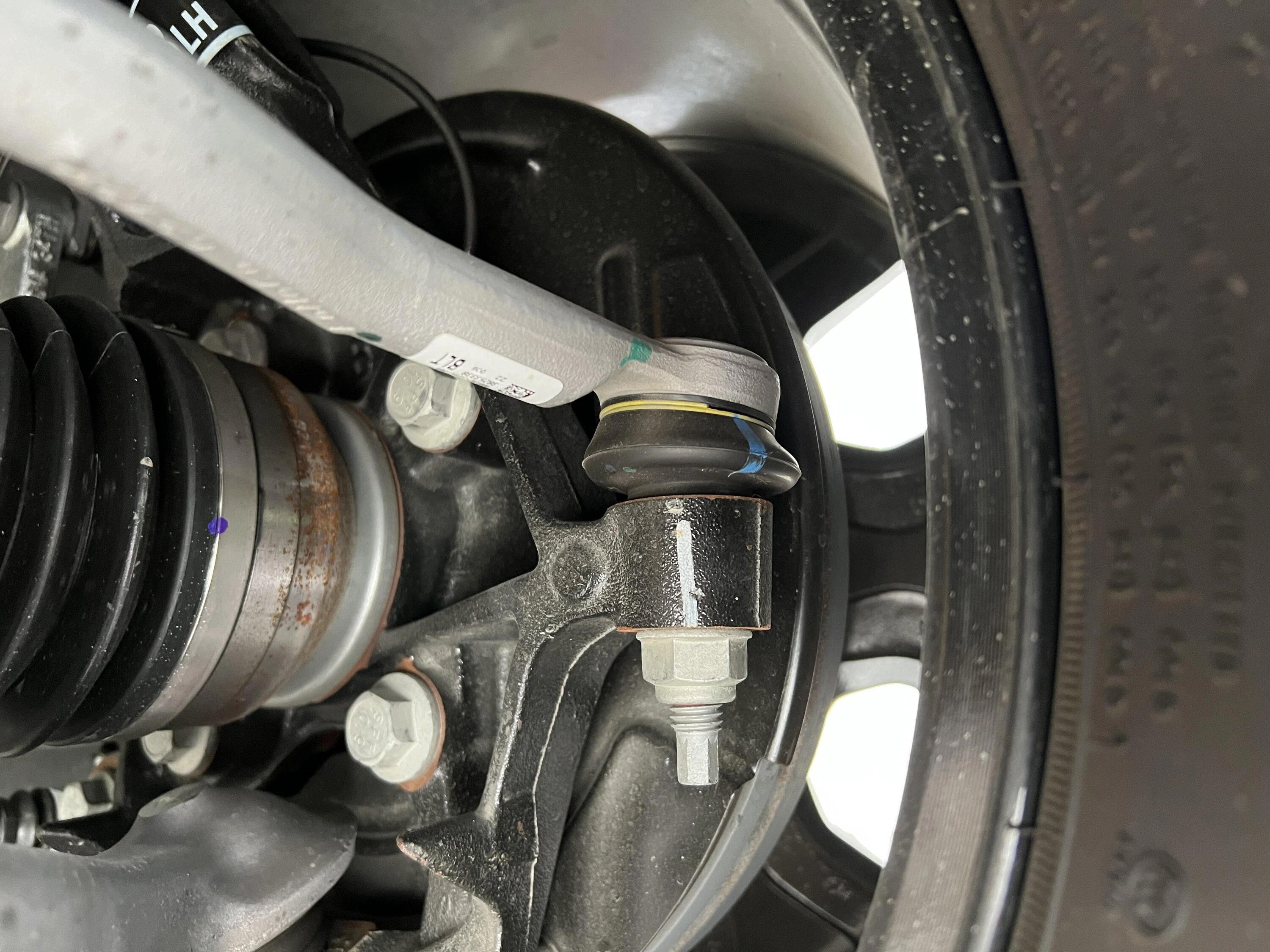

Another concern the dealer brought up is whether the beefier rack will fit with the stabilizer bar disconnect, which isn't available on the WildTrak. How close are these parts?
They are on opposite sides of the knuckle. The sb links would hit the cv axle before they could get near the tie rods. Not going to be an issue there!
