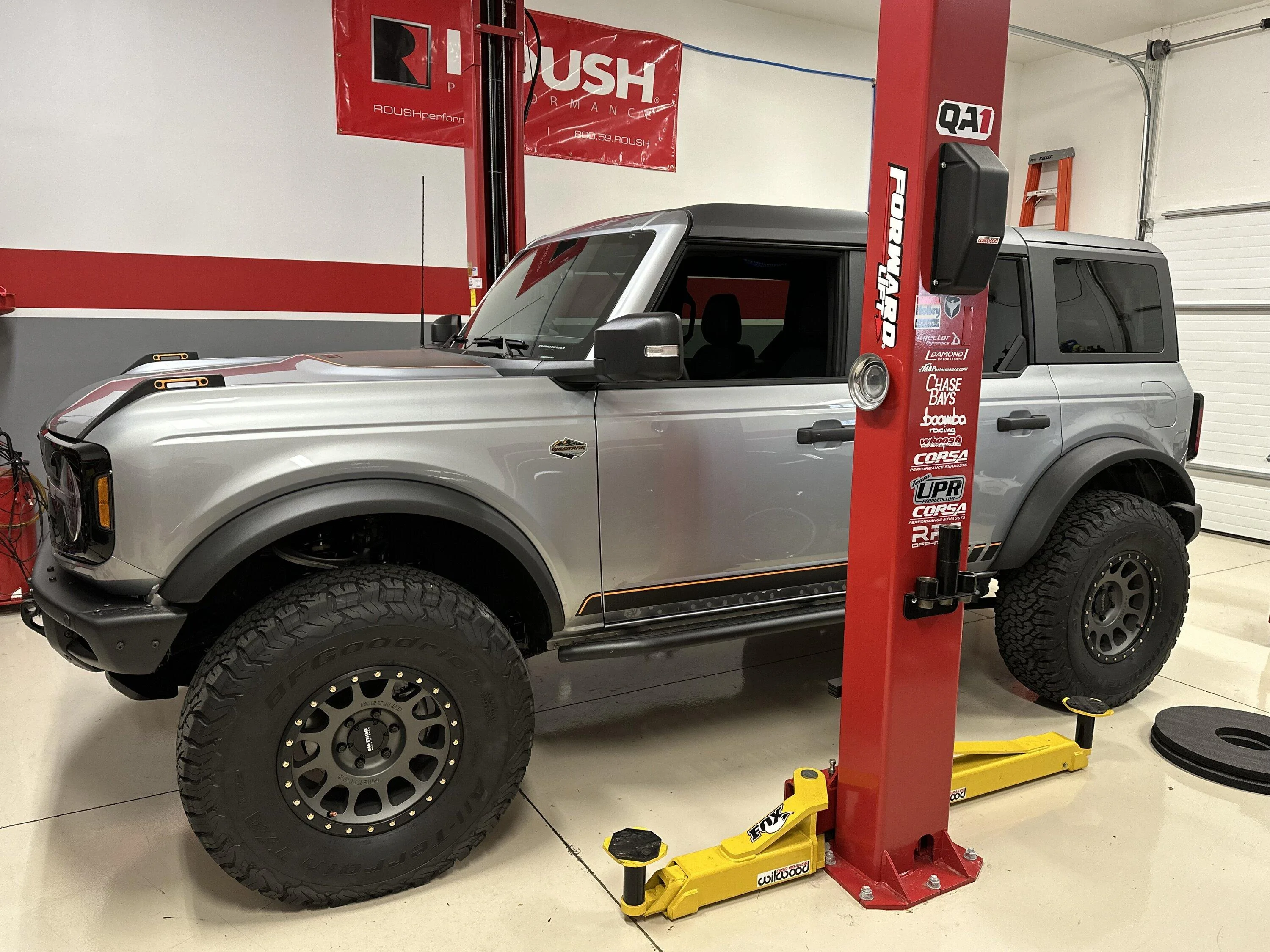

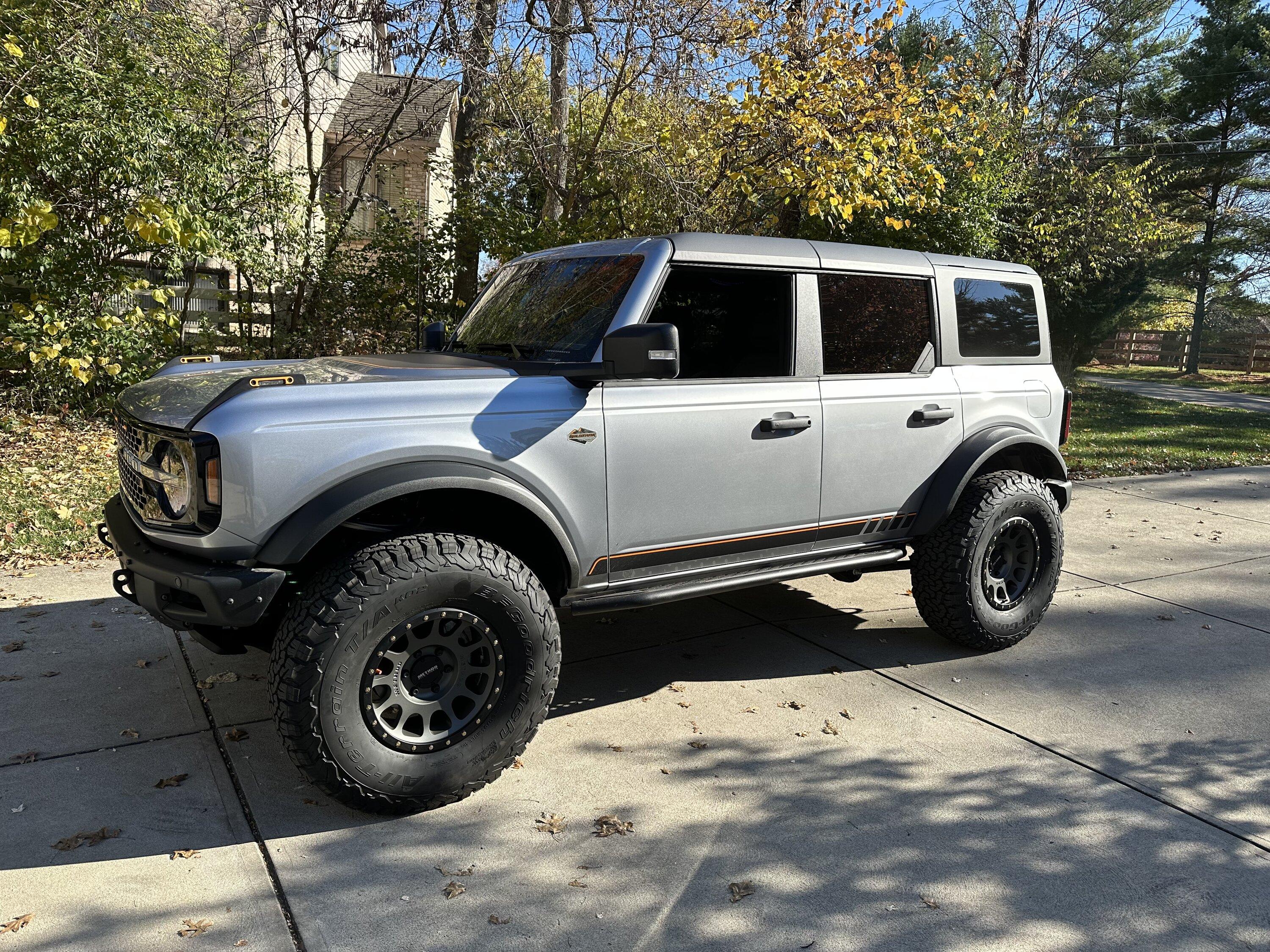

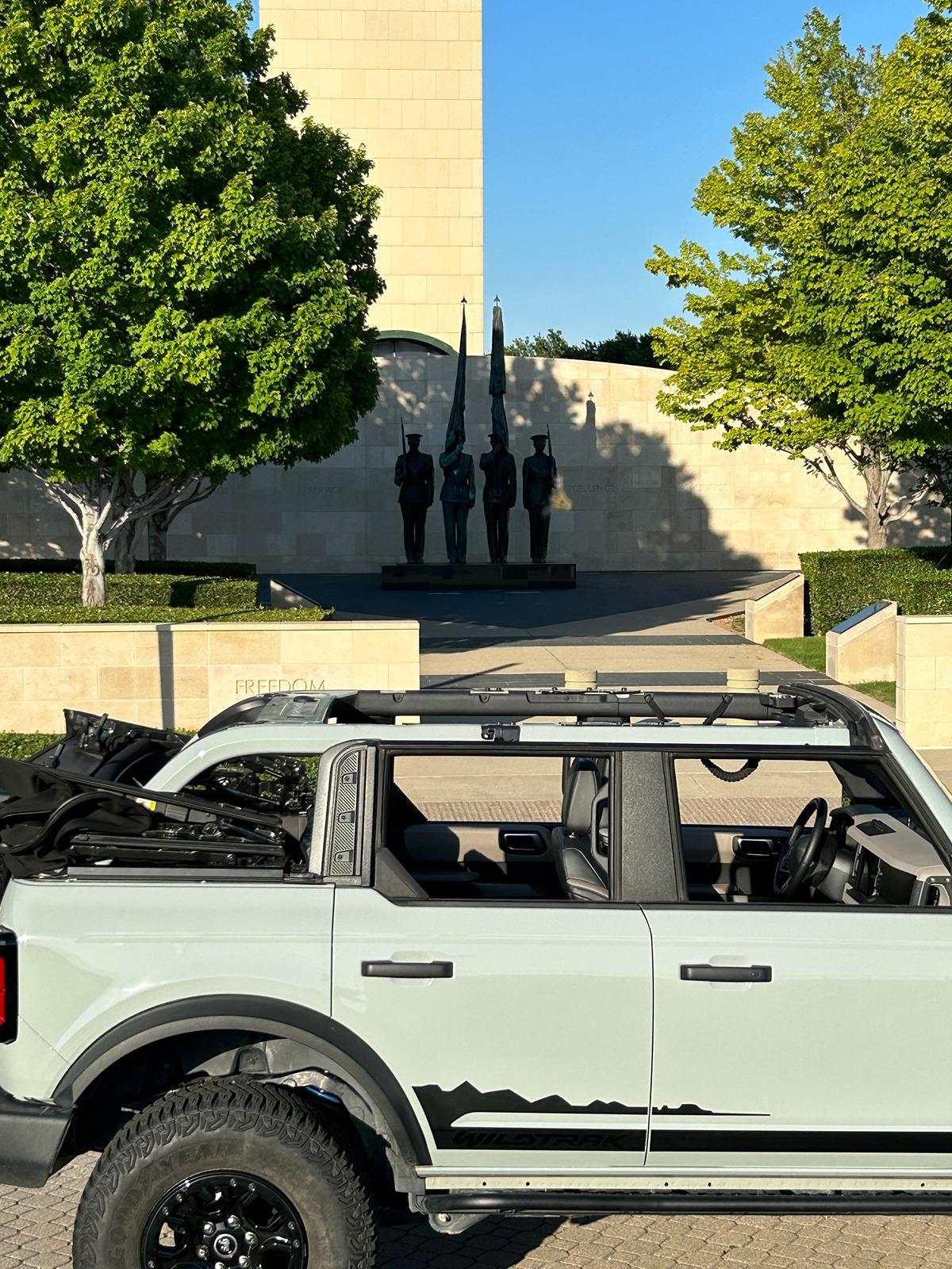

I finally got around to installing these. I have not driven it much yet. But initial drive it feels like stock. I love the results.

Looks good! What are your wheel specs? I’m guessing 17x8.5 with a 0 offset.

They are a 0 offset. I believe they are 8.5. I will also say I had zero rubbing at stock height. Lock to lock. No issues. Running 37 bfg k02

Can you drop an update on the change, if any, in ride comfort since you made the change? Thanks.

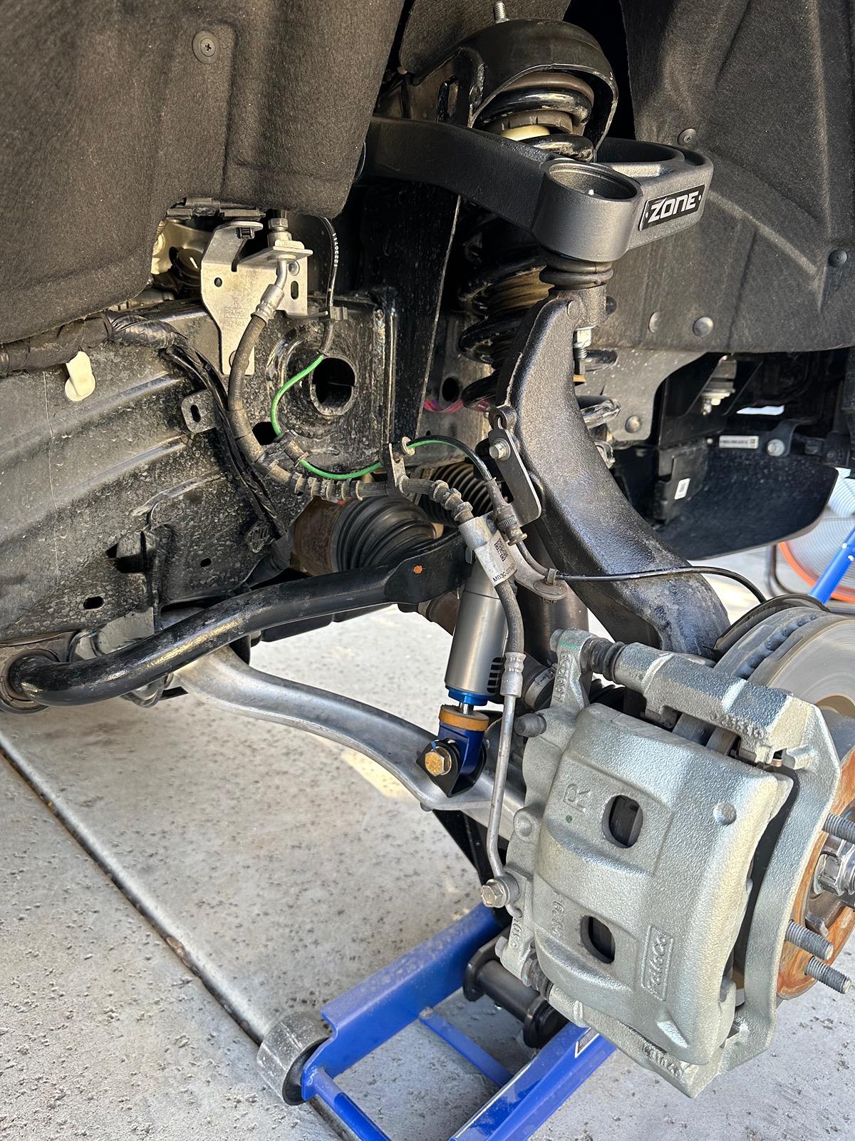

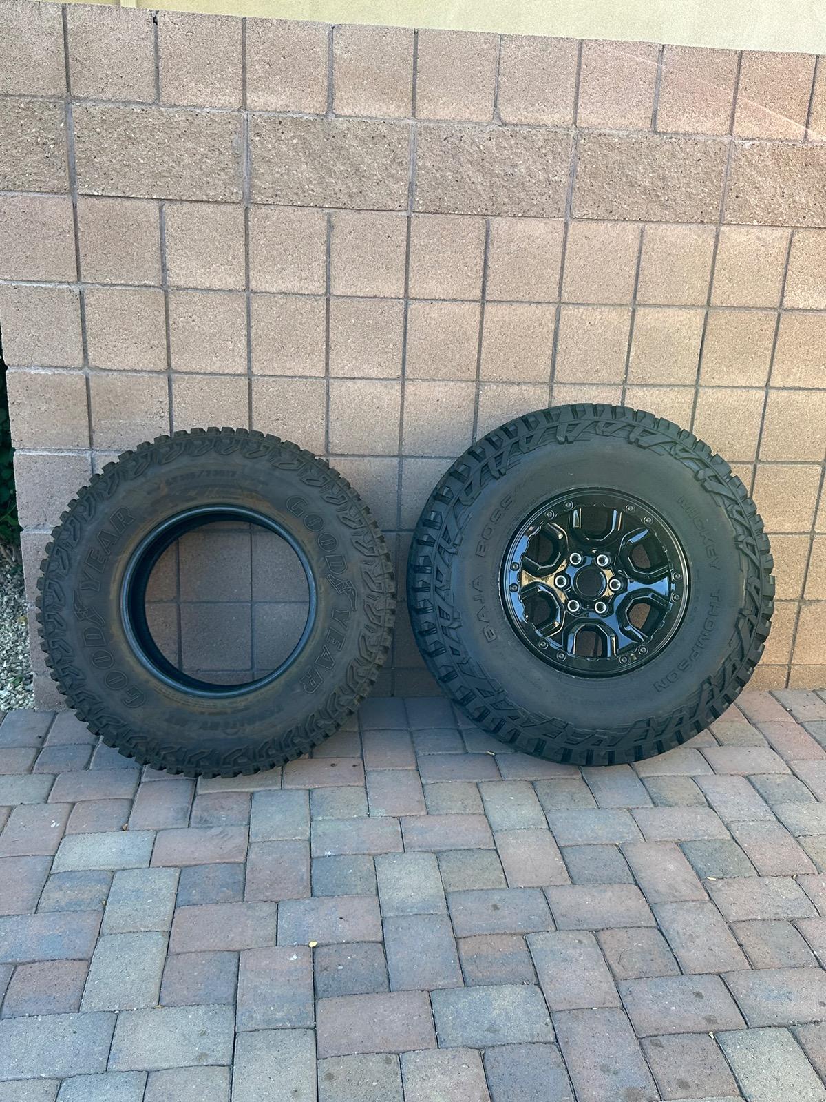

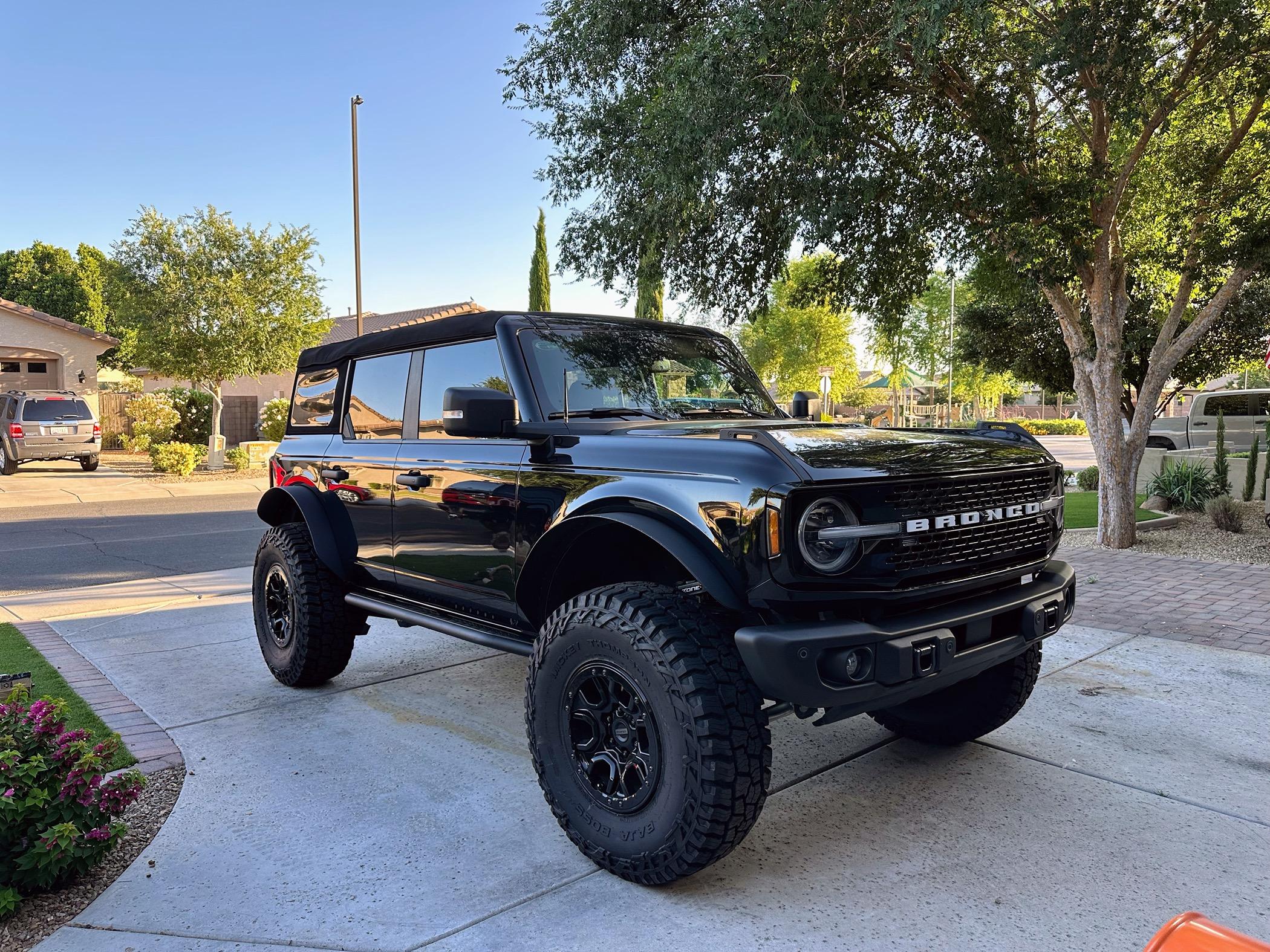

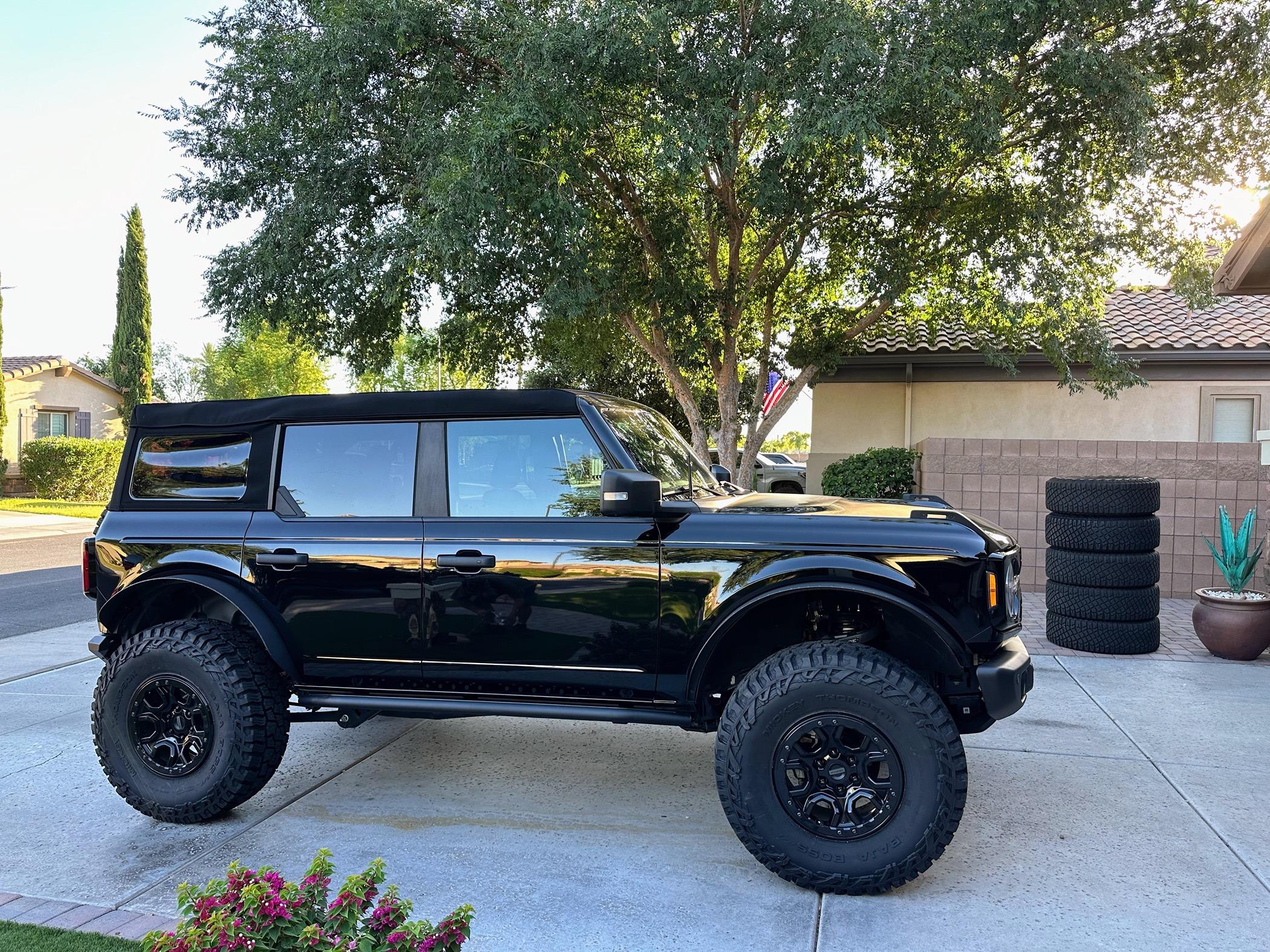

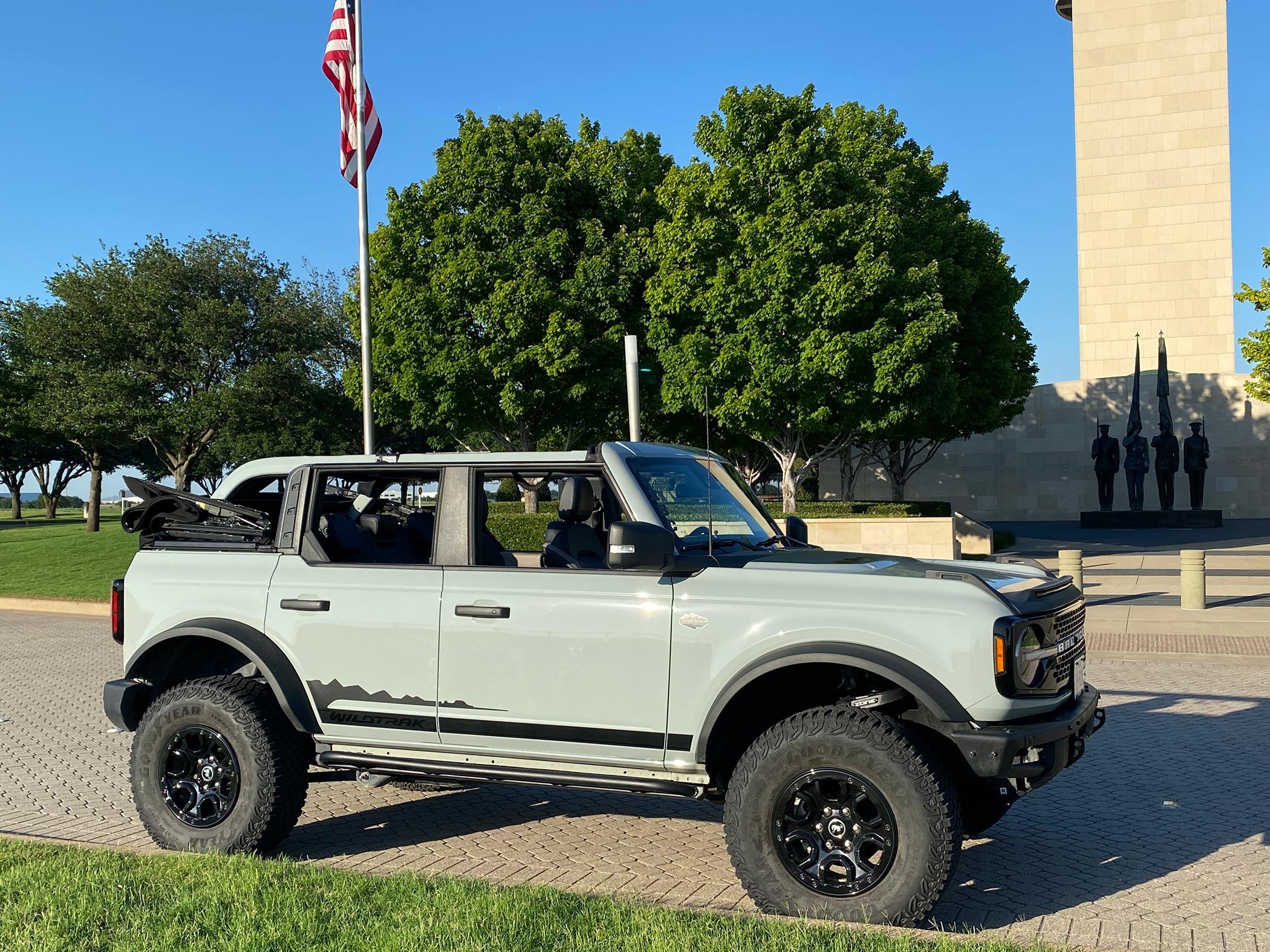

JKS max tire kit and Zone 2.25 kit installed on my 2023 Wildtrak.
37x12.50 Baja Boss A/T’s on stock Wildtrak wheels hit the UCA at full steering lock at Discount Tire. Drove it home and Installed BORNE Offroad 1.4” spacers. I now cleared the UCA’s but looked like I would hit the capable bumper plastic trim with some moderate articulation, so I removed those. Also Trimmed the plastic on the rear fenders near the bumper.
Installed the BOSS Walker end links and the ride is so much better after the lift was installed.
Absolutely love the looks and the ride now. Tire noise is less than the stock Goodyears (expected with brand new tires), gas mileage seems to have gone down .5mpg after 400miles of hwy and street driving, power loss isn’t as noticeable as the stiffer ride was (pre BOSS link install) but the Ford Performance Tune should fix that.
I’m going to Big Bear Bronco Bash this weekend and will report back after some wheeling, there are a couple spots I think I might rub but hope not 🤞

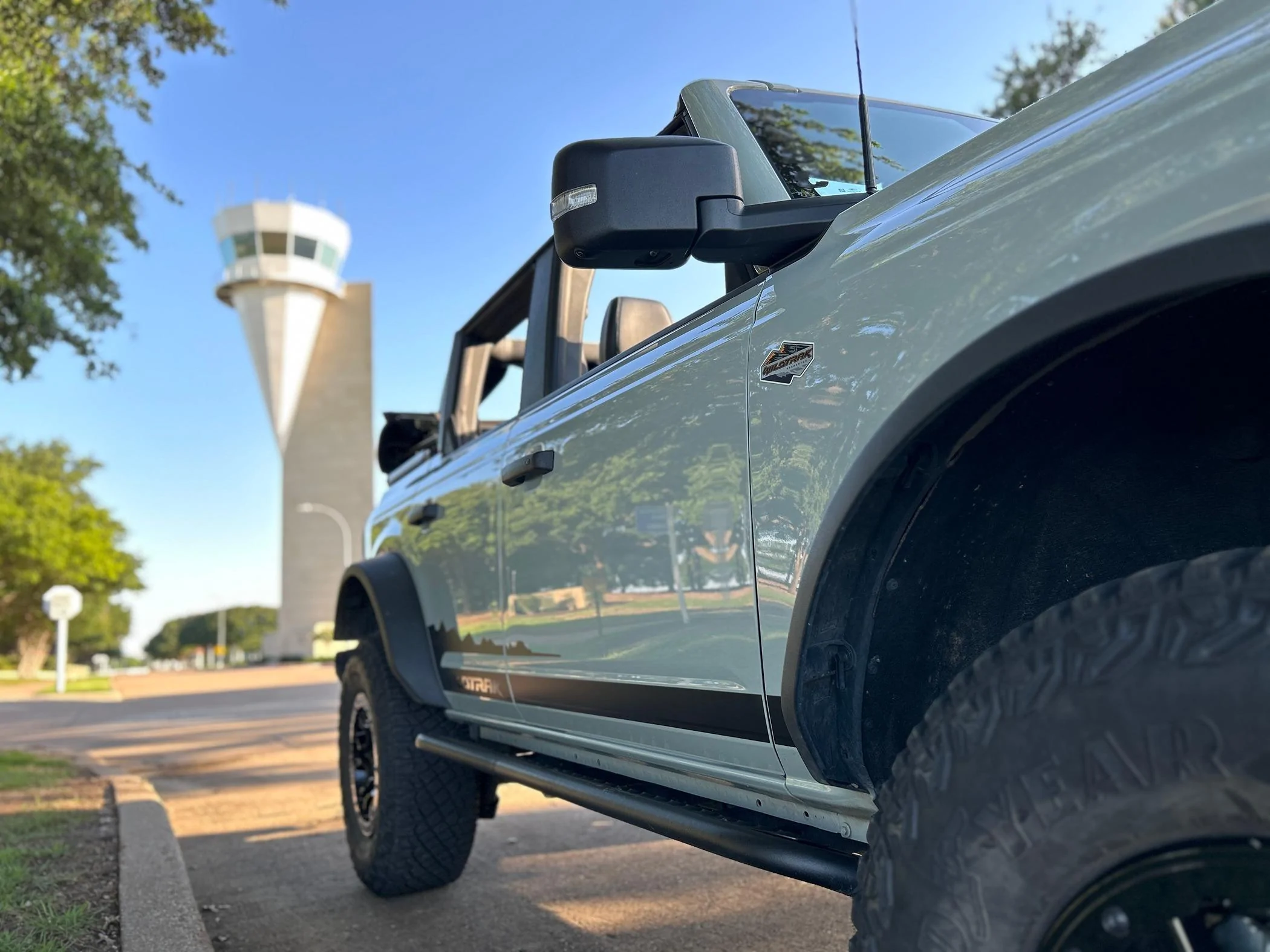

I had the Zone off-road level kit installed up front, then an RPG 2.25 inch rear puck to keep a little rake as I did not want to be leveled. It rides super smooth. I did have the Zone kit on for about a month or longer, then got the RPG rears installed today. Those actually improved the ride, it feels really smooth and solid. Wife loves it, so I'm super happy!
Measured floor to fender up the center of the tires, front is 41 1/2, rear 42 3/4.
Very happy with the outcome and look. and the 37's will be coming later this year.
I did also get the JKS max clearance kit installed at the same time to be ready. :)
