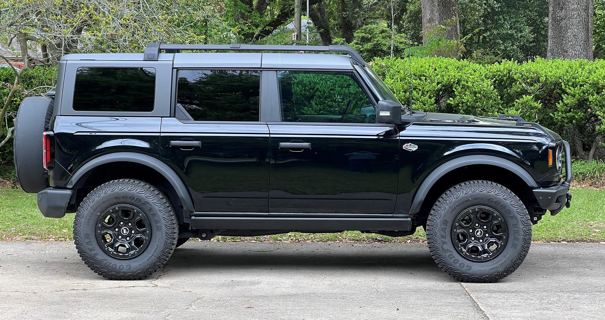

Thought I'd post this up as a teaser of what I did in my dive to leveling a Hoss 3.0 with existing lift options. I'll be back later to go into the nuts and bolts and perches and pucks. In stock trim, my '23 was about 1.5" higher in the rear at the fenders just before I did this. Truck is a little over a year old and some settling on the front end has occurred over the first year of ownership.
Looks perfect as it sits.

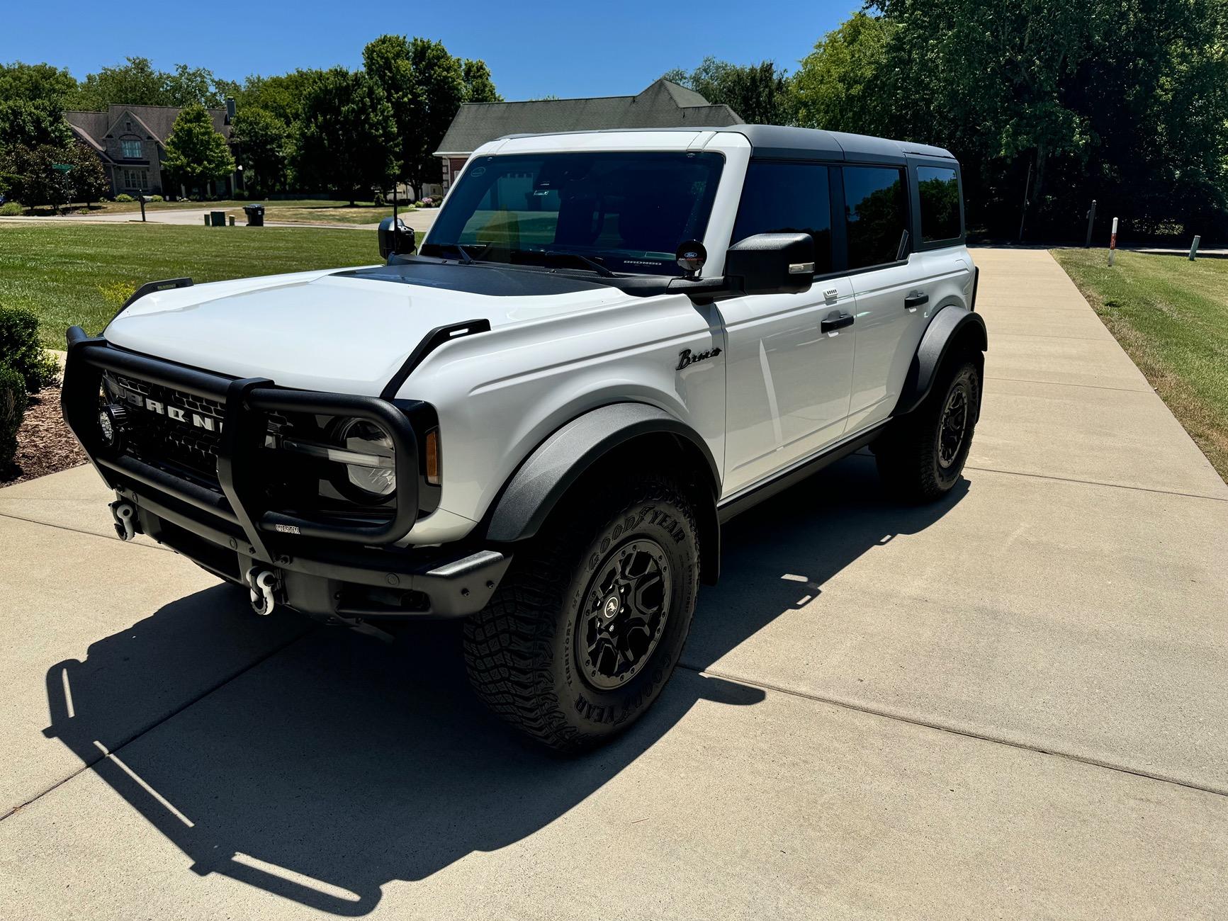

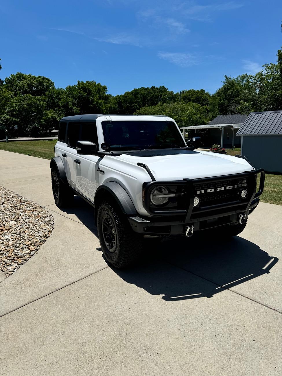

I am looking to JUST level, maybe keep a tiny bit of rake to avoid sag. I don’t really want to add anything to the rear if I can help it. I am never upgrading to 37s, maybe just to a true 35x12.5. I just can’t stand looking at the rake anymore!
Do you recommend the RPG 1.5”, 2.25” or just go with the RC 1”??
I’m probably thinking really slow today, sorry for the dumb question.

I think just the RPG 1.5" should do the trick. Mine has a slight nose up attitude when I have a load in the cargo area. I'm going to add the remaining .2" plate to the top of the rear shock at some point. The RC kit won't raise the front quite as much, but shouldn't affect the spring rate.
