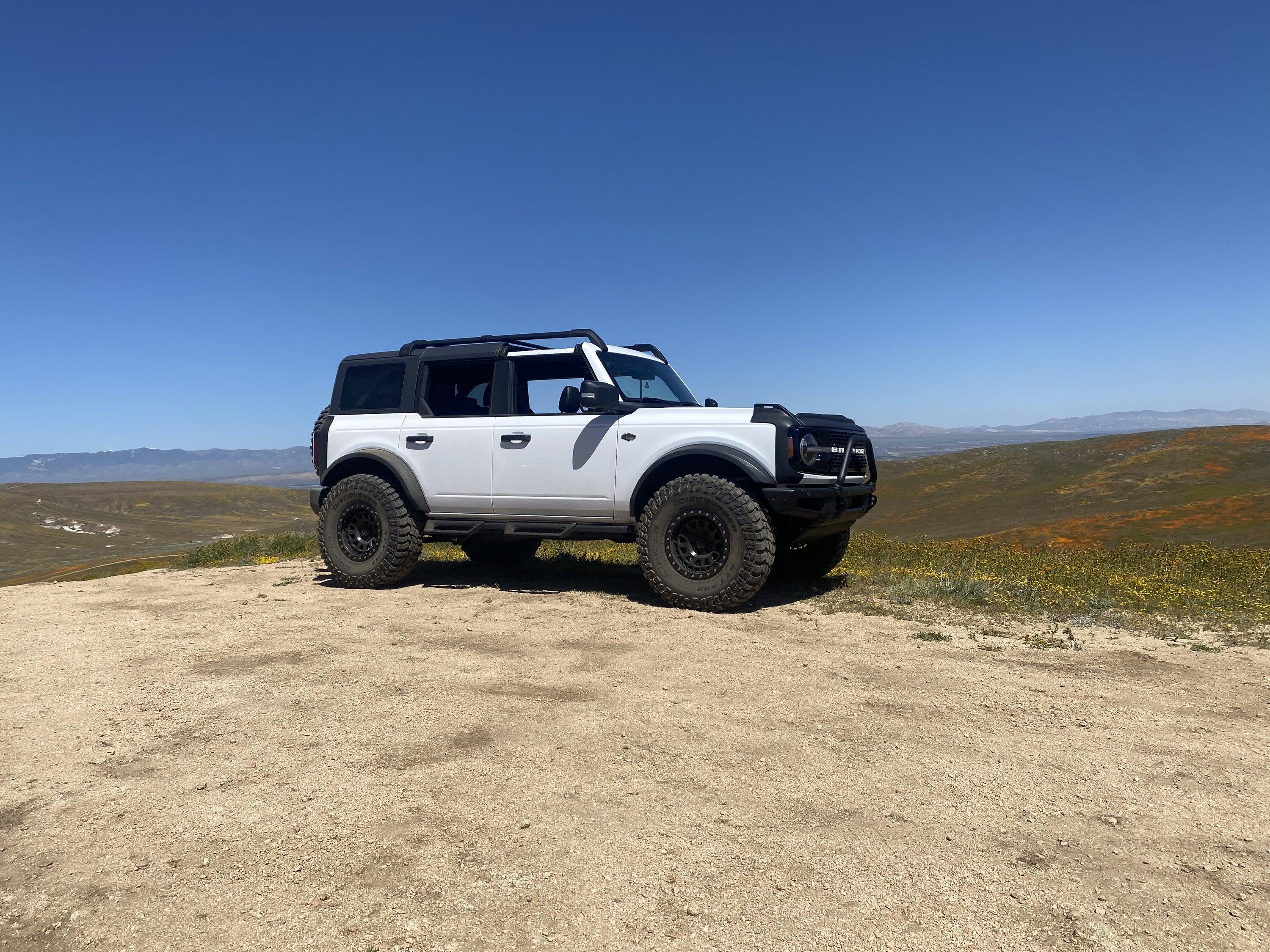

Thanks, that's the only one I have seen available so far. Would probably go 2.25 front and 1.5 rear. Was hoping someone would chime in that has this installed.🫤
I have installed RPG 2.25front 1.5rear w/ 37s they work well no rubbing but the front is a tad bit lower still. I think I would go with 3inch front and 1.5 rear.

Honestly I have ran this thing pretty hard and haven’t noticed a difference. Ride quality feels the same. Just more road noise now with actual M/Ts.
