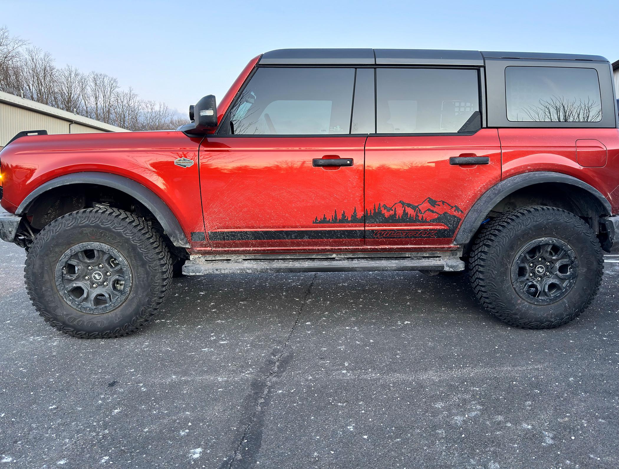

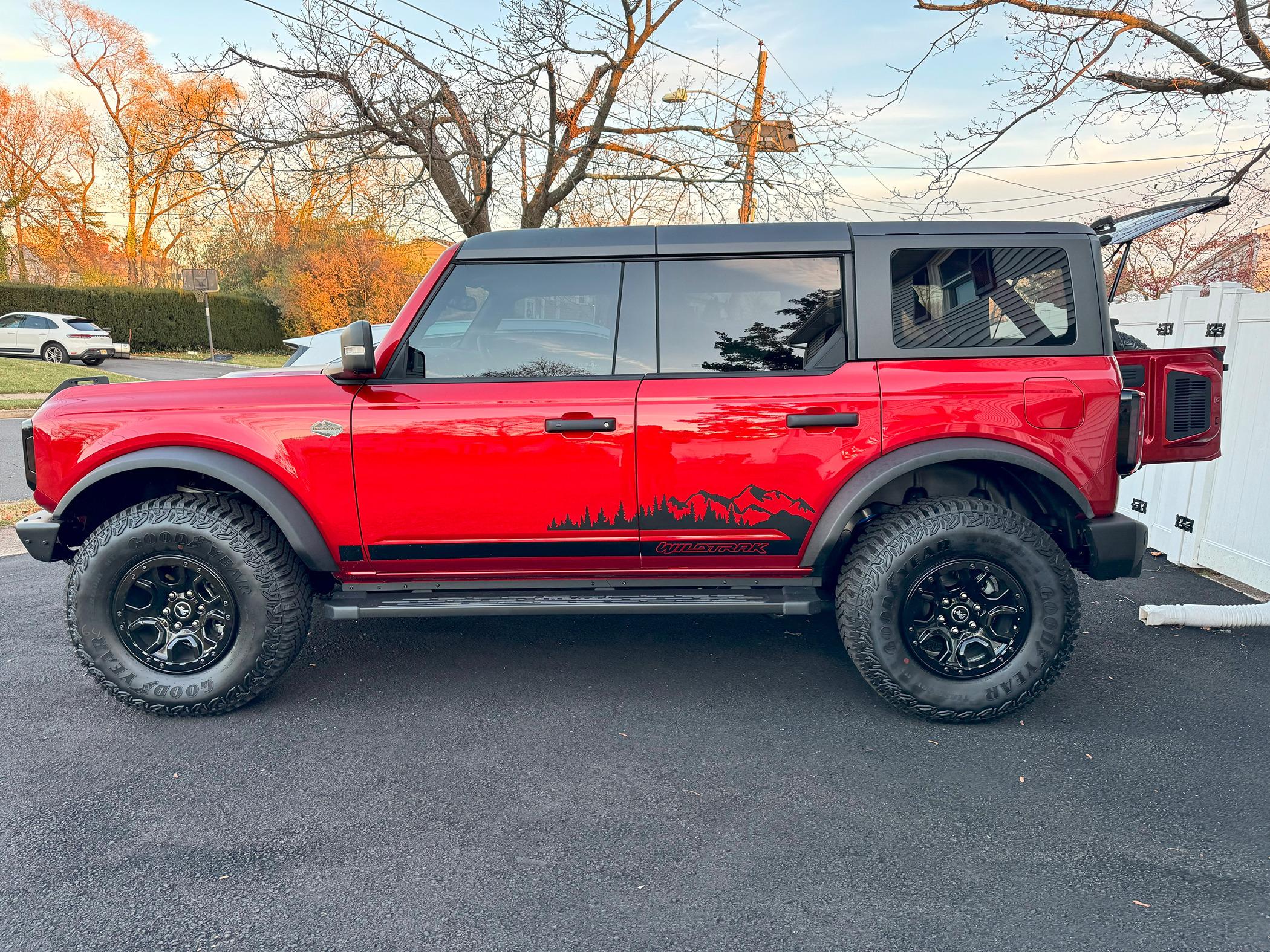

I would recommend the Zone level/lift designed for the Hoss 3.0. It just brings the truck up to where all the other trims on SAS are. I'm very happy with how mine looks and drives now.
Before
Ford Bronco HOSS 3.0 Lift options? IMG_0595
After
Ford Bronco HOSS 3.0 Lift options? IMG_1202

Looks good. To clarify, did only do the front leveling kit or did you do the zone 2.25 lift/leveling kit?
BroncoDymond88
Apr 7, 2021
763
990
New Jersey
Kia Sorento
I did the zone lift/level kit which lifts the back 1" and the front 2.5" and levels out the vehicle to match the other SAS trims.
