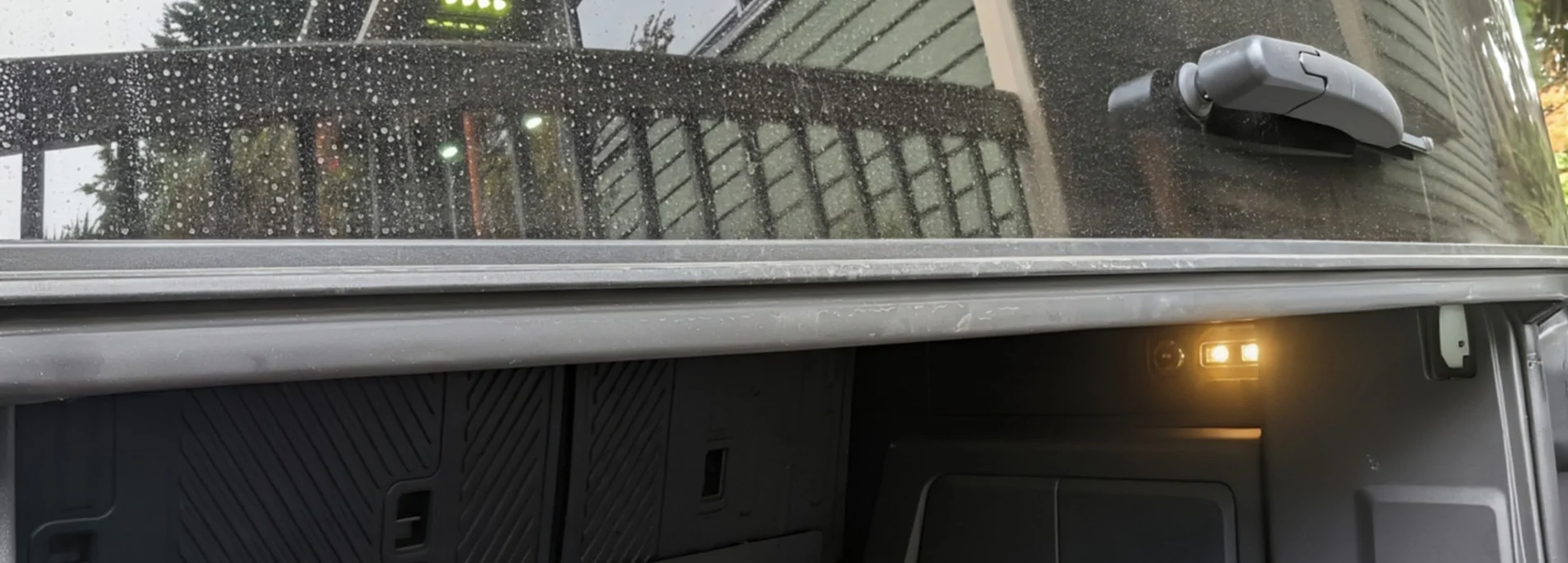

Note, my "squeak" sounded like a battalion of blood thirsty, angry rats in the cargo space. And that was on any surface but the smoothest of pavement. It was not just a periodic, mild annoyance. Our 2 door had some squeaks in its top, too, but nothing remotely close to the cacophony from the bottom rear window seal in the 4 door.
I put the Sil-Glyde on VERY sparingly and SUPER thin rubbing it into the seal really well and making sure the whole thing was coated. It's difficult to spread evenly from a large dollop, so I just put multiple small light smears on every few inches and added additional small small smears in if needed. When using the Sil-Glyde, if the seal has a bluish appearance after application, there is FAR TOO MUCH on it. If the seal looks black, but a little greasy, still got way too much on. If it just looks like a fresh, new black seal....that's probably right amount. Having it that thin, it doesn't appear to act like fly paper. I live on a short gravel road with a gravel driveway and some very large, messy conifers. Even so, my seal has not picked up a ton of garbage over the last 2 months (pic from today below). It might be getting ready for a second application, though.

This is a prime case where the ā€œbigger the glob, the better the jobā€ does not apply.
