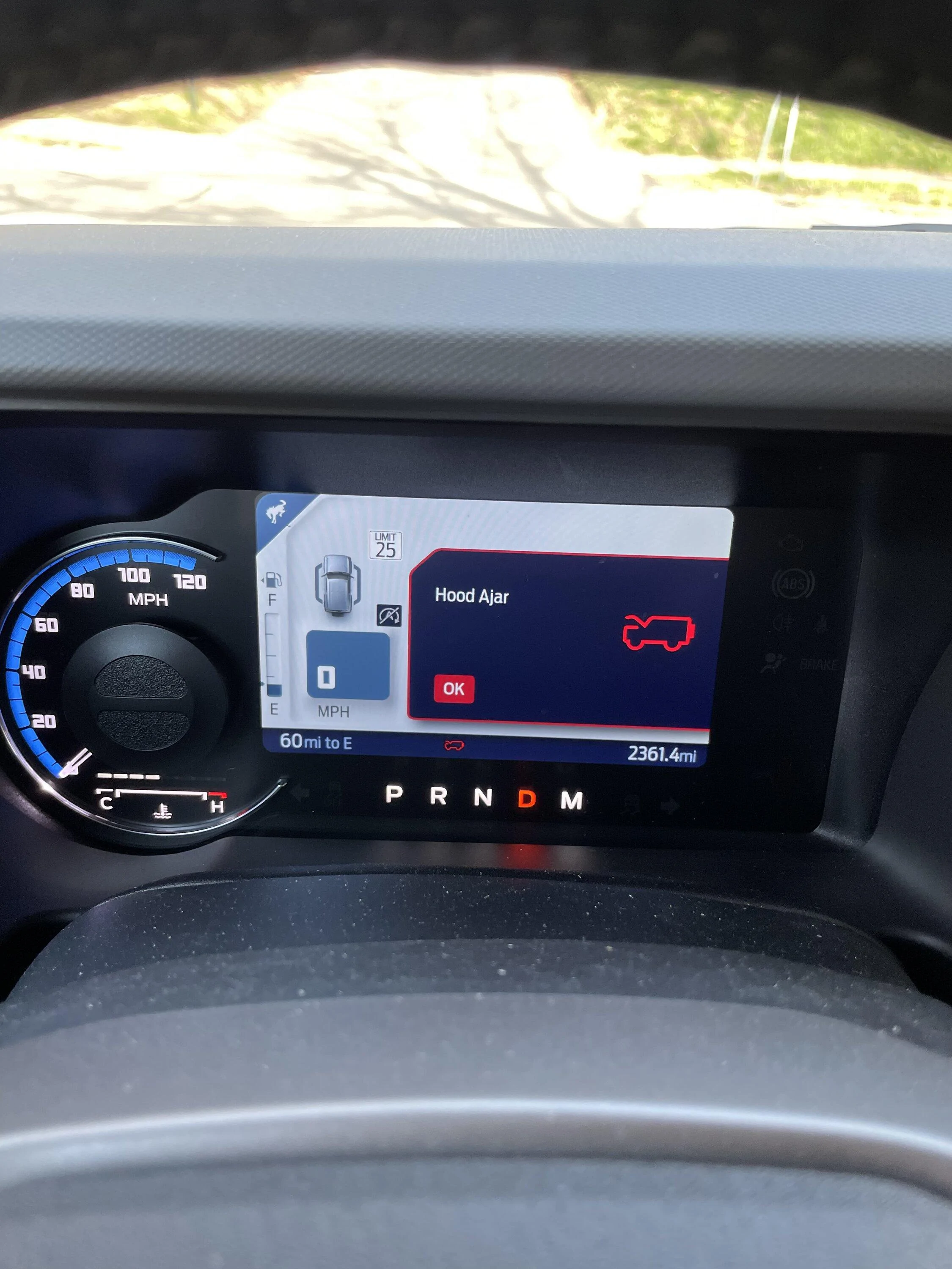

Ok, it’s getting a new hood latch next week. The new hood latch has a different (updated) part number. My dealer gets parts from the DC warehouse I’m told and where there is normally hundreds of them, there were 2, now 1. I’ll update once I see the new switch and any differences.

My 23 sent the hood ajar message to my phone once and another time while i was driving. I slammed the bejeezus out of the hood and it has not happened since (750 miles)

***update**. Had my latch replaced and no issues so far. If you have an issue with yours I would take it to the dealership and get it fixed under warranty. Hopefully you won’t hear from me again on this issue LOL.
Same issue…. Actually happened the first day I drove it home from the dealership. I just assumed the sales rep didn’t shut it well… then alarm would go off in the middle of the night… then at work… then beeping while driving…. Drives me nuts…. I’ve had to take it in twice. First time they “adjusted it”…. Then decided to replace it. I suggest if you ever take it to the dealership you ask them to order a new one and disconnect it to keep the alarm from going off…. Sounds like there was a bad batch of these from November to January

Brought it to the dealer after the alarm went off like 8-10 times in a week. I took a screen shot every time my app went off, since they automatically erase themselves with subsequent alarms.
They found a defective hood latch/sensor. Had it replaced under warranty. So far so good.
So it is indeed a defective hood sensor? Figured. This has happened to me like everyone else; multiple times. For me thus far, opening and shutting clears the issue for a while, then a few days later, it’s back.
Wish the release weren’t plastic either, but expected in a modern vehicle.
Maybe I can wait until my oil change, but if it gets worse, like when moving as many of you experience, will have to take it in.
This sounds like what should be a recall.…

I had a hood latch issue with mine from day one of purchase. I took it in and there were two other Broncos in service for the same issue. Mine turned out to be two things.
1. Hood was severely out of alignment. This is something you could see, and it was BAD. I fixed this issue on my own before taking it to the dealer.
2. Turns out my hood latch was under way too much tension. Dealer loosened it some and its been working perfectly with no issues since.
Mine never gave me the hood ajar notification, but the alarm was going off every 5 minutes with no one around it, at all times of day/night. I'd get a notification on my phone stating that the hood latch had been popped.

Ok, you’re making me wonder…..
Well, my hood seems to be aligned well. I installed lights the second week and first thing I checked were for panel gaps, so the MAP crew did a good job on the line with mine.
Glad adjusting the tension may have worked for you. I’d prefer the part just be replaced since the part seems to have been updated.
These things happen with technology sometimes. The Ford rep on here actively monitoring is reassuring to me since at least they aren’t ignoring the problem, but stepping up to address it when they learn of it.
Could just be a bad batch or the manufacturer.

I and the tech definitely thought the hood latch was going to need to be replaced. If the issue comes back, I will for sure have them replace the whole latch.

No solves but you can add me to the problem list. Happened a few times but n a row coming out of the stereo shop then went away for a week or two then t was 2-3 times daily. Had to leave the truck unlocked which is NOT an option then today it must have happened 10 times. I adjusted he bumps all the way up hoping to bend it at a little to keep contact and that didn’t help. It seems to get worse with heat. Dreading taking it to the dealer to get jerked around / part not available / can’t duplicate it. It looks like it just goes to ground so I may ohm it out to confirm and just cut and ground the wire to save the hassle.

Good morning! I'd like to look into this for you. Feel free to send over a private message with your VIN and dealership information at your earliest convenience.

2023 Badlands threw this error for the first time today. Built 12/5/22, delivered 1/2/23, 433mi. Definitely seems like a bad batch of sensors…

There is. Ford has already released an SSM detailing this. Hood latch replacement is the repair.
