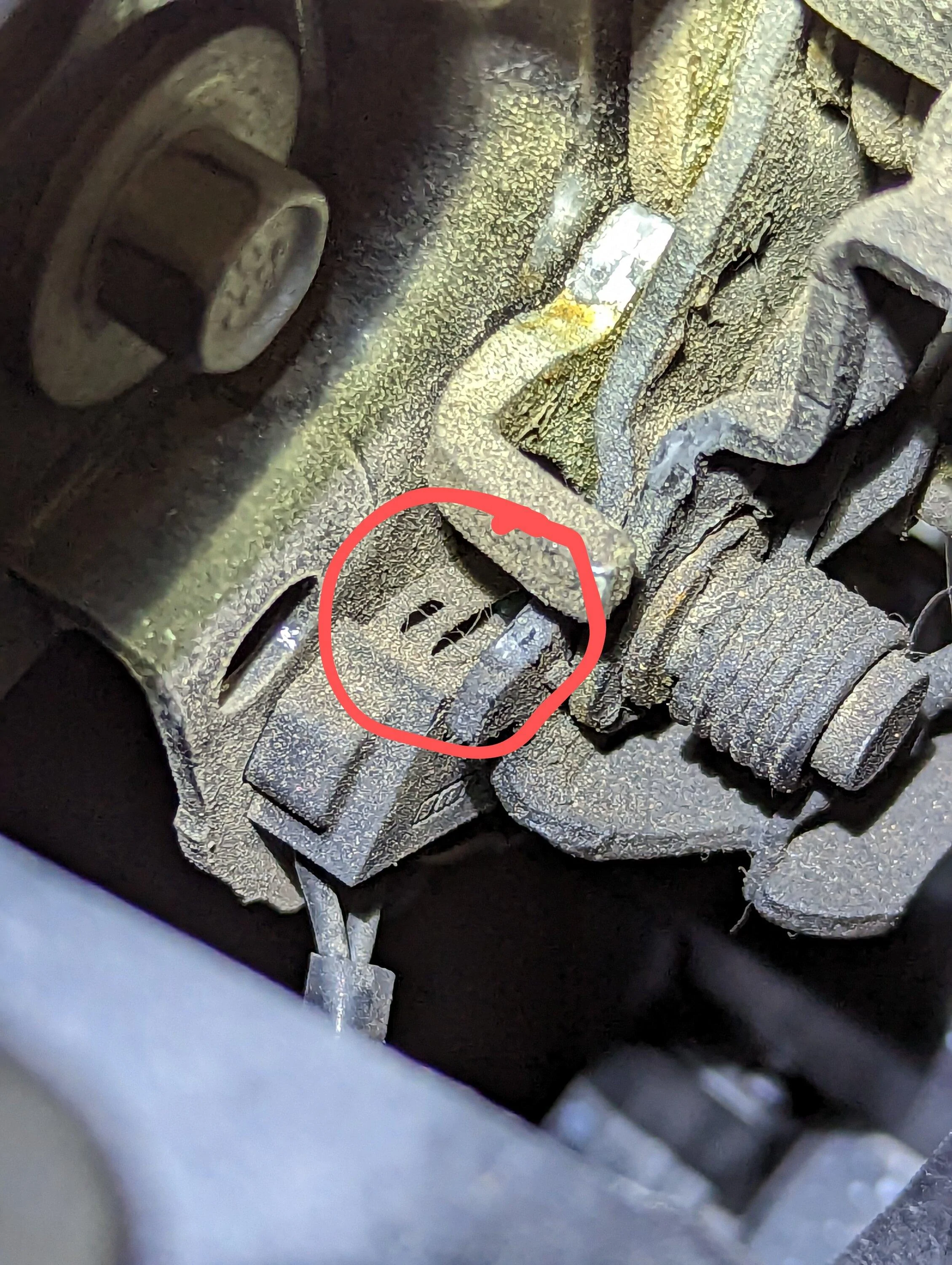

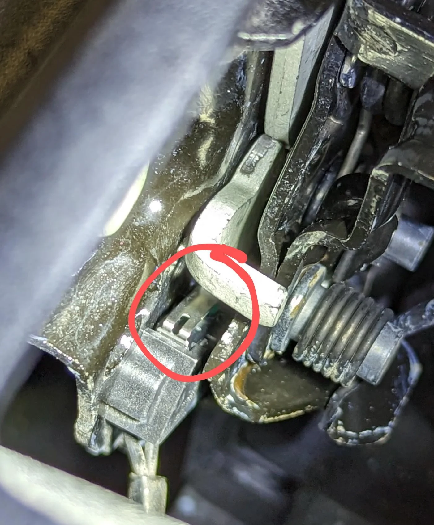

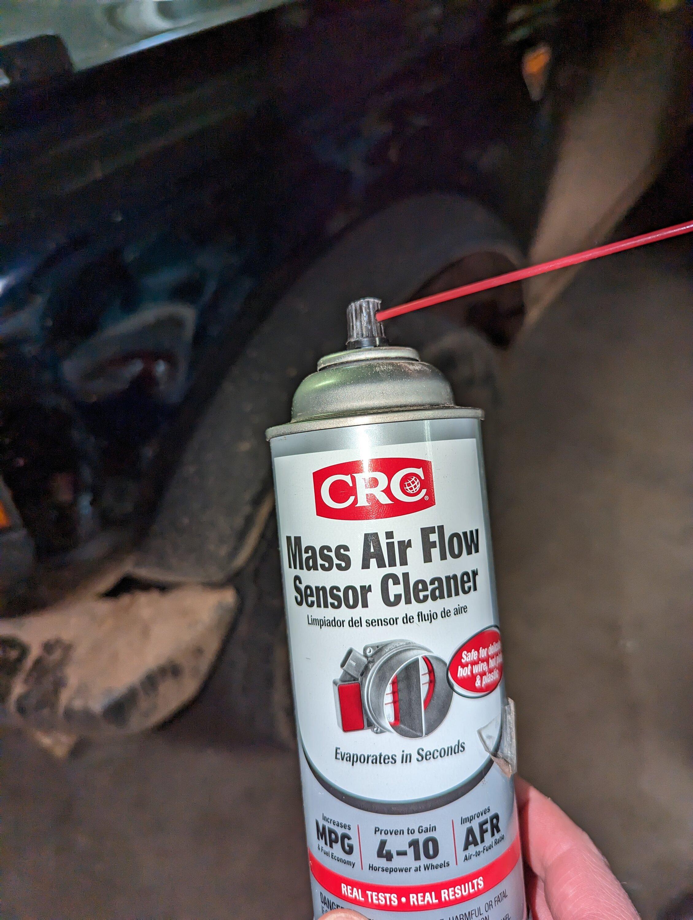

This was happening to me too. After looking at the latch I realized a sensor on the assembly had grease on it so I cleaned it off with some mass air flow sensor cleaner and it seems to have fixed it.
Thanks for this. I'll be looking to do this tomorrow!
