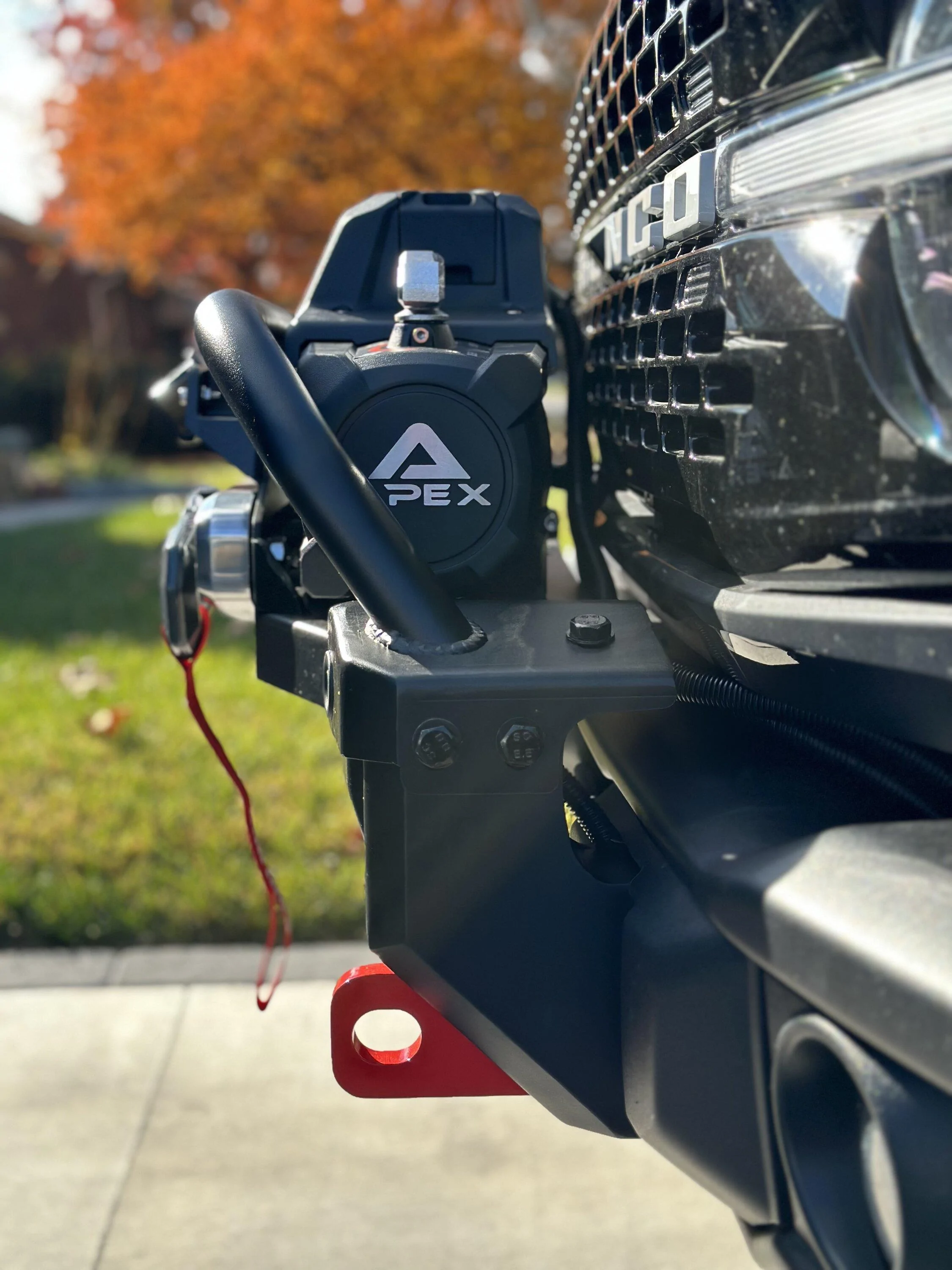

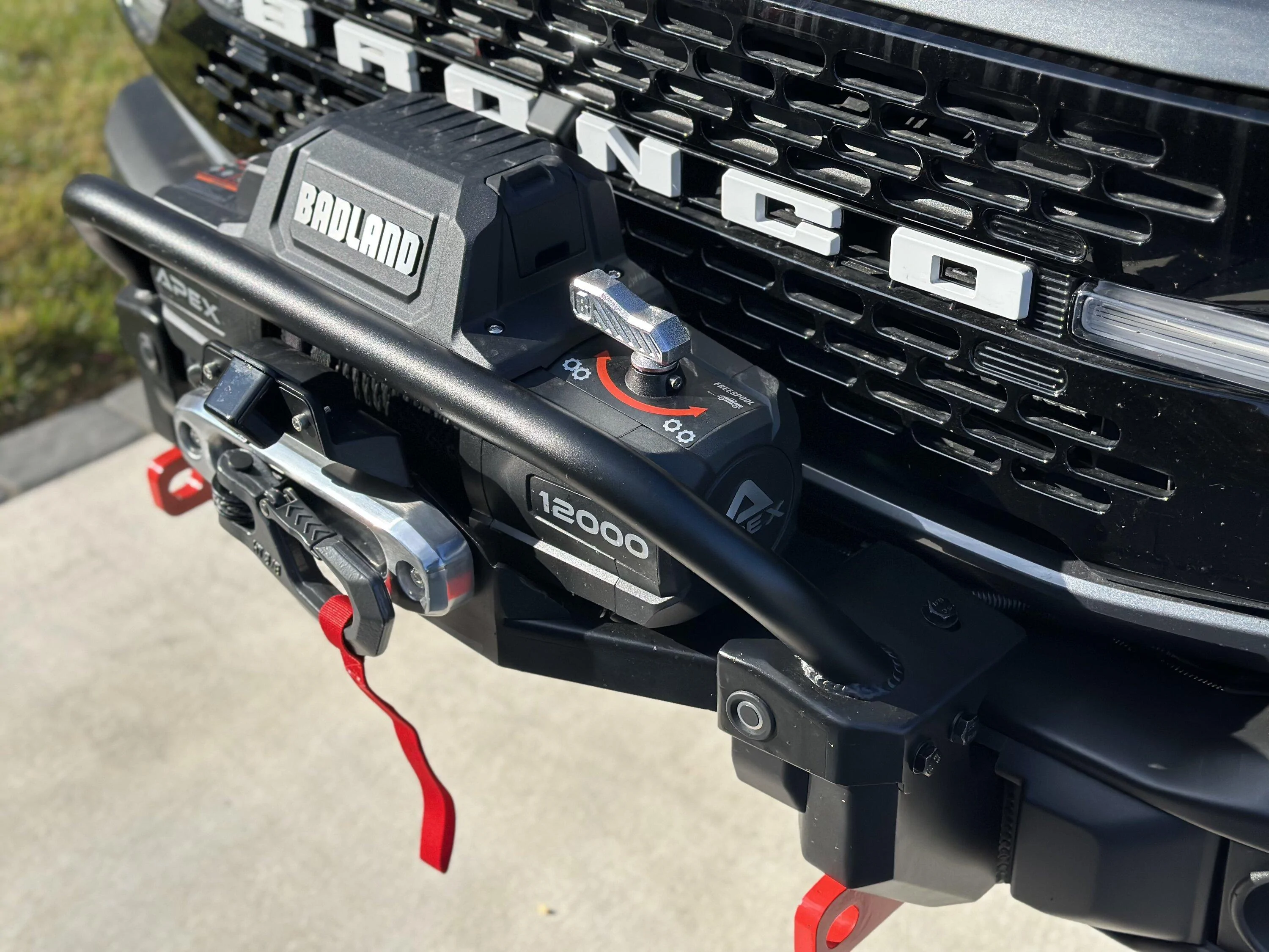

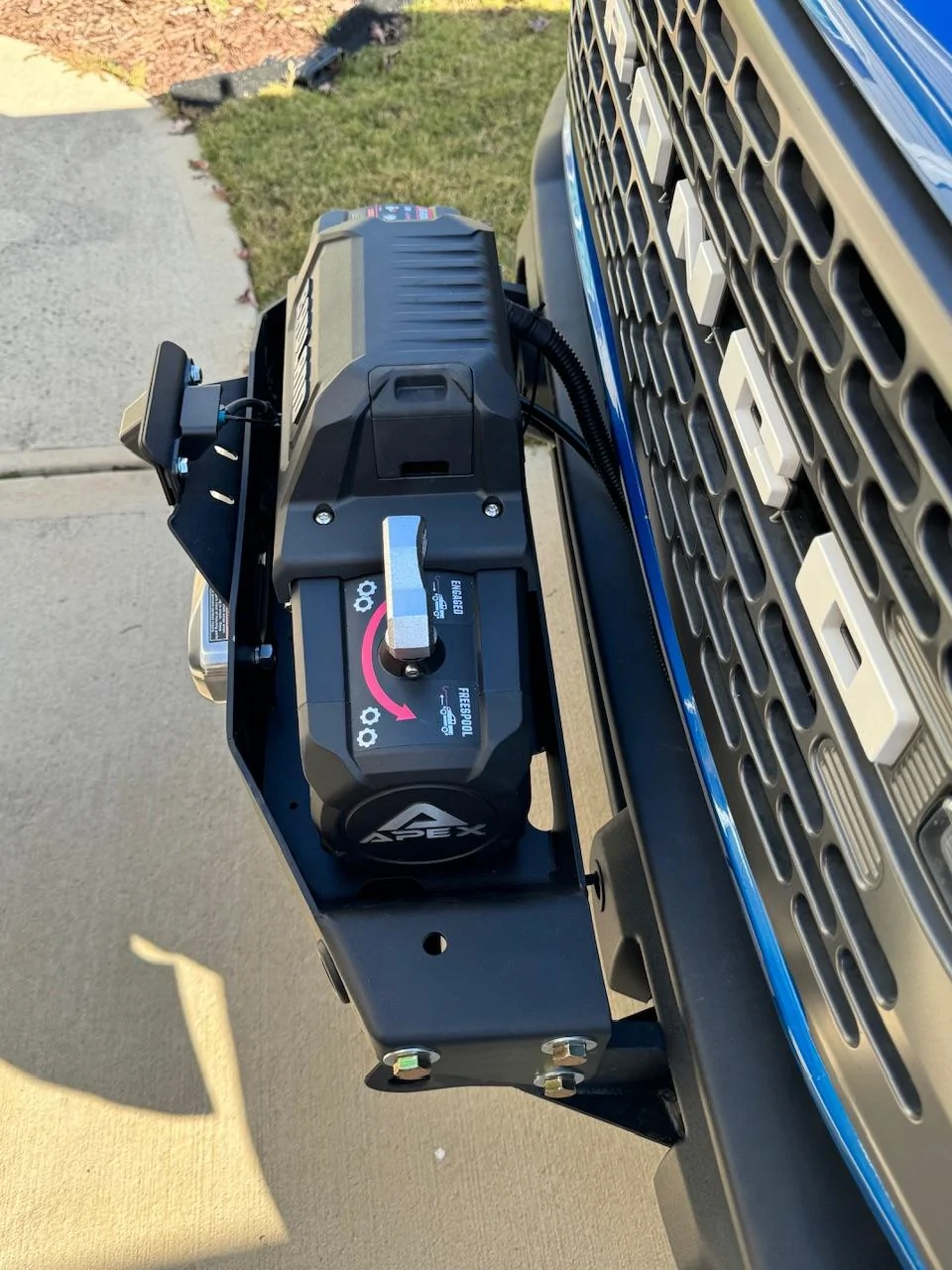

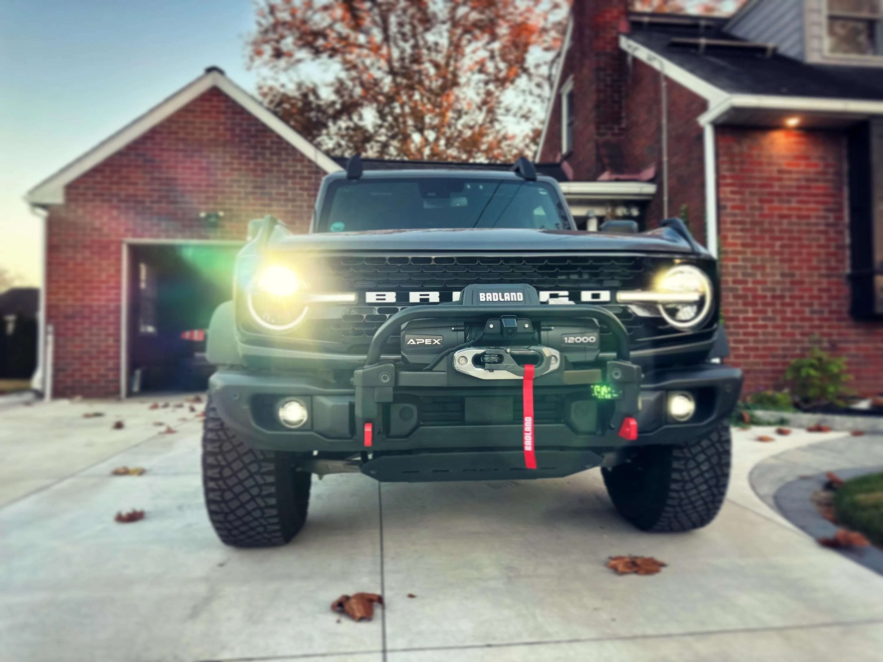

I’d say no more or less than the Ford Performance model when installed. The winch mounting brackets are pretty beefy at the mounting point.. Additional the recovery point is directly in line with the mounting point and frame, so the force should be transferred directly and not at a leveraged angle like some of the other offerings I’ve seen the last couple years. This is the first one that fit what I was personally looking for. The capable bumper has been the red-headed step child of development.
Except that the Ford Performance one DOES INCLUDE braces for the frame horns..
Yeah I just looked up the instructions for this kit and it definitely does not include braces for the frame. So yes... definitely invest in those @NJRoadkill.
I don't know why, but very few (if any) of these aftermarket high-mount kits have added bracing for the frame. All they really had to do was copy Ford's homework, but for some reason they decided not to. I'm guessing they're trying to cut down on costs, but the lack of bracing is one of the reasons why I specifically went with the Ford Performance kit on my capable bumper over the other options.

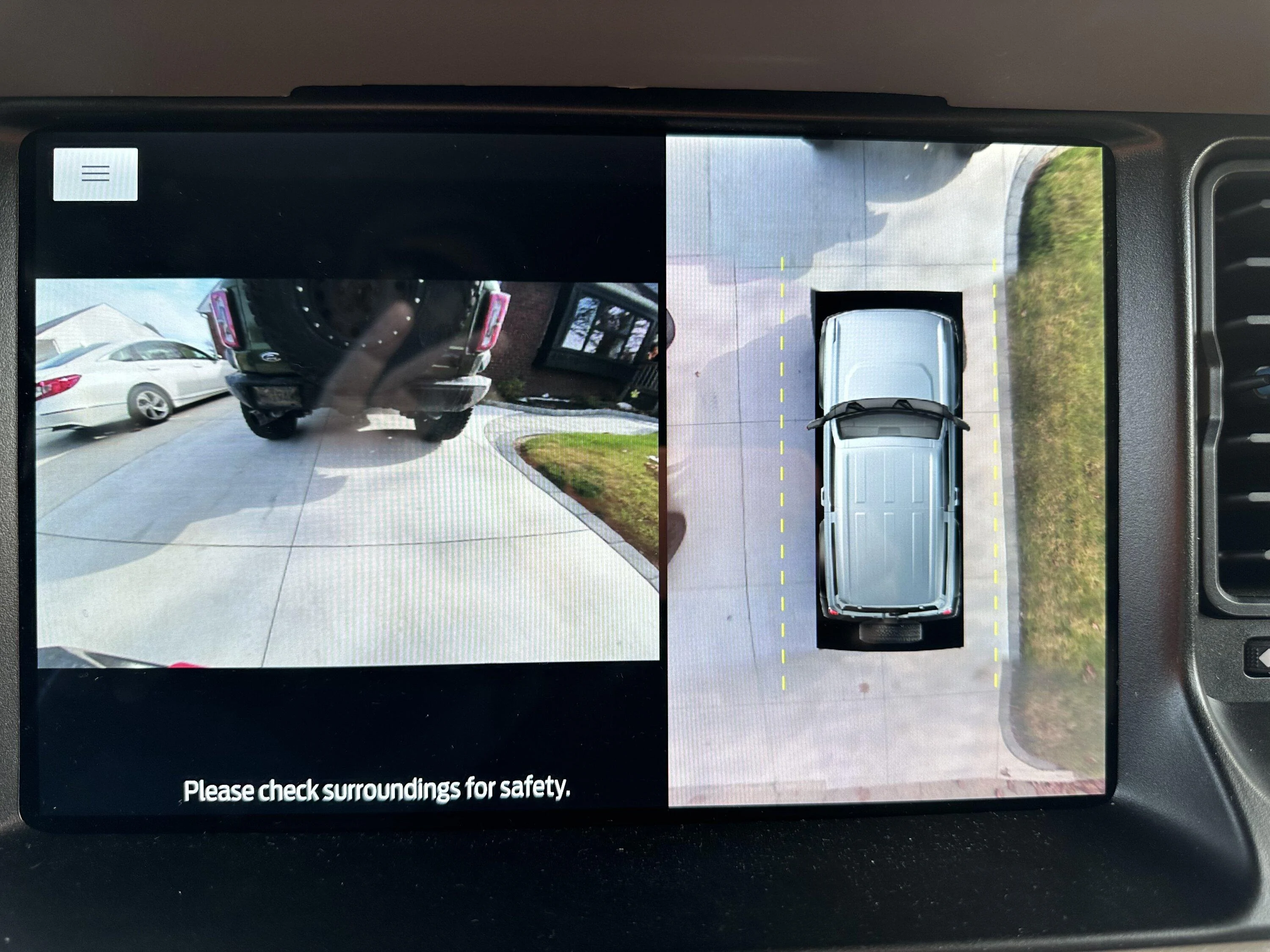

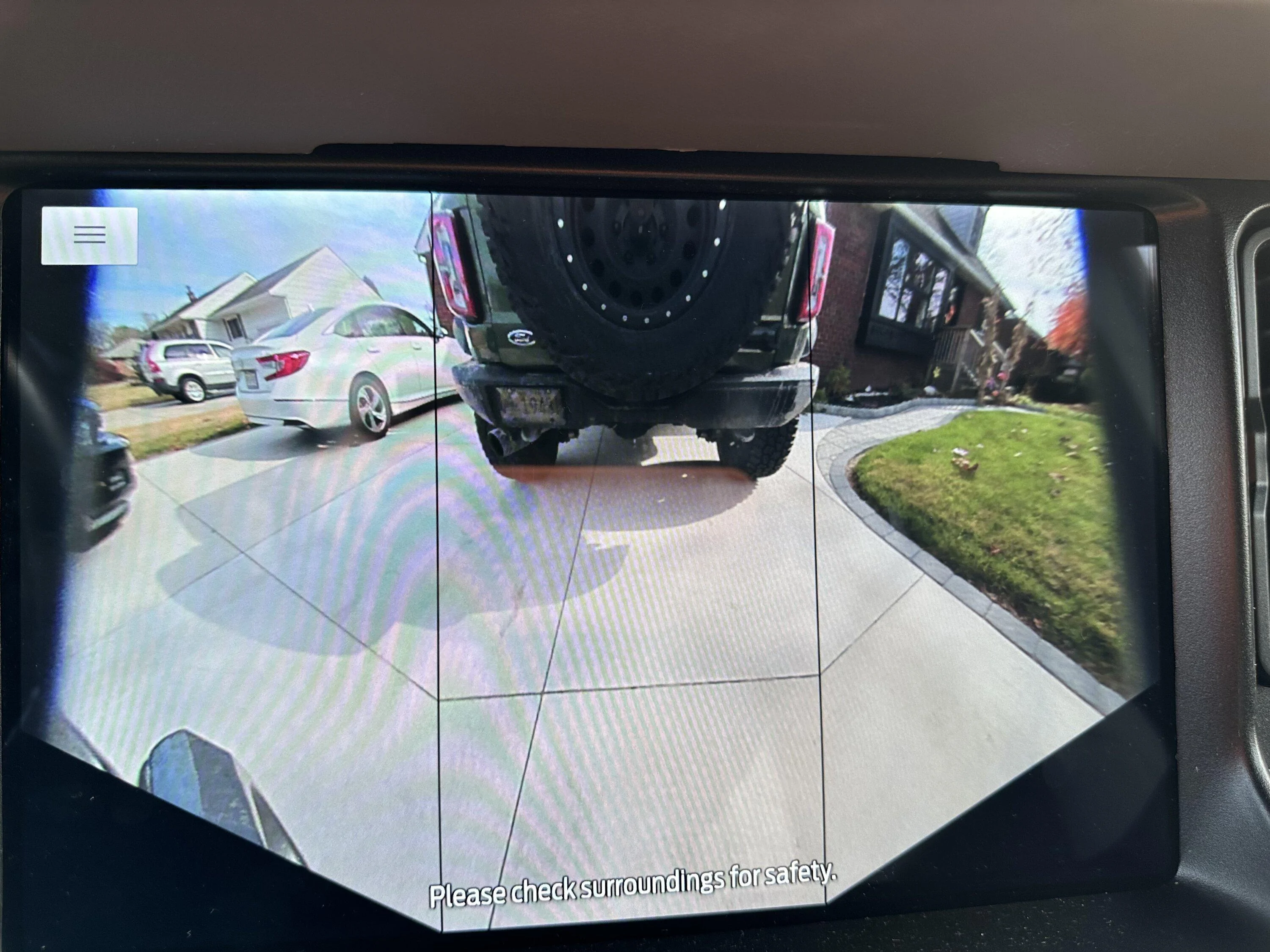

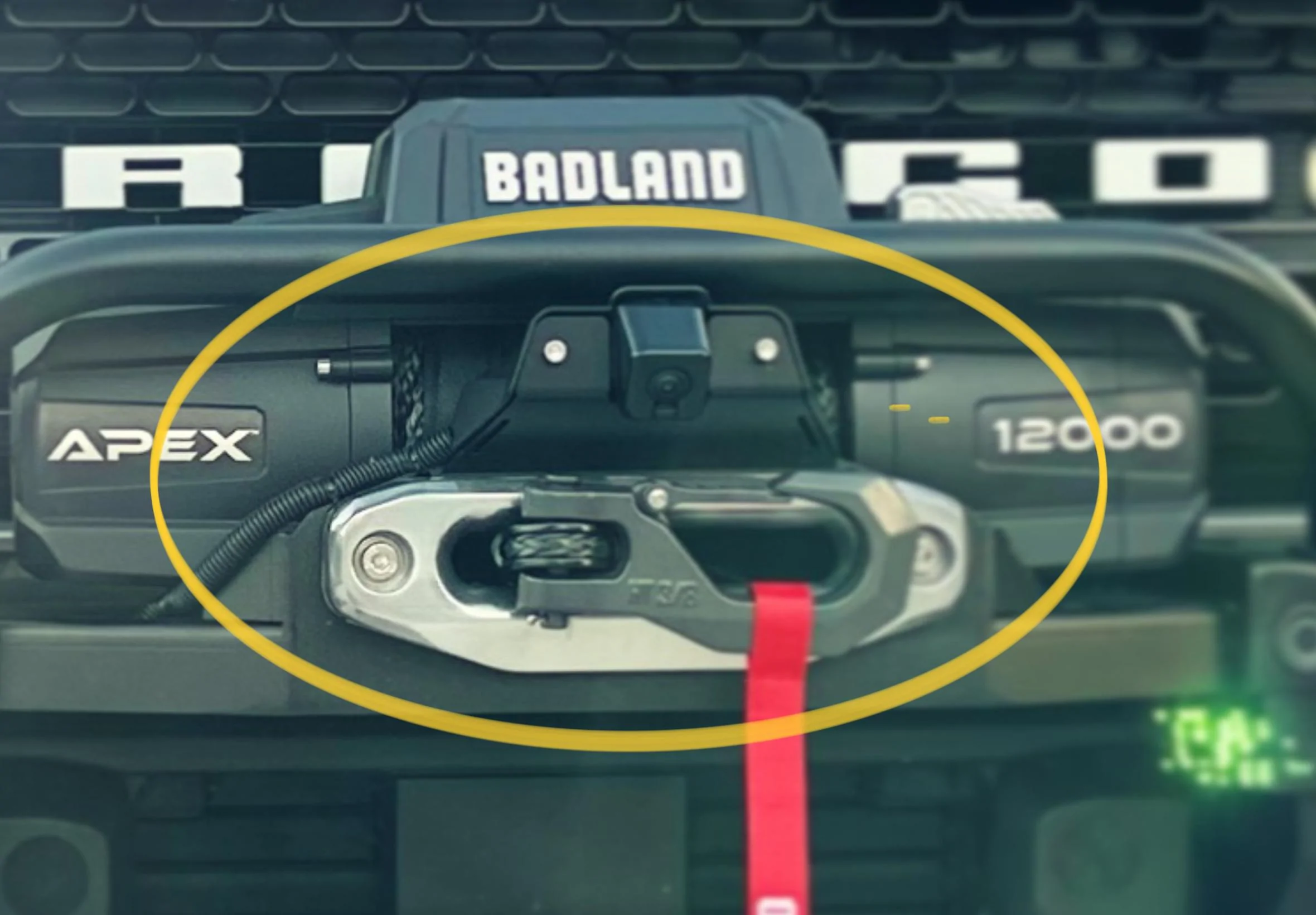

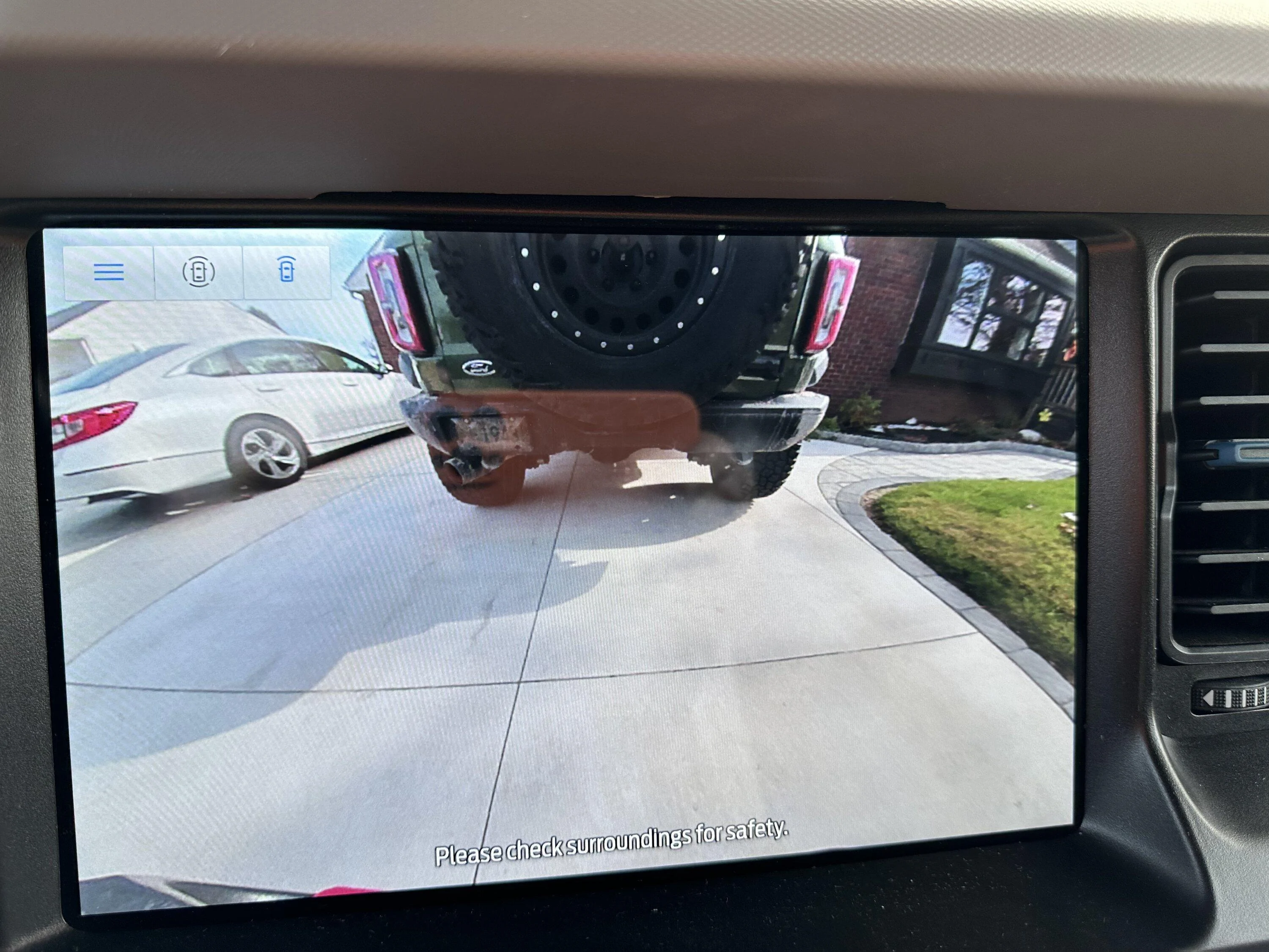

Nice job on the install!! This seems like an awesome option for those with the High/Lux package. Camera view seems basically unaffected.

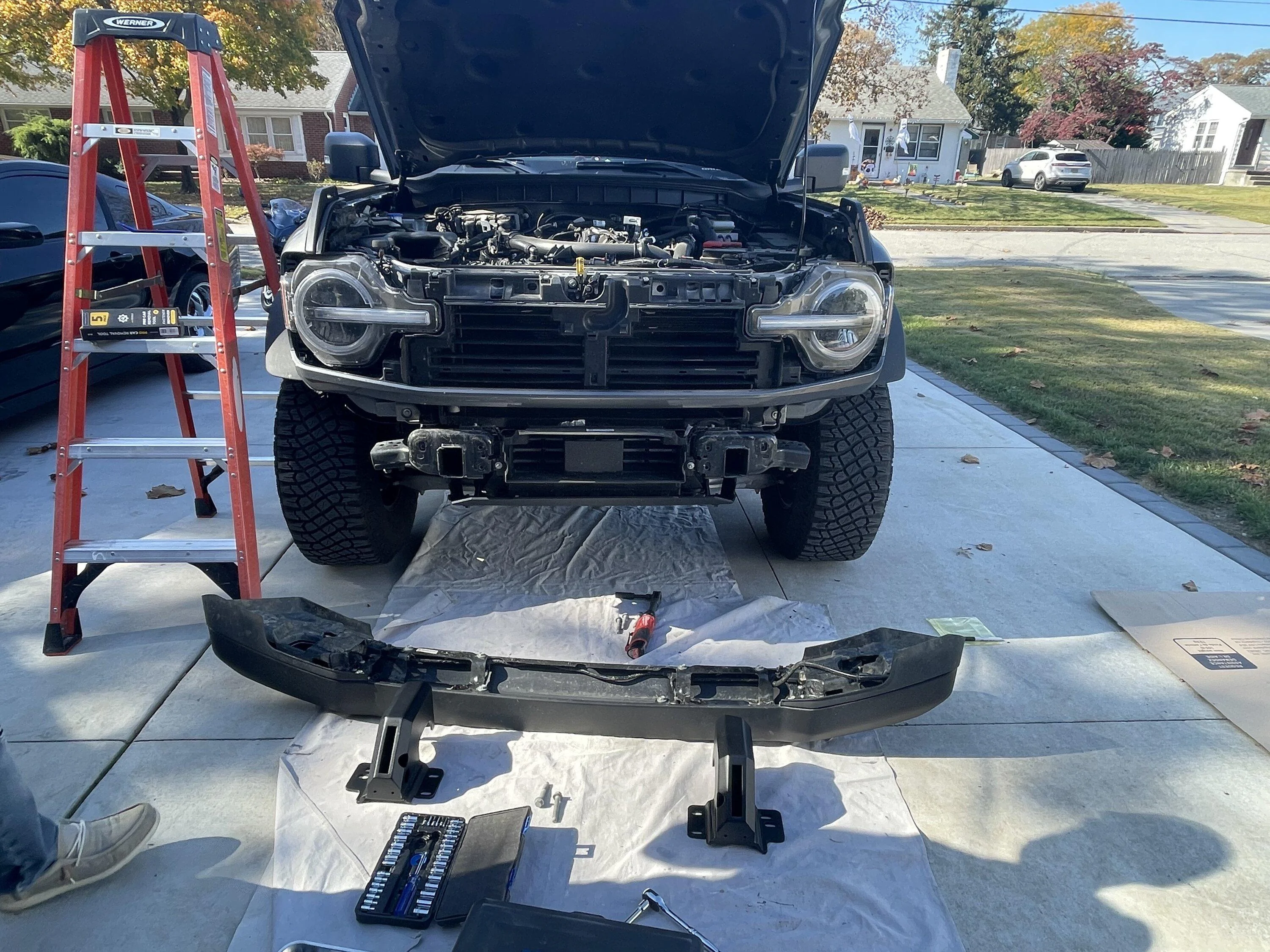

Yeah, definitely would have been a good detail to know prior to installing. 😂
No big deal. I wanted to add a switched relay anyway. I’ll get the parts, take a day to break it down, then tweak a few small details. I still have some bar clamps and lights to install.

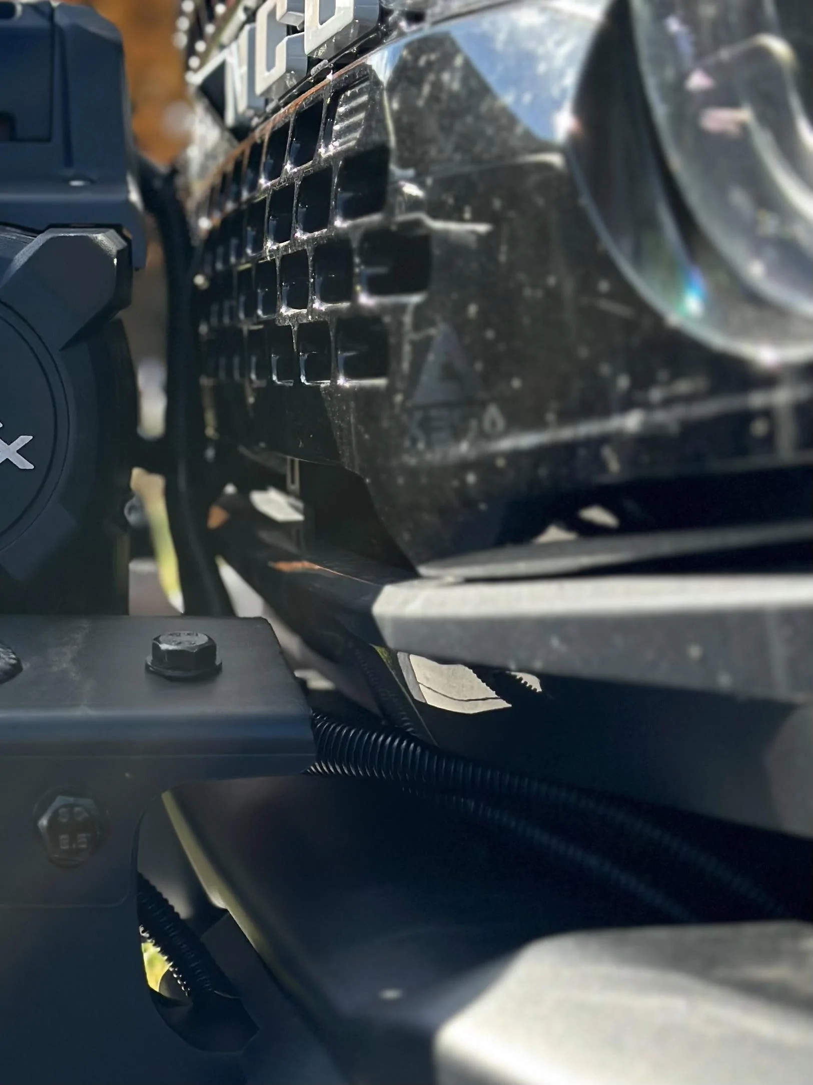

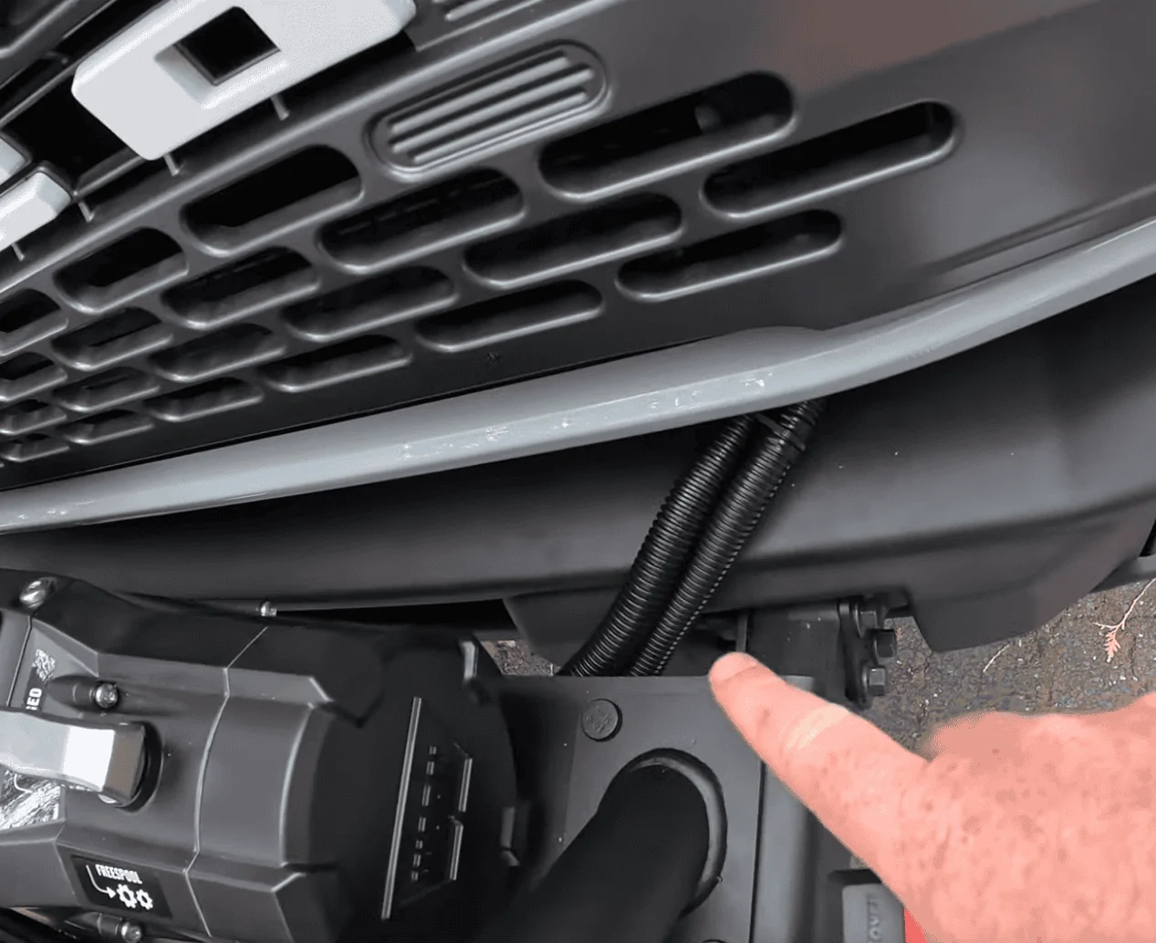

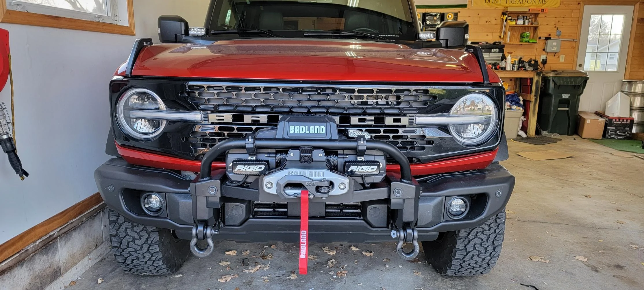

Running the power cables so they would be hidden was the one thing I couldn't figure out how to do, and I was racing the rain so didn't get much time to fuss with it. Ended up having to run them up and over the bumper.
Not a huge deal I suppose, just doesn't look super clean. If you figure out a better way to route them when you go to tear it down again... let me know. 😁
Ford Bronco High Mount Winch Plate installed on Capable Bumper 1699932350830

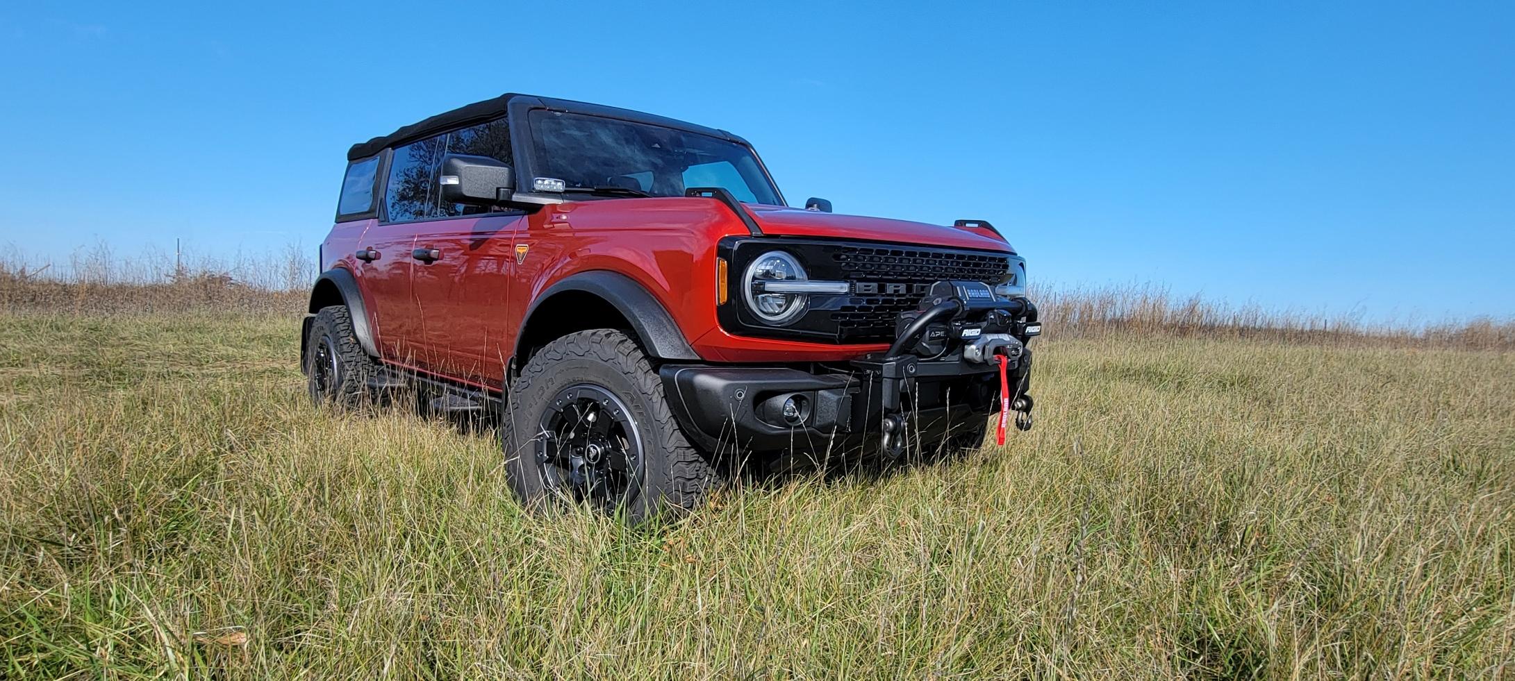

That’s where I’ve seen most installs run it regardless of winch or mount. Looks good.
Ford Bronco High Mount Winch Plate installed on Capable Bumper 1916FD3C-D752-4890-ADD4-FE9A3B5B6D34

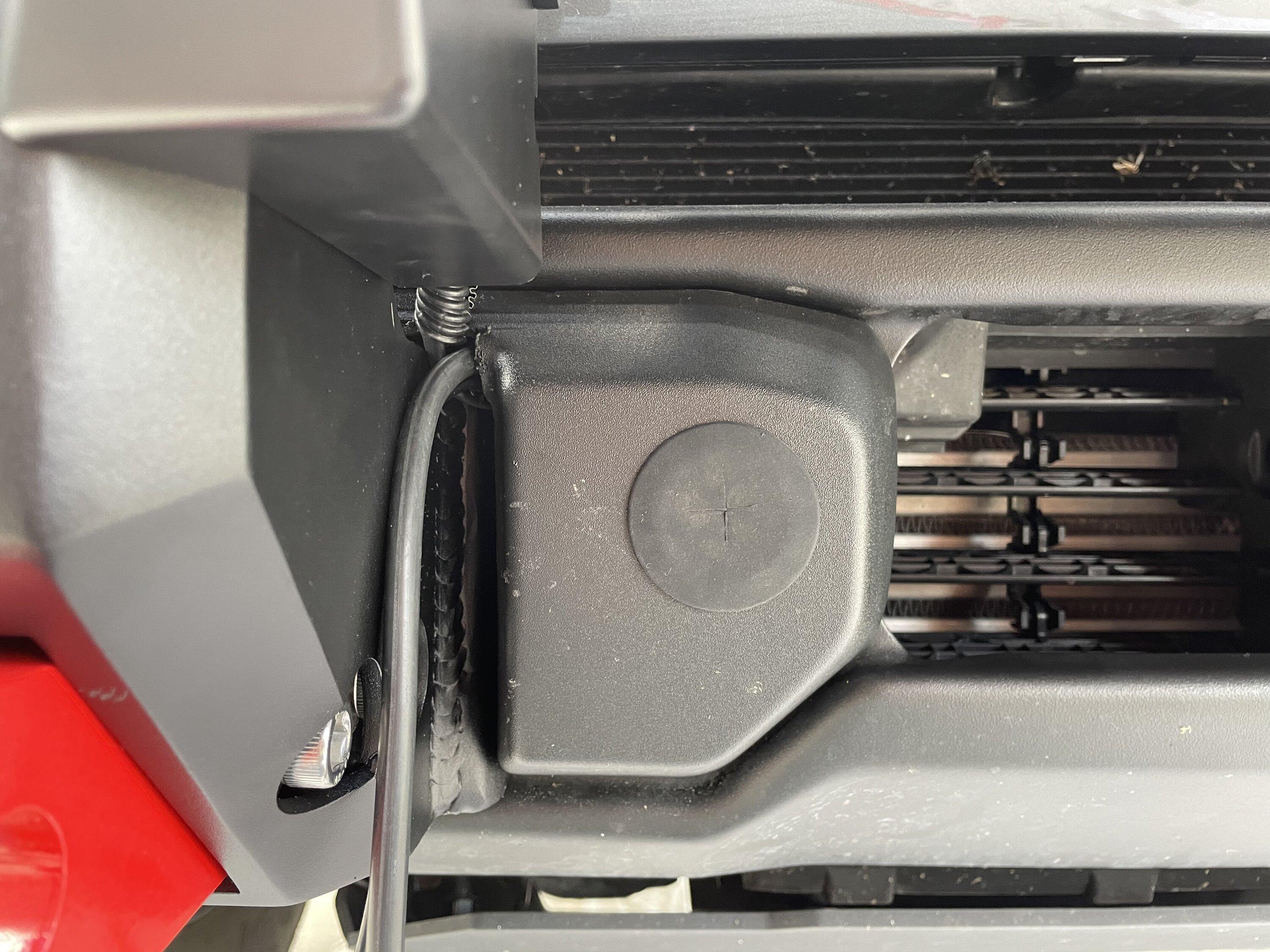

I went the JCR route on my capable bumper and have my wires routed the same way for reference.

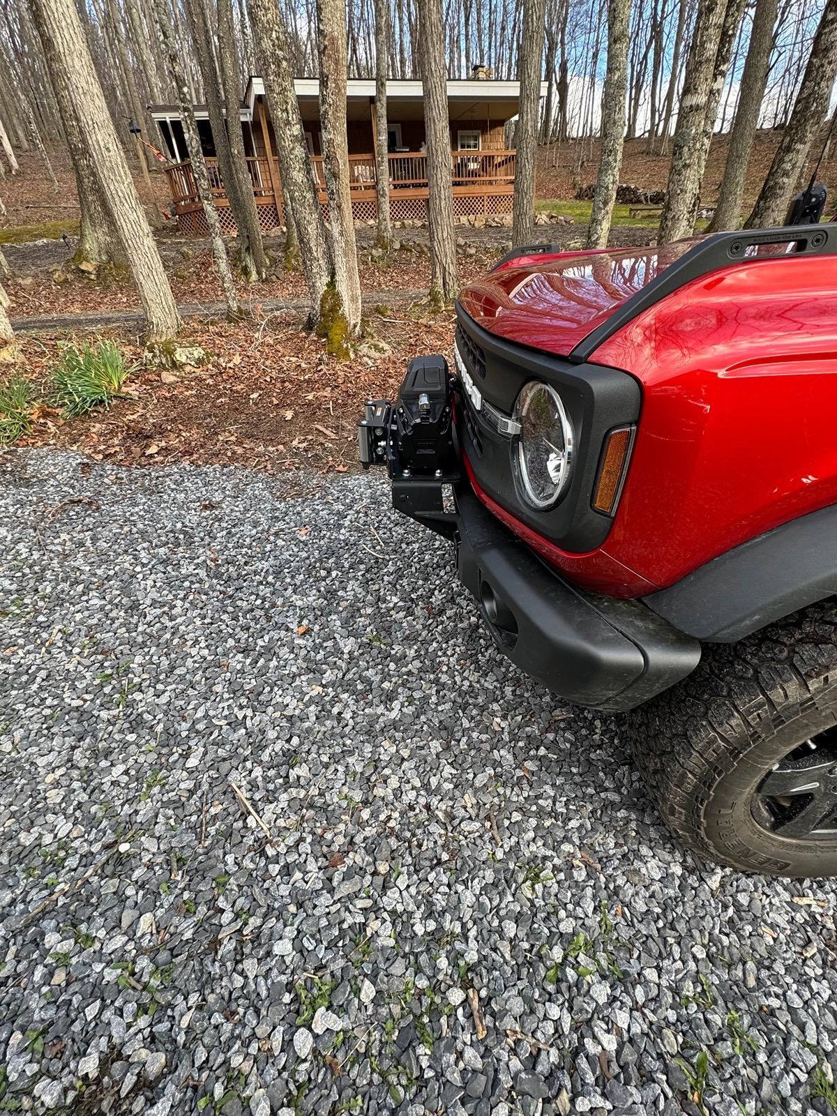

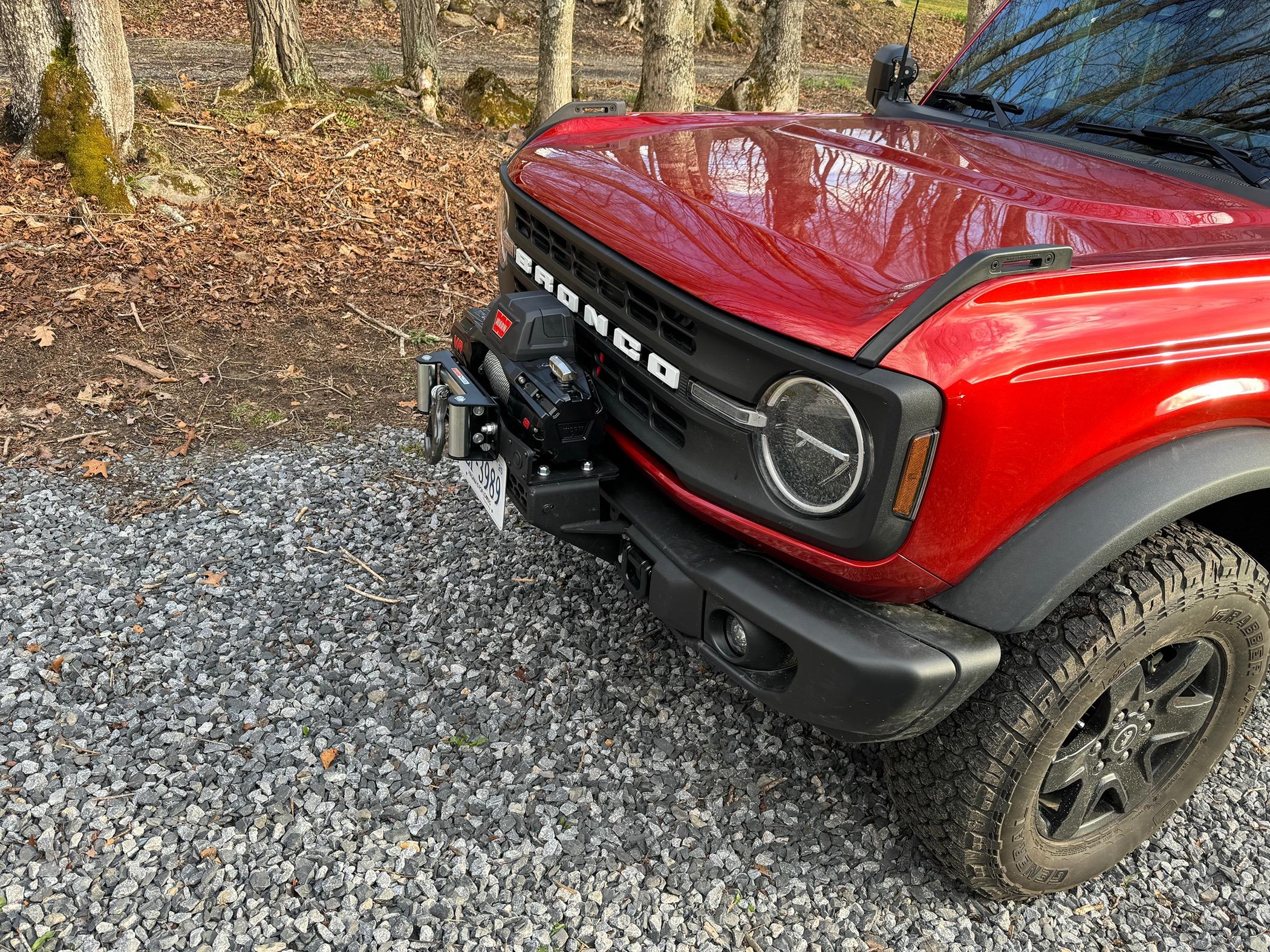

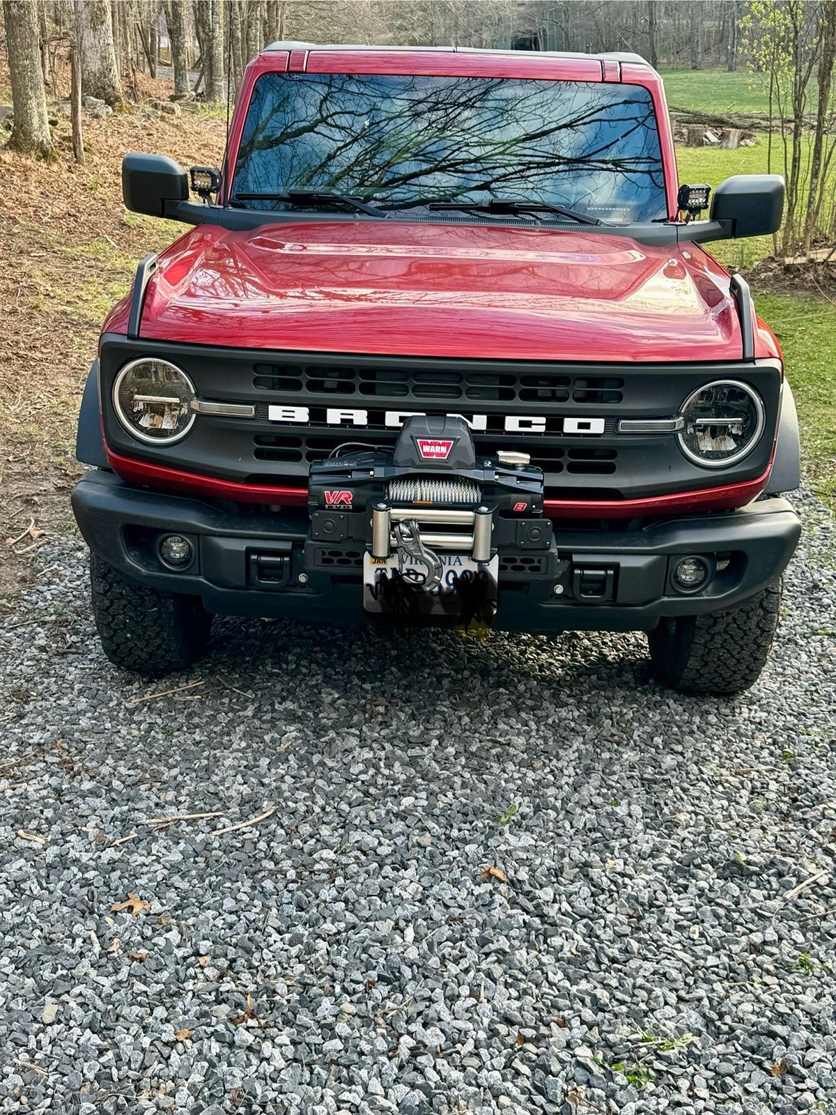

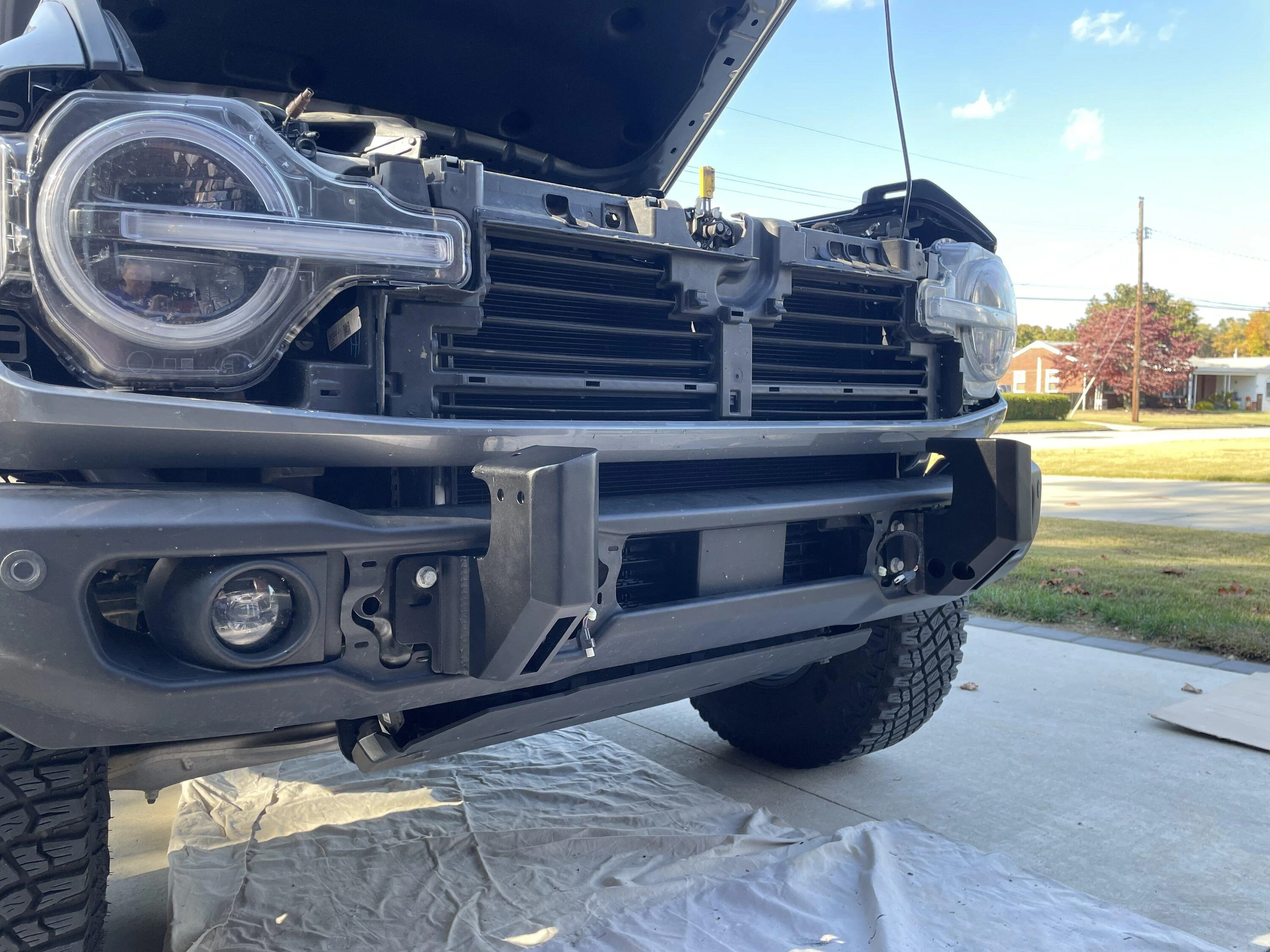

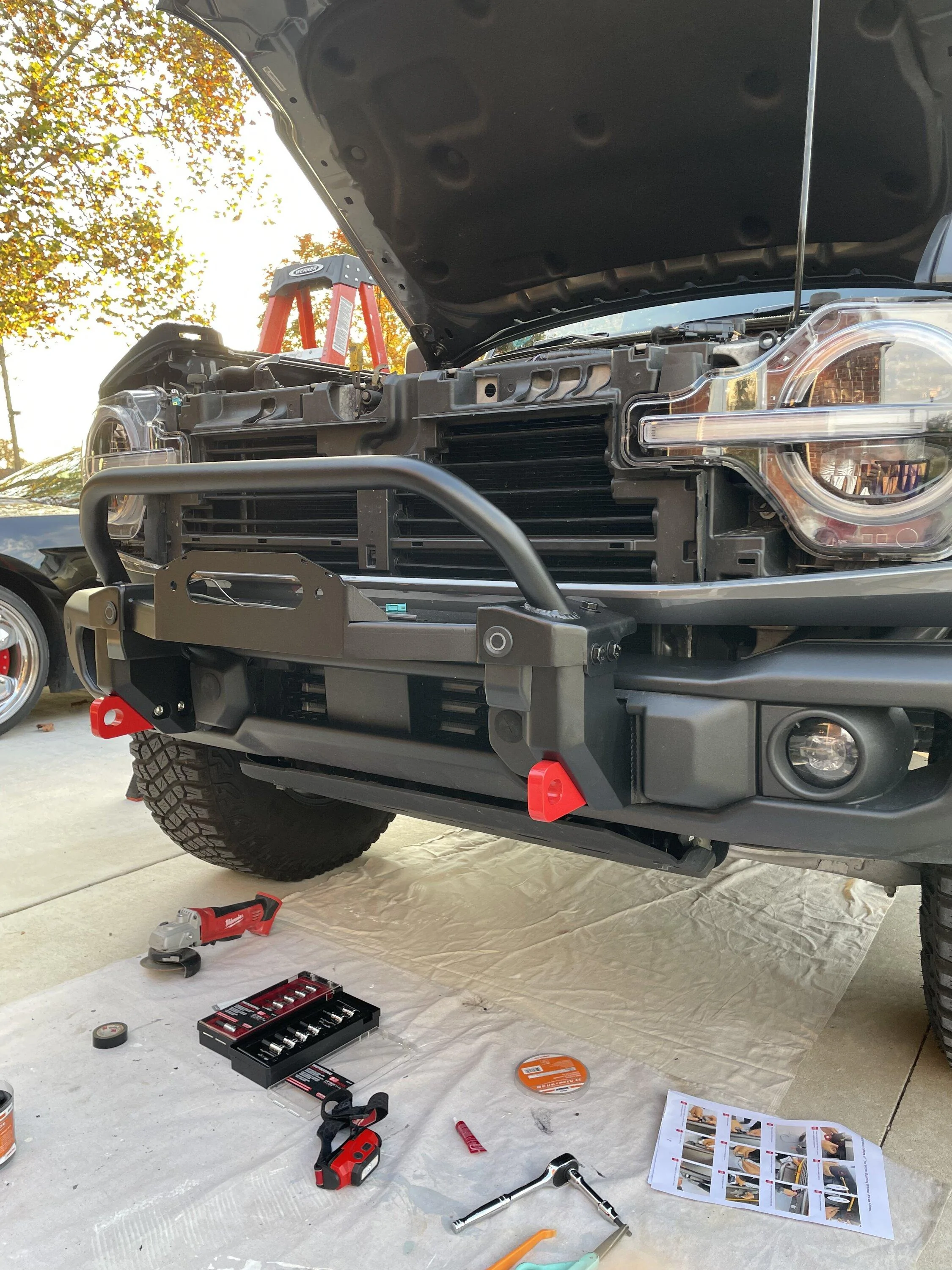

Installed the LOD frame tie in kit and RC High Mount this weekend. Very straight forward. Only thing I had to adapt was the outer LOD bracket. My BD has steel skid plates and the outer LOD brackets have the tow loop on the bottom. They would not clear the skid plate edge. So I cut them off. Ground the sharp edges off, sprayed some primer and paint on the raw surface. No issues after that. Using the LOD brackets does cause your bumper to sit about a 1/4 inch lower. Not very noticeable. Also, the Capable Bumper tow hook base is not recessed like the modular bumper tow hook base. Therefore the spacers from Rough Country that allow the winch mount to sit flush on the modular bumper are not needed on the capable bumper.
Ford Bronco High Mount Winch Plate installed on Capable Bumper IMG_0732
Ford Bronco High Mount Winch Plate installed on Capable Bumper IMG_0736
Ford Bronco High Mount Winch Plate installed on Capable Bumper IMG_0733

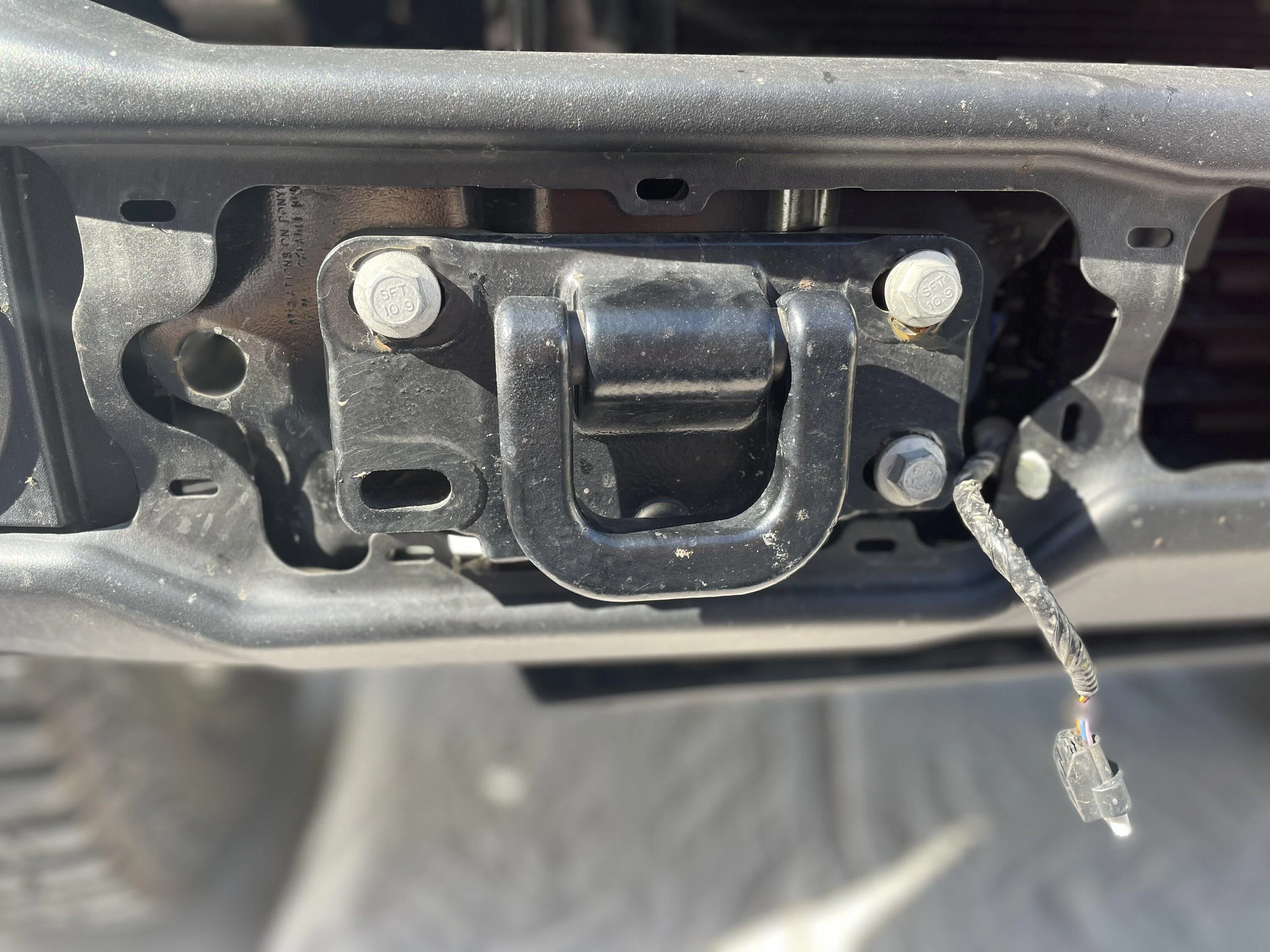

3 questions on the Buckle Up install on a capable with Lux:
1) I assume any parking lot problem issue is going to take out the camera (cam is furthest point of vehicle)?
2) I couldn't get the frame horn reinforce link to work; I assume this is what I need? :
LoD Offroad | LoD Offroad 2021+ Bronco Black-O.P. Front Bumper Frame Tie In Brackets
3) Buckle up kit plus frame horn kit is all in no other parts needed (to extend sensors, relocate cam and brace frame horns)?
Thanks very much
NJRoadkill
NJRoadkill
Oct 29, 2021
434
963
South Jersey
www.instagram.com
22 Bronco Badlands 2.3l Manual
Thanks very much
1) Yes. Cam is the furthest point forward after relocation.
2) I haven’t purchased them yet. However, the LOD will do the job. I think there’s a couple other companies/members who offer other variations.
3) Yes. Everything I needed was included and was plug and play. I did use some additional wire harness protection and wire management items that I have on hand for projects like these.
Note: we don’t have a LUX package, both are HIGH pkg. so I can’t speak to the ACC sensor compatibility.

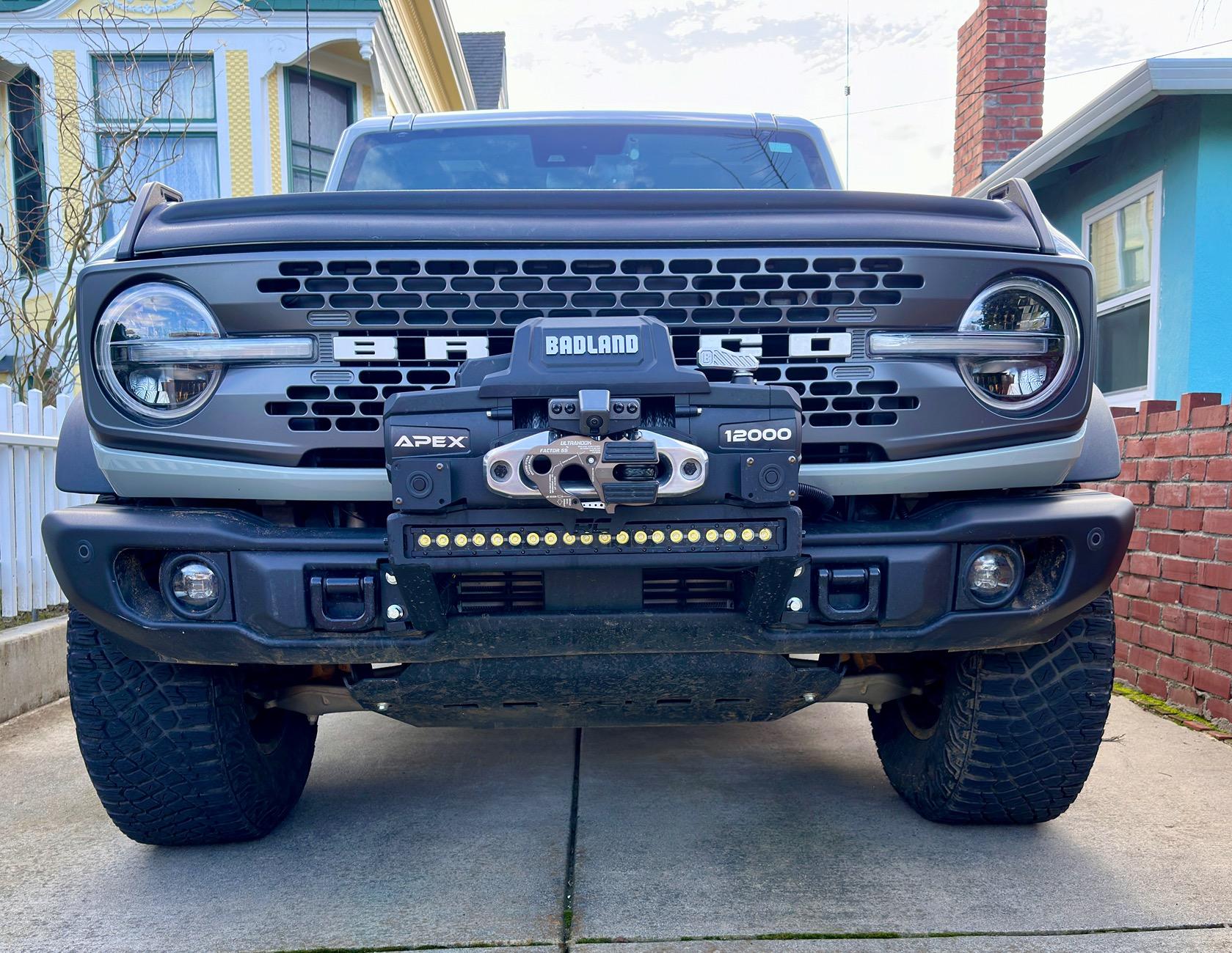

I went with the RC mount and the ADD frame horn reinforcements. That Badlands winch is huge! I had to space my parking sensors a bit forward. ACC functions fine in its original position.
Ford Bronco High Mount Winch Plate installed on Capable Bumper IMG_2394
