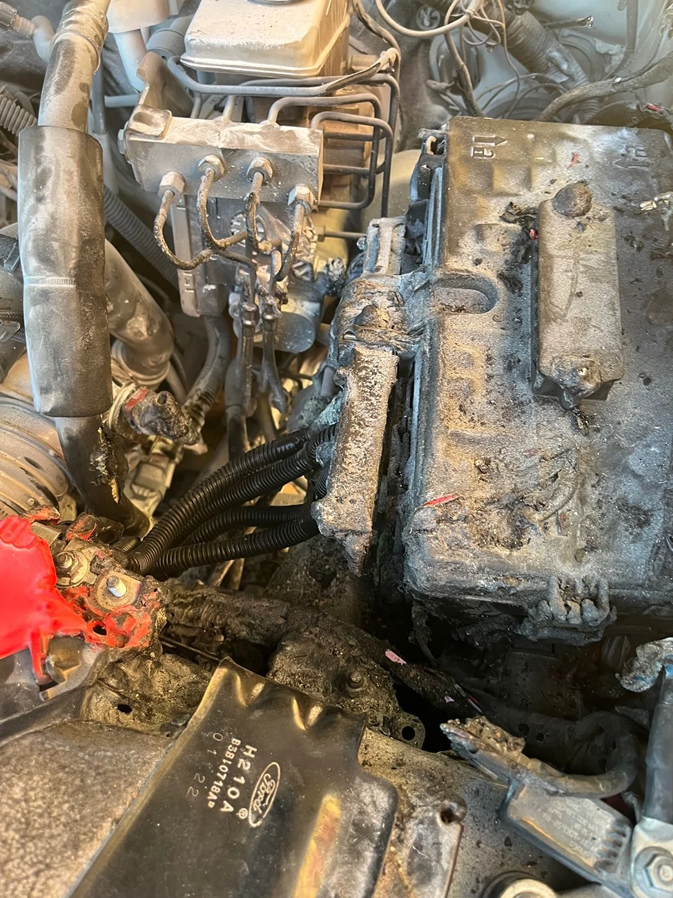

HELP!! Upfitter switch wire capacity- Fire Danger??
HPNQ420
Jul 8, 2020
513
962
Wauwatosa, WI
'23 Bronco, '19 GTI, '88 R100GS, HPN BMW G/S, 14 JK Rubicon

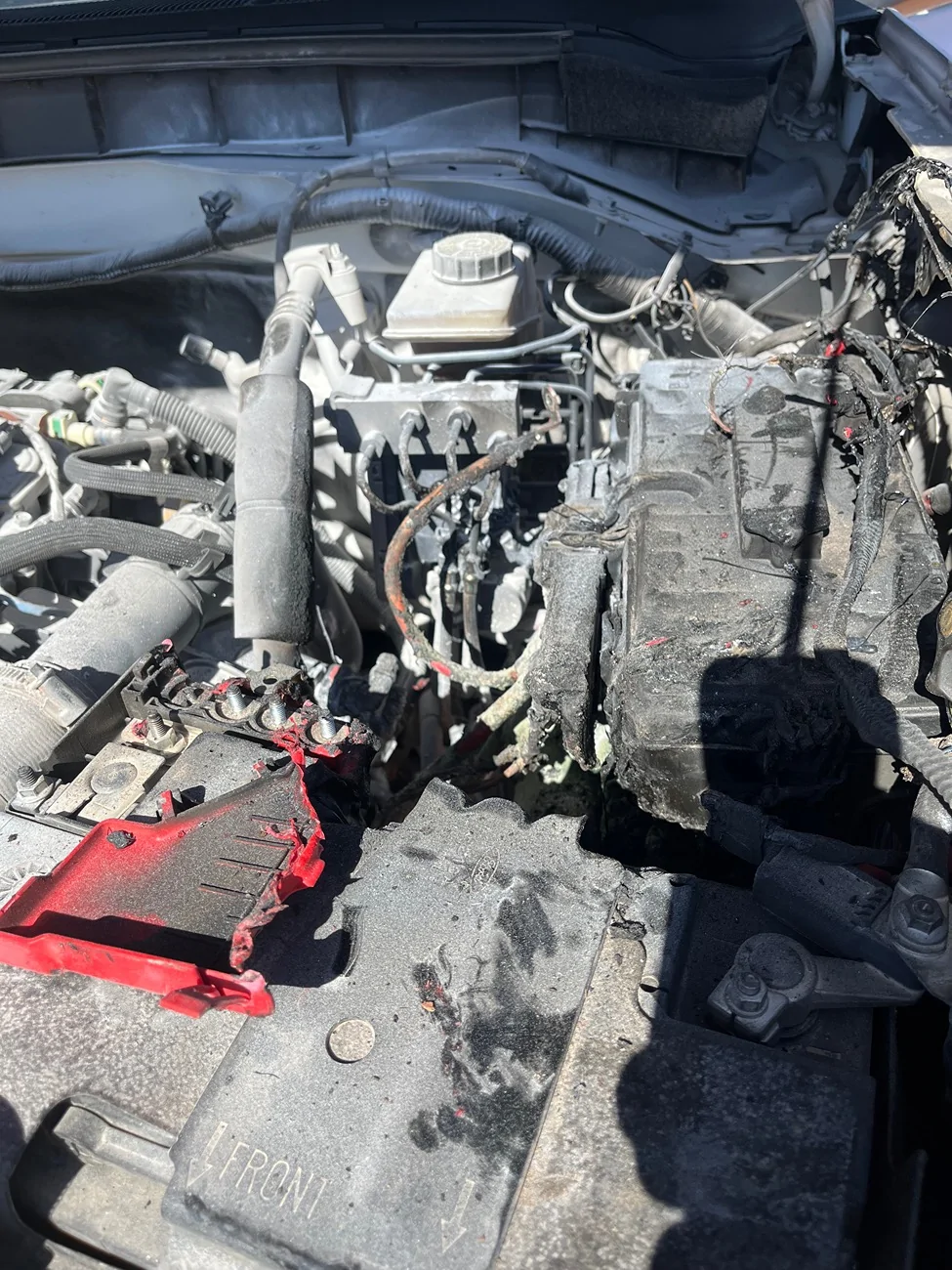

I am generally skeptical of screws to pinch wires to secure them for a reliable electrical connection. These can and likely will loosen in a vibration and thermally cycling environment. The raw leads on the "bad" or perhaps merely inconvenient design Ard superior with a proper crimp and crimp tool.
The unwanted potential side effects of a loose screw terminal connection include: poor device performance, high resistance, overheating, corrosion and fire.
Crimp a high quality ring terminal to the wire before attaching it to a screw terminal and all is well (as long as the screw terminal is of good design and quality). SOP for MS switches in aircraft.

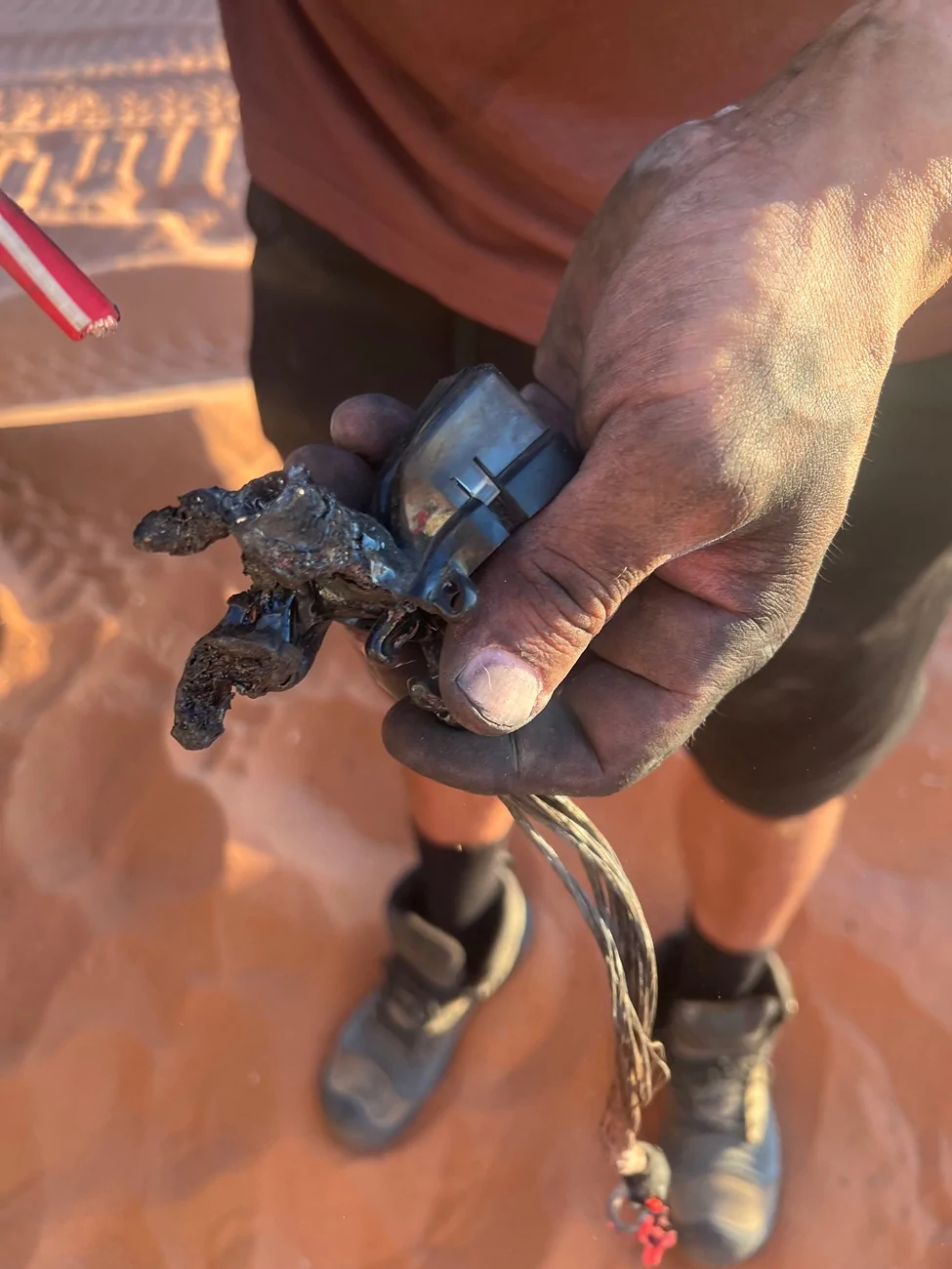

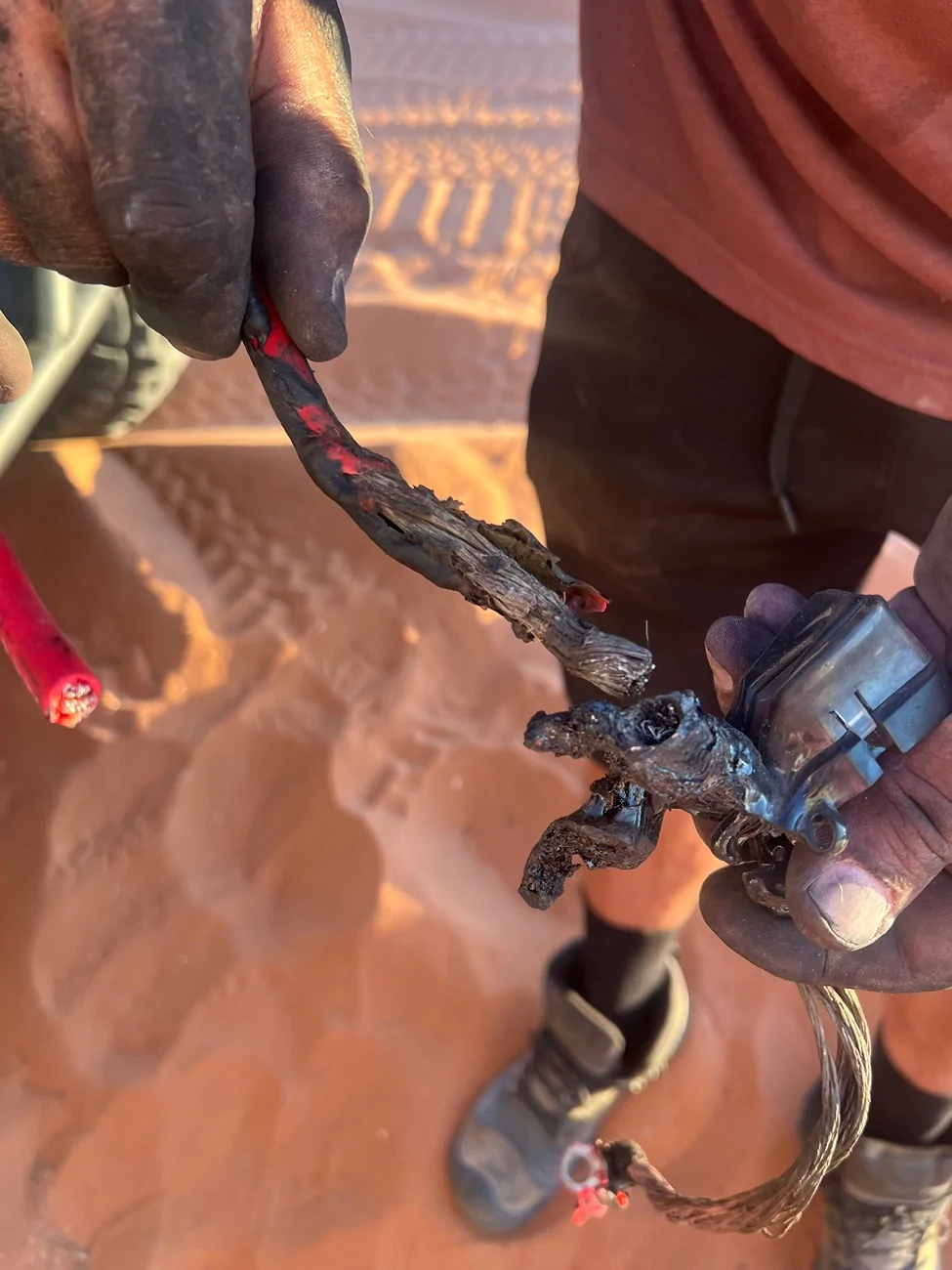

Can confirm-set screws are not “set and forget” and will indeed loosen. Then catch your shit on fire.
Yes, for stud terminals that support ring terminals.

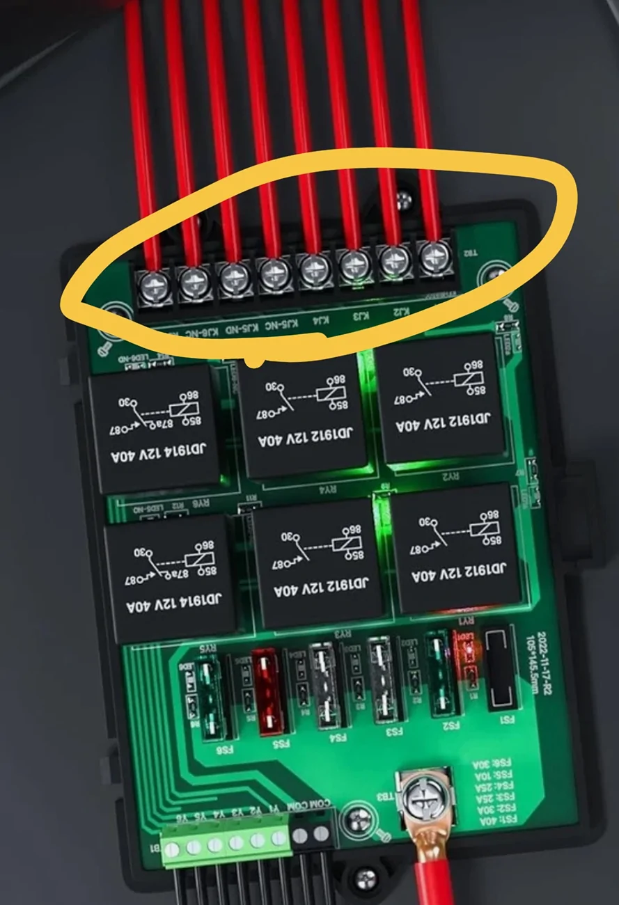

Those mentioned above (post #27), which I am referring to, absolutely do not support ring terminals. These are the ones...
Not that I look in detail, those are horrible!
Edit: No strain relief either.

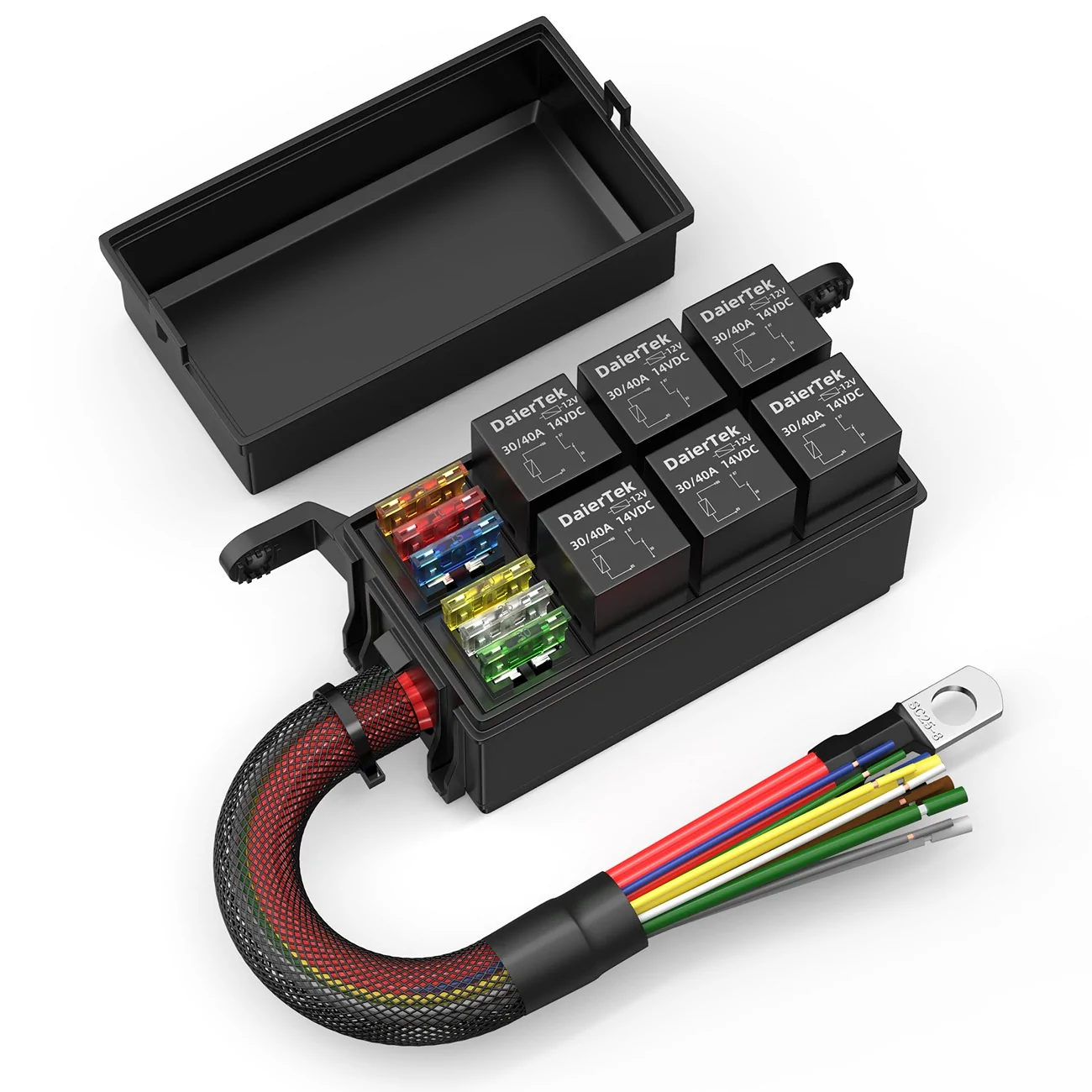

Turns out they make exactly what I had in mind! 6 relay controlled circuits. Mount this near the upfitter wires in the engine compartment, splice the leads and job done!
Anyone find a good place to mount this?
