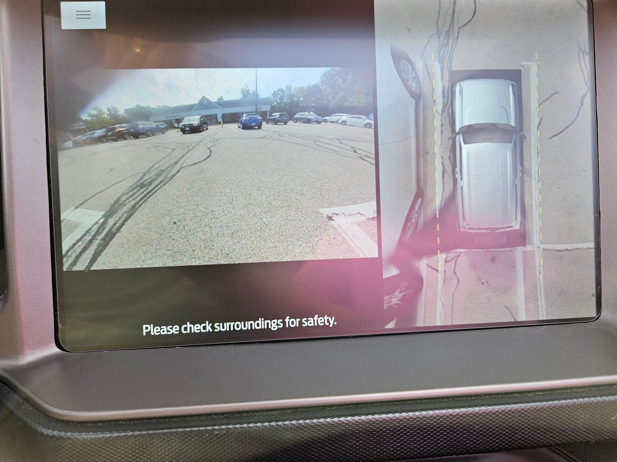

I also replaced my rear bumper ford says seeing they didn't install it they are not allowed to work on it. I have done everything I can think of, I even took off the entire bumper {few hunnert ponds) and re seated every sensor (as well as marking the direction and position prior to taking off factory bumper) Now I have bought new sensors and I have had it after I replaced the problem area the attachment is what I saw, good thing I already expected but yes same thing.
Ford Bronco HELP - Rear Parking Sensor(s) Connector 20240617_094546
